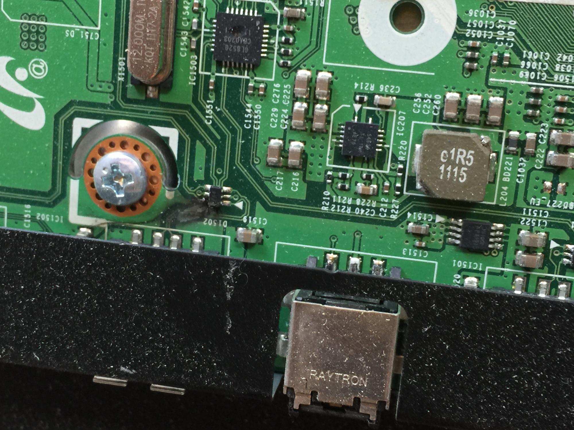

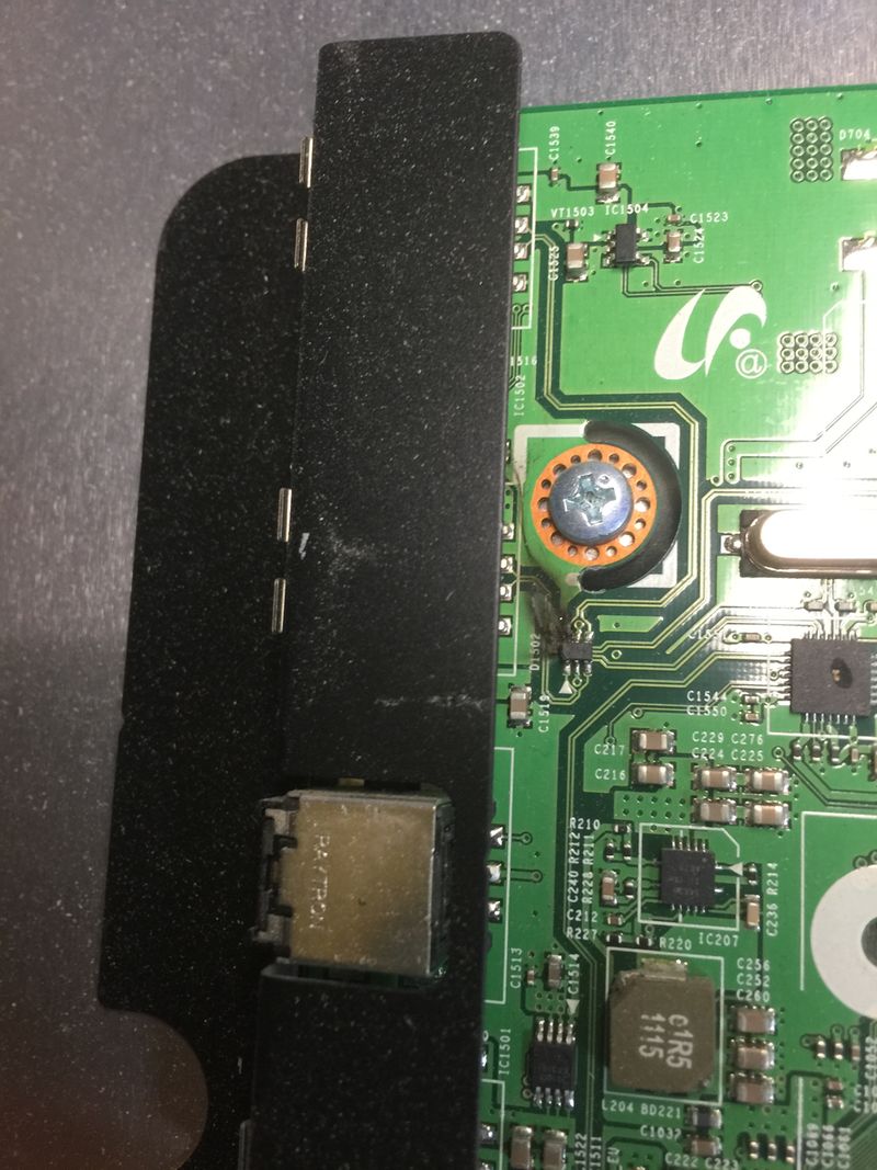

        • TheTesterMan
          • Apr 2015
          • 91
          #204
          Re: UN55D6000 Blinking Standby Light
          UN55D6000SFXZA
          PSU BN44-0042A
          MAIN BN94-04358C
          Initial Symptom: TV turns on, no picture, LED blinks and the PSU seemed to be cycling ( could hear it )
          Initial Repair: Since I've fixed many TVs with this same type of problem, the first thing I did is to power up the LED strips at which time I found the LEFT side strip out. I pulled the strip and verified that a few LEDs were bad. Ordered a replacement strip from China.
          Existing Symptom: Once the replacement strip was installed the TV does not power up at all, no backlights, no LED ( solid nor blink ). I was very surprised by this.
          Troubleshooting: Checked LED Strips again all working. When I disconnect the cable between MAIN & PSU, the LED strips turn on. Also all the voltages are available on the PSU ( see below ). When I connect back all the voltages drop to 0 which leads me to believe that I somehow fried the MAIN.
          PSU CM803 Pins - Not Connected to Main
          1, 2, 6 - NC
          10, 11, 12 - GND
          3 - B13V (12.5v)
          4 - EPWM (3.2v)
          5 - B13V (12.75v)
          7 - Vamp (12.75v)
          8 - BLU_ON (3.0v)
          9 - Vamp (16.82v)
          13 - B5V (5.39v)
          14 - ASV (5.39v)
          15 - B5V (5.38v)
          16 - PSU_ON (3.38v)
          Question: This TV uses a BN94-04358C MAIN, but can a BN94-04358A, B, or D be used in its place ? I assume the difference is probably firmware and not component ?

                #207
                "When I connect back all the voltages drop to 0 which leads me to believe that I somehow fried the MAIN."
                So the standby A5V drops to 0 Volt when all the boards are connected back together?
                Did you inspect both ends of the connectors of the cable that goes between power supply and the main board? This series is known for burnt out connector due to poor contact resistance.

                        Maybe also check the solder joints of CNM803 on powerboard and the joints of the other side too where it plugs into mainboard.
                        • TheTesterMan
                          • Apr 2015
                          • 91
                          #212
                          @budm - Yes A5V, along with all other voltages on that connector, drop to 0.
                          I did inspect the connector closely, including all the crimps, and it looks practically new. I also did a full continuity on each pin and it is fine.
                          @ nomoresonys - Yes familiar with this video but unfortunately there are no voltages anywhere on the MAIN, it is like it is suffering from a major short although I am not able to find/measure one.
                          Just to make sure, I resoldered CNM803 on both boards although I saw no solder cracks nor cold solder joints.
                          The PSU Filter Cap measure 350 when LED rings are on but drops to about 260V when I connect the connector and the LED rings turn off.
                            #213
                            1) So the A5V tested at the power supply connector side (not at the main board side) shows 0V, correct? For A5V to drop to 0v, it has to be dead shorts.
                            2) Have all the cable back in place then check the resistance on the A5V with ref to GND.

                                #215
                                160K is not enough to load down the STANDBY A5V to 0V at all, got to be error some where.
                                • TheTesterMan
                                  • Apr 2015
                                  • 91
                                  #216
                                  Fully agree but have not been able to find anything that would pull down those voltages.. Nor can I explain how this is now not working only by switching the LED strip. Unfortunately I am a very impatient man and moving on to another TV. I'll post additional results after a few bottles of wine
                                    #217
                                    Try having nothing else connected to the main board but just the cable between main and power supply board and see what will happen to the standby Voltage.
                                    • TheTesterMan
                                      • Apr 2015
                                      • 91
                                      #218
                                      Same, the short ( if any ) appears when the Main is connected. For now I put the TV in storage while I work on others, I'll get back to it sometime in the near future. Thanks all for the help
