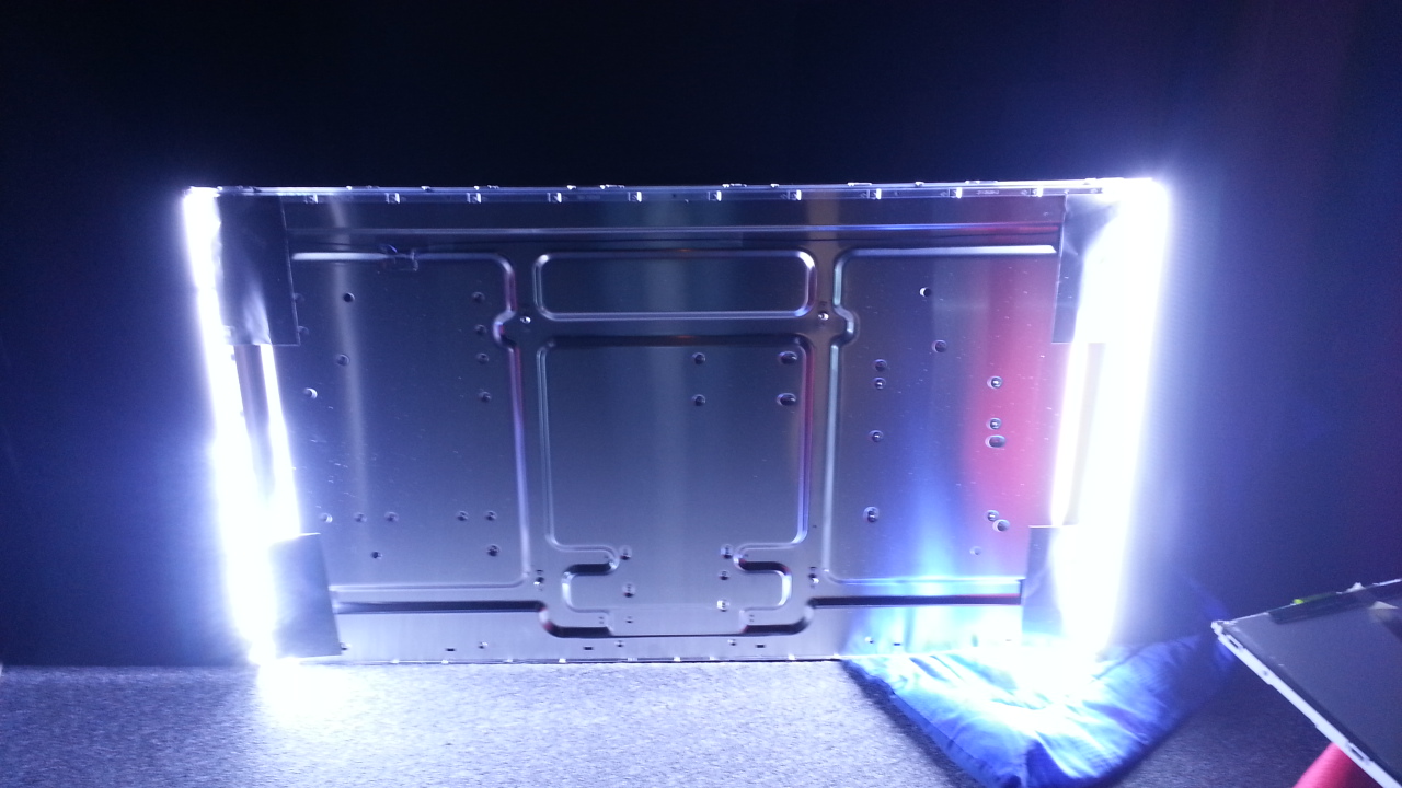

                                    #97
                                    Re: UN55D6000 Blinking Standby Light
                                    Well of course I got impatient and put a wire across the two open diodes...
                                    SUCCESS !!
                                    • mmartell
                                      • Oct 2013
                                      • 3189

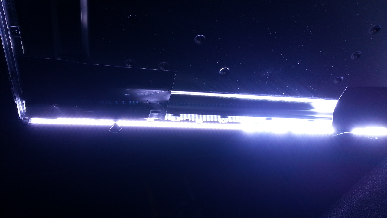

                                      #98
                                      Sort of...
                                      As can be seen the led's on the bad strip are quite a bit less intense on the top half as the bottom half. Can that be explained by the fact the bottom has 19 of 50 led's out ?
                                        #99
                                        If those bottom LEDs are short circuits, the LEDs should be just as bright (circuit will drive a constant current regardless); if they are in between, then the LEDs might be dimmer.
                                        • mmartell
                                          • Oct 2013
                                          • 3189
                                          #100
                                          All 20 tested short (continuity) though I didn't ohm them.
                                          Strangely enough I'd doubt you could tell the difference in brightness from the bottom half left strip vs the right strip with regular programme material even though almost half are out. Can't leave it the way it is though as I DID notice a difference with the top left portion of the screen when the set was working.
                                          Need a source for these led's if I can't get another strip...
