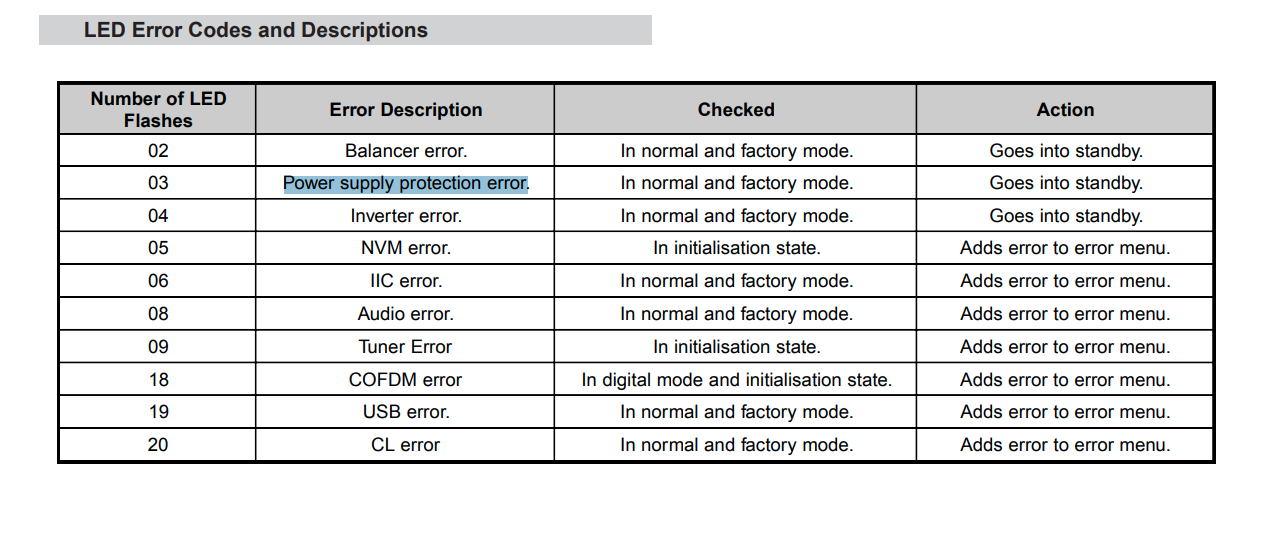

    my tv almost 2 years not powerd on and when i turned it on nothing happened and only 3 red light keeps blinking
    i opened the back cover no sign of damage on the powery suply or motherboard
    when i plug in the power i hear the reley sound like tik first and another tik..after that only red keep blinking..
    another thing is even after i unplugged the power, The tv keeps red blinking 3 times for 2 almost 2 munites

    Code error 3 - Power supply protection error
