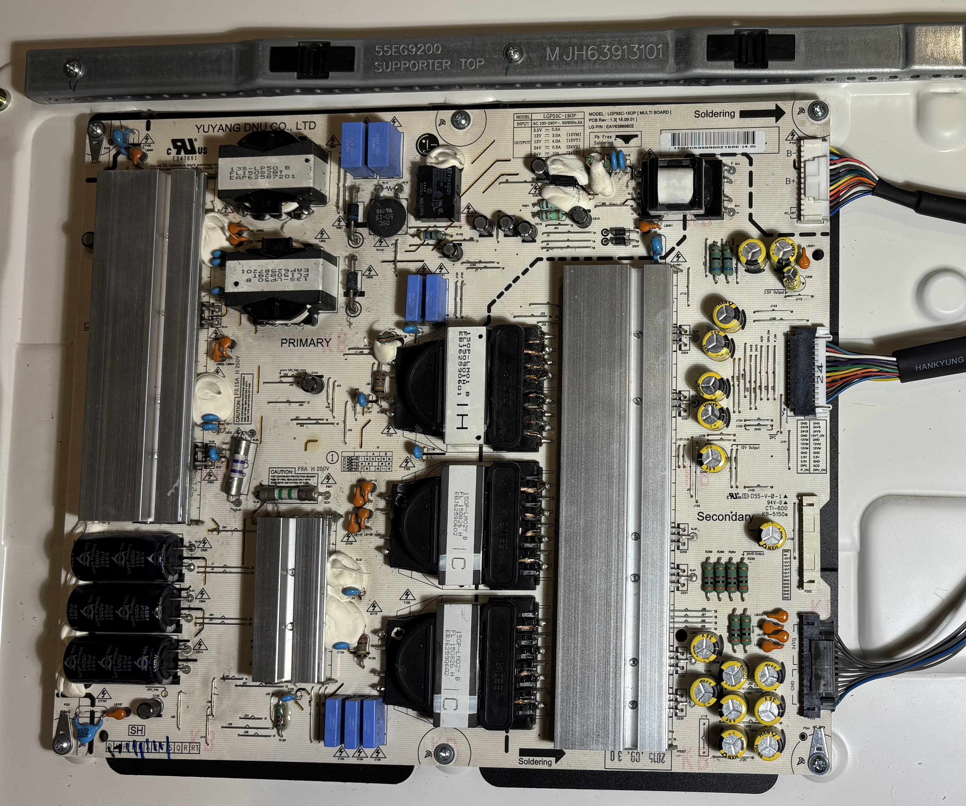

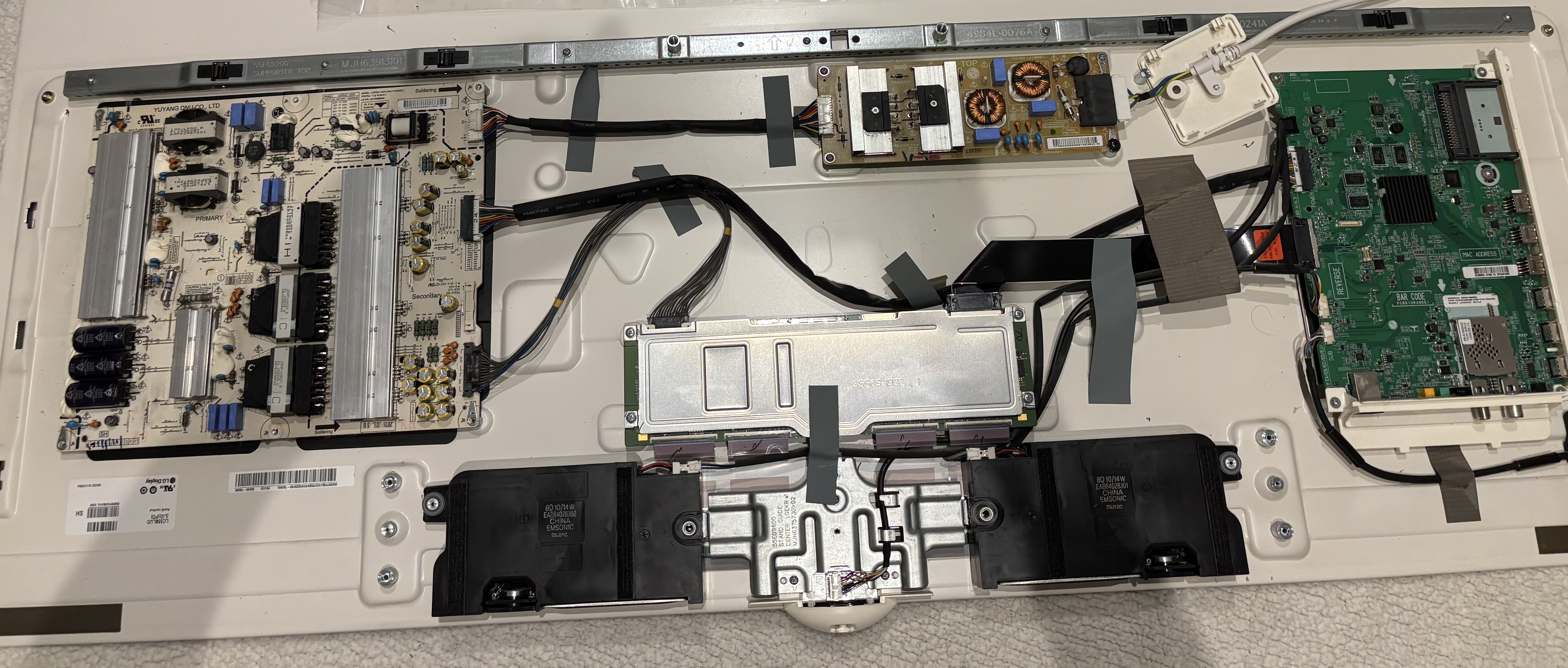

    Hi everyone,
    I'm trying to troubleshoot and repair this old LG OLED curved TV, model 55EG910V.
    I did some basic troubleshooting and reviewed most related posts here, but I wasn't able to isolate the issue.
    The TV shut itself off during playback and never came back to life - the standby light remains off. My dad claims that it has happened a few times in the past but the issue resolved itself after some time. Not this one.
    After checking the basics I did the following:
    • I measured all voltages and as expected the only active supply is the 3.5V standby. It reaches into the main board and IR/button assembly just fine, but the standby LED stays off. Pressing/holding the button or using the remote to turn it on does nothing.
    • I tested the power supply by disconnecting it from the main board and the TCON. By shorting P_ON and DRV_ON to 3.5V I can hear the relay click and all outputs turn on. Even when loaded the supply is stable.

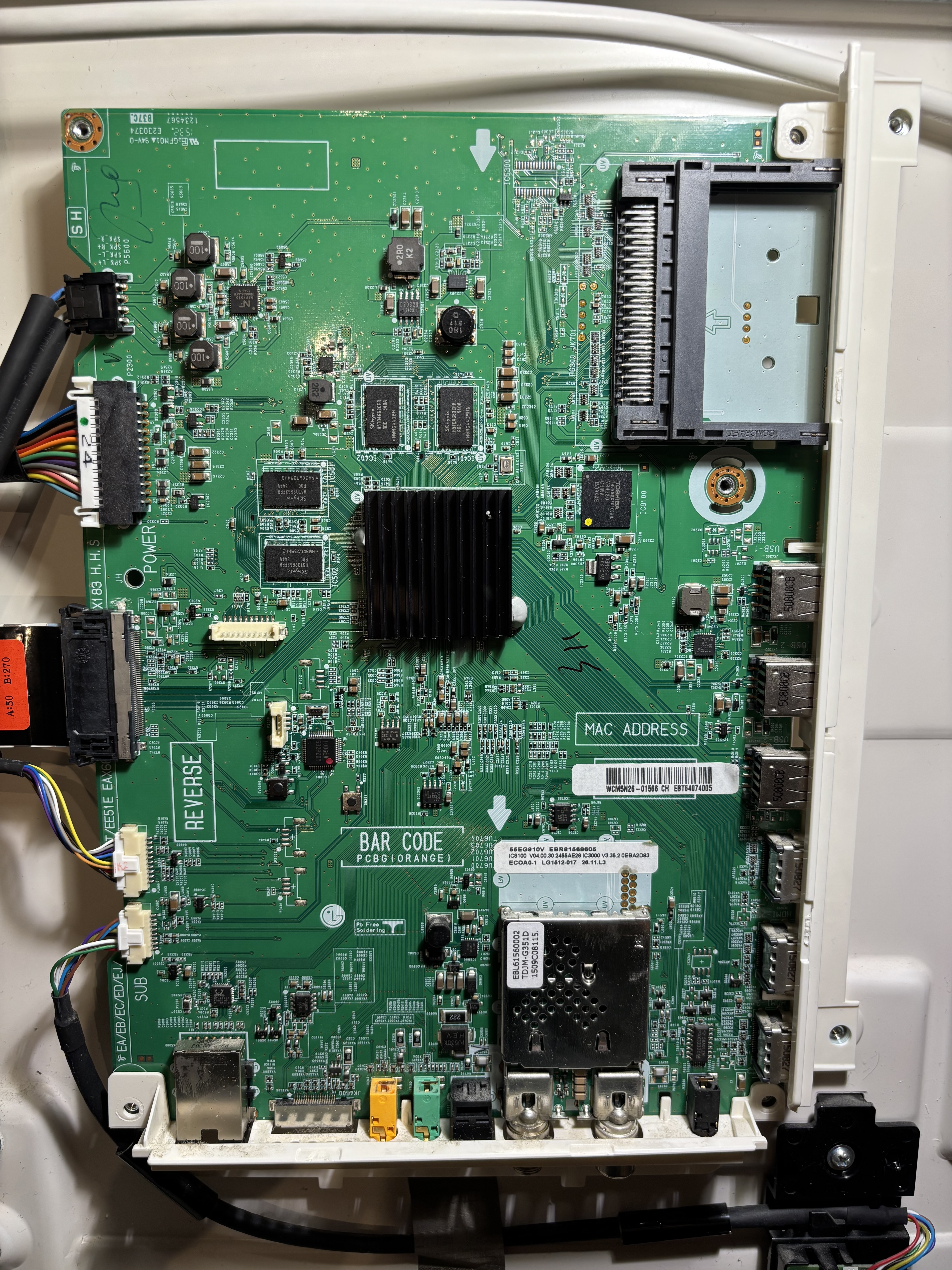

    • I then tried to disconnect the main board, force the power supply on, and see if the panel would show some kind of test pattern or image. Nothing. Probing around on the board I could see the 24V rail being active, but no voltage on most components or test points. As far as I can tell, nothing got noticeably hot. I tried the same with the panel's ribbon cables disconnected and the results were the same.
    • With the main board connected again and the ribbon cables of the panel left disconnected, I tried again, but to no avail.
    • On the main board, I also tried to hold down SW201 while trying to power it on but nothing happened.
    I still need to try to force the board to reset with the Headphone IR trick as I don't currently have the IR LEDs needed.
    Now I'm stuck wondering what to check next and if a main board/TCON replacement is worth trying. Any advice is much appreciated.
    Pictures are attached below.
    Thank you

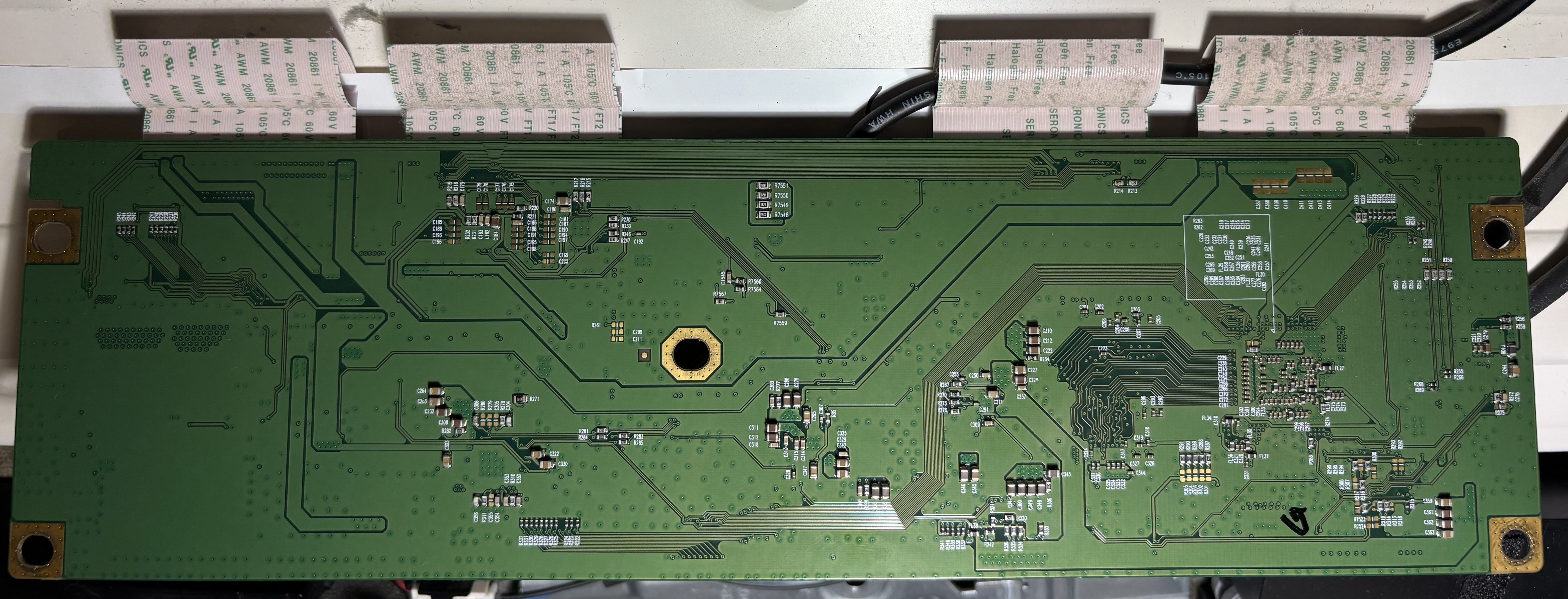

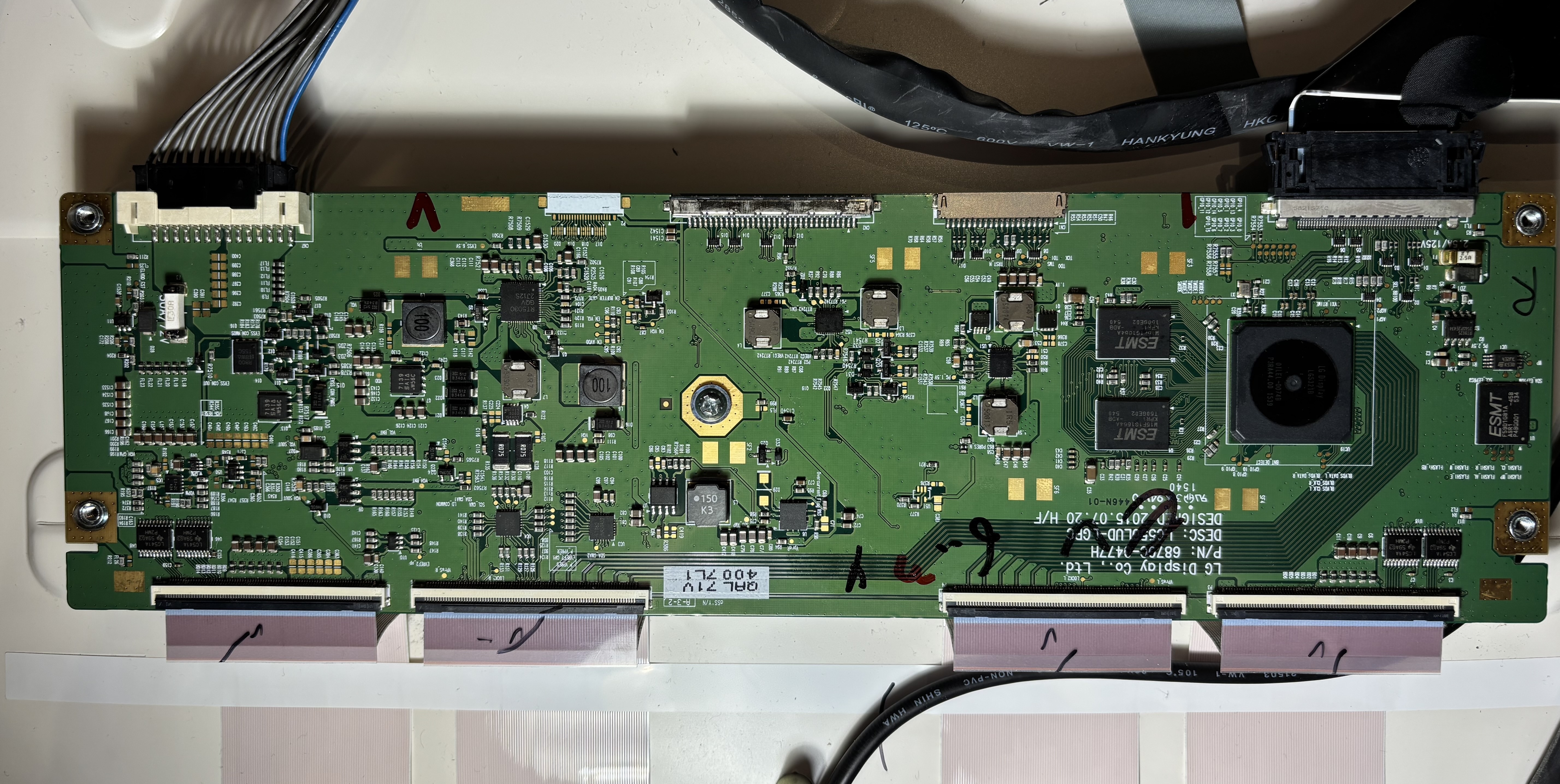

    Try an half reflow to the bga chips on the tcon then turn on tv when slightly hot..
    • AleMonti
      • Nov 2024
      • 15
      • Italy
      It's doable with a heat gun? I don't have a reflow plate. I think tomorrow I'll check the ceramic caps for shorts first. If there's a faulty component what could be a safe voltage and current to inject to try locate the shorted component? I'm thinking something that will be enough to melt wax or something.
      • Davi.p
        Hobbist Tech
        • Sep 2009
        • 4537
        • Italy - Milan
        Heat gun ok. Dangerous to inject voltage there. Don't do it..

          Also, to test the TCON while it's disconnected from the main board, is connecting CN7 enough? That only feeds 24V. I wasn't sure if I could force the PSU on with the main board connected, so TCON was disconnected from P1 during my tests yesterday. Looking at it more now, that ribbon cable might carry 12V to the board. Do I have to jumper 12V to it? In that case I guess that would be on the top right corner where F1 is.
          Another thought, if the issue is the TCON, shouldn't the TV turn on with it disconnected? I've already tested that and it doesn't. Maybe the main board is at fault here..
          Anyway, I'll post an update tomorrow as I get to work on it
          • Davi.p
            Hobbist Tech
            • Sep 2009
            • 4537
            • Italy - Milan
            To test an lcd or oled tcon at bench, usually give it a 12v is enough, but in some models and some designs there could be a jumper to place to simulate the connected panel

                      Ok I've connected the TCON to 12V via F1 and now I can see that most parts of the circuit have voltage, yet no image. I've turned on 24VD too. The board draws around 0.25A on the 12V rail, and UC19 gets warm to the touch. I tested all the ceramic caps on the TCON and there were no shorts I think.
                      With the ribbon cables going to the panel disconnected, some test points measure different voltages:
                      panel connected panel disconnected
                      VGL 0.18 -7.05
                      VGH 0.26 23.0
                      VGL_SOUT 0.34 2.61
                      VGH_SOUT 2.02 3.83
                      EVSS_6.5V 6.56 6.57
                      PG_1.5V 4.68 4.67
                      VDD 0.45 16.1
                      Are those normal?
                      I also tried the IR file with everything connected normally but nothing. Maybe I'm doing it wrong? With my phone's camera I can see the IR led illuminating with one of the files.
                      Any other thing to try or test? I think reflowing should be the last resort as it's quite easy to mess it up with the heat gun.

                            NO WAIT.... check the panel pins connected to VDD respect to GND, maybe there's a shorted cap there...

                              on this chassis the main problem is IC3000​
                              • AleMonti
                                • Nov 2024
                                • 15
                                • Italy
                                Testing the TCON with the left most ribbon disconnected from the panel I get a white line! I think that confirms the panel being the issue? I've tested all the exposed caps and they seem fine to me. I guess there are more under the metal chassis... maybe it's time to get the Dremel..
                                IC3000 on the mainboard controls the wake from standby as far as I know. It probably also gets feedback from the TCON, so refuses to turn on the TV after detecting the issue

                                  if VDD it is not shorted at panel, i don't think panel must be damaged, if you feel the cost is acceptable and trust me, try.at least a tcon on market, 2 only requisites: 1) brand new or 2) extracted from working set (cracked panel)
                                  • lotas
                                    • Jan 2016
                                    • 4852
                                    • Russia
                                    These models LG 55EC930V, LG 55EG910V..., the panels are dying like flies, and no new T-CON will help here...
                                    • Diah
                                      • Feb 2013
                                      • 6558
                                      OP you are doing wrong OLED Panel will never work with disconnecting ribbon cable one or more between T_CON and panel... just because of the EVDD VCC >22V will go around over all 4 ribbon.long...
                                      you need to disconnect the LVDS from MB to T-con and the socket between PSU and MB and switch power on on psu to turn on 12V and evdd 24V. include power by using the stand by 3.3V via 1KR
                                      • AleMonti
                                        • Nov 2024
                                        • 15
                                        • Italy
                                        Diah I don't see your point, I think I'm doing the test correctly. TCON connected to PSU via CN7 and to 12VM (on the PSU) through a jumper on F1. The mainboard was completely disconnected. I then forced the PSU to turn on with the standby 3.5V bridged to P_ON and DRV_ON. Because the panel might have been shorted and overloading the buck converters on the TCON, I tried disconnecting it from its ribbon cables and the voltages didn't drop anymore. My take away is that the panel is shorted, either internally or on its small bottom edge boards. But I could be wrong.
