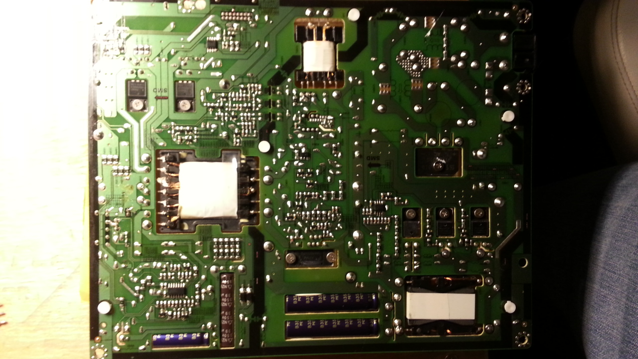

                        Ok need some help here thinking this out.
                        I believe I have a faulty power supply. 5V Standby is rock solid. However when the secondary voltages come up the unit shuts down (protection ?) and the cycle starts over again.
                        I think there is a short because I'm reading voltages on the PSON, BLON and DIM pins.
                        Doesn't sound like a capacitor issue does it ? I've heated the board anyway with no change.
                        Where should I be looking ?

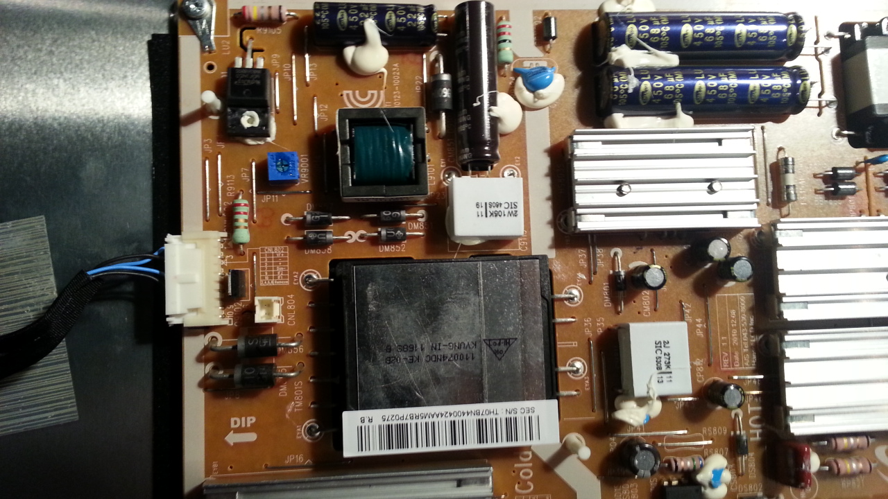

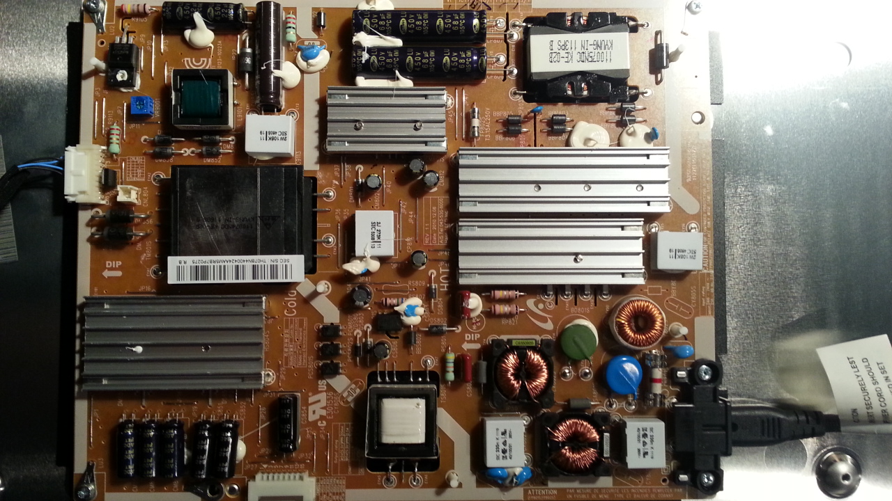

                          #32
                          Re: UN55D6000 Blinking Standby Light
                          Here are some pics of the board. Is there some common area that would leak voltage to the input pins ??

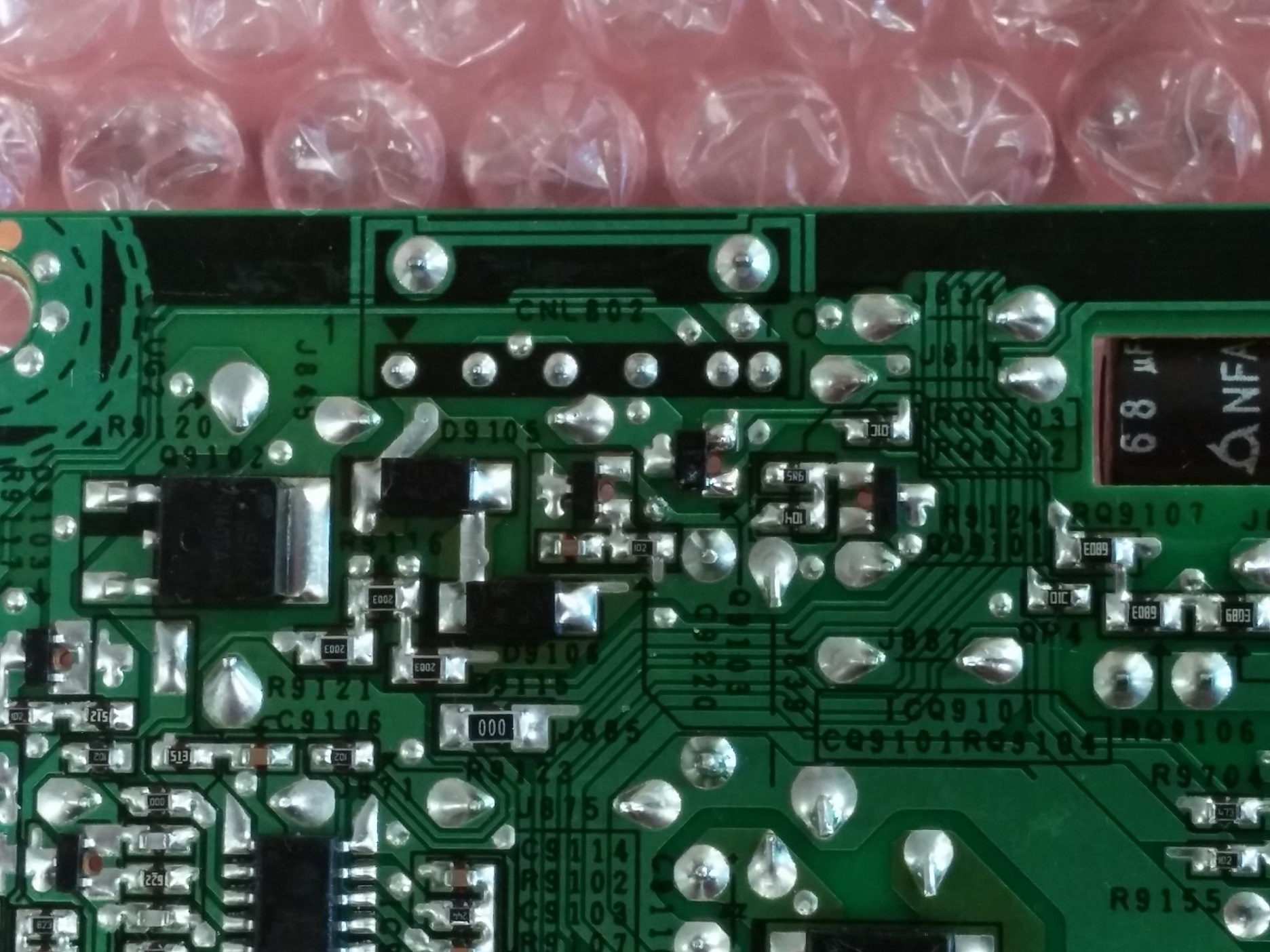

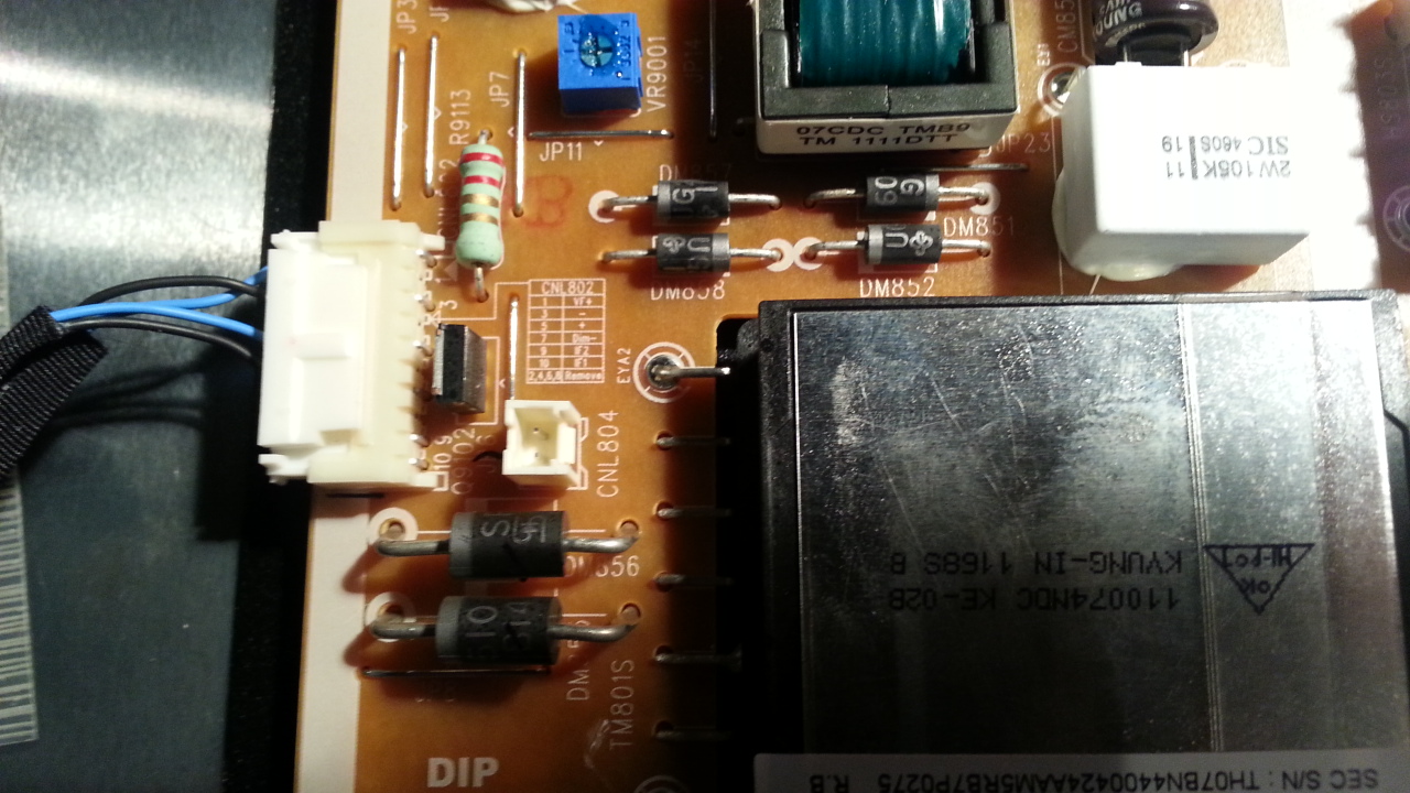

                                    #37
                                    Pins 3 and 5 are physically connected on the psu ill try to post a pic
                                    2, led panel will not light , main has to keep the psu fully on, some can be tricked to stay on , i will have to look into it , w/o schematics its kinda hard.
                                    i still have not received the new main yet. will post as soon as its in,
