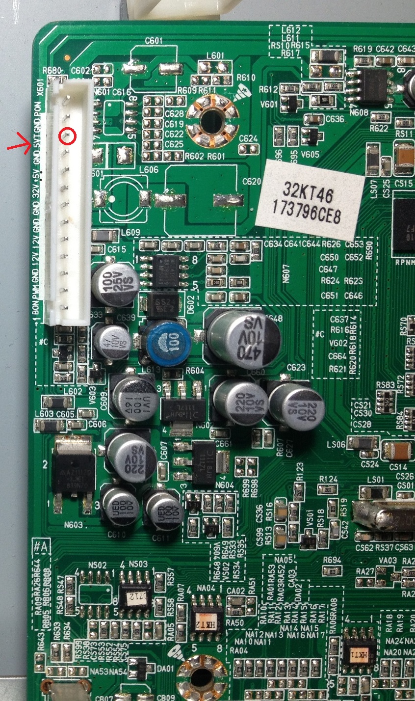

        #83
        Re: 32" Dynex DXL3210A Won't Power On

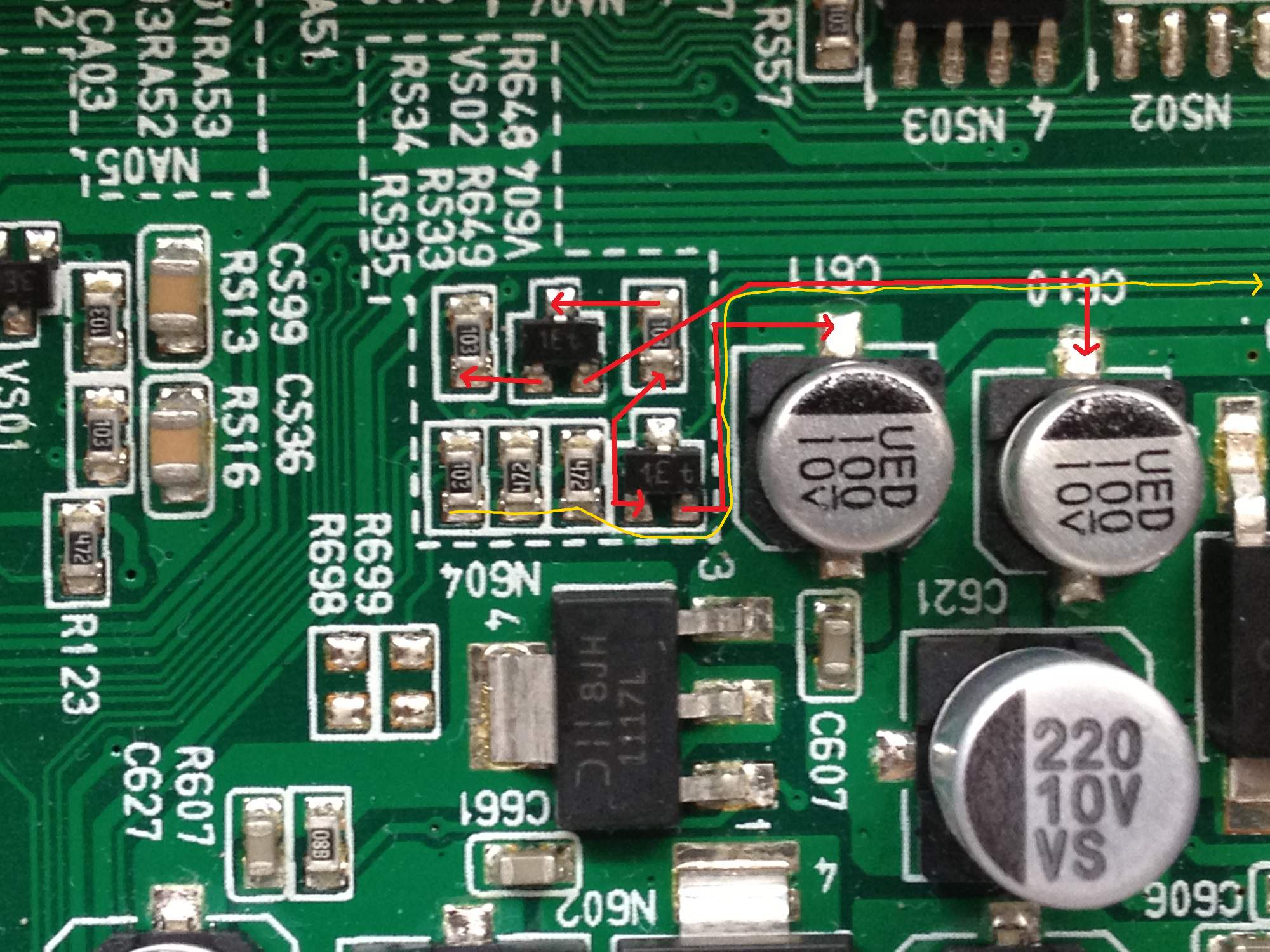

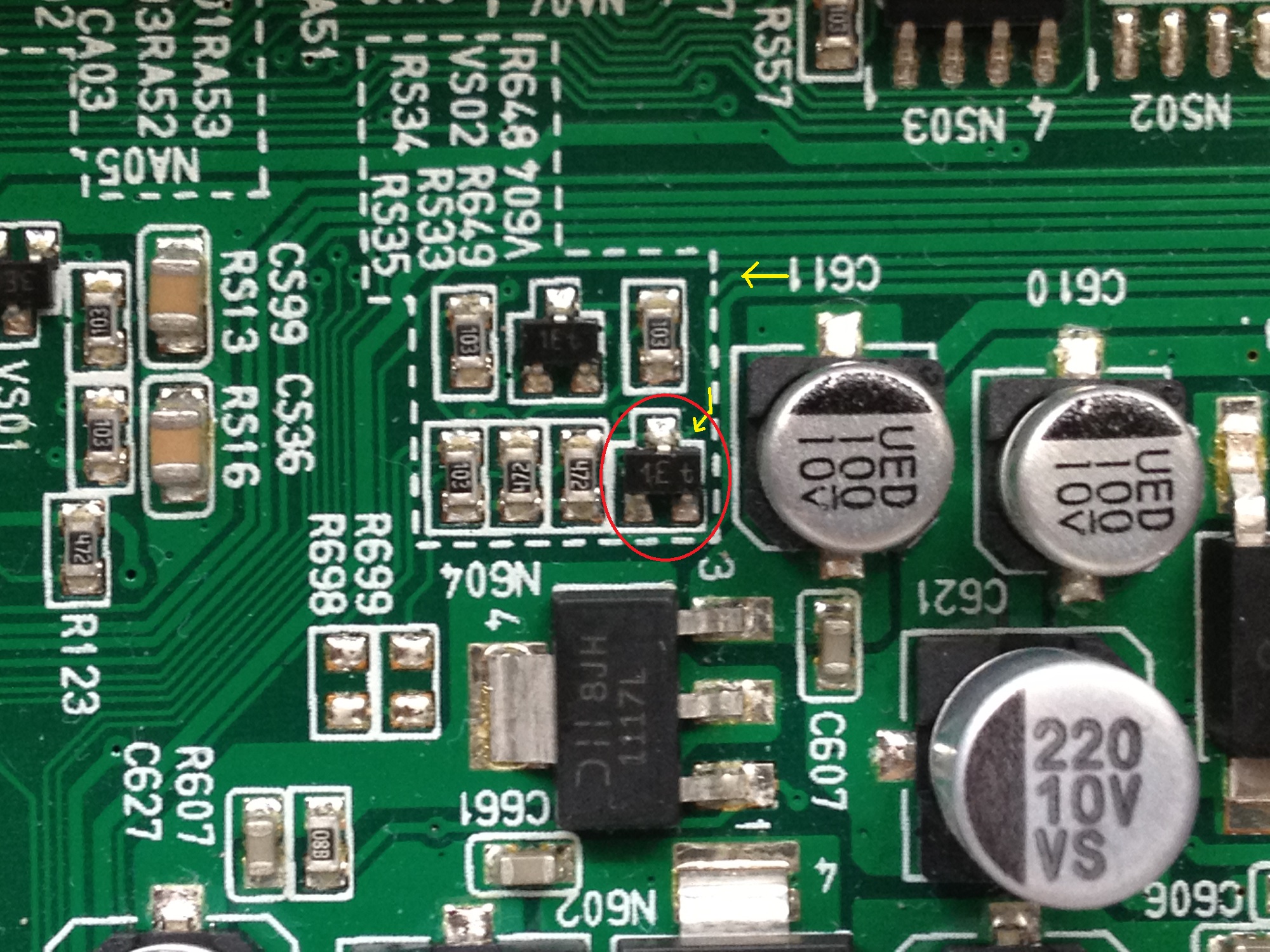

        Alright I think we're finally getting somewhere! I finally found where the trace leads. It leads to what I think is an smd transistor. It just might be the bad component, but is there a way of testing it?
        • ben7
          Capaholic
          • Jan 2011
          • 4059
          #84
          First we need to draw out the circuit right there to see what we need to check.
          Both transistors in question have the marking "1Et", which is a BC847A.
          Muh-soggy-knee
              So how do we draw out the circuit?
              We trace the tracks, and draw it out. I use a special circuit-designing program to draw them out on.
              You can try using just a simple paint program, since it will take a while to install more programs...
              On your picture, the transistor that is circled in red, where do the bottom two pins goto? I think one of them will go to ground. The other I think leads to R684.

                Whcih pin that the trace (PSON) is connected to on that transistor (left, middle (top tab), right)
                • ben7
                  Capaholic
                  • Jan 2011
                  • 4059
                  #88
                  Top tab. (Collector)
                  its an NPN transistor.
                  Im thinking that is the pull-down transistor for the P_ON signal.

                    #89

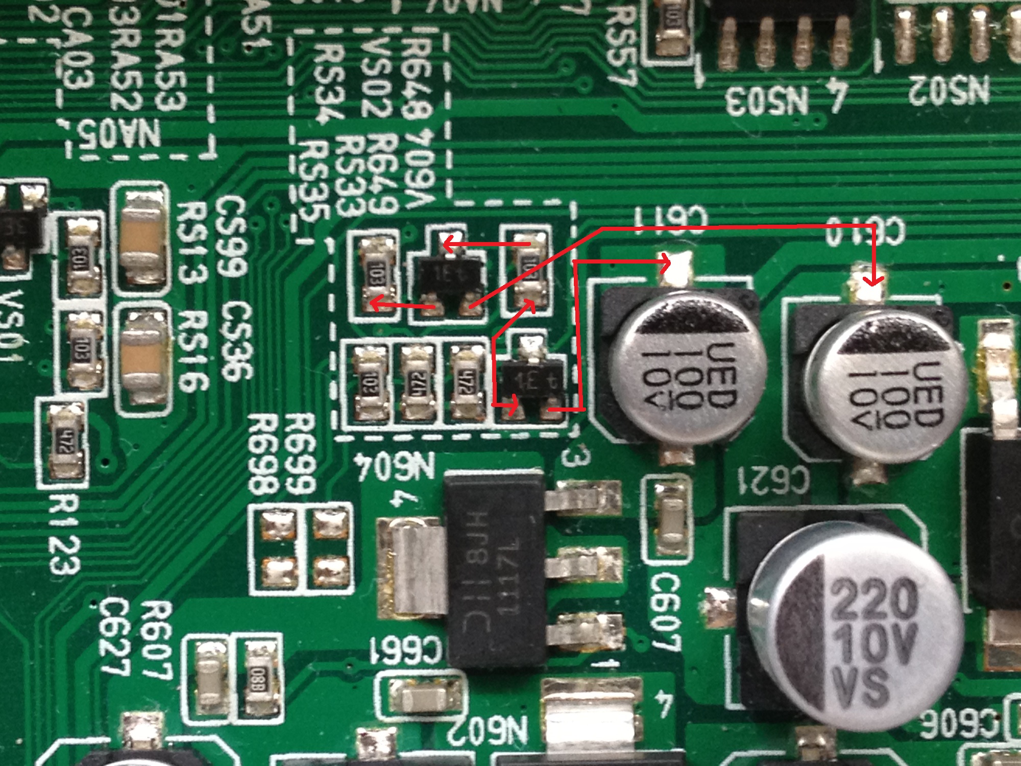

                    Heres what i traced using the continutity function.
                    I forgot one line, but the two SMD capacitors seem to be in parallel.

                      #90
                      So, if im right, this yellow trace should goto a power source? (probably 5vsb)

                        #91
                        Yep it leads back to the pin labeled 5VT, back on the connectors.
                          #92
                          Then you should check the voltage between the Emitter (right pin) and Base (left pin) to see if it has about 0.6~07Vdc, if not, that means the processor is not sending the signal to the base to keep this transistor on (this will cause the PSON to stay lo) when the TV is not on.

                            #93
                            Component V604, With red probe on the emitter and black probe on the base, I get a reading of 0.035V. So does this means that the transistor is bad and is the cause?
                            VS02, I did the same measurement and got 0.683V so just comparing the differences.

                              #94
                              Do you think the other transistor pulls it high then?
                              Im kinda thinking the other transistor has to do with this one too. Like maybe they are hooked up as a buffer? (Two inverters)

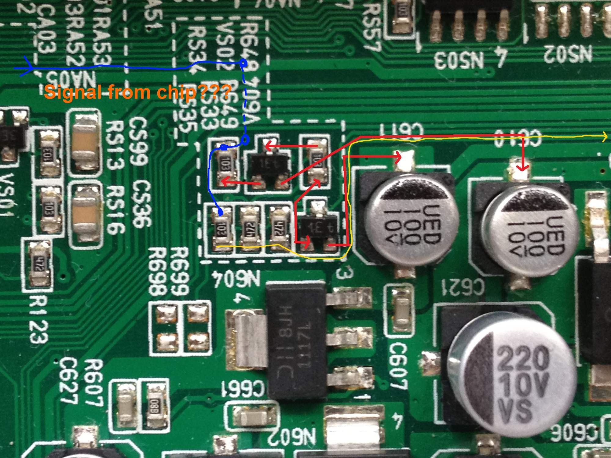

                                #95
                                I'm thinking this is where the signal from some control chip comes from!

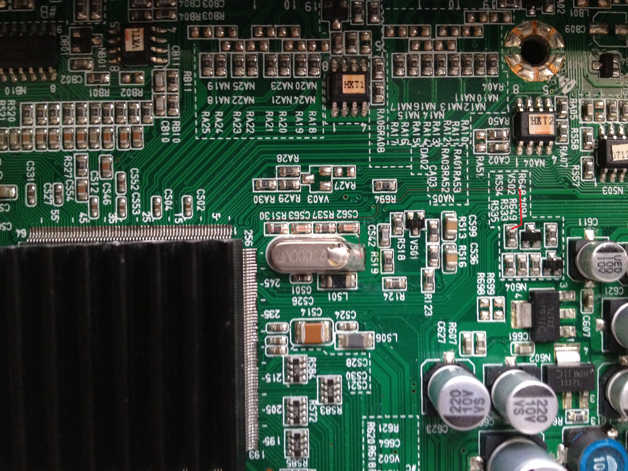

                                  #96
                                  Heres what i found going through the trace

                                    #97
                                    You've made a mistake, it doesn't go to the resistor, it goes right under the chip in the corner.
                                    EDIT: oh, you switched from one track to the other, and back again, I see now.
                                    Strange that it connects to the crystal, unless it is supposed to be powered on when the tv is turned on.
                                    Measure the voltage from ground to each end of RS34 back near the two transistors.

                                      #98
                                      The soldered joint near the crystal is to reduce EMI by connecting the case of the crystal to ground creating an RF shield around the crystal.

                                        #99
                                        Im not sure about it though. The white overlay makes it hard to see the traces around there.
                                        It is possible that when the TV is turned on, the PS_ON goes high, and it starts up the crystal oscillator.
