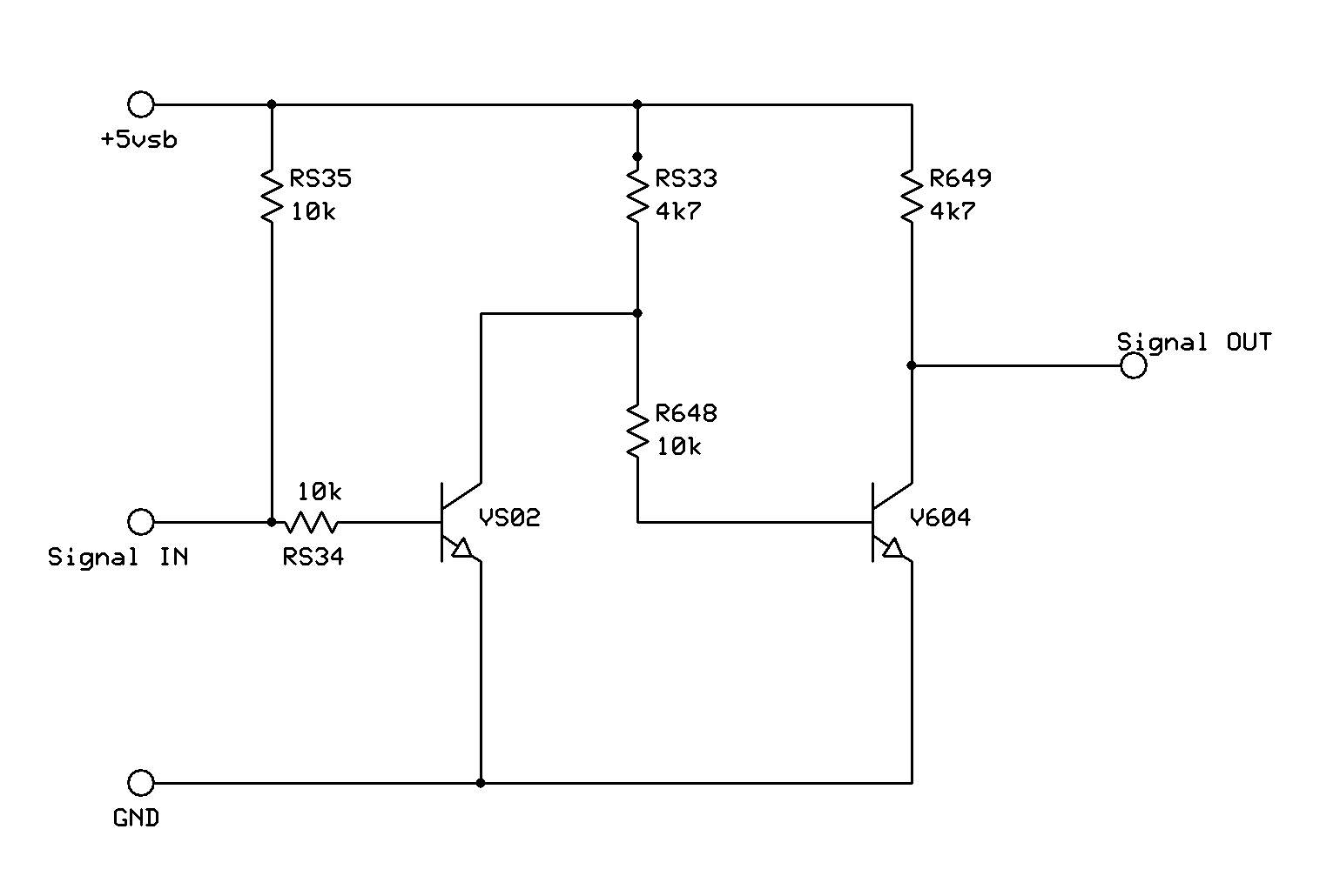

                Let me try to draw out the circuit.
                Muh-soggy-knee
                  Re: 32" Dynex DXL3210A Won't Power On
                  Ok!
                  Here is the circuit I drew, and it was exactly as I thought it might be, a buffer circuit xD
                  Muh-soggy-knee
                      Originally posted by tieny View Post
                      Nice, I wish I knew more about circuits though
                      When the input is high, or '1', a current (limited by RS34) flows through VS02's base to its emitter, then to ground. That causes the transistor to turn on and let current flow through its collector to its emitter, then to ground. However, the current is limited by RS33, and the voltage at VS02's collector is about 0.7v. That 0.7v is considered a low state, or '0'.
                      When the input is low, no current flows through VS02's base, and so it does not turn on. Because of the resistor - RS33 - going from the 5v bus to VS02's collector; and because VS02 is not conducting, there is no current flowing through RS33. That means there will be 0v across RS33, so VS02's collector will be at the 5v potential, or 'high'. (This is assuming that there is NO current flowing towards R648 - the output of the inverter. If there is current flowing through the inverter's output, then there would be a voltage drop across RS33. How much voltage (V) is dependent on the current (I) and the resistance (R). You can calculate the voltage drop by using ohms law, V=IR)
                      And so there is another inverter made up out of R648, V604 and R649. The two inverters in series make up a circuit know as a buffer. The wiki page will explain more about why they are used.
                      Hope I didn't overload your brain! :P
                          That is what I thought the output of the processor will be, which is usually active high, so just think of the two transistors as switches. When the output of processor is sitting at '0' (which it should be normally when the TV is OFF) the first transistor is turn off which will cause the second transistor to turn on, so the output (PSON) will be lo, when the processor wakes up and its output goes HI, then the first transistor will turn ON, which will cause the second transistor to turn OFF which causes its out put to be HI (PSON = HI = 12V/24V power supply section turns on. Simple.
                          Now we just need to find out what is the logic level of the processor out put is when the TV is OFF.
