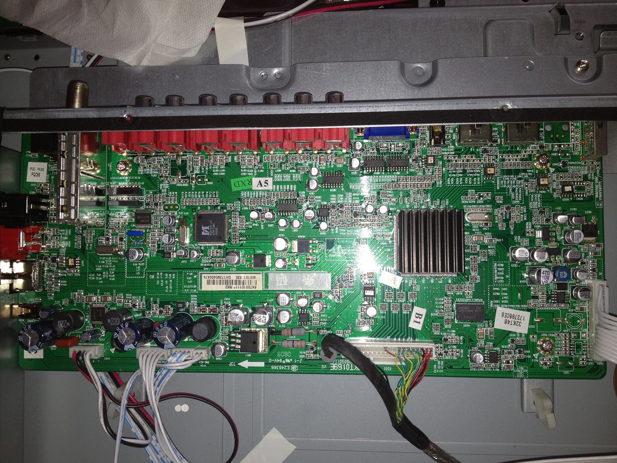

    I have a 32" Dynex, model number dxl3210a, that seems to be stuck on standby. The red standby light is on however nothing happens when I press the power button to turn on the TV. Opened the back don't see any blown caps and checked the fuses already. Would the power supply board be of suspect?

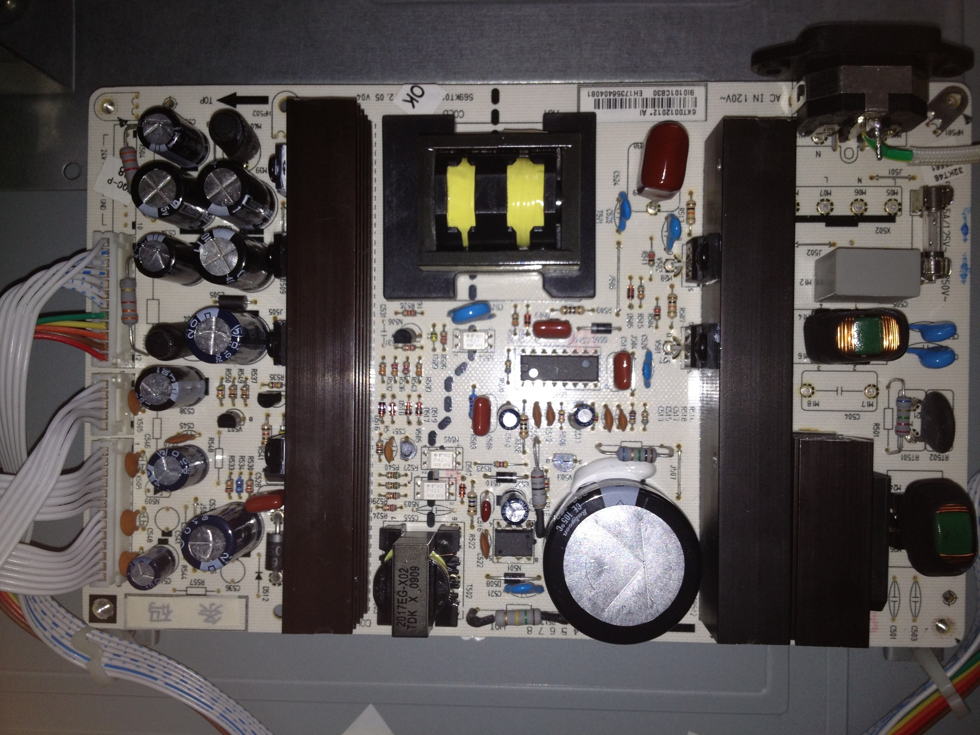

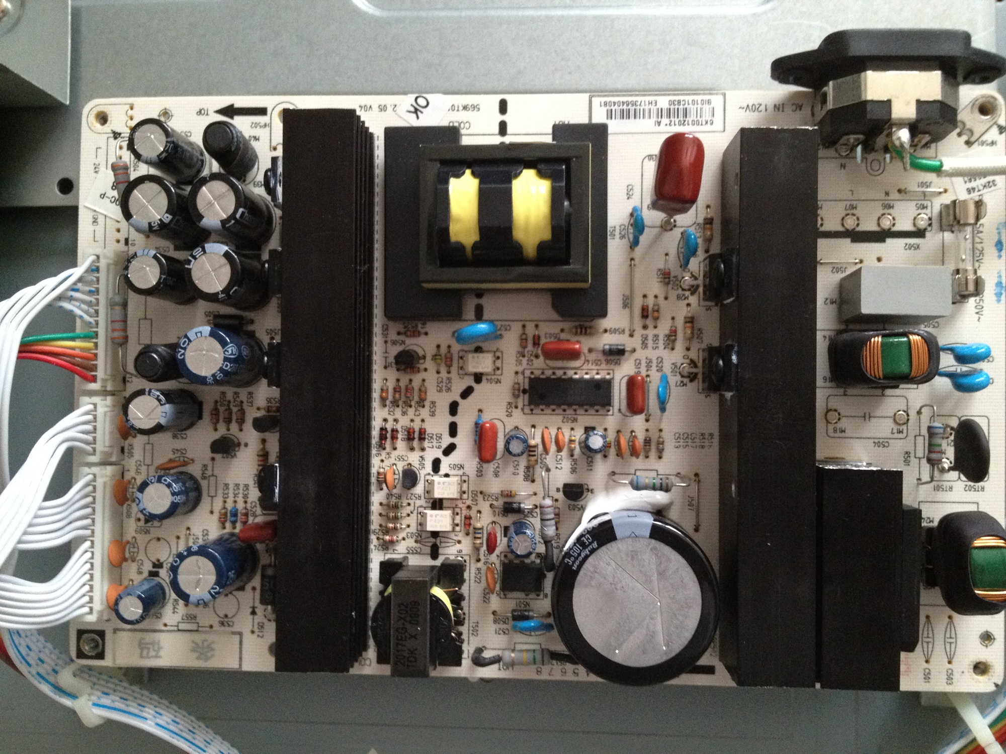

    Re: 32" Dynex DXL3210A Won't Power On

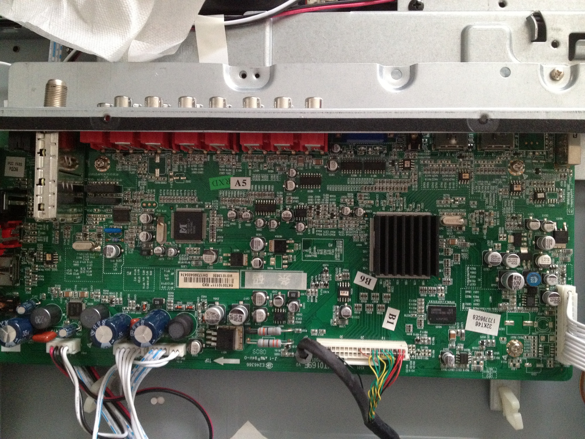

    if you get a standby light I would suspect the main board has a issue. Btw what is that gunk below rf6 cf5?

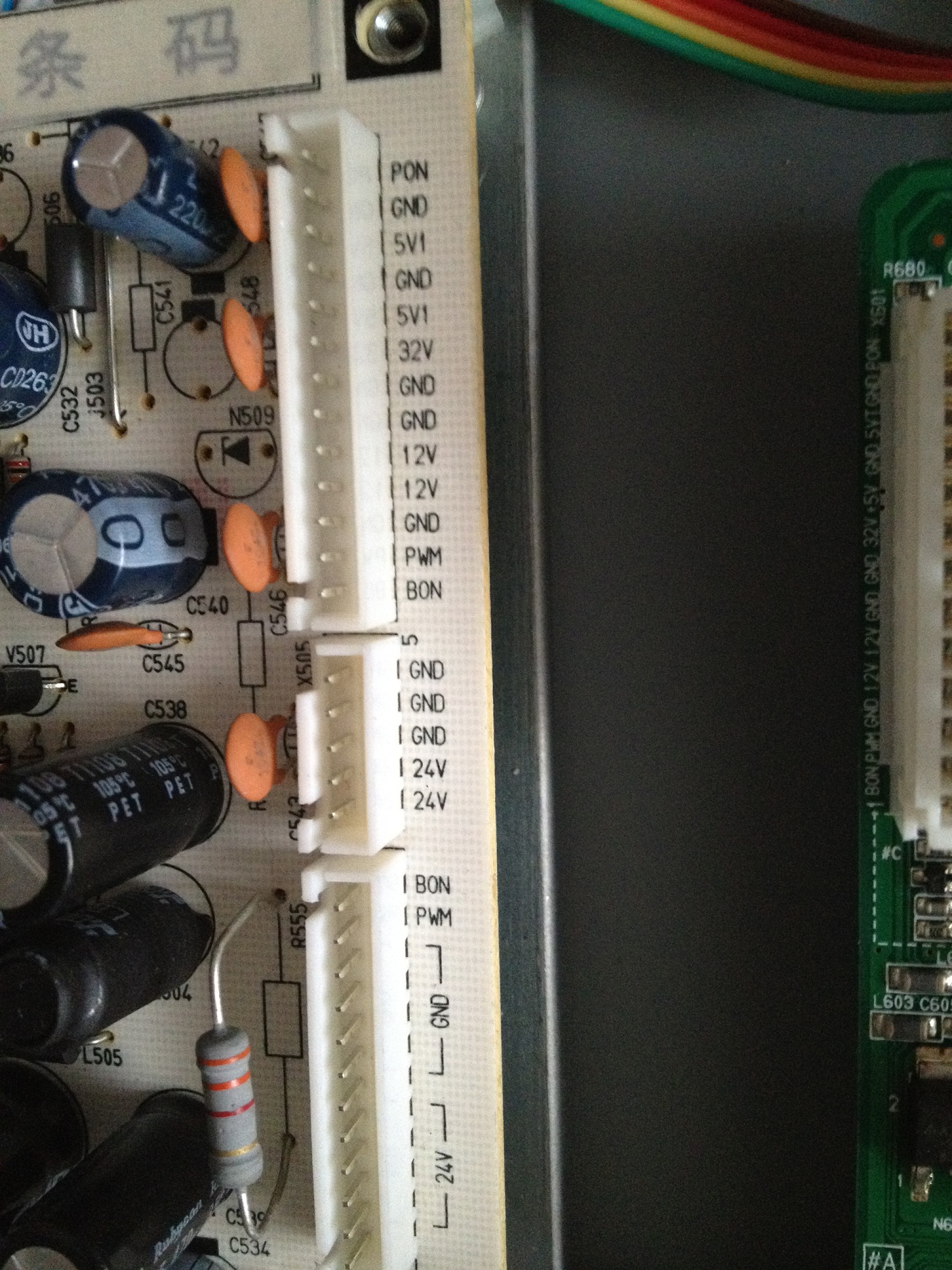

      Are the connectors on the power supply labelled?
      Loving the imitation Elna vents on the crappy JH caps...!

        I count 6 voltage regulators on the main board. Check them all to make sure they are in spec.
          Hmm, that gunk seems to be a blob of solder.
          Yes the connectors are labeled, photo is below.
          I measured a few voltage regulators, I feel some of these seem odd but I'm not sure.
          N604
          8JH 1117H
          pin1-0.58v
          pin2-1.84v
          pin3-3.32v
          N602
          8JH 1117H
          pin1-2.07v
          pin2-3.32v
          pin3-5.31v
          N611 (Largest one)
          AZI0845 ADJEI 829J43
          pin1-3.84v
          pin2-5.11v
          pin3-8.36v
            What is the voltage on pin 5V1?
            • tieny
              • Feb 2012
              • 478
              There are two pins that are labeled 5V1. The higher pin reads 5.32V but the lower pin gives me a reading of 0V.
                Okay that suggests good standby power but no run power. Do PON or lower 5V1 vary at all when you press the power button?

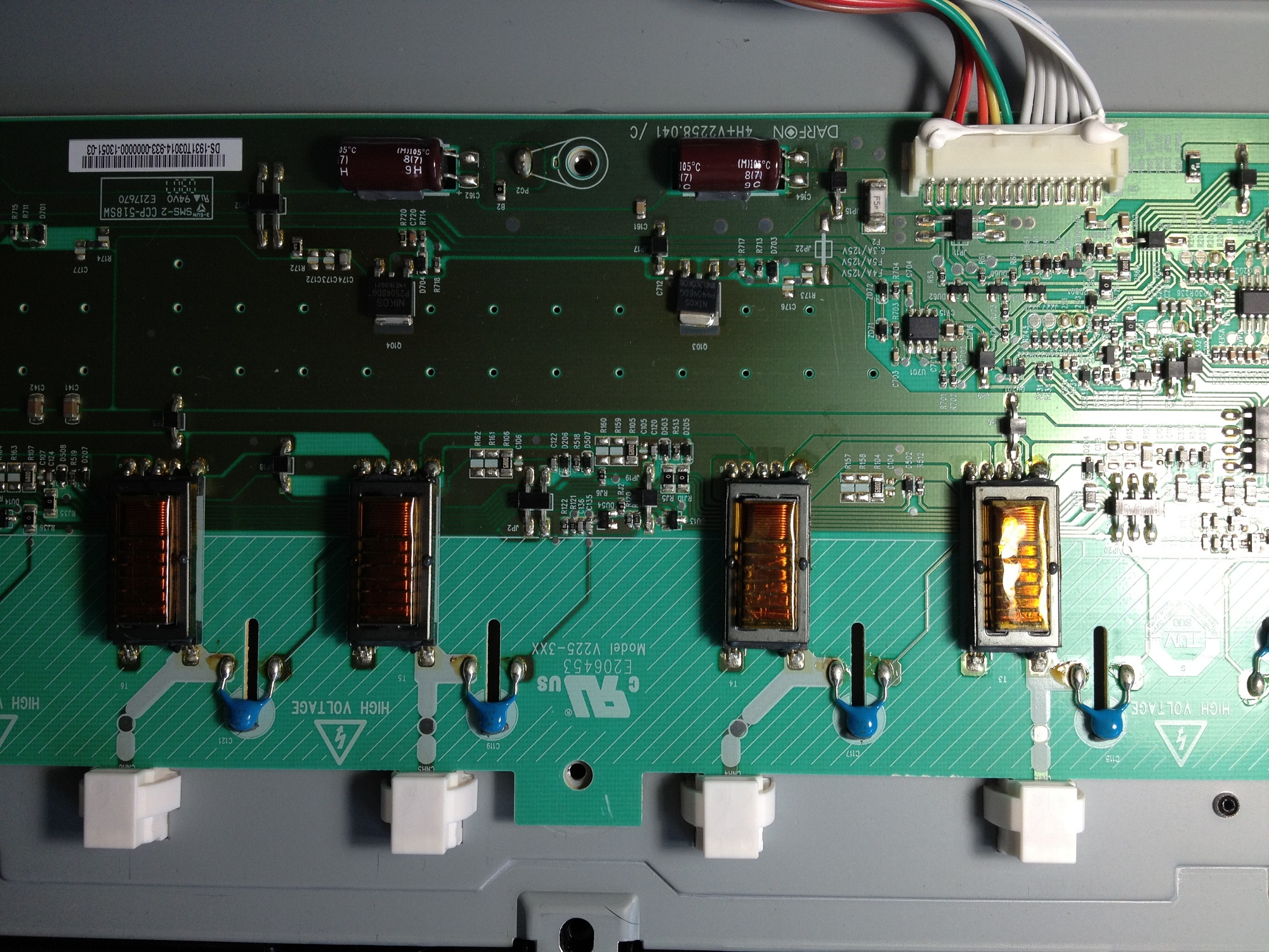

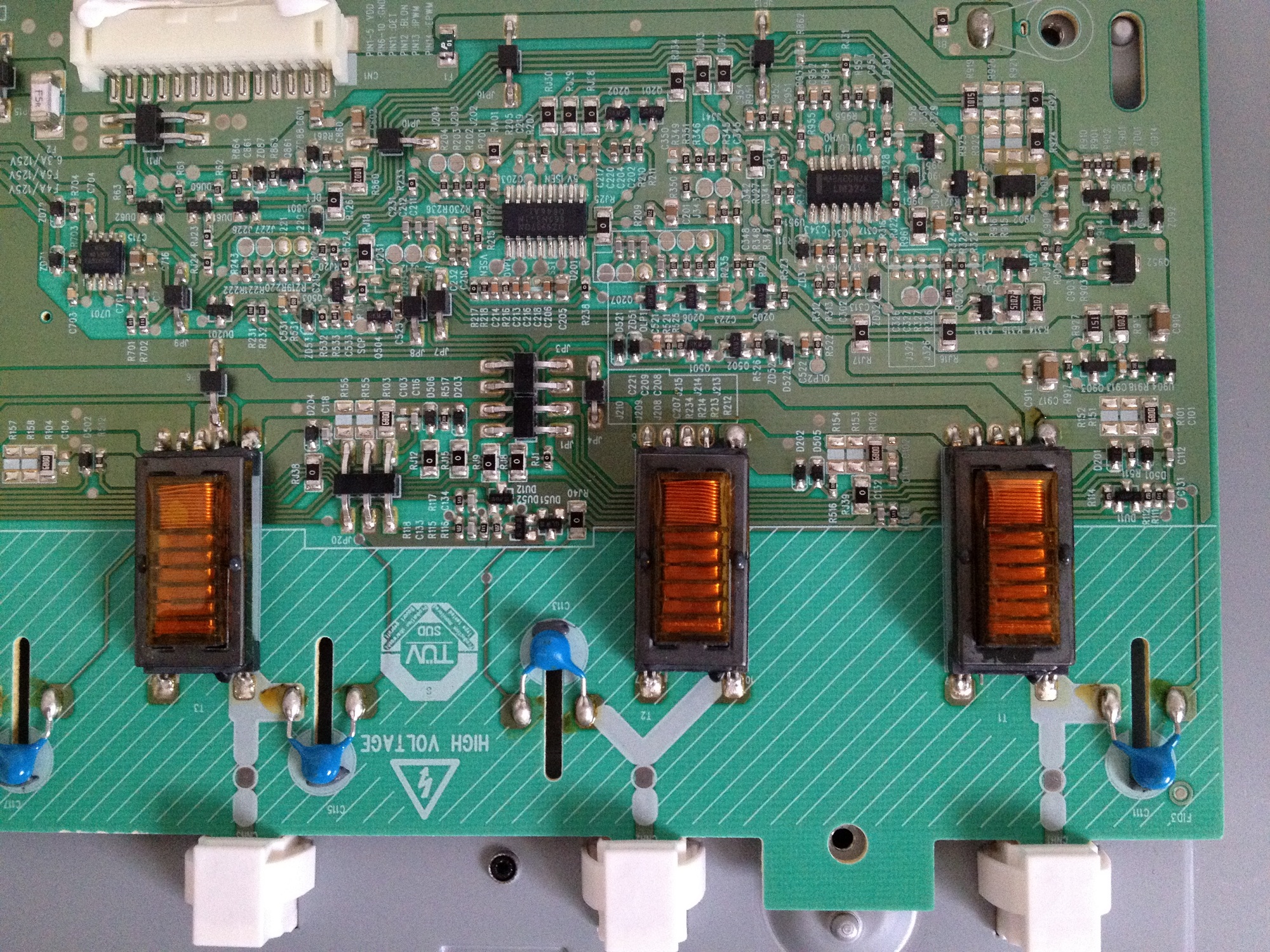

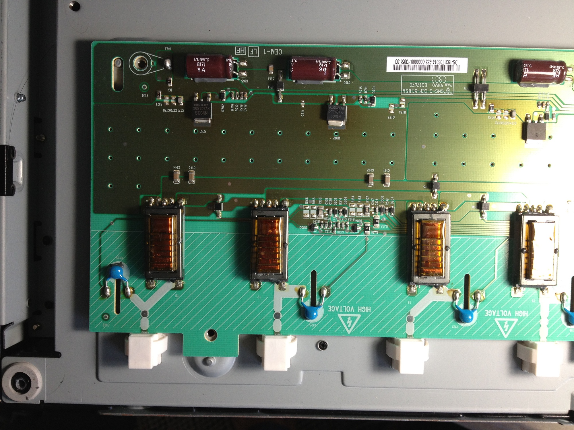

                                        Photos of the inverter board, So far only checked the fuse, but it doesn't seem open. Also I'm about to buy an ESR/Capacitance meter, any suggestions or recommendations?
