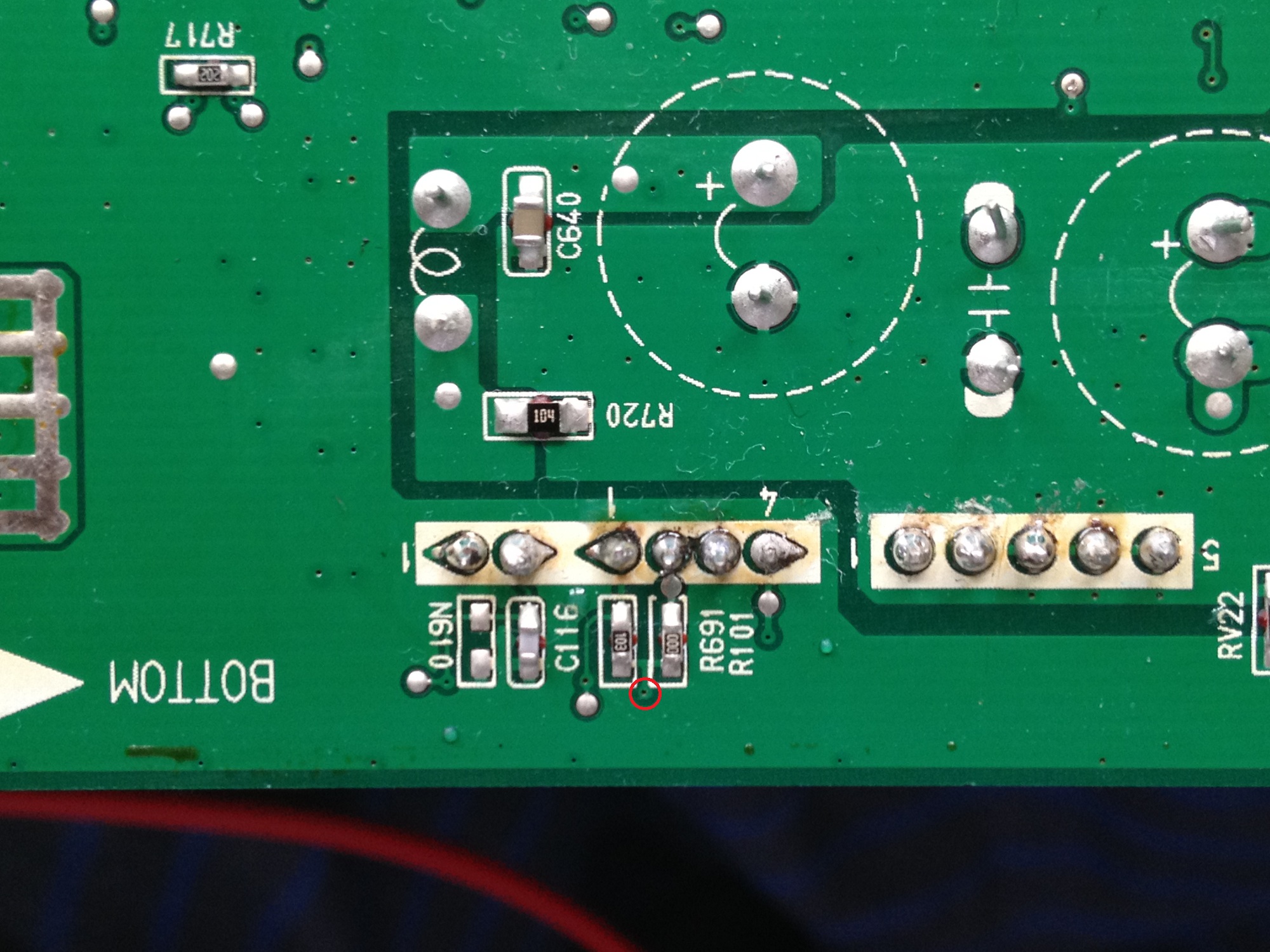

            #65
            Re: 32" Dynex DXL3210A Won't Power On
            Originally posted by tieny
            I tried tracing the pin back to any connecting components using the continuity function on my multimeter but i couldnt seem to find any before. Ill give it another try once i get home. Theres a closeup photo of the pin and nearby components in post 59 if you have any suggestions.
            The picture is on the wrong side of the connector though, I cant see where any of the traces go. It seems like the P_ON goes to an empty spot where a chip should be. Not saying the chip should be there though, some models exclude certain circuits, so they leave the component spaces blank.
            And Im not talking about taking a picture on the back side of the board, there are no traces there to track from one of your other photos.

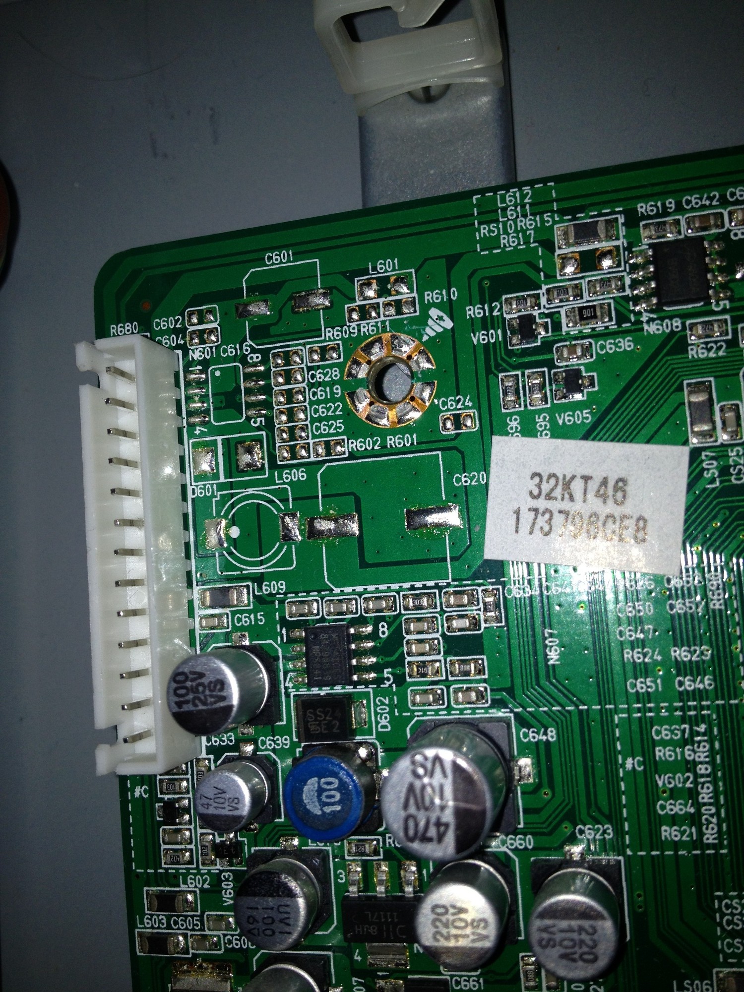

              #66
              Heres a better picture of the connector.
              • ben7
                Capaholic
                • Jan 2011
                • 4059
                #67
                See the resistor marked R680 next to the header?
                Which pin of the resistor is connected to the P_ON pin?

                  #68
                  Measuring from the P_ON pin and the resistor (Red probe on P_ON and black probe on the resistors pin), I get 4.72 ohms on the left side and 5.36 ohms on the right.
                  • ben7
                    Capaholic
                    • Jan 2011
                    • 4059
                    #69
                    Hm. What number is written on the resistor?

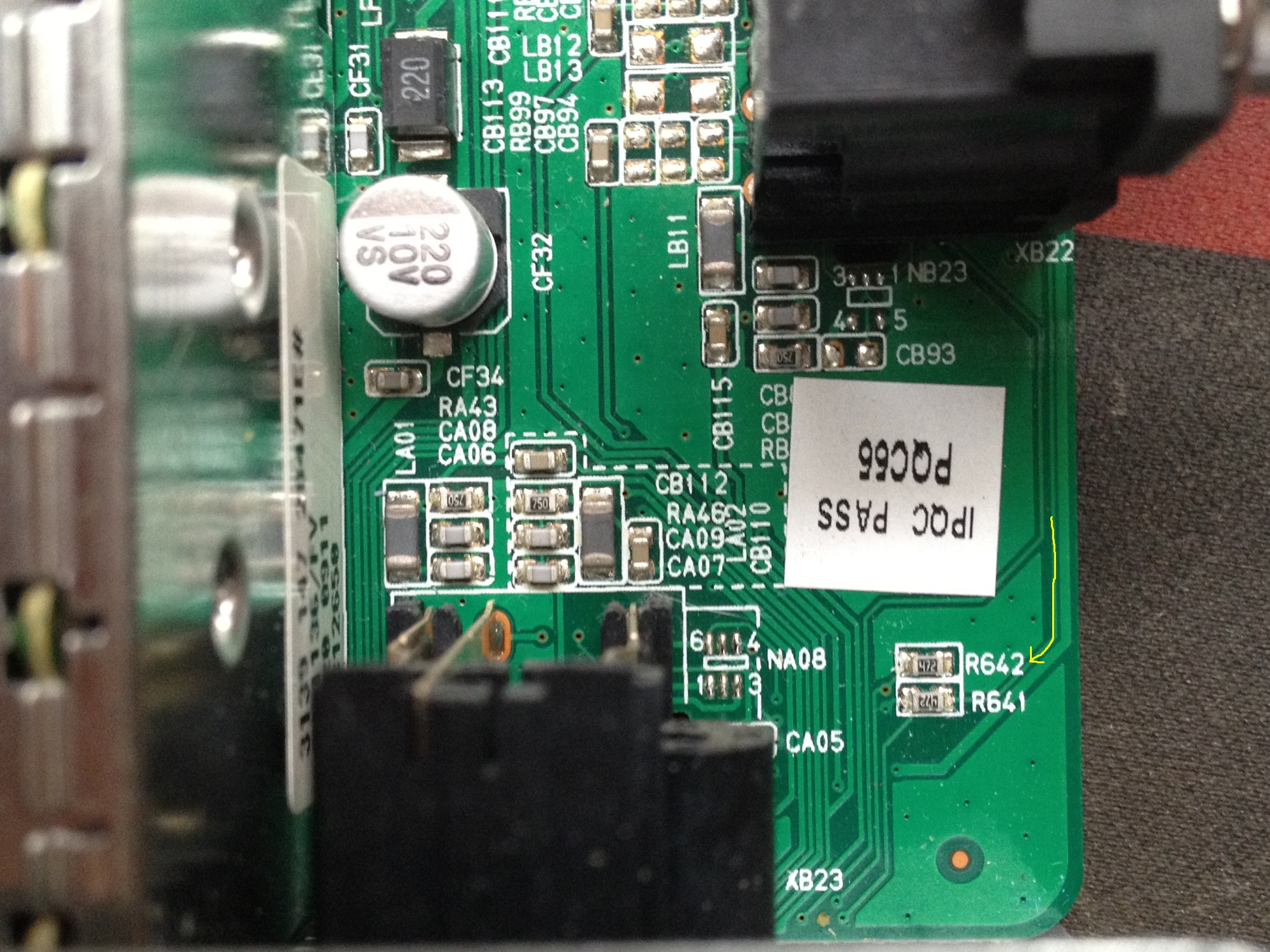

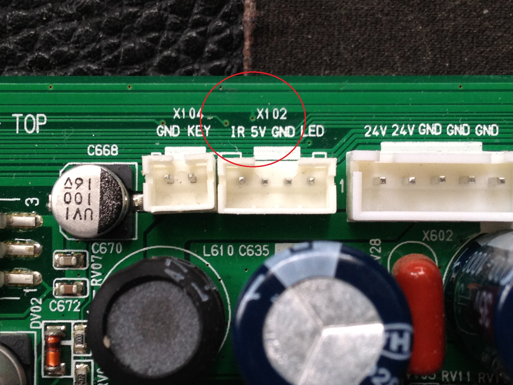

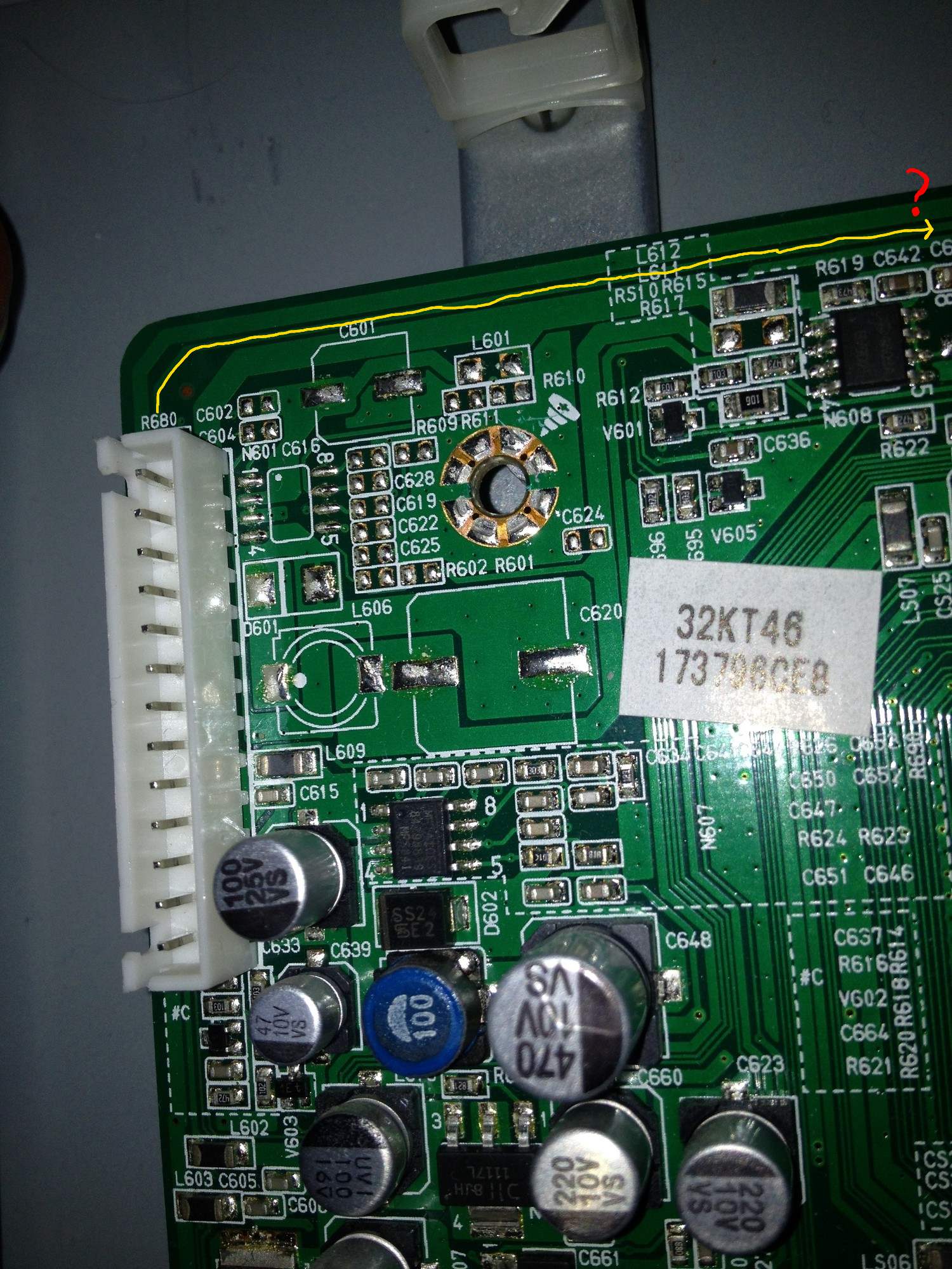

                          #72
                          Where and what does this trace lead to? (marked in yellow)
                          Muh-soggy-knee
                          • tieny
                            • Feb 2012
                            • 478
                            #73
                            It leads to X102 and to the back of the main board to some resistors connected to the 5V pin. Following the trace leds to a dead end.

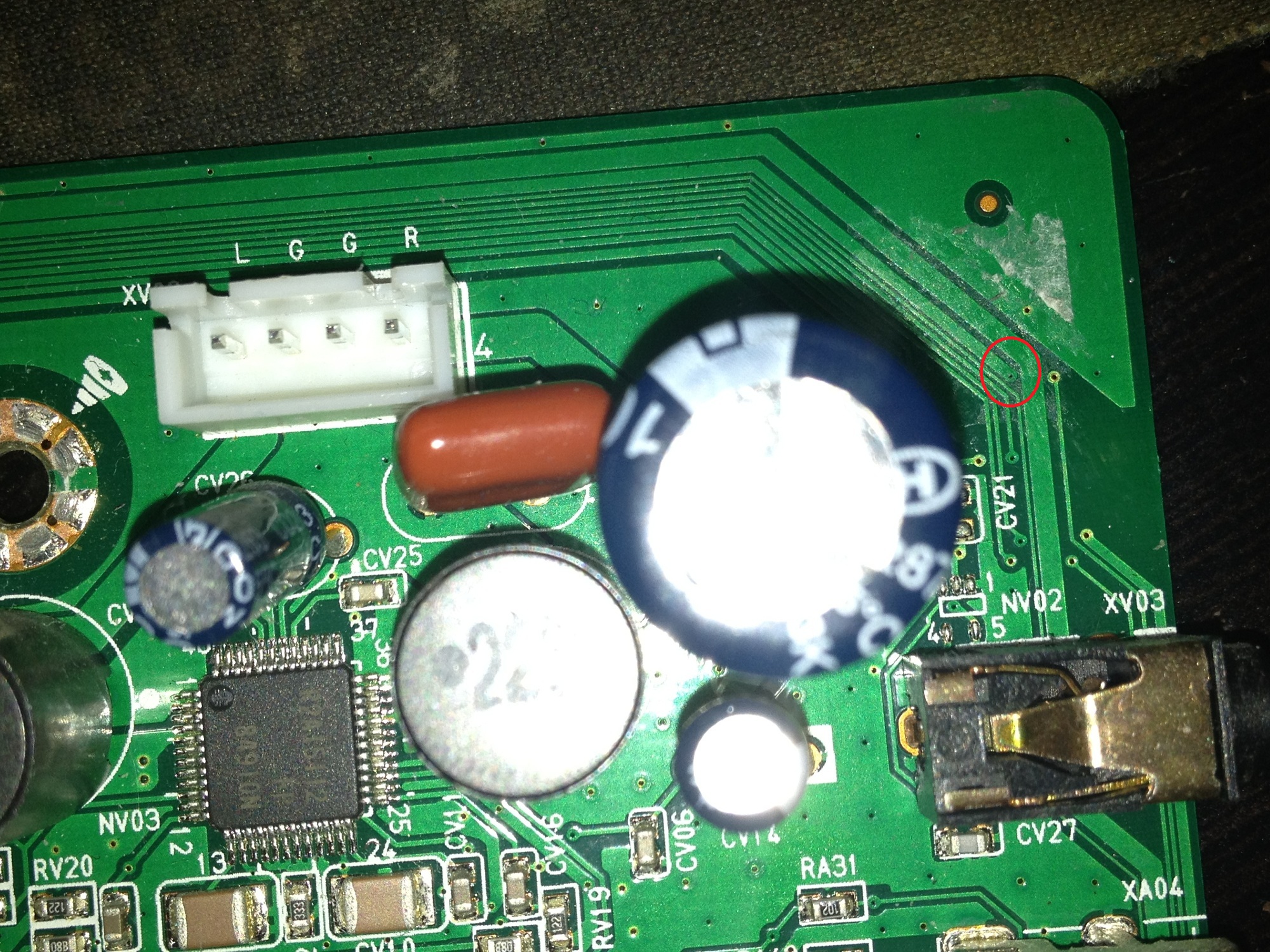

                              #74
                              in the third pic, what does the trace goto on the other side?
                              Muh-soggy-knee
                              • tieny
                                • Feb 2012
                                • 478
                                #75
                                actually my mistakes it continues to follow to more resistors.
                                • ben7
                                  Capaholic
                                  • Jan 2011
                                  • 4059
                                  #76
                                  Hm, and where do those go? Is there a chip on the bottom of the board?

                                    #77
                                    Nope there doesnt seem to be a chip near there on the bottom.

                                        #79
                                        yeah this is the problem I mentioned in post 64, having trouble trying to figure out where the P_ON trace leads

                                          #80
                                          Yep I know.
                                          If you want you can do the random probing technique, probing pins, components , around the connector. See if you can find anything that has continuity to the P_ON pin.
                                          The only other thing I can think of is that it goes under the plastic connector, on the left side and down to something else, or it goes to a trace in one of the intermediate layers of the board.
