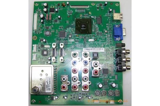

    I can barely make it out, it reads: (the one i suggested to chalk)
    12G
    25L3205DM2I
    2Y305600
    TAIWAN
    a083536

        Heres the other two chips,
          Re: 32" Dynex DXL3210A Won't Power On
          The first one is a MP1410es.
          The second one is a Renesas R2A15112 audio amplifier chip.
          I was wrong about the maxim chip, im not sure what model that one is.
          Muh-soggy-knee

            Can you please take a picture of the back of this area?

                  Heres the back of the area you asked for.

                              Tieny- Couple of things - on the back of the board just above the connector it says C813 but whaterever is next to it looks a bit odd - what is it?
                              The other thing is are ther any part numbers on the very small ics V601 V605.
                              And another time consuming idea, if you have another board the same you could just work through them both checking every component for shorts or differences in resistance.(Well I did say it was time consuming)

                                Tieny:
                                Measure the voltage across capacitor 648 (470uf 16v) near the power connector.

                                  Ill take a look at components V601 and V605 once i get home. I would try that time consuming method if i did have anothet board to work with.
                                  C648 is that the smd cap labeled, 470 10V VS? Measuring across the cap means red probe on positive and black probe on negative correct?

                                      For that cap, I get 1.31V
                                        Ok, thats just about right.
                                        R624 (10k-ohm) and R629 (81-ohm) make up the feedback voltage divider.
                                        Tieny, have you tried to shine a bright flashlight into the screen, to see if the pixels are lighting up? Im just wondering, maybe its not telling the backlight to turn on?
