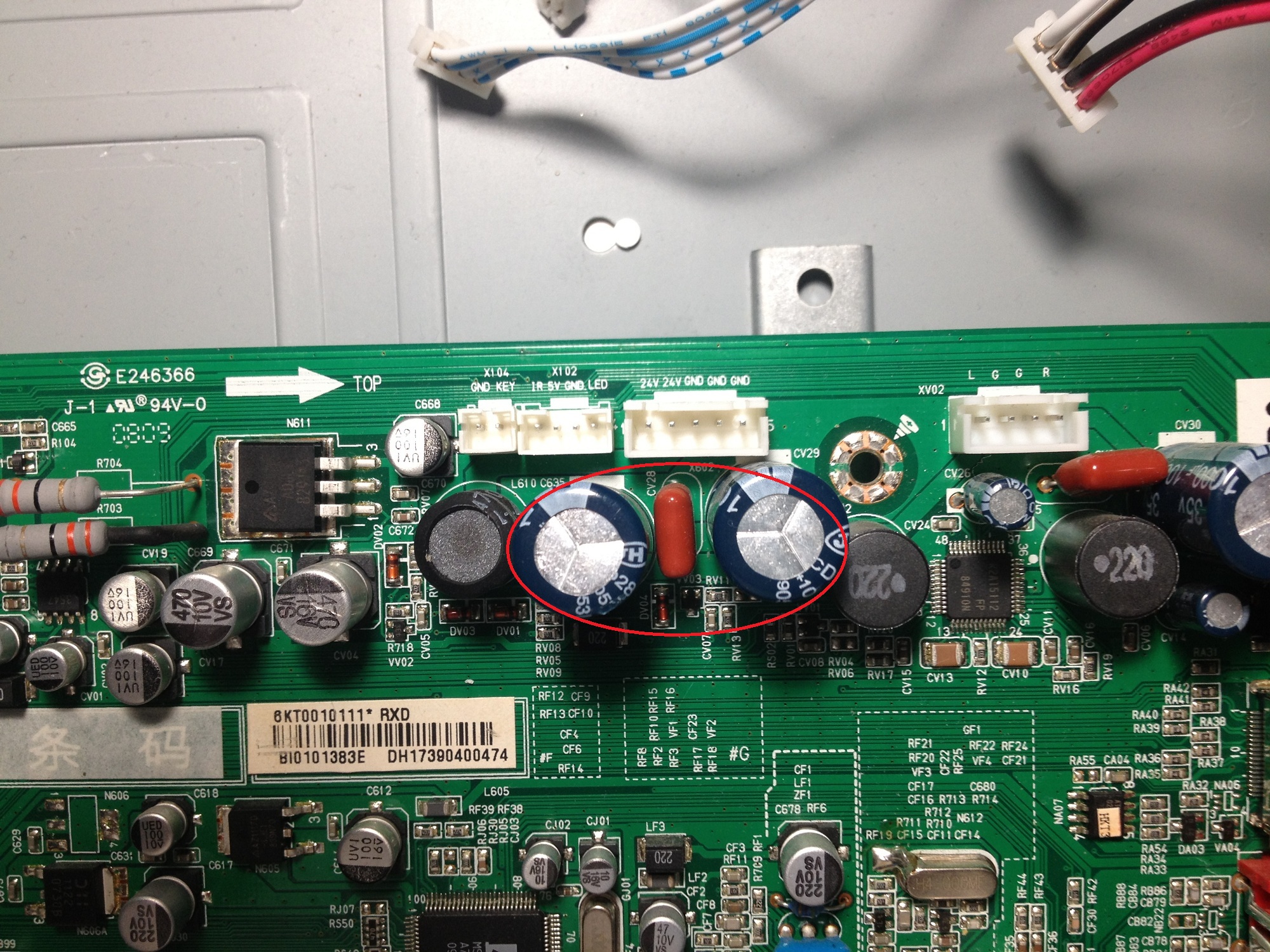

      Re: 32" Dynex DXL3210A Won't Power On
      Doesn't seem like the pixel are on at all. I not sure which input the TV is even on, the last time it worked it was on HDMI so i used that input but I can't see any movement what so ever.
        I know it sounds crazy, but get a hairdryer and heat up the board, just not too hot to touch though. And then see if it will work. Sometimes chips and capacitors have a bad habit of not working when cool.
          Any area of the board in particular? I have a heat gun from one of my last projects when i was trying to reflow a chip, but it didn't end well when it accidentally blew up an SMD capacitor right next to it (actually exploded) .
            Any area of the board in particular? I have a heat gun from one of my last projects when i was trying to reflow a chip, but it didn't end well when it accidentally blew up an SMD capacitor right next to it .
            Id use a hair dryer, and don't put it right up to the board, or you will overheat stuff. Check the temp of things too to make sure they don't get too hot. Do it over the whole board, starting in one area and moving around the rest of the board.
              Hmm, I think it worked! Well for a second, I was pressing the power button while warming up e board, and the red LeD turn blue for a second but back to red o.o

                      #190
                      I'm not sure, I'm using my heat gun about half a foot away from the board. I warmed the right side, then the left side but no luck so I just warmed the whole board in general and thats when it turned blue.
                      What kind of problem would this mean?

                        #191
                        huh Have you tried tapping the board with a pencil eraser? You either have a bad capacitor, IC, or a bad solder joint.

                          #192
                          What do you mean tapping it with a pencil eraser?
                            Tap the board with the end of a pencil which has an eraser on it, the eraser is soft so you wont damage anything.
                            This is just a vibration test basically. Bad solder joints will connect/disconnect when heated, cooled, and vibrated.
                              I tried tapping the main board while repeatedly pressing the power button but no luck. I tried the heat gun again but I can't simulate what happened like before, I guess it was just luck.
                                How hot did you heat it up? Like just barely warm? Just don't heat it up anymore than you can tolerate on your skin. (Don't want to boil the water in the capacitors :P)
                                  It was hot enough where it would tingle my finger when touched but not so hot that it would burn the skin i think.
                                    Well, idk what to check next.
                                      I noticed that these caps feel particularly warm after I let the board cool down for a good amount of time after I heated it.
                                        If you have extra caps on hand you can try changing them.
                                        I think they may just be warm because they have a larger mass and so they hold the heat longer.
                                        Of course though, bad capacitors will get warm, so they might be bad (JH is crap, if you fix this I'd recommend replacing all JH caps) after all.
                                          Well, I measured the 3 caps 1000uf 35V out of circuit, and all have ESR of 0.04 ohms or less, 989.5uf, 1002 uf, and 1034 uf
