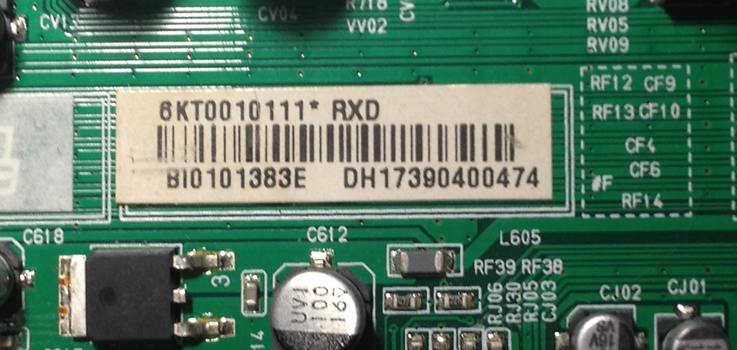

    The main thing is that you have to match the number as printed on the white barcode sticker.

      #122
      Re: 32" Dynex DXL3210A Won't Power On
      Which numbers?

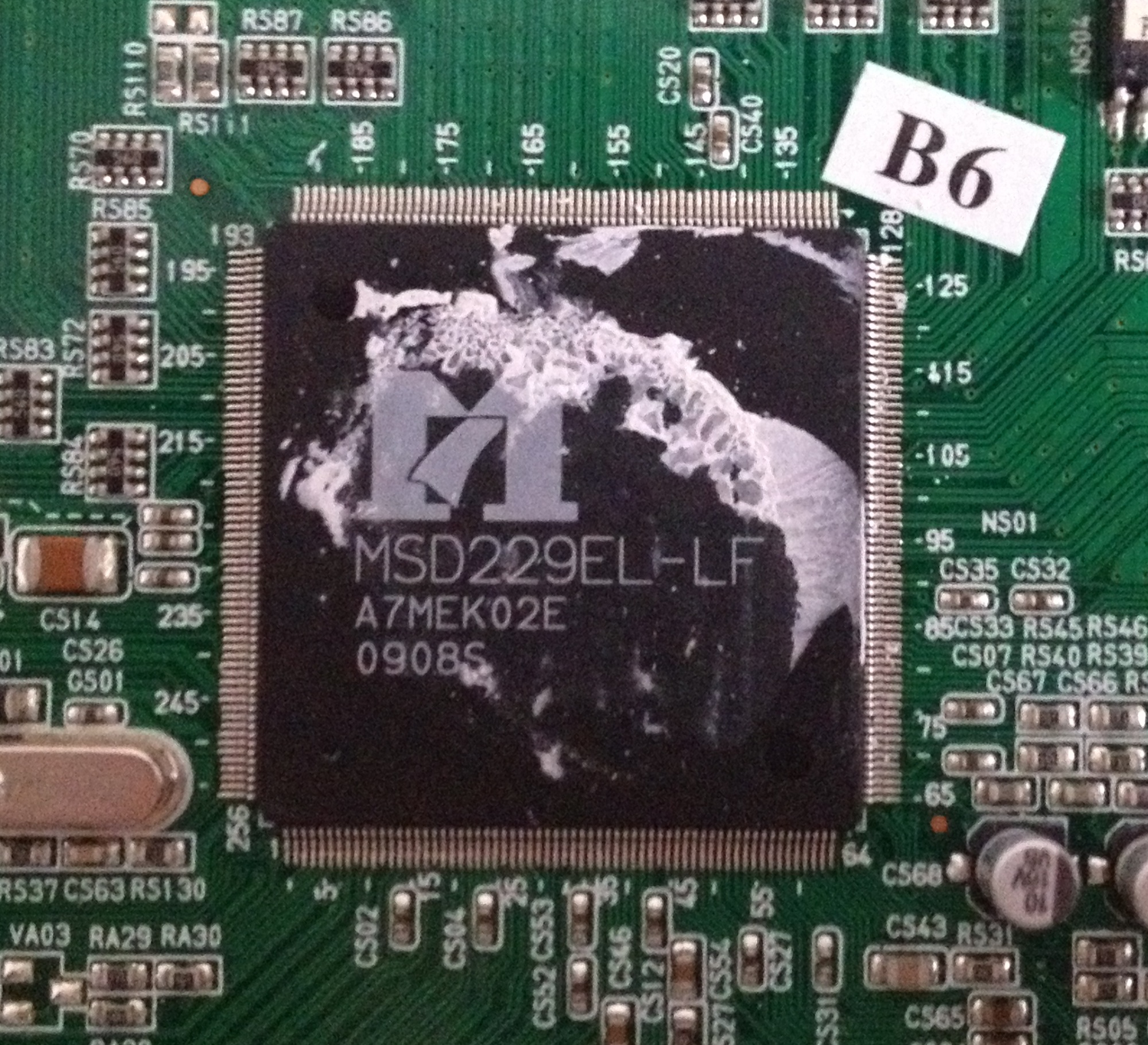

              Tieny, measure the voltage at the top end of RS34, it seems normal for the base to be about 0.65v, because RS34 limits the current. I'd expect it to be somewhere around 2-3v.
              I suggested finding the processor model, so we could find the pins for it's Vcc (+V bus), and measure those.
                The top end measures 1.99V. Right now I'm having some difficultly removing the heat sink from the chip

                  #128
                  Perhaps we can find a datasheet on this board, that might list the model of the processor, and give its pinouts.

                    #129
                    Heres the model

                      #130
                      Heres the model
                      I cant find anything about that chip.
                      all I know is its made by MStar.
                      Their useless website:
                      http://www.mstarsemi.com/index.php
                      They do have a contact though, you might have to contact them to get the datasheet.
                      We need the more advanced forum members to help us find this.

                              #134
                              Well, I just sent an email to their contact address. If it is repairable, what kind of soldering job would I have to expect?
                              If the chip is bad, I would say you need to get a new board.
                              If the chip is not getting enough voltage, we will have to see if there is some sort of small voltage regulator on the board.
                              Im kind of wondering if the chip is powered by the 5v-standby all the time, or only when the TV is off. If so, maybe there is some sort of controller/power router circuit that is dud.
