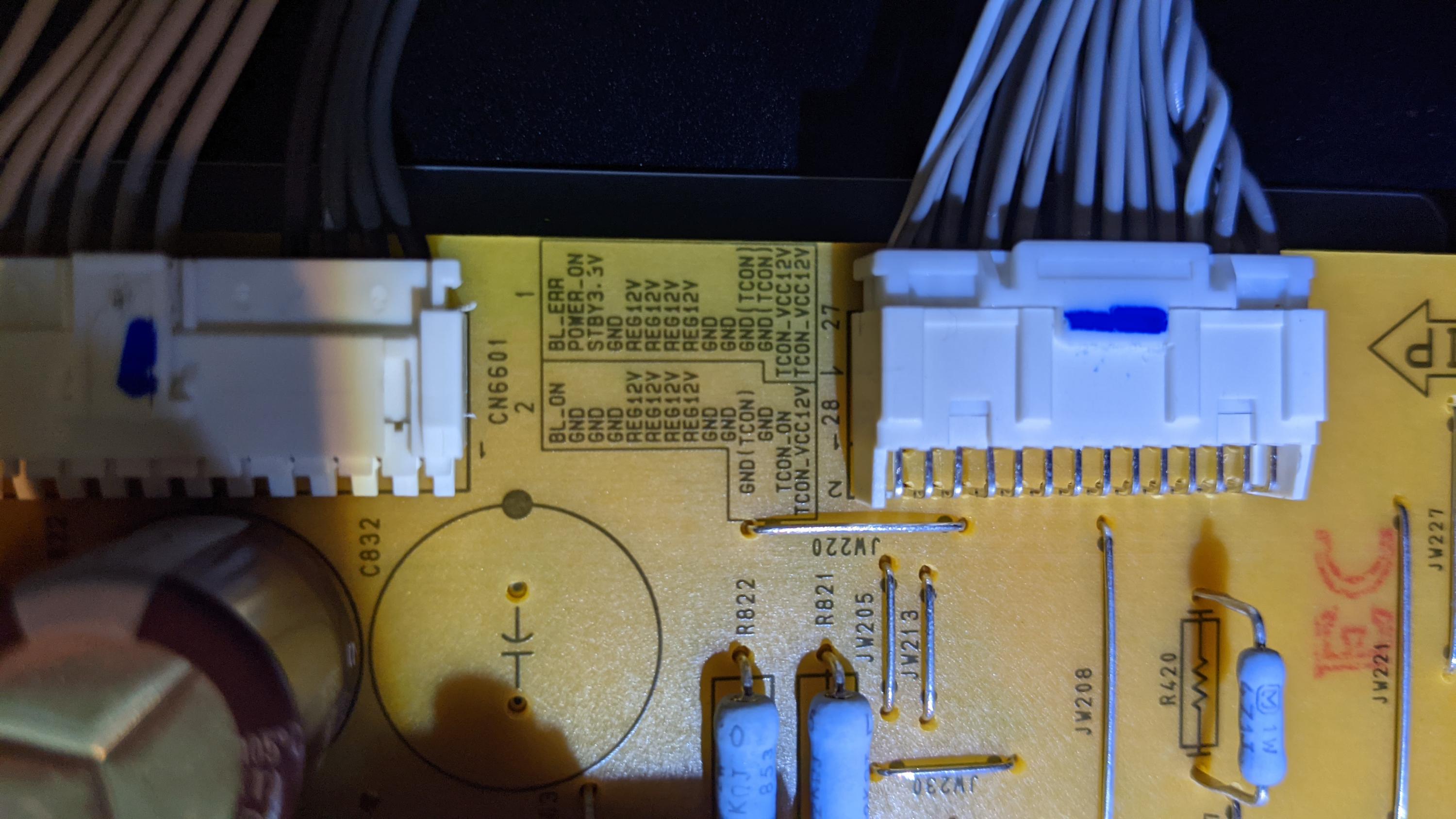

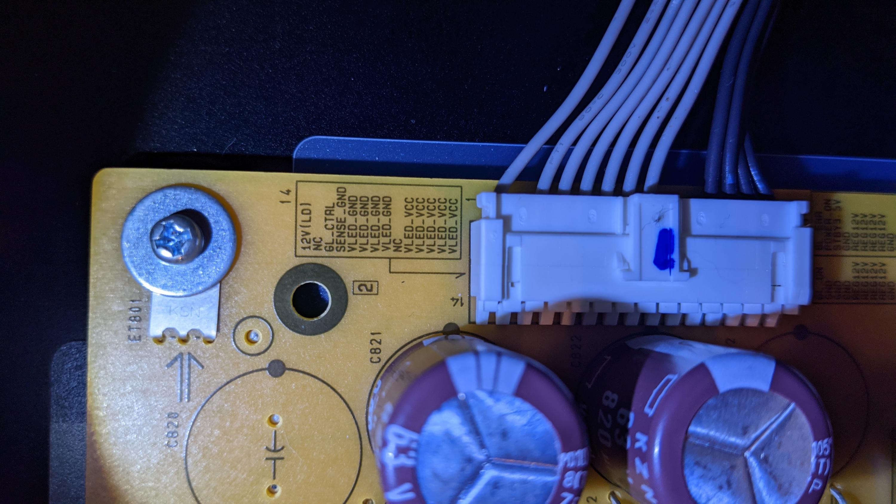

    Can you post photos of the legend along side the two connectors and also what voltages do you have on those connectors?
    Connector xxx
    Pin 1 Name Volts
    Pin2 Name Volts
    Etc

      You can't go by the led on the front, on some TV's (some Sony's) the led comes on to indicate the tv is ON. and the led is OFF in standby.
      CN6401 has two rows of pins, make sure you are checking the correct pin for POWER_ON (it's pin9) so you can't access it from the top of the board.
      Since you have STBY 3.3v I suspect the problem is on the main board.

        LD Board Connector
        CN6601
        Pin 01 "12V(LD)": 12.74V
        Pin 02 - N/C
        Pin 03 "GL_CTRL": 0.001V
        Pin 04 "SENSE_GND": 0.001V
        Pin 05 "VLED_GND": 0.001V
        Pin 06 "VLED_GND": 0.001V
        Pin 07 "VLED_GND": 0.001V
        Pin 08 "VLED_GND": 0.001V
        Pin 09 - N/C
        Pin 10 "VLED_VCC": N/C
        Pin 11 "VLED_VCC": 0.001V
        Pin 12 "VLED_VCC": 0.001V
        Pin 13 "VLED_VCC": 0.001V
        Pin 14 "VLED_VCC": 0.001V
        Main Board Connector
        CN6401
        Pin 01 "BL_ERR": 0.036V
        Pin 02 "BL_ON": 0.002V
        Pin 03 "POWER_ON": 3.472V
        Pin 04 "GND": N/C
        Pin 05 "STBY 3.3V": 3.505V
        Pin 06 "GND": N/C
        Pin 07 "GND": 0.001V
        Pin 08 "GND": 0.001V
        Pin 09 "REG 12V": N/C
        Pin 10 "REG 12V": 12.75V
        Pin 11 "REG 12V": 12.75V
        Pin 12 "REG 12V": N/C
        Pin 13 "REG 12V": 12.75V
        Pin 14 "REG 12V": 12.75V
        Pin 15 "REG 12V": 12.75V
        Pin 16 "REG 12V": 12.75V
        Pin 17 "GND": 0.001V
        Pin 18 "GND": 0.001V
        Pin 19 "GND":0.001V
        Pin 20 "GND": 0.001V
        Pin 21 "GND(TCON)": N/C
        Pin 22 "GND(TCON)": 0.001V
        Pin 23 "GND(TCON)": 0.001V
        Pin 24 "GND": 0.000V
        Pin 25 "TCON_VCC12V": N/C
        Pin 26 "TCON_ON": 0.001V
        Pin 27 "TCON_VCC12V": -0.001V
        Pin 28 "TCON_VCC12V": -0.001V

                          When I jump BL_ON and POWER_ON to standby nlthe backlight does NOT turn on (as far as I can tell. Still a lot of daylight in the house)...
                          Pins with different voltages compared to most nea previously are as follows:
                          LD Board Connector
                          CN6601
                          Pin 01 "12V(LD)":12.75V
                          Pin 02 - N/C
                          Pin 03 "GL_CTRL":
                          Pin 04 "SENSE_GND":
                          Pin 05 "VLED_GND":
                          Pin 06 "VLED_GND":
                          Pin 07 "VLED_GND":
                          Pin 08 "VLED_GND":
                          Pin 09 N/C
                          Pin 11 "VLED_VCC": 25.72V
                          Pin 12 "VLED_VCC": 25.72V
                          Pin 13 "VLED_VCC": 25.72V
                          Pin 14 "VLED_VCC": 25.72V
