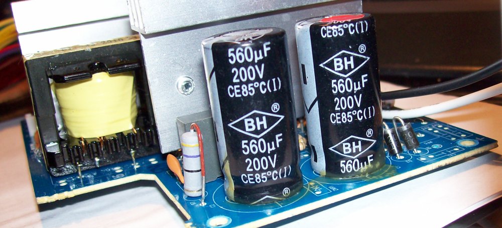

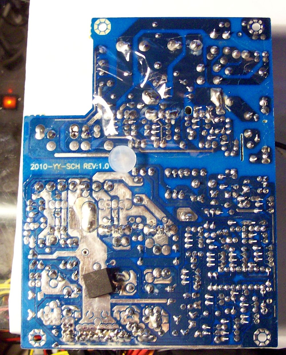

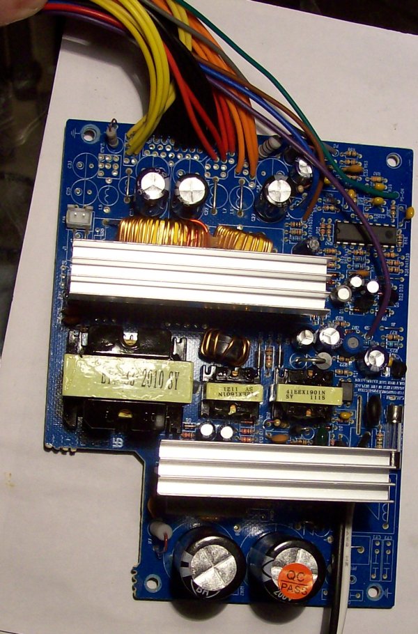

                                  I've looked into some brand new Kolink psus that came with oem cases. Amazing...
                                  One has no model number or anything the other is a Kolink CHS-450
                                  -no graetz bridge just four 2amp diodes
                                  -fake primary caps, real capacitance is 220uF
                                  -no brand 13007 switchers
                                  -2n60 fet for standy
                                  -fake, tiny el-33 trafo
                                  -label claims 5V-25A; 3.3-14A; 12-26A. Diodes are SB2045; SB1640; F1020
                                  -no pi filter, some secondary caps.
                                  -awg 20-22 wires
                                  Strangely one has some emi filtering and connectors instead just plain soldered wires.
                                  The pc cases are also horribly made, you can cut your fingers practically anywhere. The overall builld is paper thin mess.
                                  Avoid.

                                    #357
                                    Re: the gutless, bloated, and fried power supply hall of shame
                                    It's EI-33 not EL-33.
                                    One of the members here is a common victim of the reverse mistake.

                                          #360
                                          Originally posted by Behemot
                                          At least it does not have diode treatment for +12 V. That's progress, no?
                                          Of course, that's the 26 amps right there! And to think one of my coworker has got one of these to save some cash...
