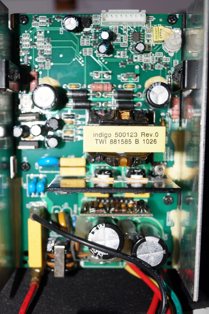

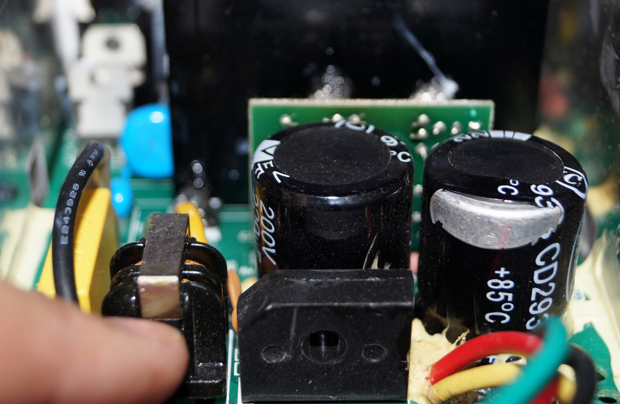

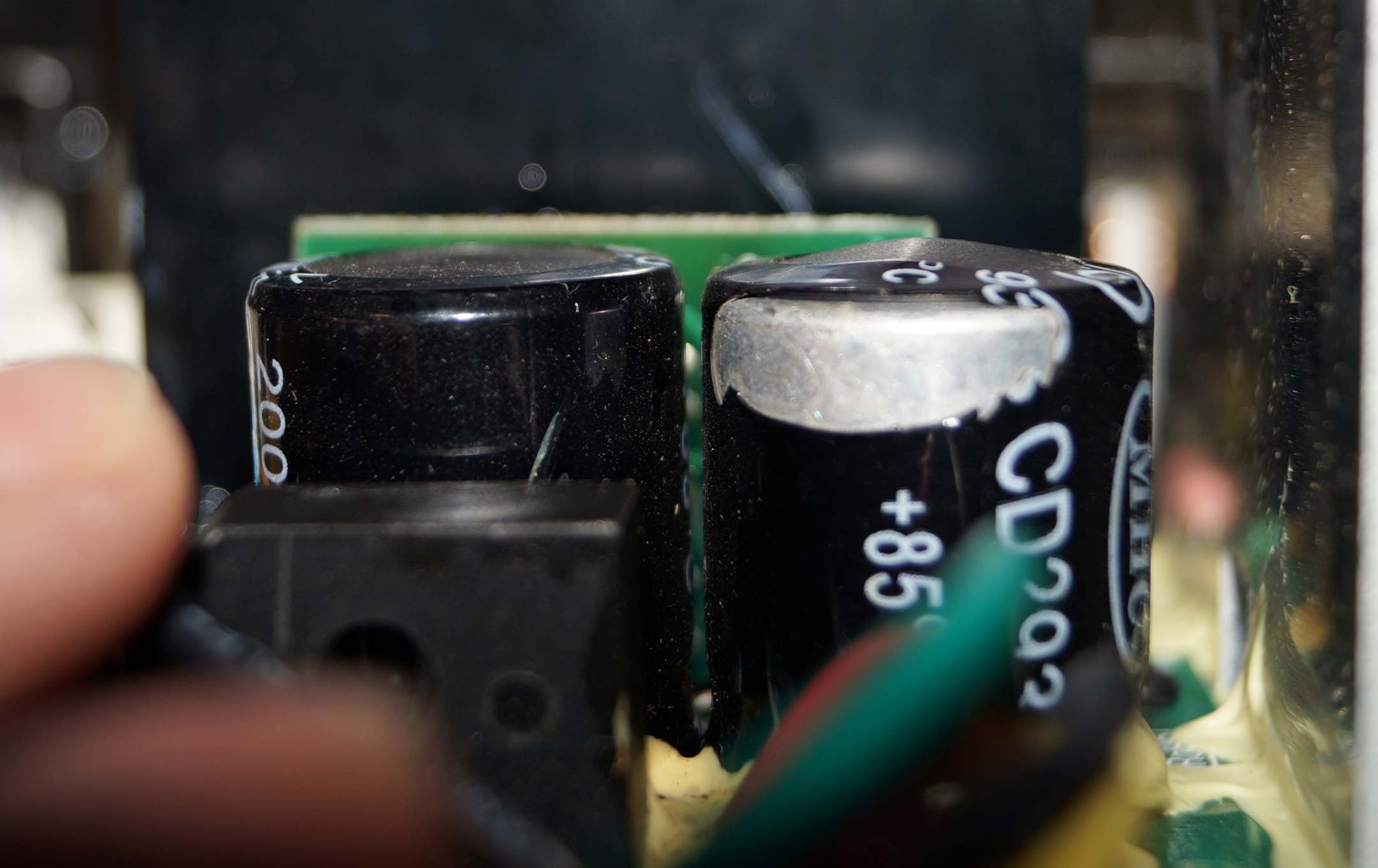

    Need to replace a blown main caps on the PSU board on the Focal subwoofer I'm working on.
    MHC 200v 220UF (CD293 85c) 22mm x 30mm (10mm Lead Spacing)
    http://uk.farnell.com/panasonic-elec...rad/dp/1673462
    http://uk.farnell.com/panasonic-elec...-in/dp/2357418
    Not replaced main caps before but assuming just like any other. Not sure if I need snap in type like the second link or if the first link with 7.5mm spacing will do. That seems to be better rated @ 105c?
    Or any other suggestions?

    Re: 200v 220uF Main Cap Replacement Advice?
    Either will work buddy
    • mikay786
      • Aug 2014
      • 765
      ordered the first one as diameter and ratings are better. Hopefully it works.

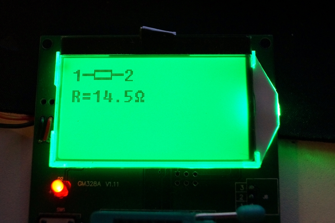

          Just testing stuff around the entry point and have a varistor 14n471k and a thermistor SCK104.
          The thermistor SCK104 is beeping on continuity test, is this normal or is it shorted? But is reading 14ohm at room temperature and does drop when heated.

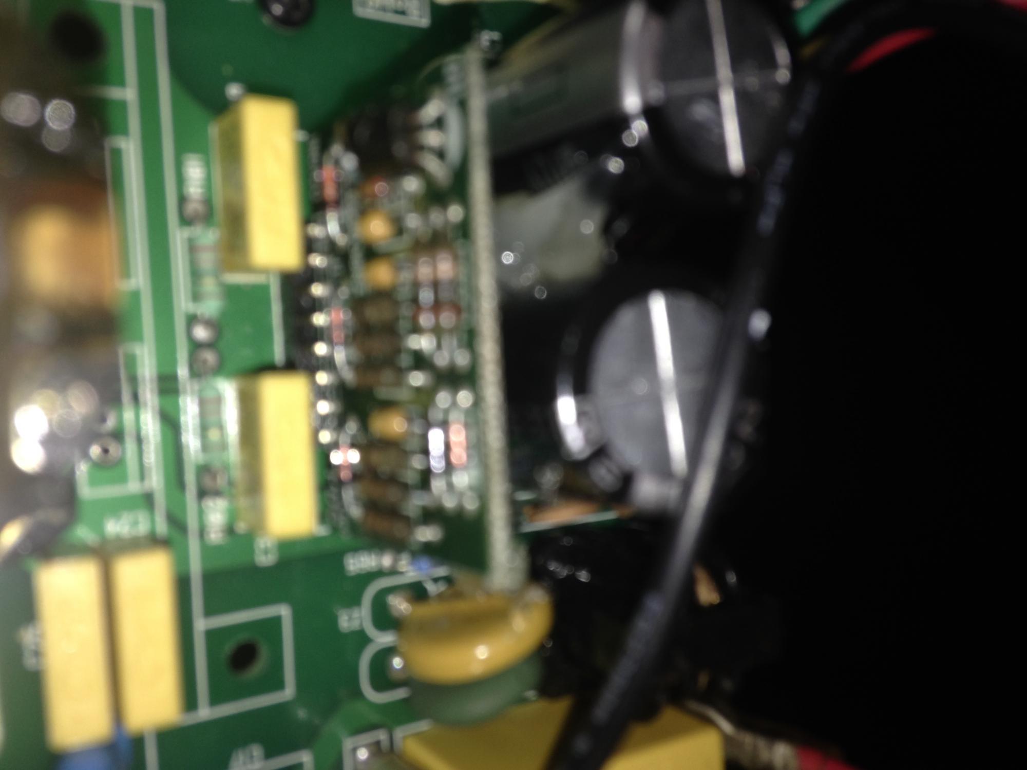

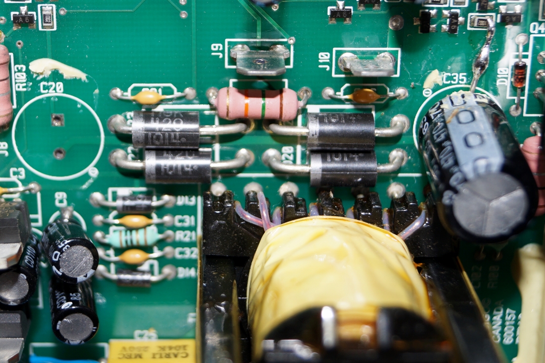

                Think ive found the problem. 4 x Mur 420 1014 Rectifier Diodes
                one of them doesn't read in either direction in diode mode and is shorted.
                Should I change all 4 or just the shorted one?
                  Replace all 4 at the same time. It tested bad off the board too, right?

                    Yes removed all 4 and tested. They seems to be in parallel?
                    Is one rectifying diode shorted enough to cause fuse to blow?
                            I haven't looked at the datasheet for that, but it is likely okay. If it goes open or high resistance (as in, over 100 Ohms), then it's bad for sure.

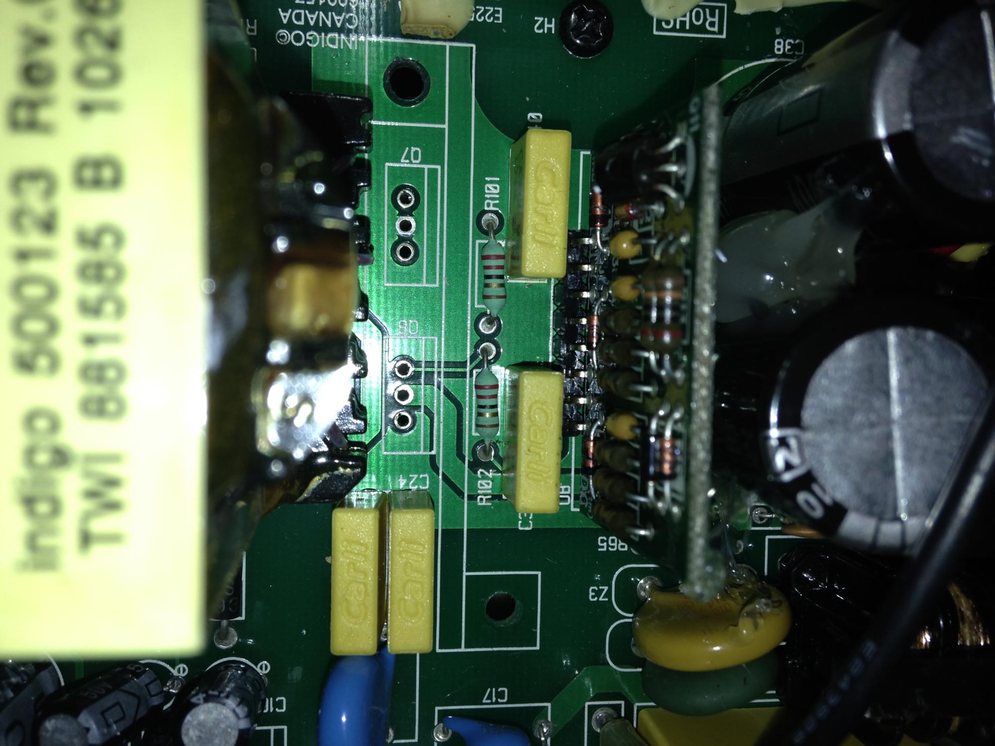

                              There are a couple of resister connected to the source pins of the mosfets (pair of irf730's)
                              But they are 22ohm, I'll check them though. Red, red, black, gold, brown
                                I think those connect to the Gates. Usually, TO-220 MOSFETs have their pins as Gate, Drain, Source, in that order. Seeing that the MOSFETs are facing the transformer, that means their Gates are the top pins.
                                Still, if any of those MOSFETs blew, then check those 22 Ohm gate resistors as well.
                                  Your right seems like the source pins connect to the doughter board which is packed with diodes and resisters, so will have to remove and check that too

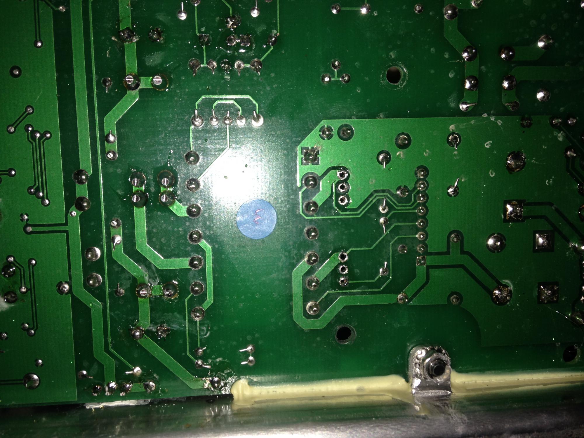

                                      Alright so pulled out the daughter board and pin 2 & 5 are connected to the resister in line with the source pin on the mosfets.
                                      They are both reading 394 Ohm (0.394k Ohm), but having a hard time figuring out the colour bands to see if the readings are correct w ith specification. Asume they are as both read the same.
                                      Looks like, Brown, Black, Brown, Gold, Orange
                                      But there is no orange as the fifth band or if I reverse no gold as the 2nd band?
                                        From the reverse side picture, it looks like there are NO Source resistors. So I guess that is one less thing to worry about now.
