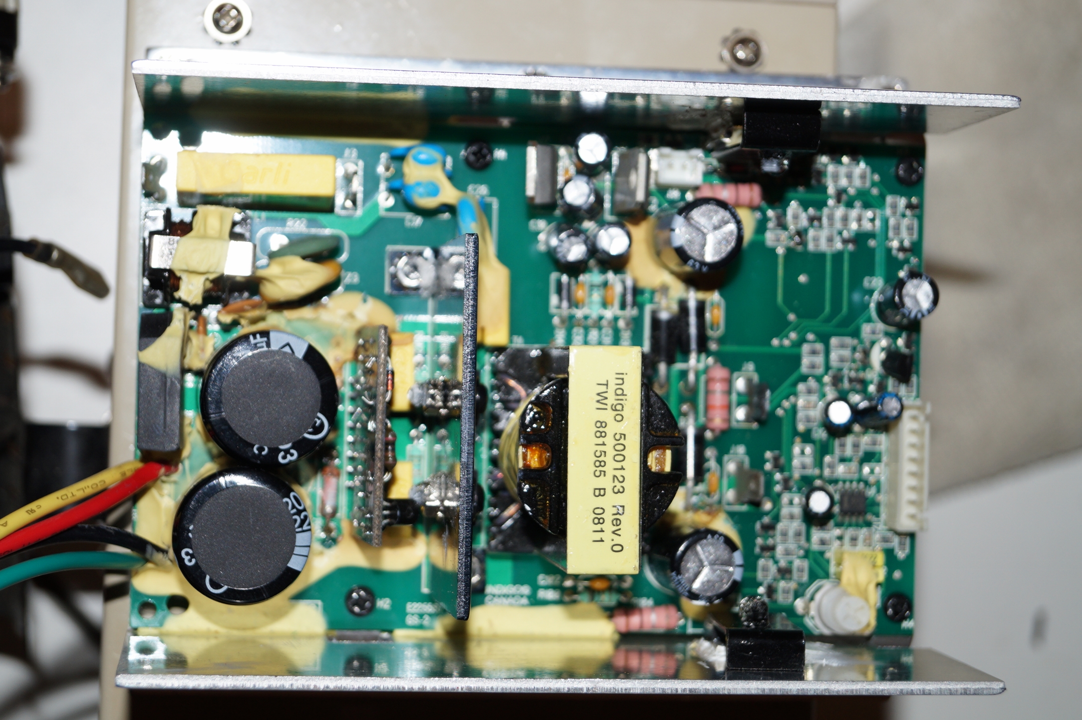

    Are you sure, the track connects to this daughter board and the two resisters are in line with the pins?
      master hoarder
      • May 2008
      • 12175
      • Bulgaria
      Re: 200v 220uF Main Cap Replacement Advice?
      It does, but those aren't the Source resistors. I am 100% sure. Too high of a resistance and the tracks leading to the daughterboard are too thin. Plus, it looks like the Source legs on both MOSFETs go directly to the transformer pins.
        All sorted, that was probably the hardest but most satisfying repair ive done to get something working again. Pretty much everything ive learned over the last year was of use.
        Just a quick question regarding heat, on my solder sucker desoldering station I set it at 360c which I thought was a good temp. But I found myself twice pulling pads whilst working on this, the PCB was a little thinner than normal but still normal.
        Is that too high a heat?

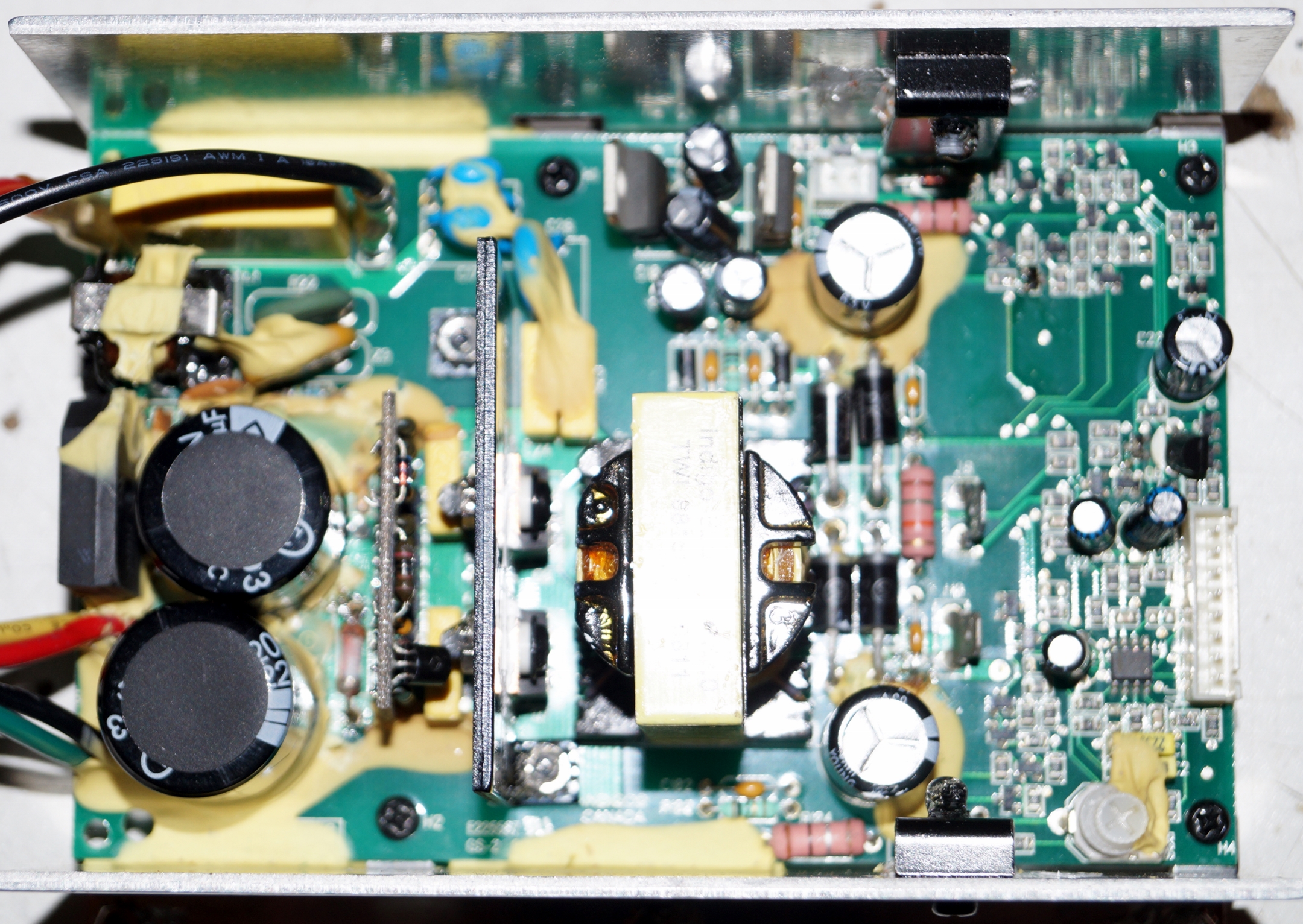

          Got hold of another one of these which had 2 blown irf730 mosfets which ive replaced.
          It turns on and then off right away but doesn't blow a fuse and just makes a clicking noise coming from the main PCB.
          Sound like a relay switch but for the life of me I cant see one?
          Could something else be making the clicking noise?

            • 31304
            or a coil energising and hiting the core.

                what's with the resistor right of the main caps?
                and try to lift that glue!
                  That glue is a son of *****, so bloody hard to get off.
                  Resister a bit mangled as I was trying to get it out but had glue all over it, the outer shell broke off when removing. Tested ok.
                  Looks like this one is beyond repair if the transformers are gone
                    http://www.ebay.co.uk/itm/MURATA-102...cAAOSwrklVOT-i
                    edit: something like that possible? size is roughly the same and looks very similar
                    So is a AC line filter inducter, just going to remove the bigger yellow coil (assume that's a transformer!) and see if its still making clicking noise. Was just about to give up but that might be replaceable.
                      i doubt there is anything wrong with them.
                        Seems it's the bigger transformer as when remove clicking stopped and when put back in it started again.
