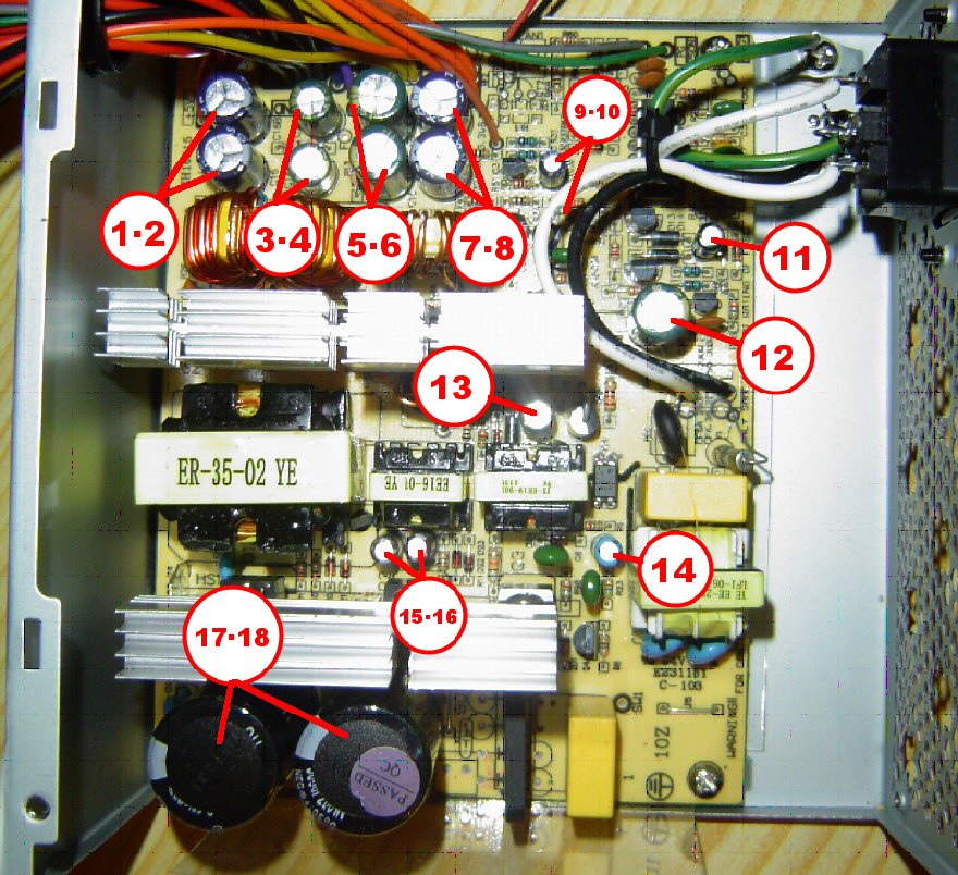

                                          I'm thinking about a moderate recap of the 'TOOQ' PSU from the beginning of this thread, just the output filtering and +5VSB critical caps:
                                          1,2 (+5V) · 1000uF · 10V · 105C · ASIA
                                          3 (+5VSB) · 470· 16V· 105C · ASIA
                                          4 (-12V) · 470· 16V· 105C · ASIA
                                          5,6 (+12V) · 1000uF · 16V· 105C · ChengX
                                          7,8 (+3.3V) · 1000uF · 10V · 105C · ASIA
                                          12 (+5VSB) · 1000uF · 16V· 105C · ChengX
                                          13 (+5VSB) · 47uF · 50V · ChengX
                                          This crappy PSU doesn't have any PI coil in the output , so I wonder if it could be a good idea replacing all the output caps with higher capacitance ones, say 1500~2200uF replacing the 1000s, and perhaps ~1000uF replacing the 470s. Or something like that.
                                          I have four spare Panasonic FJ 1500uF 6.3V 105C caps scrounged from an old mobo, apparently in good health. What do you think about using them for 1-2 (+5V) and 7-8 (+3.3V)?
