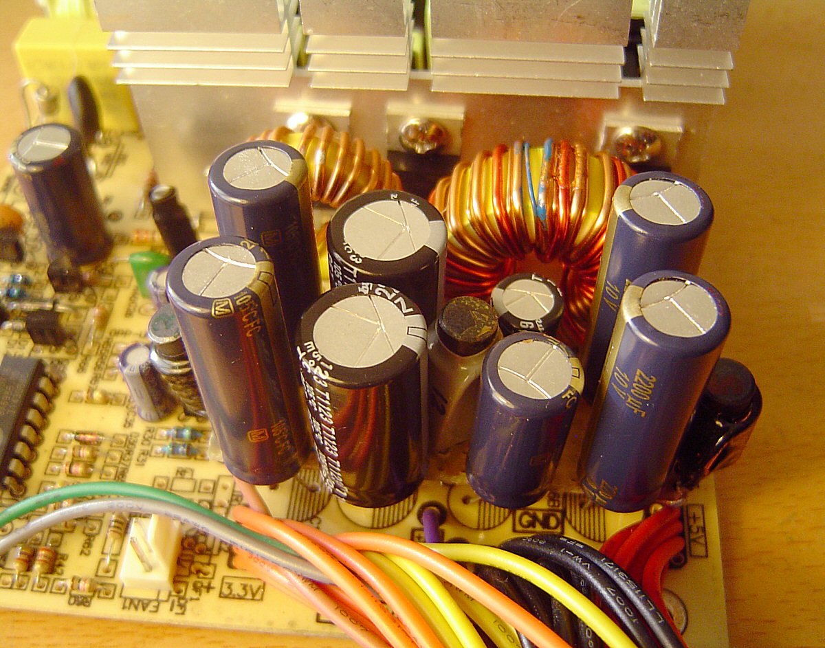

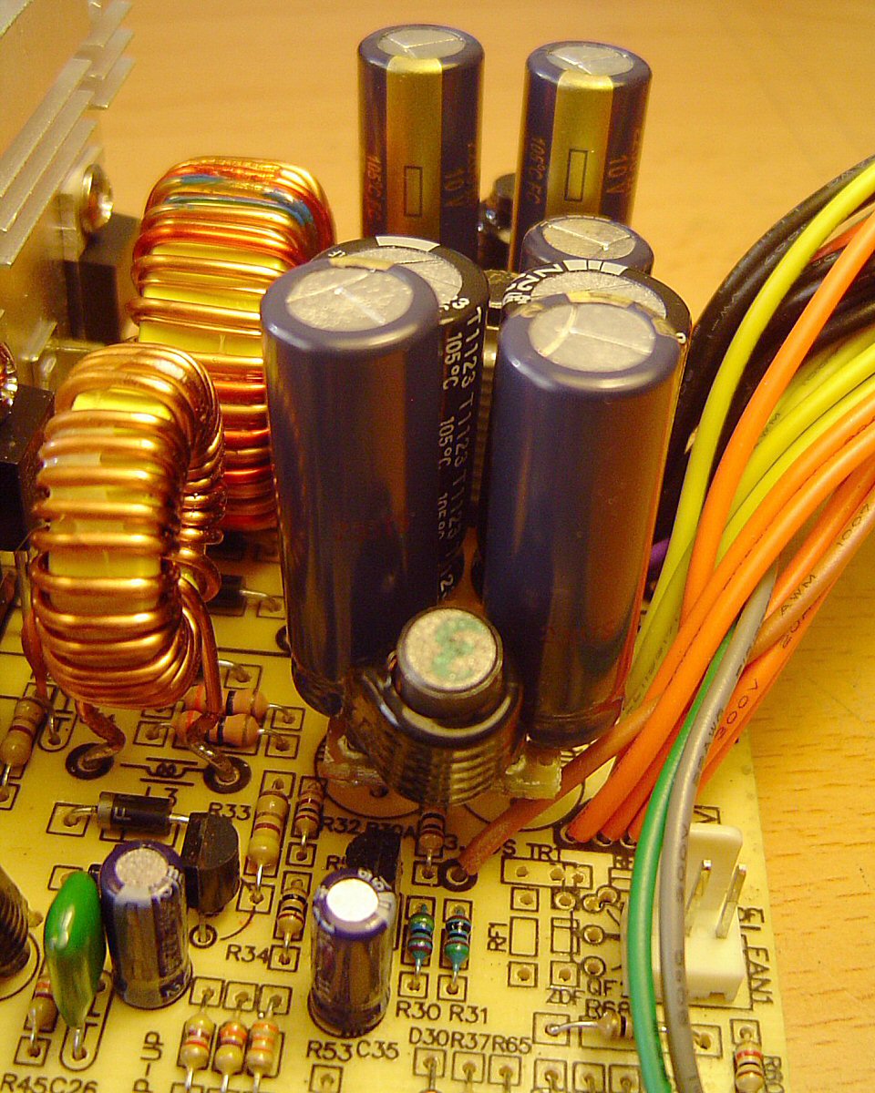

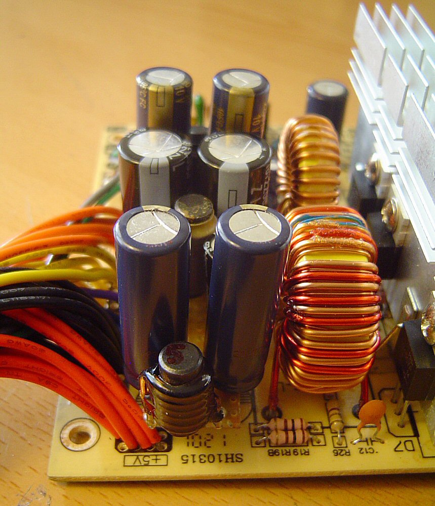

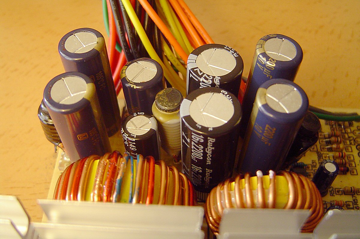

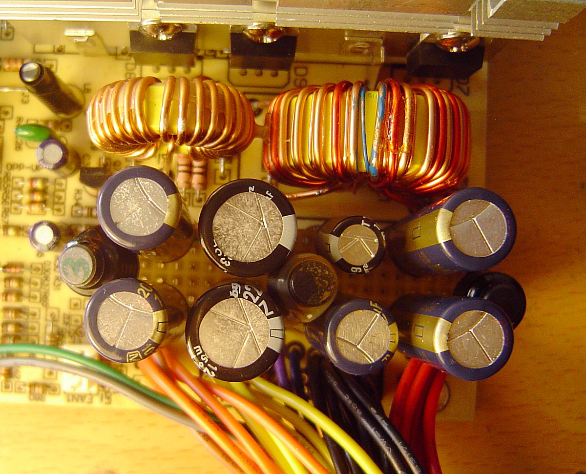

        Guetto-modded a bit the 'TOOQ' thing. To add PI coils for +12V, +5V & +3.3V outputs in a PCB lacking any parking slots for them, I brainfarted what I call 'the inglourious basterdaughterboard':

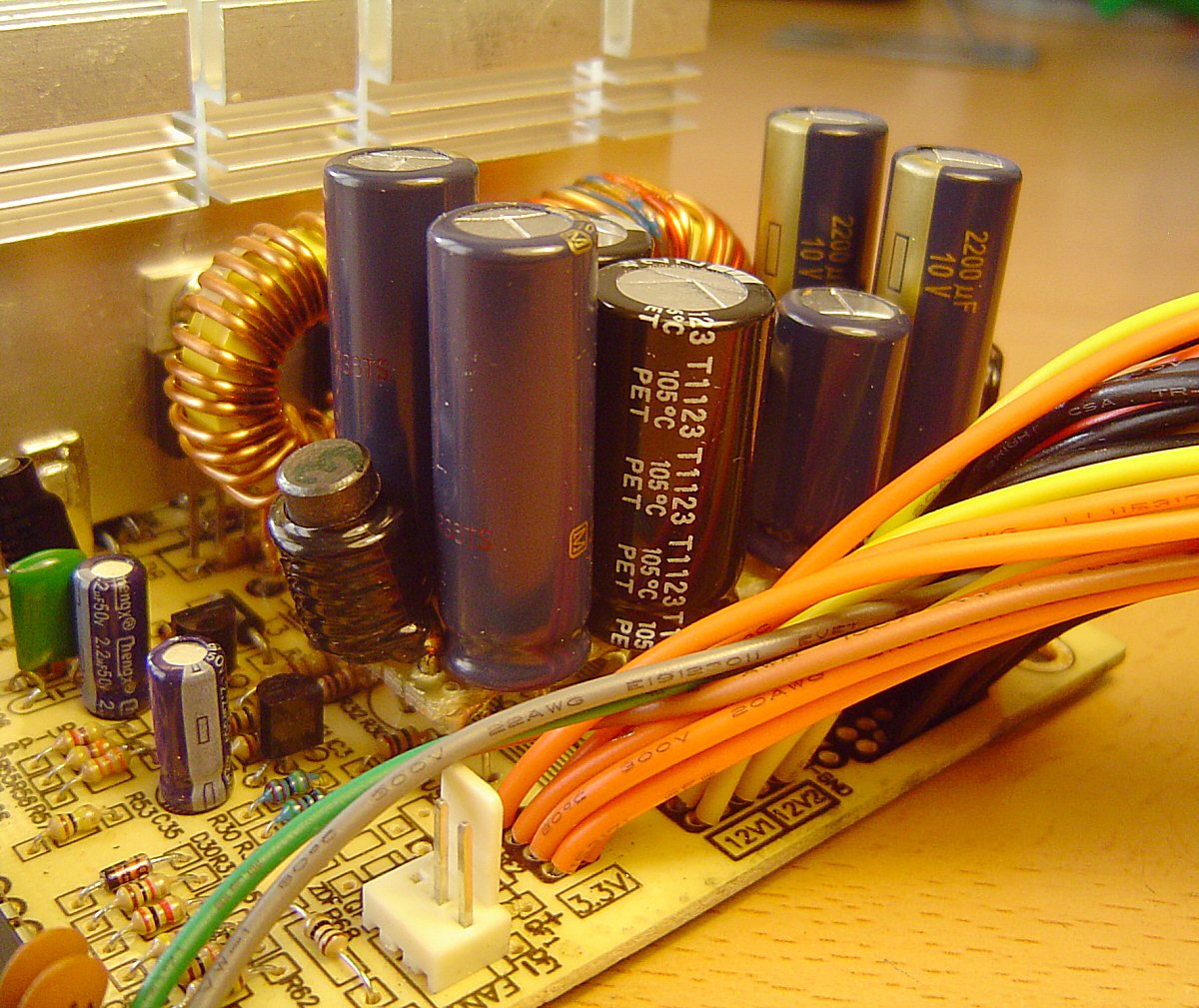

        Scrounged the PI coils from an old deceased PSU, and soldered them bridging the positive legs of each pair of caps (2200uF Pannys & Rubys now, replacing the 1000uF 'ASSIA' & 'ChungX' crap).
        Cut the traces under the PCB, so that the juice has to go up from the PCB through the + leg of first cap, then pass through the PI coil, then go down through the + leg of second cap back to the PCB downstream of the trace cut.

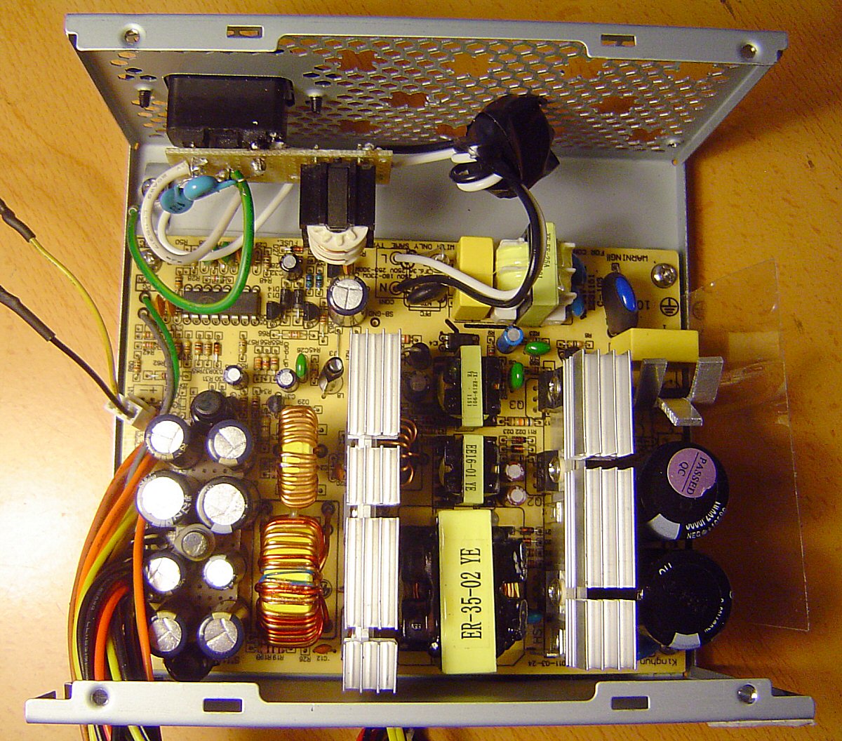

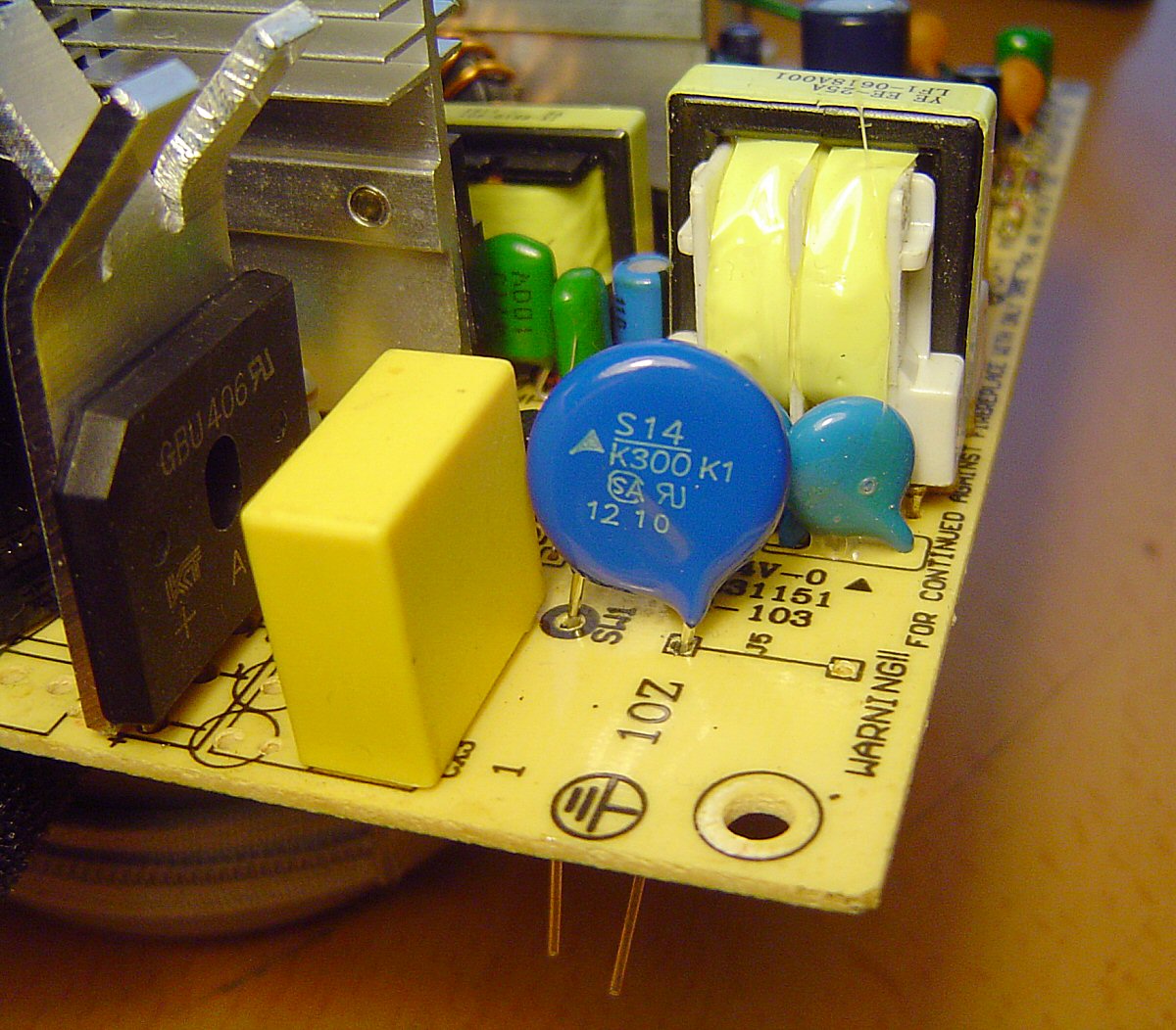

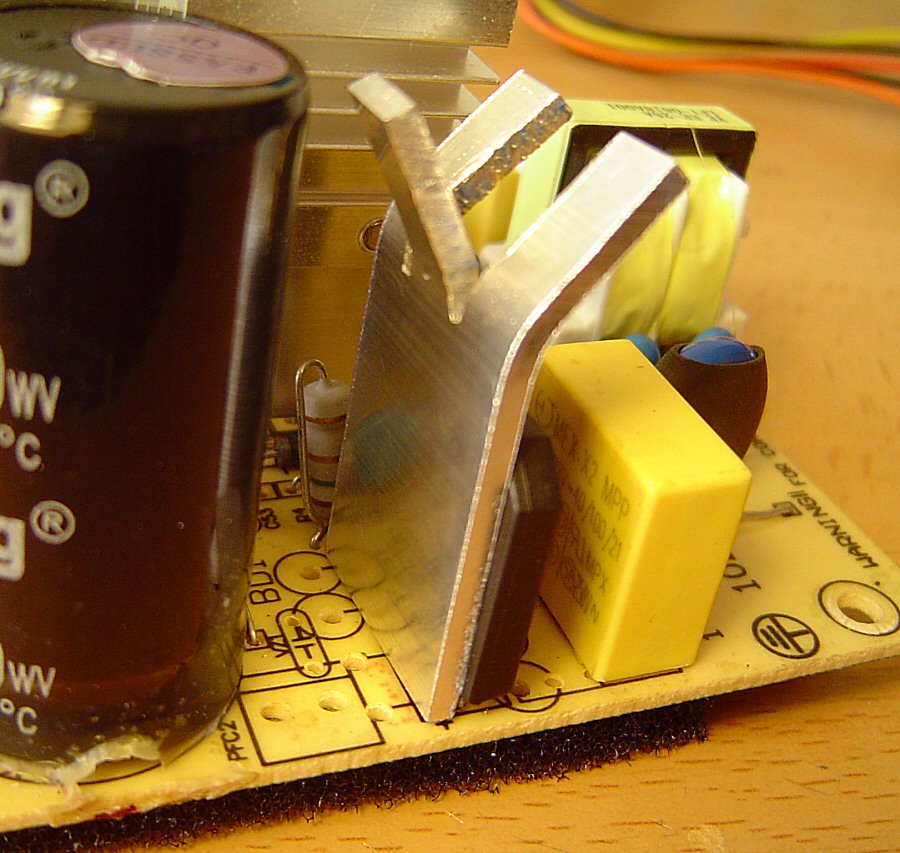

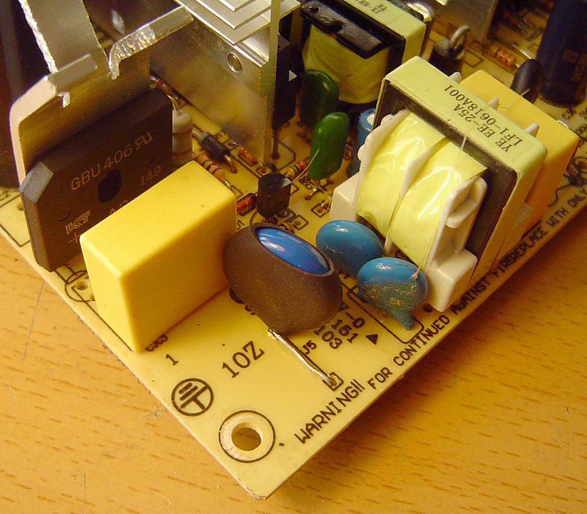

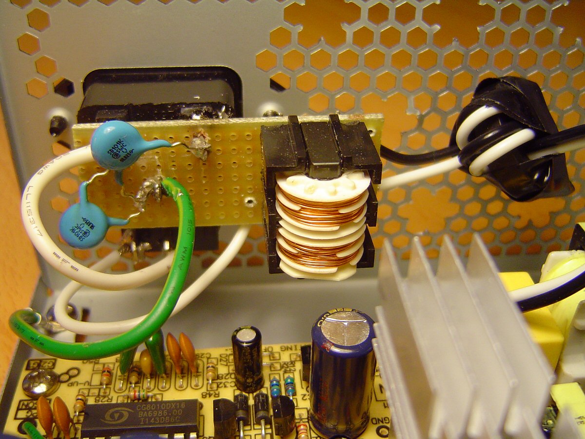

        Also added a small daughterboard for extra input filtering components, with two Y-caps, a common mode ferrite choke, and a ferrite bead for the main wires:
        A MOV across L-N downstream of the fuse:

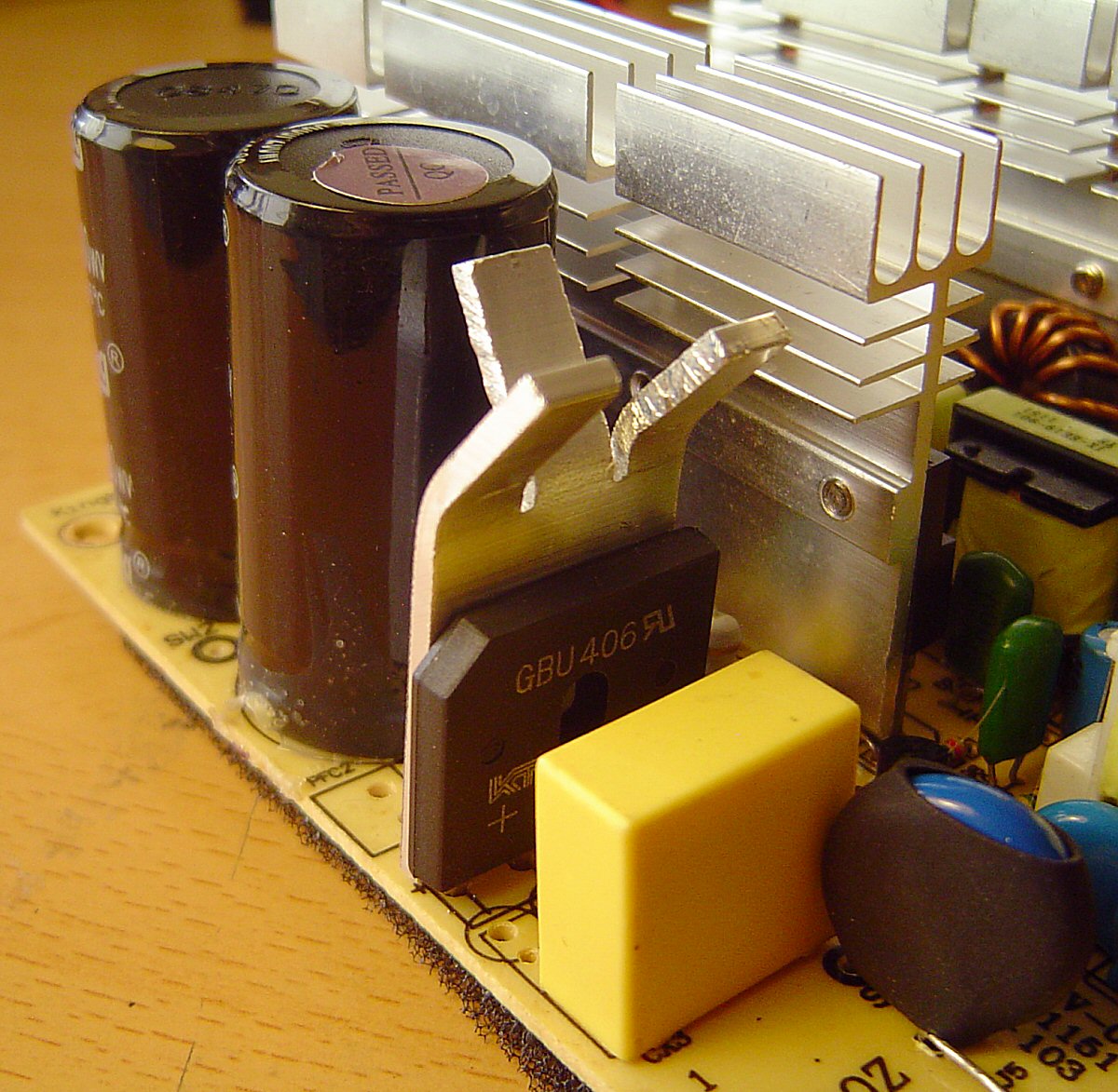

        DIY heatsink for the bridge rectifier:

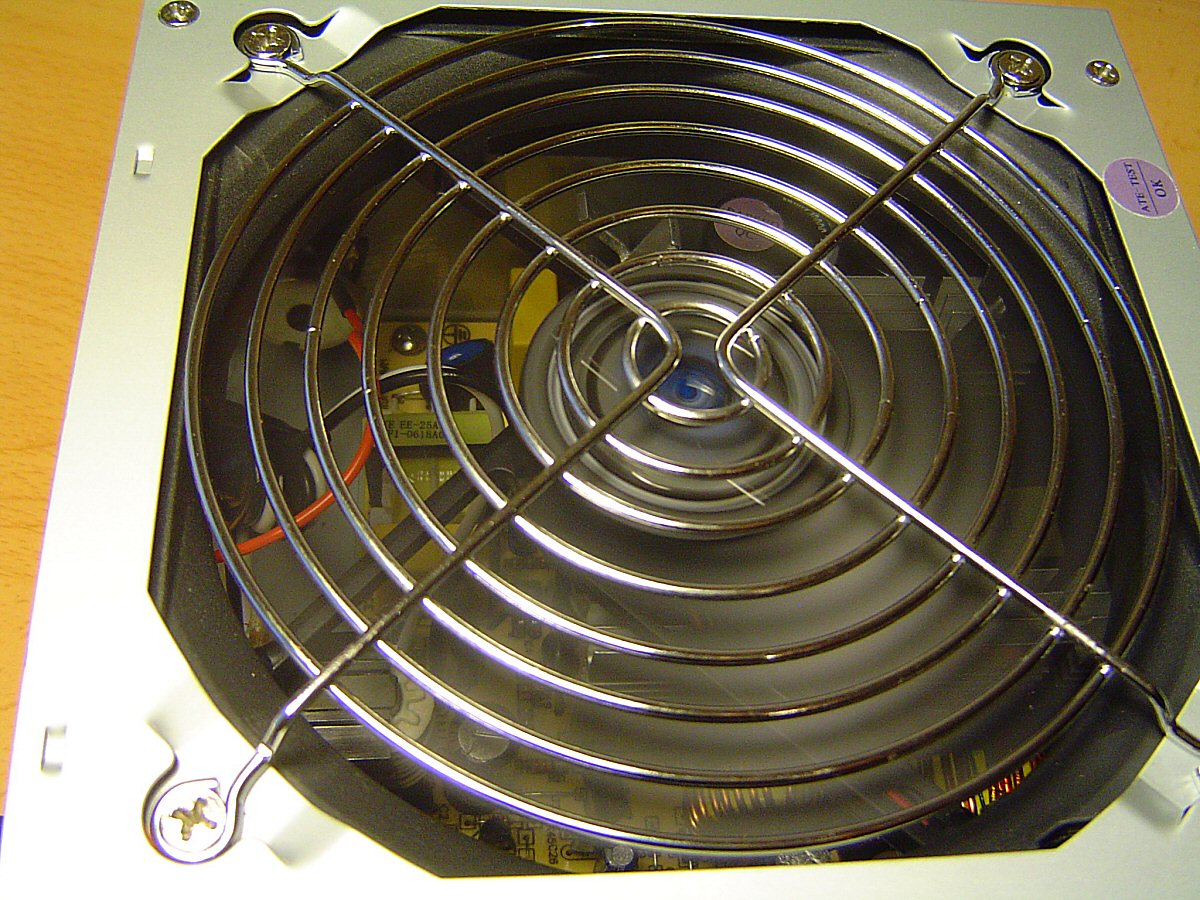

        Top view of the thing once modified to the perpetrator's delight:

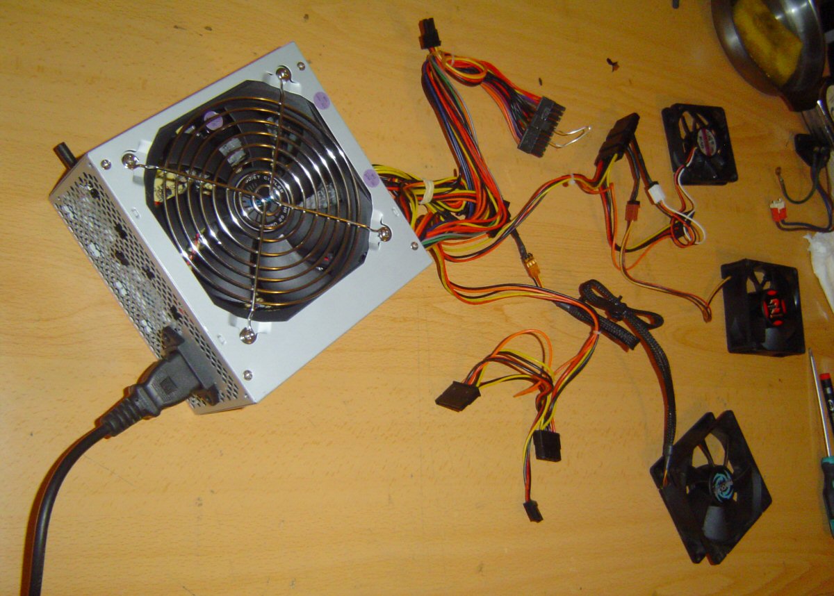

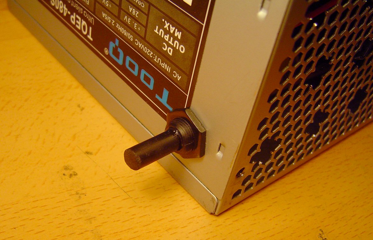

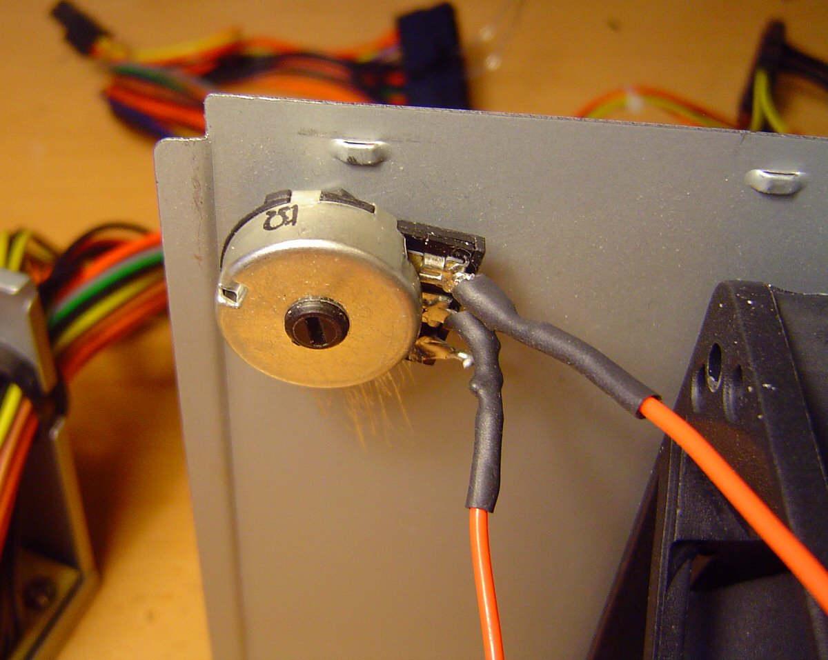

        A potentiometer for 'digital' control of fan speed:
        The thing under test to discover in how many pieces it explodes:
        But again in a most amazingly way the thing works , with the DMM reading coherent voltages.
        A pity I lack the equipment to find if ripple & noise have improved or what.
        Man do I love this shit .

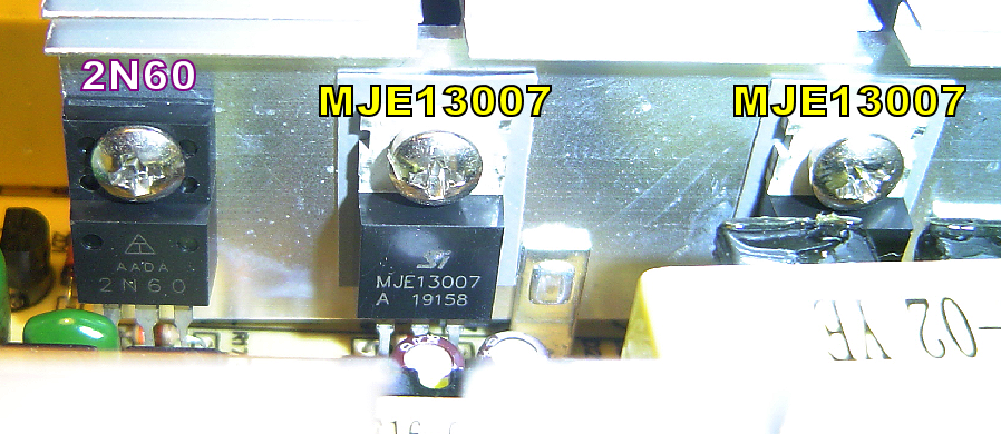

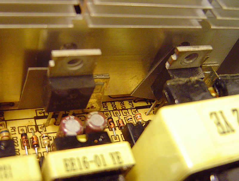

                      The 'TOOQ' thing has this on the primary:
                      I think the 8A 13007s could perhaps be replaced with 12A 13009s.
                      The MJE13009G is out of catalog in Farnell. How about the Fairchild FJP13009H2TU, could it do the job?
                        Re: Cheap PSU: Piece of junk or semi-decent?
                        Yup, it would do fine as well.

                                      Harsh profanity was required but managed to unscrew the 13007s without desoldering the heatsink :

                                        I always unsolder the whole heatsink, saves a lot of sweat.

                                          While you're at it, replace those two small electros. They, along with some resistors and diodes, bias the two switchers.
                                          Miniature long- and needle-nose pliers are excellent for removing and replacing the screws and insulators for the power transistors.
