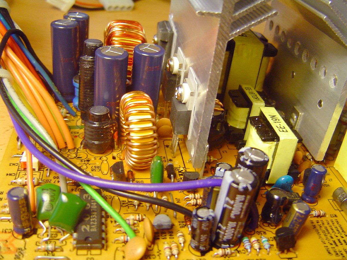

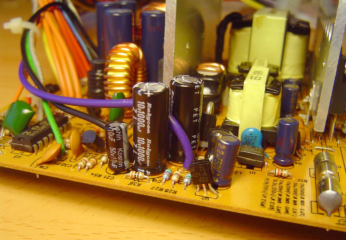

                  The fresh caps arrived .
                  It's going easier than I expected , except for the two little ones between the heatsinks. They were a PITA and needed tweezers & lots of harsh language to go into formation .
                  ->LARGE · ->LARGE · ->LARGE
                  I'm leaving the n.16 2200uF 16V 12.5mm Ø for the end, to have room for fixing my resistor-cooling ghetto-mod. Also the two Panasonic big ones are a bit larger than the Su'scons and need some tweaking in the neighborhood for clearance.
                  BTW, I was puzzled when I couldn't find any 'Panasonic' marks on them, and even more puzzled when I couldn't find Panasonic in this list . Then I learnt that Panasonic was called Matsushita years ago, and that Panasonic caps are marked 'M' :
