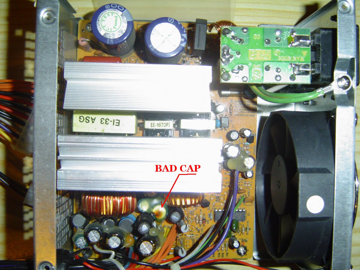

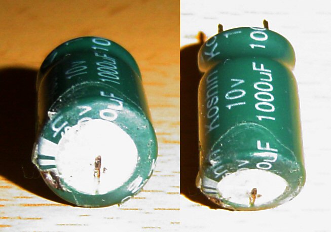

                            Did my first ever recap on the 'P4' PSU .
                            -> LARGE
                            The little bugger with its cracked domed top excreting 'Agent Orange'.
                            Replaced it with the closest I could find amongst the loot scavenged from an old broken huge CRT monitor.
                            The replacement is 1000uF 16V 85C, against the original 1000uF 10V 105C.
                            Again in a most amazingly way considering my solder skills, when I plug it to the wall the thing not only doesn't explode, but seems to work OK with coherent voltages .
                            I'm looking for what you call 'a sacrificial comp' for the supreme test.

                              I wouldn't keep an 85C cap in that place, it'll be toast quickly. Also, almost all 85C caps are general purpose, not low ESR, so the ripple may be out of check.

                                  Concur with Th3's comment! That 85C cap won't last long as the output cap in a power supply. It's 2004 vintage, so I would get 1000uF, 10V United Chemicon (= Nippon Chemicon) LXV, LXY or LXZ series parts or Nichicon PM, PJ or PW series parts (or Panasonic FC series) in there as soon as you can get some from Farnell or whatever distributor sells in Spain.

                                        Originally posted by PeteS in CA View Post
                                        ... That 85C cap won't last long as the output cap in a power supply ...
                                        Excuse the potentially noob question: What exactly will kill it? The heat?
                                          Main cause would be heat, yes. There is also ripple current that the cap has to handle, which causes self-heating. This, along with the heat coming from the rest of the components, will quickly cook that 85C cap.
