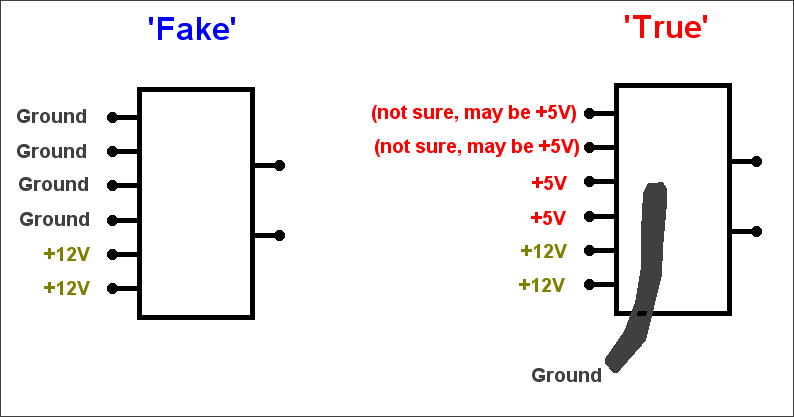

    Hmmm ... I've been beeping my way and the two PSUs are very dissimilar :
    In the TOOQ four of the six 'secondary' legs of the main trafo seem to be put to ground, two go to +12V and apparently none goes to +5V.
    Too baroque to tangle with, I think I'll live with the fake 35 for the time being .

      Re: Cheap PSU: Piece of junk or semi-decent?
      Those are often not independent windings rather than single winding with several outputs. It is also usually thick wire, you won't be able to measure that unless you have precise meter (like ESR metr, inductance meter is better). Ordinary resistance meter is not precise enough and has higher transitional resistance on probes than the measured winding.
        That won't do. Windings are all connected together so you can't use a multimeter.
        What you need is to have both PSU boards in front of you and physically (i.e. with your eyes) trace the 3.3V, 5V, and 12V rails to their corresponding transformer pins. Start from the rectifiers for each rail and work your way backwards to the transformer.
        For the transformer that doesn't have the separate ground tap, you should have 2 pins for 5V, 2 pins for 12V, and 2 pins for ground . On the one that does, it's possible that 3 of the pins are for 12V and 3 are for 5V... or 4 are for 5V and 2 for 12V. Or just 2 for 12V and 2 for 5V, and 2 unconnected.
          By visual tracing it may be that the two center pins of the 'fake' go to +5V. Most definitely two pins go to +12V, and two to ground.
          The two dubious pins in the 'true' seem to go to a resistor and a small lenticular ceramic cap, then seem to go to +5V. I can't tell for sure, the donor PCB is now almost empty of components and heavily mauled.
          I don't know, sounds too baroque and risky a trasplant with my very limited tools and knowledge . Better I'll wait till I can scrounge some true 35 with a clearer pinout and no hanging wire.
          Thanks a lot for your interest and your help , this is a fantastic forum for learning!
            Good luck with that, most halfbridge PSUs have that grounding wire on the transformer.

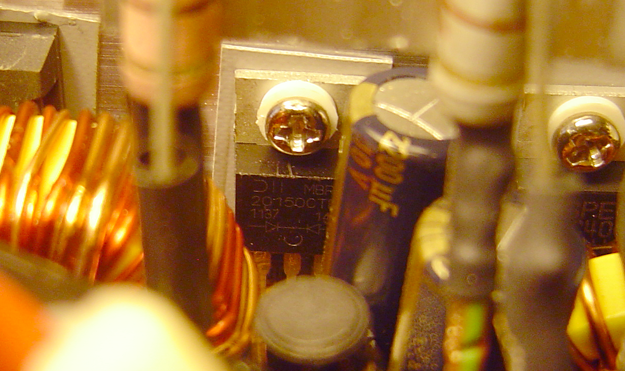

                                My legendary 'TOOQ' frankenPSU concoction suddenly refuses to start. This PSU has not seen much use since it was frankensteined, just some hours a month powering a P4 retrocomp.
                                +5VSB is alive and well, but when I switch the PSU on the fans don't even blink, and the bulb trick just flashes once briefly.
                                On visual inspection everything looks OK, but after some meter testing it seems the +12V rectifier is blown:
                                Legs 1 Leg 2 (center): .001 continuous beep, Ω 1.7
                                Legs 3 Leg 2 (center): .001 continuous beep, Ω 1.7
                                This +12V rectifier is a STPS40M60CTN which replaced the original MBR20150CTP (max Vrrm = 60 vs 150):
                                  Interesting.
                                  Maybe the Repetitive reverse voltage was too low for that platform.
                                  The secondary heatsink is directly connected to the rectifier's output pin? I don't see any insulation.
                                    schotky rectifiers usually have a snubber resistor&cap, was it there or added?

                                      The STPS40M60CTN +12V rectifier is definitely blown, once unsoldered from the PSU one of its legs is shorted.
                                      That's my best guess.
                                      Ahem , thas was an old mishap since solved, see here.
                                      The OEM MBR20150CTP was a Schottky, so I'd guess yes, but I can't really tell.
                                        Ok.
                                        Either the Repetitive reverse voltage was too low for that platform,
                                        or else, something went wrong with the rectifier's insulation.
