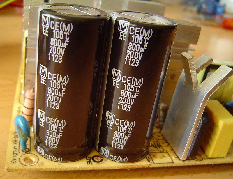

      Fresh Panny primary caps, perhaps a bit oversized for the application :

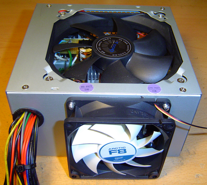

      Smaller electros replaced with Panny FCs, and an extra ghetto-modded fan to let the air flow:
      >Expand . . . >Expand . . . >Expand
      Now with larger primary caps, 12A switchers, a 40A +12V rectifier, and overkill cooling, what do you think might be an honest max continuous wattage for this thing?

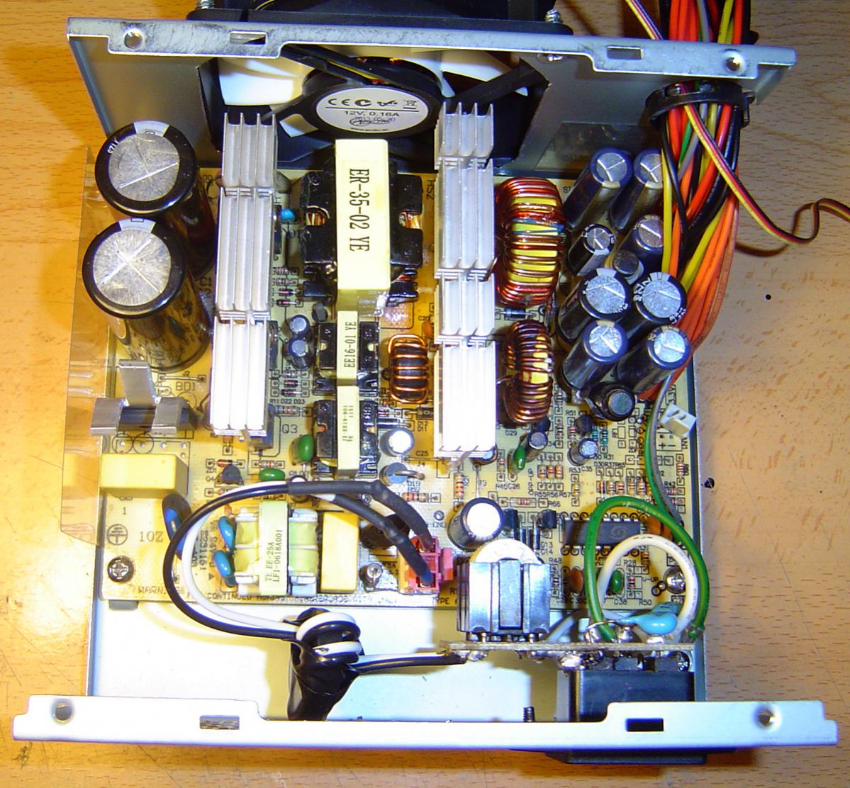

        I don't think it can do 300W due to the small main transformer size.
        • Th3_uN1Qu3
          Believe in
          • Jul 2010
          • 6031
          • Romania
          #284
          Re: Cheap PSU: Piece of junk or semi-decent?
          Note that they said series, not parallel... So no, putting diodes in parallel will not magically increase their voltage rating. Putting them in series will, however, this is suboptimal for many reasons and thus is not used unless there's really a need for it, usually in high voltage circuits.
          I think it'll do close to 350W... However those output inductors will likely get pretty hot.

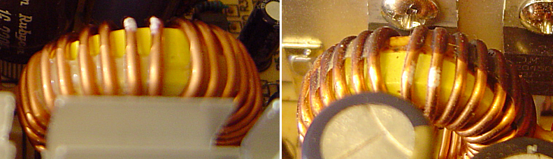

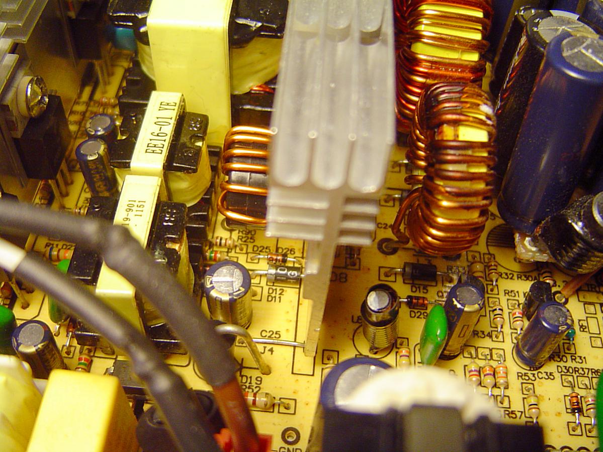

            Yep, I noticed how, after a time powering the Preshott, the glue on them was roasted alive:
            In this IR pic inductors are even hotter than voltage regulators :
            Guess the extra fan will help here.

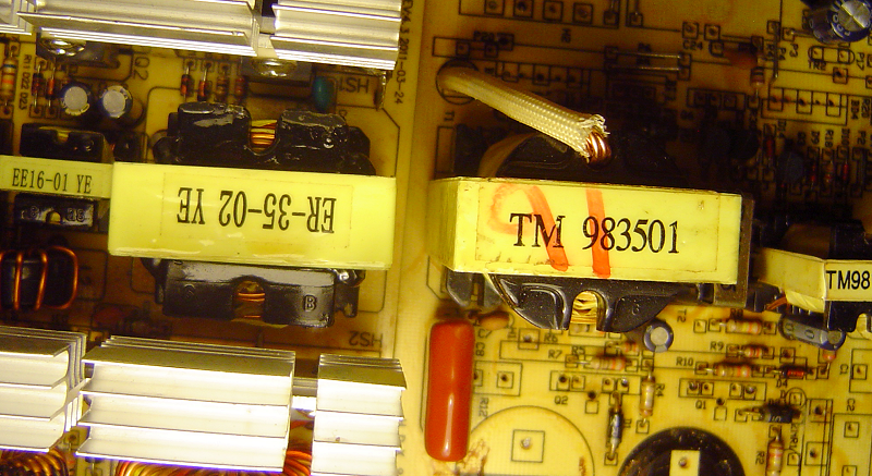

            Well this PSU with 13009s, similar heatsinks, '35' transformer, and one 20A +12V rectifier managed 377W.
            Let's make a deal at 300~350W, OK?
              This is real 35 size transformer on the link you posted: http://www.clubedohardware.com.br/fu...hp?image=70239
              Your psu has fake 35 size transformer judging from the pics.
                For sure! That looks like a 25, maybe a 28.
                  LOL, the main transformer is a fake? The more I know her the more I love this PSU .
                  OK, will it work better or will it if I kick off the fake and fit a real '35' trafo?

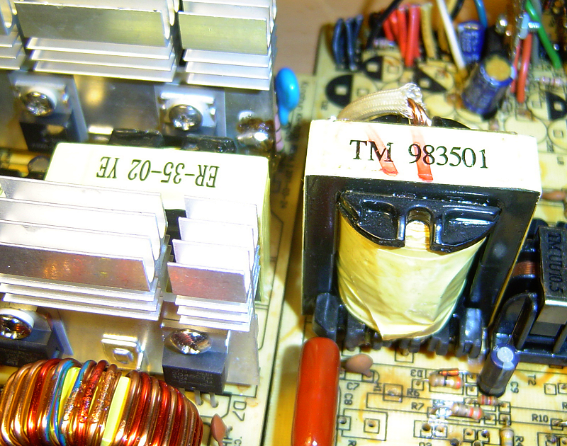

                    It actually looks like 33 to me. Still not good....Although I have seen half bridge with 33 transformer do almost 350W. Unless you're loading this thing over 250W I'd leave it. If you were in the USA I'd send you a transformer, I have quite a few 35 and 39 transformers just sitting here!!!
                    Edit: I would also try and get the secondary caps a little closer to the PCB. Having them like that shouldn't cause too many issues but having the lower ESR definitely wouldn't hurt

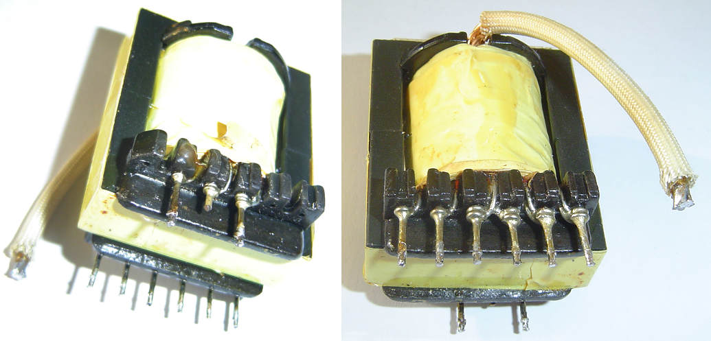

                      Do we agree this is a true legit bona fide authentic 35 size transformer ?
                      It comes from a 10~15 years old deceased PSU, can I test it somehow to verify it is still OK?
                      What do I do with that thick wire, put it to ground?
                      • goodpsusearch
                        • Oct 2009
                        • 2850
                        • Greece
                        #291
                        Please don't replace transformer with another one if you are not sure that they are compatible.
                        Compatibility has to do with the psu desing, if it is a half bridge, transistor forward etc...

                          I wouldn't say fake. At least not in the usual "prints whatever on the label" sense. Just keep the load reasonable and it should be ok.
                          Do not do this unless you are certain about the two transformers being compatible!
                          Obviously, you need to consider pinout and ratio. Number of primary turns vs core area are exceedingly important also, since this determines the minimum freq the supply must run at. Get this wrong, and the core'll saturate- no more transistors. Depending on how the replacement is wound, you may also need to modify the primary snubber due to leakage reactance.
                                P... Compatibility has to do with the psu desing, if it is a half bridge, transistor forward etc...
                                The donor PSU claimed 350W and was also half-bridge topology with two NPN transistor switchers.
                                Originally posted by kaboom
                                ... you need to consider pinout and ratio. Number of primary turns vs core area are exceedingly important also, since this determines the minimum freq the supply must run at. Get this wrong, and the core'll saturate- no more transistors. Depending on how the replacement is wound, you may also need to modify the primary snubber due to leakage reactance.
                                Pinout is identical, six pins at one side, two pins at the other side. However it has that thick grounding wire that the fake 35 lacks.
                                How can I identify turn ratio and number of primary turns vs core area in a transformer?

                                  #296
                                  Not gonna work then.

                                    #297
                                    You sure?
                                    I guess it would be possible to re-wire the output connections on the PCB so they match those of the newer, larger transformer.
                                      Even if you replace the transformer have you got a load tester to check that the new transformer combined with the psu you put it into will provide 300W+ without saturating?

                                        #299
                                        Originally posted by ben7
                                        ... I guess it would be possible to re-wire the output connections on the PCB so they match those of the newer, larger transformer.
                                        (Potential absurdity ahead): If the problem is the lack of a hole in the PCB close to the transformer to solder the thick ground wire in, I could connect it to the secondary heasink, which is grounded.

                                          #300
                                          +1
                                          If you match the pinout correctly (that is, connect the pins from the 5V windings to their corresponding 5V holes on the PCB, the 12V windings to the 12V holes, ground wire to ground, and etc.), then there is no reason why the transformer from one half-bridge PSU won't work on another one.
                                          Now, as far as how well it will work (as kaboom mentioned, there's some other things to worry about too), that's another story. This you will know only with a load tester until the PSU goes bang .
                                          Yes, that would work. And you'll probably also have the transformer standing a bit off the PCB as you rewire the pinout on the bottom to match the PCB holes. But this crosses quite far into the ghetto mod thread territories .
