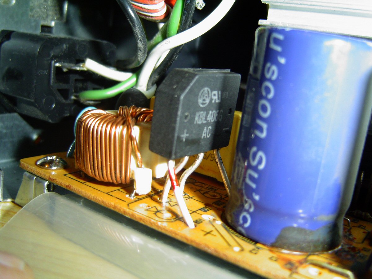

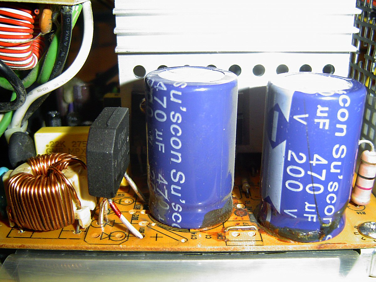

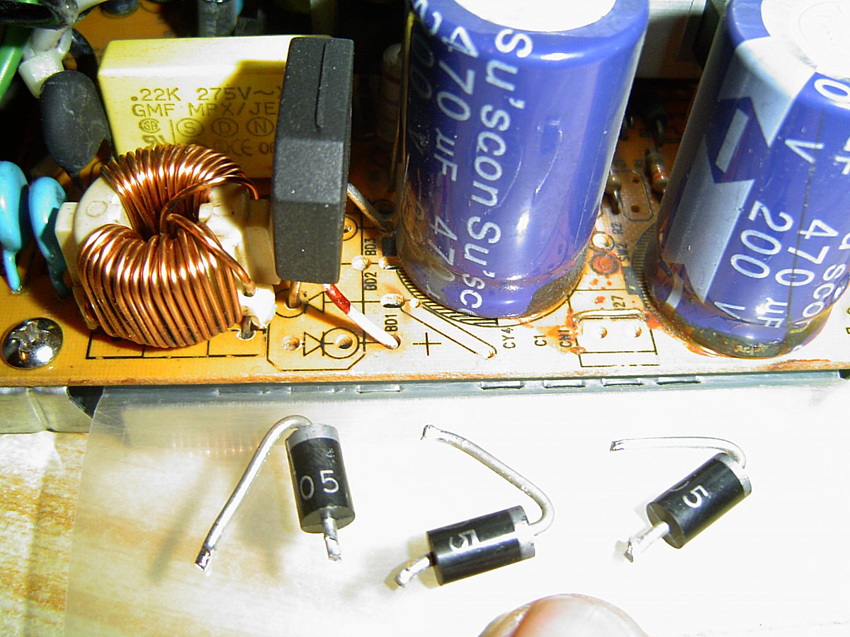

in 2002) resting in the attic under tons of dust

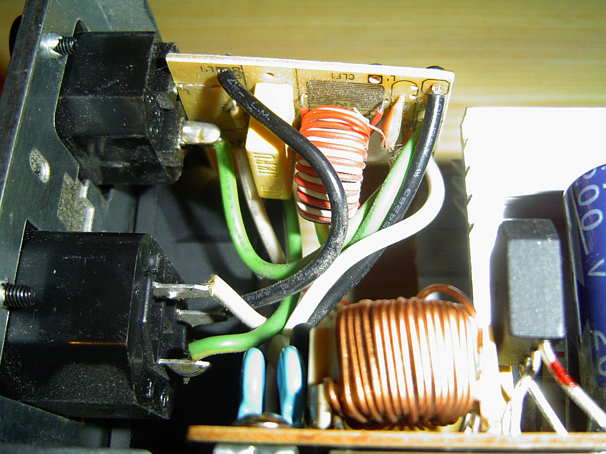

. This one donated its organs (KBL 406G bridge recitifer, ferrites and X/Y-caps).
I thought I trusted how to correctly solder the bridge recifier's four legs to the PCB. I was very worried about the X/Y caps lacking polarity marks
... until I discovered that X and Y caps lack polarity ('logical, as they eat AC, you moron'
the soldering was done.

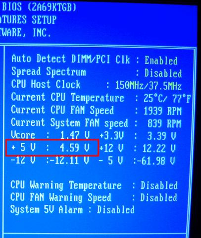

Half of the computer problems is caused by bad contacts
