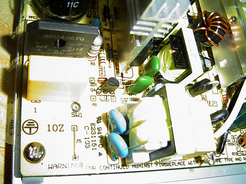

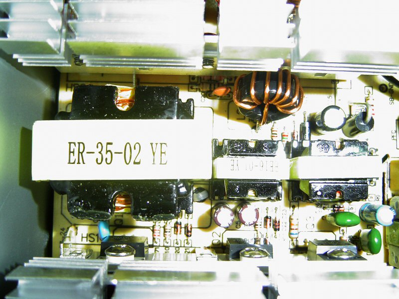

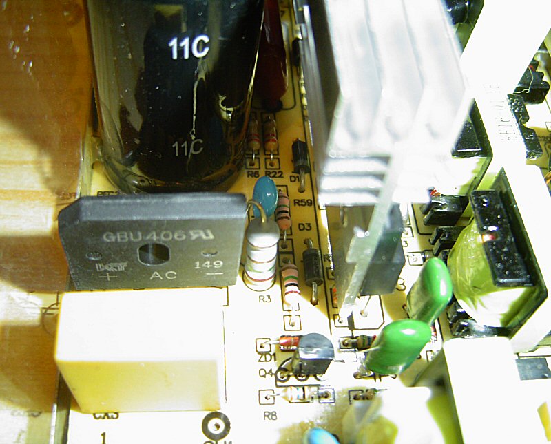

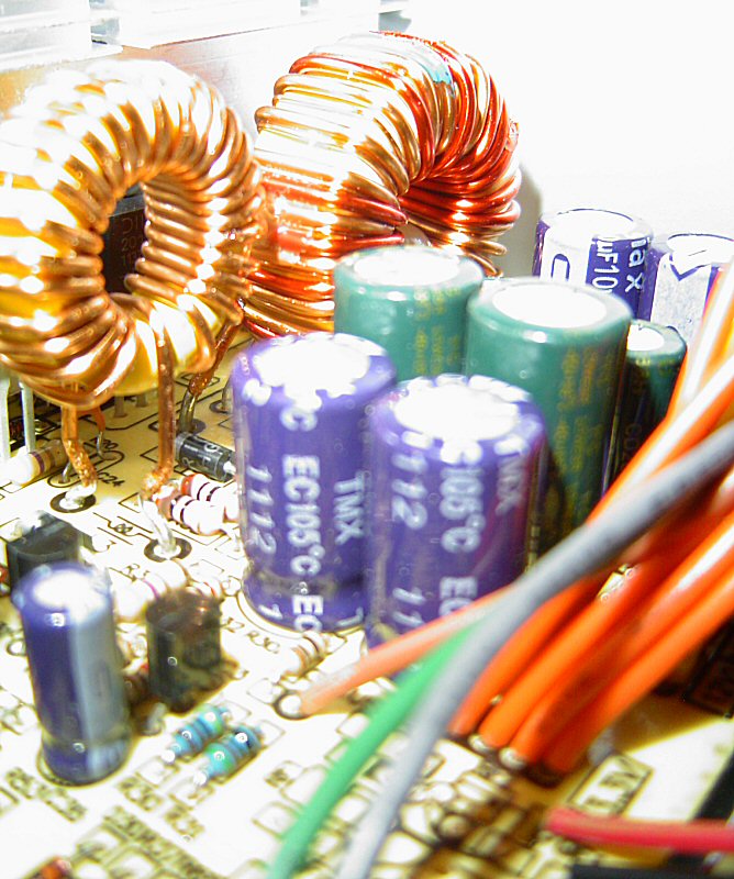

    Greetings from Spain.
    Got this cheap (€16 , about $21) PSU, opened it expecting a hopeless gutless horror show, but after having a look I'm now in doubt, maybe it's not so terribly bad after all. I would like to know the experts' opinion (I'm just an amateur with pretty limited knowledge).
    The thing is called 'TOOQ TQEP-480S', and pretends to be 480W no less.

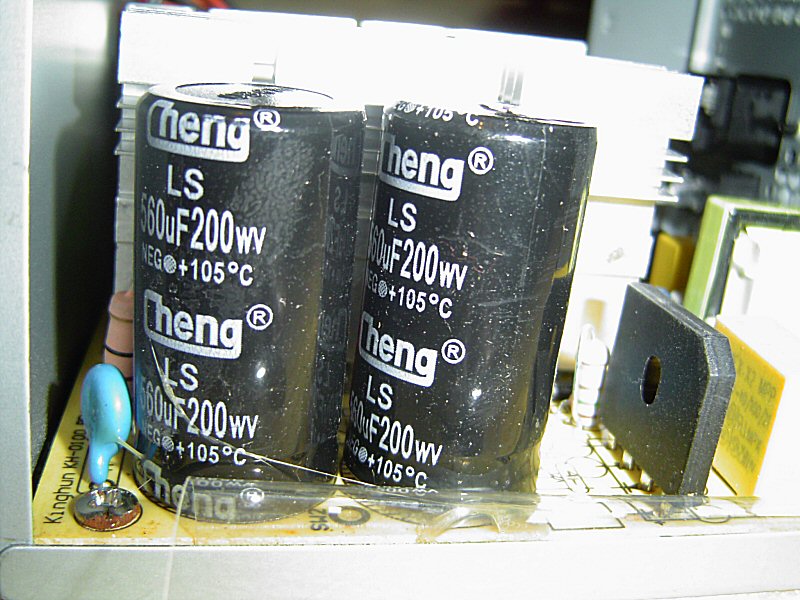

    Transient filtering stage: --> Larger pic --> Larger pic
    Bridge recitifier: --> Larger pic --> Larger pic

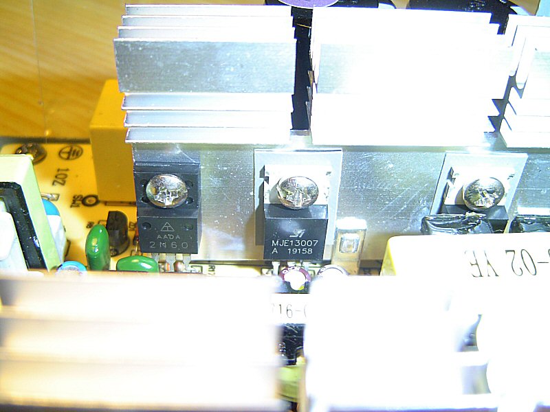

    Primary switchers, left to right 2N60 / MJE130007 / MJE130007 : --> Larger pic
    Transformers: --> Larger pic

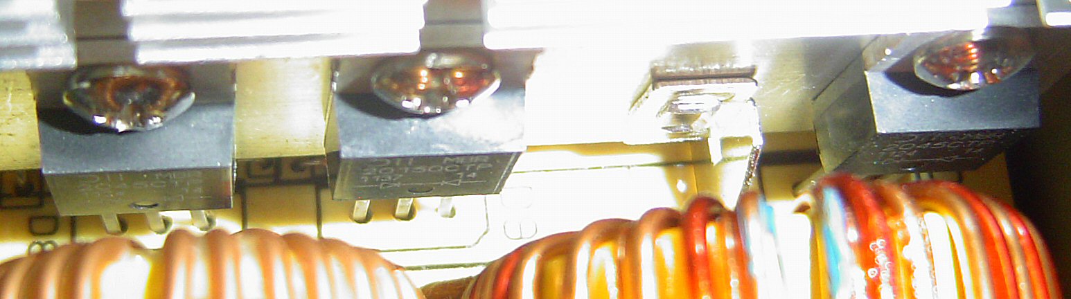

    Secondary rectifiers, left to right 2045CTP / 20150CTP / 2045CTP : --> Larger pic

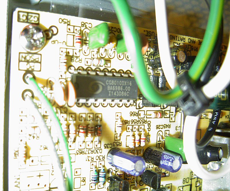

    Other pics: --> Larger pic --> Larger pic
    What do you think?

    Not terrible but not good, it won't do 480W that's for sure but for that price that's to be expected. I would definitely recap it with higher capacitance caps. That thing could probably do 300W continuous, the heatsinks look decent. But I'd be curious to know the specs on the switching transistors and output rectifiers.

      Looks good enough for a 250-300w psu.
      The GBU406 is a 4A part, so theoretically you can do 220v x 4 = 800 watts.
      The MJE13007 can do 350w on a good day, with good cooling.
      The 2045CTP and 20150CTP are all 20A parts... so you're looking at fake values on label ... 3.3v x 20 = 60 watts 5v x 20 = 100 w , 12v x 20 = 240 watts

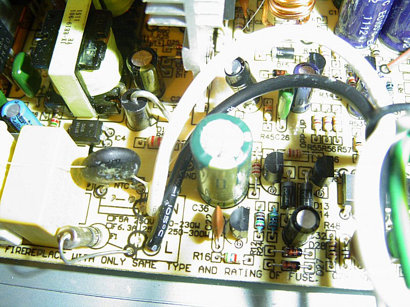

      You can even see on the PCB on the 4th picture that the fuse is listed for two models, one for 230w max, one for 300w max.

        The input filter needs an extra coil.
        It is a 250watt unit that might do 300W for some seconds.
                Excuse the noob question, how do you deduct that wattage from the MJE13007 specs?
                And the label says 'FUSE RATING: F6.3A', so 300W tops (if).
                I was thinking the same. Maybe placing it in that empty lower left corner with the wire? I could cannibalize ferrite coils from some old PSUs.
                There is any MOV in this PSU? Could this little blue thing in the left be a MOV? Or is it an Y-cap?:
                Any guesstimate for the % efficiency of this PSU?

                  It's a Y cap. No MOVs here, except if they are placed behind the big caps.
                  I don't know if you can add a coil when there is no empty slot on pcb. On the contrary, adding extra X cap or Y caps (when needed) is much easier.
                      The 13007 transistors are very old and common (seen datasheets showing them as early as February 1999), found in lots of power supplies with similar designs to yours:
                      http://www.digikey.com/product-searc...376376?k=13007
                      In lots of reviews I saw, they tend to pop when going and staying over 320-350 watts for longer periods of time.
                      It varies on how good the heatsinks, the main transformer and other factors...
                      The fuse will always be a few Amps above the maximum load the psu can handle, to factor the high pulses of current when the psu is actually powered and the main capacitors charge. There's a burst of current for a second or so when you plug it in. During normal operation the current decreases.
                      As for efficiency, I'd say about 65-68% below 50-80 watts, about 70-75% up to about 200 watts and then going back down to about 70% above that.
