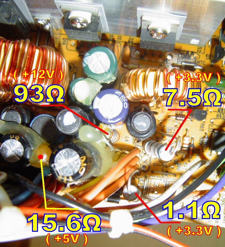

          Ok this is very confusing, I did my best.
          7.5Ω:
          · Both resistor legs beep between them.
          · Both resistor legs beep to black cable in molex.
          · Leg 'A' of resistor beeps to center leg of +3.3V rectifier.
          · Leg 'B' of resistor beeps to center leg of +3.3V rectifier AND to center leg of +5V rectifier.
          1.1Ω:
          · Leg 'B' of resistor beeps to center leg of +3.3V rectifier.
          93Ω:
          · Resistor legs do NOT beep between them.
          · Leg 'A' of resistor does NOT beep to black cable in molex.
          · Leg 'A' of resistor beeps to center leg of +12V rectifier.
          · Leg 'B' of resistor beeps to black cable in molex.
            #85
            Re: Cheap PSU: Piece of junk or semi-decent?
            Well under 10 ohms it usually beeps. In these low values, go not only for sound, but also for value on DMMs display. There should be 0.0 for it to be direct joint;-) Mine DMM also shows 0 if it is under 1,5 ohm - than check that with resistance meter.
            Judging from their position, 93 is on +12 V, the other two on +3,3 V.
              #86
              Thanks Behemot, that cleared my rookie brainstorm .
              7.5Ω (+3.3V rail)
              · Leg 'A' of resistor beeps to center leg of +3.3V rectifier (.000)
              · Leg 'B' of resistor beeps to center leg of +3.3V rectifier AND to center leg of +5V rectifier (.015)
              1.1Ω (+3.3V rail)
              · Leg 'A' of resistor beeps to center leg of +3.3V rectifier (.001)
              · Leg 'B' of resistor beeps to center leg of +3.3V rectifier (.000)
              93Ω (+12V rail)
              · Leg 'A' of resistor beeps to center leg of +12V rectifier (.000)
              · Leg 'B' of resistor beeps to center leg of +3.3V rectifier (.007) AND to center leg of +5V rectifier (.015).
              Are the multimeter resistance readings valid while the resistors are soldered in the PCB?

                #87
                Originally posted by Behemot View Post
                May wanna do flying resistor mod too
                That will work as well if you don't have any suitable replacement resistors. Personally, I don't like "flying" components, though, because if they are not secured well, they can short out on something. And in my experience, the short circuit protection in these Deer/Allied/L&C isn't very sensitive (actually, not at all).
                Originally posted by TELVM
                Argh, there goes my 'productive +12V dummy load'
                It is a nice 3.3V/5V load though. I have several Radeon 9700 video cards and they pull similar power from the 3.3V/5V rails. They make the PSU rails very balanced if used in a 12V-based PC.
                For the most part, YES. They may be off by a few Ohms, but that's okay. I usually go by the printed color code on them. And to see which rail they are on, I just remove the PSU board from its case and trace where they go to.
                For these older Deer/Allied/L&C PSUs, I can tell you for sure that the "93" Ohm resistor is actually a 100 Ohm resistor (color code Brown, Black, Brown, Gold - just Google resistor color codes) and it's for the 12V rail. The "7.5" Ohm is likely for the 3.3V rail. The first band on its color code is blue, though, so it's actually 6.x Ohm resistor. Perhaps 6.8 Ohms? (Blue, Gray, Gold, Gold).
                As for the "1.1" Ohm resistor, I'm not sure what that is on. It has too low of a resistance to be on any of the rails. If it was to be on the 3.3V rail, then it would dissipate (3.3 V ^2) / 1.1 Ohms = 9.9 Watts - and that can't be the case because judging by the resistor size, that resistor is probably only a 2 or 3 Watt rated resistor. At 9.9 Watts, it wouldn't last more than a few moments without burning. And if it was on the 5V or 12V rail, forget it - the thing would burn as soon as the power is turned on - so it can't be on those rails either.
                So, for the "1.1" Ohm resistor, you would have to remove the PSU PCB from the case and follow the traces. It may be that the "7.5" Ohm resistor is connected in series with the "1.1" Ohm resistor.
                If you don't want to do any PCB tracing, another way to measure the resistance of the resistors on those Deer/Allied/L&C PSUs is to connect one of your multimeter probes to a ground on the PSU (a black wire on a drive connector is perfect), and then with the other probe measure the resistance for the 12V rail (yellow wire), 5V rail (red), and 3.3V rail (orange).
                Report what resistance measurements you get this way.

                  #88
                  I'm not yet familiar with resistor color codes, but I'll try:
                  · 93Ω: Dark brown / very dark brown or black / dark brown or dark red / gold
                  · 7.5Ω: Very dark blue or faded black / light brown or yellowish green / dark brown or dark red / gold
                  · 1.1Ω: Light red or orange / white / silver / gold
                  Originally posted by momaka View Post
                  If you don't want to do any PCB tracing ...
                  Errr not sure now what you mean by tracing. I looked for full continuity (beep + .000 in display) between the three resistors and the three rectifiers, and posted the results above.
                  Perhaps you mean visual tracing?:
                  ... another way to measure the resistance of the resistors on those Deer/Allied/L&C PSUs is to connect one of your multimeter probes to a ground on the PSU (a black wire on a drive connector is perfect), and then with the other probe measure the resistance for the 12V rail (yellow wire), 5V rail (red), and 3.3V rail (orange).
                  Aye aye, here we go:
                  · Black molex ground to yellow molex +12V: 93Ω
                  · Black molex ground to red molex +5V: 15.6Ω
                  · Black molex ground to orange mobo connector +3.3V: 7.5Ω

                      #90
                      Ha, spotted a hidden resistor lurking between the output wires. And guess what, resistance between its legs reads 15.6Ω. And guess what, it zero-beeps to the center leg of the +5V rectifier:

                          #92
                          ... You will need to do a few modifications on it, though. For example, the likely reason why one of its original caps cooked is because of the minimum load resistors. Using this photo as a reference:
                          http://www2.picturepush.com/photo/a/...g/11286455.jpg
                          note the 3 large resistors...
                          - 1 just below the bad Koshin cap you replaced
                          - 2 to the right of the orange wires
                          These are the minimum load resistors. More often than not, Deer/Allied likes to use low values for these so they end up generating a lot of heat and cook the caps. If you are going to use this PSU with a computer, then you can change those resistors.
                          Assuming you'd want to use this with your Pentium 3 PC, you can make the following changes to the load resistors:
                          3.3V rail: swap for 33 to 100 Ohms resistor (preferably 33 to 47 Ohms), 1 Watt or higher rated resistor
                          5V rail: swap for 56 to 270 Ohms resistor (100 Ohms works well, but you can go even higher than 270 Ohms if you're going to use this PSU only on 5V-based computers). Again, for power rating, you'll want 1 W or higher.
                          12V rail: 270 Ohms resistor or higher, 1 W rated ...
                          So if I get it correctly the problem with these resistors is that they dissipate much heat, and this heat can cook close-by components like capacitors. That's why you recommend replacing them with higher Ω, and hence lower W & lower heat resistors.
                          But these resistors must be there for some good reason (otherwise they'd discard them to save costs). Maybe they are for better crossloading management? If so perhaps it isn't such a good idea to lower its Ω.
                          I can think of several ways to tame the heat problem.

                                #95
                                Like I mentioned, Google resistor color codes and you will know how to read them. It's not hard and comes in very handy when you start messing with circuits more often.
                                Errr not sure now what you mean by tracing... Perhaps you mean visual tracing?
                                The multimeter can give confusing results sometimes, so I rather go by what I see.
                                Boom! perfect. You got a 100 Ohm resistor on the 12V rail, 15 Ohm on the 5V rail, and 6.8 Ohm on the 3.3V rail. Judging by your underside pictures, the "1.1" Ohm resistor along with the 2 diodes next to it appears to be in some kind of load-balancing circuit between the 3.3V rail and the 5V rail. I *think* you can leave that one alone as it probably won't cause harm since it's far away from nearby capacitors.
