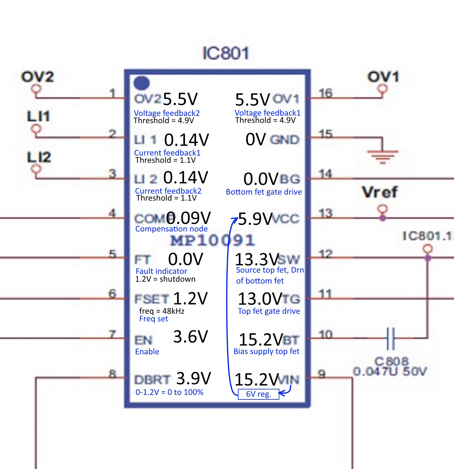

    Ok, so I took voltage readings on the MP10091 with all 3 resistors in place:
    Pin 1: 5.54V
    Pin 2: 0.136V
    Pin 3: 0.136V
    Pin 4: 0.092V
    Pin 5: 0.0V
    Pin 6: 1.207V
    Pin 7: 3.58V
    Pin 8: 3.91V
    Pin 9: 5.54V
    Pin 10: 0.0V
    Pin 11: 0.0V
    Pin 12: 5.88V
    Pin 13: 13.3V
    Pin 14: 13.01V
    Pin 15: 15.22V
    Pin 16: 15.19V

        You're quite right Dumah, my error. Should look like this, sorry for the error:
        Pin 1: 5.54V
        Pin 2: 0.136V
        Pin 3: 0.136V
        Pin 4: 0.092V
        Pin 5: 0.0V
        Pin 6: 1.207V
        Pin 7: 3.58V
        Pin 8: 3.91V
        Pin 16: 5.54V
        Pin 15: 0.0V
        Pin 14: 0.0V
        Pin 13: 5.88V
        Pin 12: 13.3V
        Pin 11: 13.01V
        Pin 10: 15.22V
        Pin 9: 15.19V

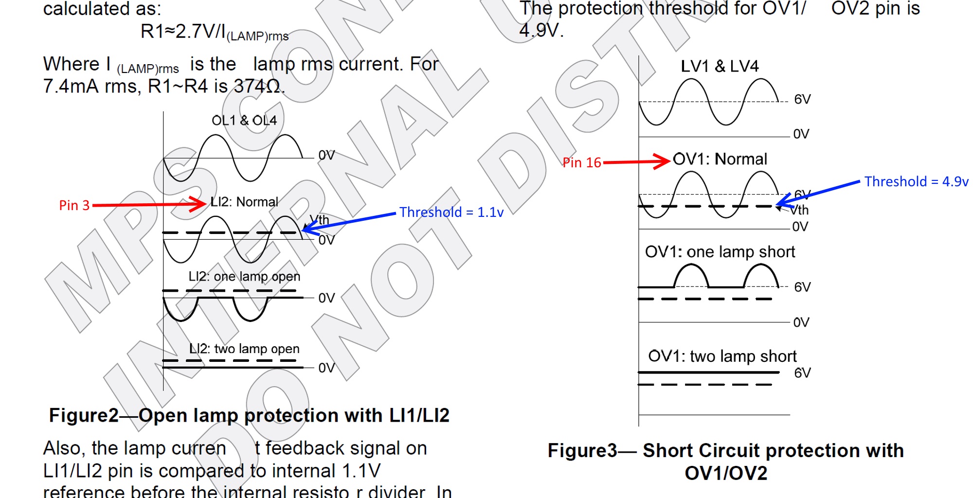

          • will62
            • Dec 2016
            • 229
            • usa

                    #69
                    Re: Benq G2255 doesn't power on - amber power light when plugged in
                    OK, chip appears shut down. I'm adding another pic with the voltages you measured. About this time, I'd be looking for gate pwm signal with the oscope.
                    But you won't see it if chip is down. Let's see what Budm recommends.
                    One oddity: Both gate drives should be 0V if chip is down. You have 0V on BG (bottom), But 13V on TG (top).
                      #70
                      I would put the scope pin on the GATE drive pin and keep it there then power up the board and you should see the drive signal, if the drive signals are present for both GATE that means the inveter transformer primary will get the drive Voltage and will try to fire up the lamp if that does not happen then to protection will kick in, or if it detects over current when the MOSFET are driven, the protection also kicks in, this will happen very fast. the circuit will have to try to drive the lamps first if there is problem (I.E lamp do not conduct) within set time then protection will kick in.
                      The typical protection circuit used in the CCFL will shutdown the circuit:
                      1) It will detect if the lamp will conduct current and stay conduction when the Firing Voltage is applied to the lamps, if the lamps do not conduct then the shutdown occur. The detection circuit detect the error on the lamp return side of each lamp, so one bad lamp will shutdown the circuit. Some circuit may try to fire up the lamps up to three times.
                      2) if the lamps are not connected then it will detect no lamp current flow due to no load connected so you do not want to have over 1000V at the lamp connector present without load otherwise it will start arcing to the near by circuit.
                      3) Over current will also shutdown the circuit.
                      Some circuit may have 3 seconds timer, if the false is present during the first 3 seconds then the circuit is shutdown, thus 3 seconds to black, everything has to be working within 3 seconds for the circuit to stay on.
                      The MP1009 looks to have only 300mSec.

                        #71
                        Hello gentlemen,
                        I have to admit that at this point, I feel a little confused although I understand your explanation Budm, I think this is getting beyond my skills for repair.
                        We are trying to get the inverter working, but I also have a problem with the logic board, so down the end, it might not be economically viable to repair this monitor? What do you think?
                        Also, there seems to be 2 gates but only one Mosfet and one inverter transformer?
                        Budm, you didn't comment on this quote? Is this normal?
                        On the mosfet, I measured again between S1 and D1 and get 475K, on S2 and D2 I get 47K?? Should I be measuring it out of circuit? On that topic I succeeded in removing a AF4910N from the other board. When I measure S1 and D1, I get mega ohms resistance, same from S2 to D2.

                                  #76
                                  I would go back to post#70 and do what Budm recommended. While you've got everything set up, go ahead and look at the pic in post #65. Check the waves on OV1,2 & LI1,2. Check voltage ripple as well. As Budm mentioned, shutdown will happen quickly, so you need to start each test from power off, caps drained.
                                  Some other notes:
                                  1. Based on the 13V not coming from gate, and your previous mosfet checks, that mosfet may be OK.
                                  2. We have a pin-out of the MP10091ES, but no datasheet. I've been going back to the MP1009 datasheet, hoping that the pin specs are similar. They may not be.
                                  3. If chip is shut down, I'd expect both gate drive pins to be 0V. I may be wrong here, need someone else to chime in.
                                  4. The datasheet for Mp1009 shows that the max pwm voltage on pin 8 (dbrt) is 2V. Right now we have 3.9V jumped to that wire. Is that causing a problem? May be different for MP10091ES.
                                  Hope you don't quit, it's just starting to get interesting.
