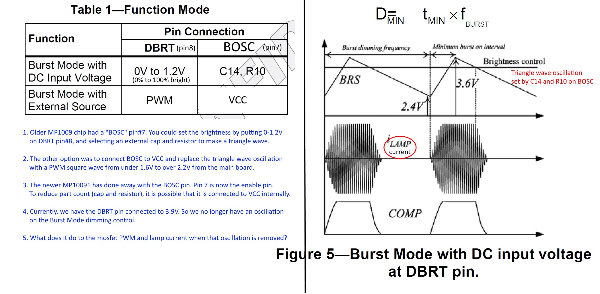

              I'm adding a couple of diagrams from the MP1009 datasheet and some comments. This is pertaining to my above comment about the signal from the main board. Do you follow what I'm talking about on it?
              The mosfets may test differently, the lamps may be suspect, but when you disable current monitoring, both lamps come on immediately without any flicker. We haven't found any bad parts yet, and we've got to consider that there may not be any.
                    Oh yes I understand very well what you are talking about. Just not sure how to rule this out without getting the main board working....I was able to get the firmware in a zip file for this monitor from a Russian website. Maybe we could try to flash the firmware and see if that fixes it?

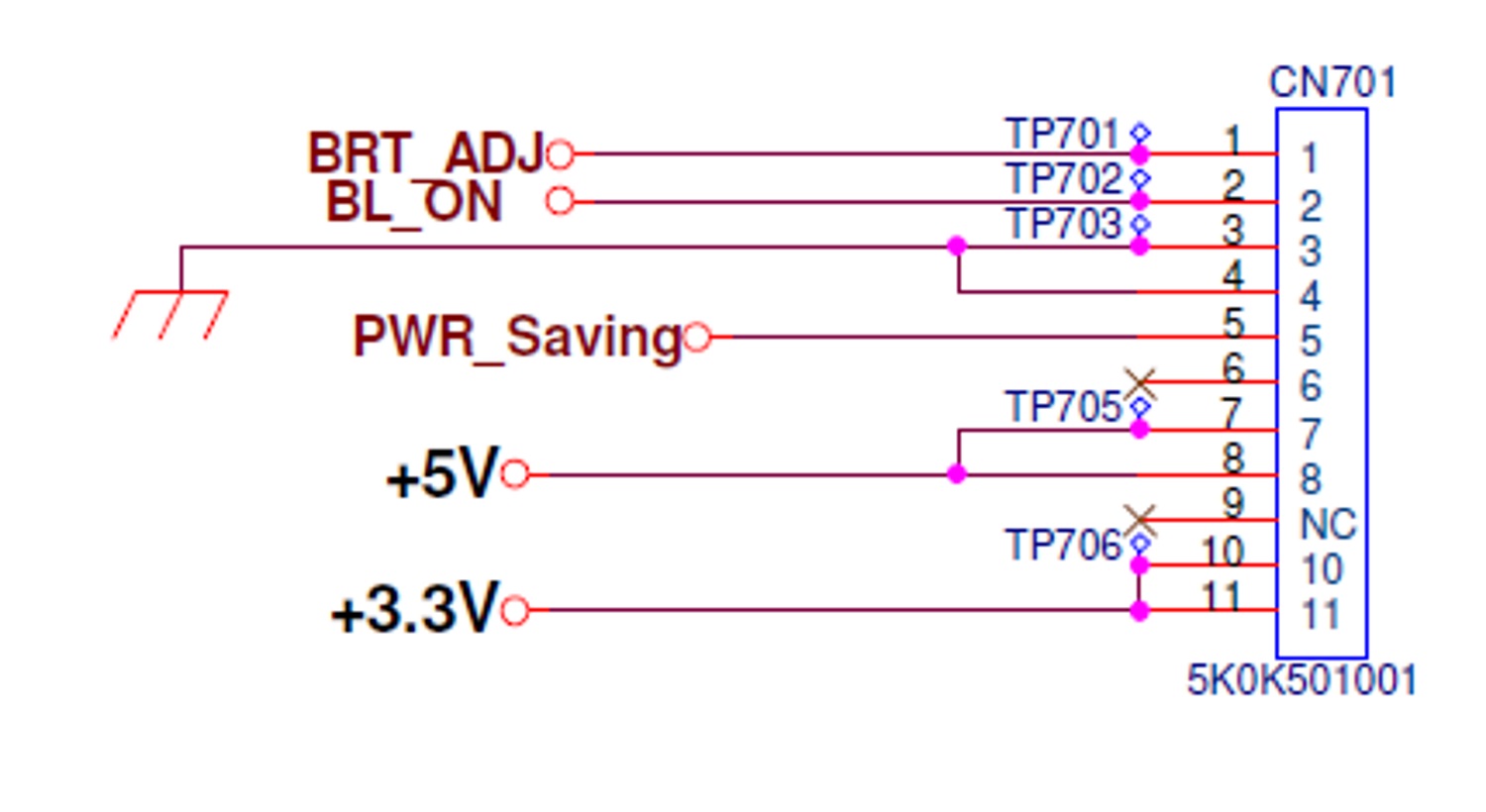

                          Ok, I noticed that we have 3 resistors one on the blue, one on the green and on the white all with 5 volts. Not too sure what wire is the dimming is it the blue? The green would be enable and what is the white?
                          I think Will you said pin 7 is the dimming, so I am trying to trace pin 7 back to the connector but I get lost along the way?
                          I resoldered the diode and made a 10K resistor jumper, so I am ready to go, but want to do it the right way. Do I replace the 1K resistor on the blue wire with the 10K?

                            I think the connector is like the one in the pic. BRT_ADJ would be pin 1. Jump the 1k from blue to 3.3V

                              Will, 2 things. Do you mean the 1K resistor or the 10K resistor on 3.3V?
                              Also, in the diagram you just attached (which is right on with my connector) we have a 1K resistor on the power saving mode (pin 5)...should I remove that, maybe that is causing us the headaches, no?

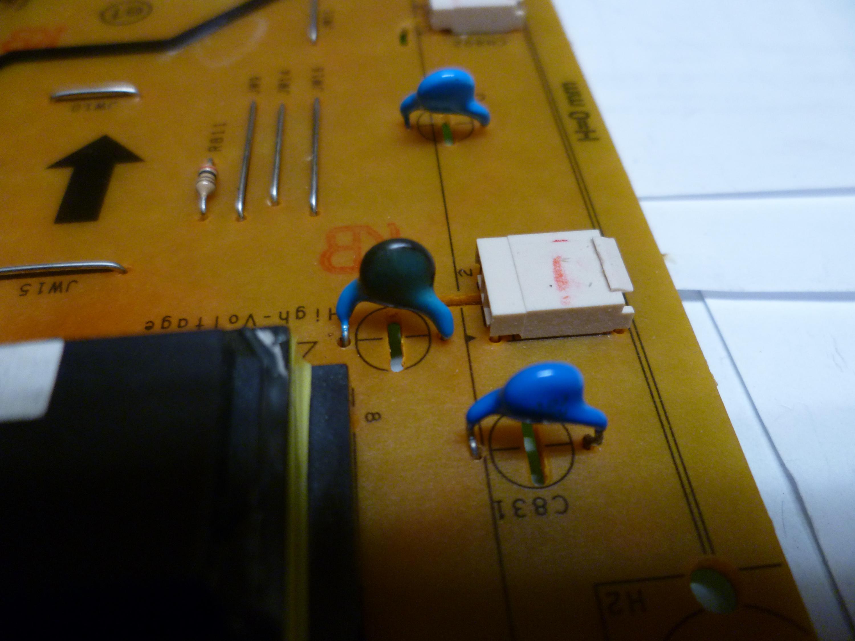

                                Oh, oh, things are getting weirder. I decided to switch the blue wire on to 3.3V with the 1K resistor and try it out.
                                Before making the test, I measured voltage on the blue pin with board upside down...I got 3.228V. While I was doing that I was hearing like a very faint crackling noise so started to investigate what it could be. Then after a few seconds I saw a bit of smoke coming from under the board (the top side) so I unplugged everything.
                                Turned the board around to inspect it and this is what I found. C817 had started to roast (see picture).
                                I haven't touched anything, just measured resistance at C817 and I get approx. 450ohms like before.
                                What's going on?

                                  Re: Benq G2255 doesn't power on - amber power light when plugged in
                                  I was talking about 1k from 3.3V to blue power saving. I can't find anything that says what the normal signal to power saving should be. Looks like your original jumpers had 5V going to it. Just move it over to 3.3V (orange). You can try powering on with and w/o the jumper to power saving.
                                  I believe Dumah was talking about using a 10k resistor to lower the voltage going to BRT_ADJ. We need to get that voltage down to around 1.5-2.5V to see if that changes anything. If necessary, use the resistor divider I mentioned above
                                  On post 215:
                                  That's not good. C817 goes between the pins on the transformer secondary. I would remove it and check resistance between 7 and 8 on the secondary. Also check for shorts to ground. What could have caused that?

                                      Will: Ok, that is what I had, the 1K resistor connected from 3.3V to blue.
                                      Dumah: Yes I did power it on without the CFL's just wanting to check what voltage I was getting on the blue wire. I shouldn't...I thought that the power to the CFL's was turned off when they are not connected?
                                      Not sure what to do now. I removed the C817 and checked the resistance between 7 and 8 of the secondary and I get 453 ohms, just like before. That capacitor (charred) still measures 12pf. I inspected all my soldering, the last thing I had done was to put down the top pin of the diode and solder it and don't notice anything special. I have some 5 pf HV caps, and one of them measures 14pf (if my transistor tester is accurate). Should I put that one in place of C817, or the old 10PF that I still have, or the Frankenstein cap that I had made but dismantled?

                                        453 ohms is ok for the secondary. Good catch on Dumah for recognizing the cause. I wouldn't put ole crispy back in there. I believe that cap and the inductance of the secondary form a tank circuit. It's value determines the resonant frequency of the circuit. That's the point that the max power can be absorbed for hitting striking voltage. If you increase the cap value, you lower the resonant frequency. The opposite for lowering cap value. It's over my head to tell you how a 2pf difference would impact lighting the lamps. Better rebuild Frankie, or we'll be wondering about it down the line.
