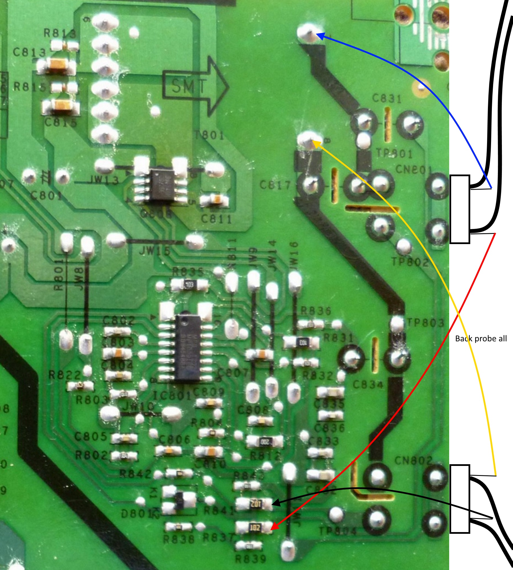

      #142
      Re: Benq G2255 doesn't power on - amber power light when plugged in
      Something quick to check... R838, R839 & R837 are used in the current detection circuit on cn801. R842, R843 & R841 are for the cn802 circuit. The pairings below should be very near each other on resistance check:
      R842-R838
      R843-R839
      R841-R837
      Also, is D801 marked "A1"?

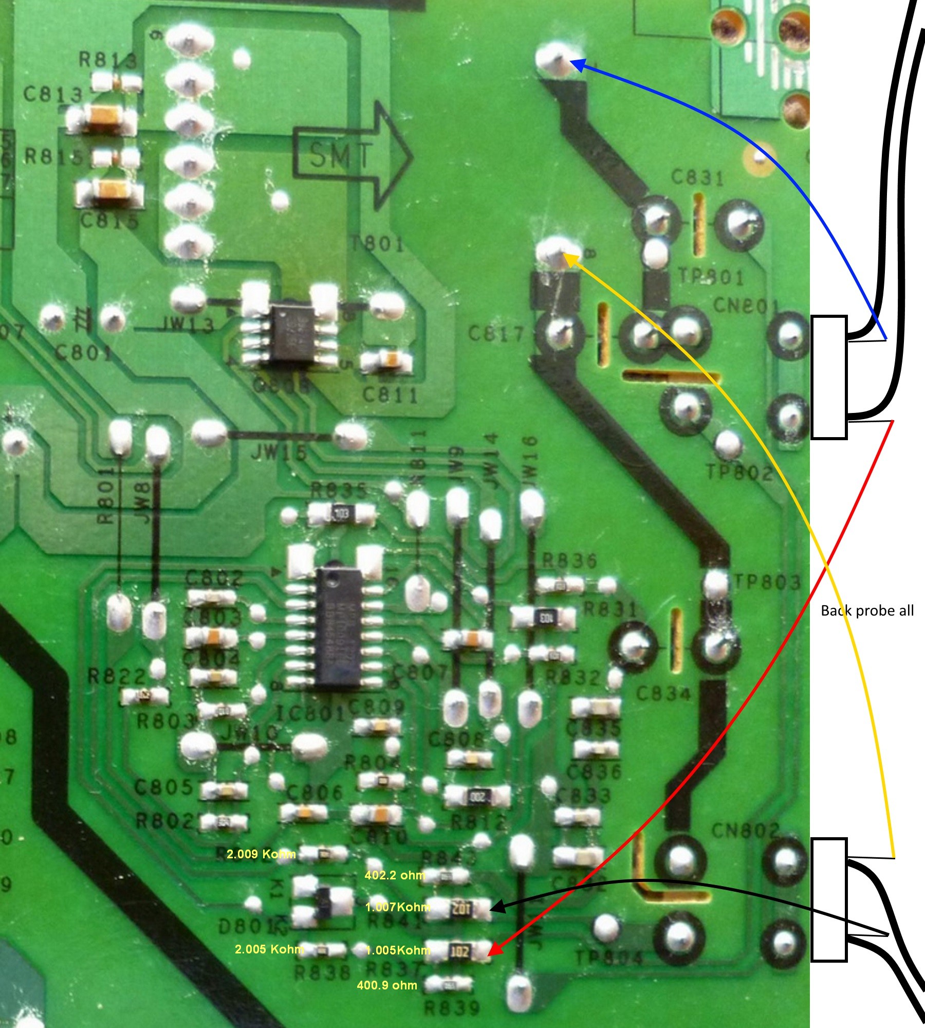

        #143
        Pairing of :
        R842-R838
        R843-R839
        R841-R837
        read the same value.
        Also, is D801 marked "A1"? Yes it is marked A1.

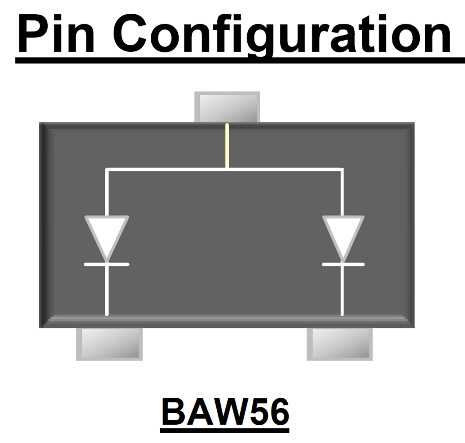

            #145
            The attached is a pin-out on that diode. Please check it. If not 100% sure on checking, watch a video on checking a diode.

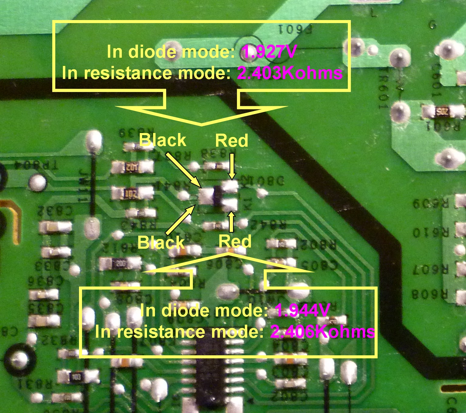

              #146
              These are the readings I get on D801.

                #147
                You're going to have to lift the top pin, or take the diode out of circuit. In diode mode, reverse biased (red to either of the bottom pins) meter should read OL.

                              #154
                              Here you go for the resistor values. Off to my surgical task of lifting that leg. Will report in a few minutes.

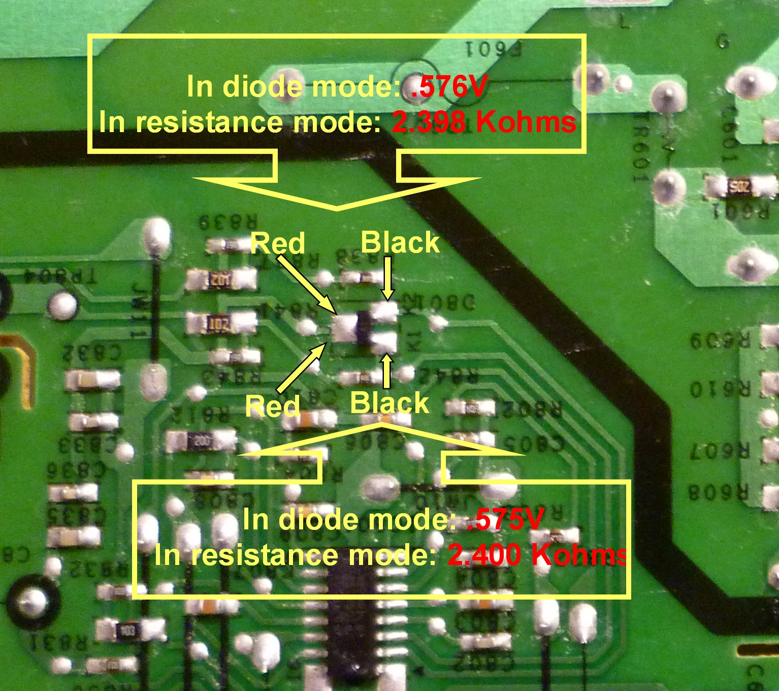

                                #155
                                Ok, Will, checked the diode. Lifted the pin, was fairly easy with your guidance.
                                Measuring in diode mode, black to lifted pin and red to either of the 2 other pins I get 0L. When I reverse the probes, I get .580V on one and .582V on the other.
                                Does that mean the diode is good?

                                    #157
                                    Diode checks good, you can put it back down. The chip is measuring amperage by checking the voltage drop across a known resistor, so it's actually looking for the voltage to be in a certain range.
                                    Might be a good thing to check the actual current on each connector so that we can see if there is a significant difference between them, or the chip just thinks there is because of an out of range component in the circuit.
                                    You'd have to lift the end of R841 and R837 (one at a time), and measure current between the lifted end of resistor to the pad it was lifted from. Power on, check lights and measure amps. (jumper on pin5)
