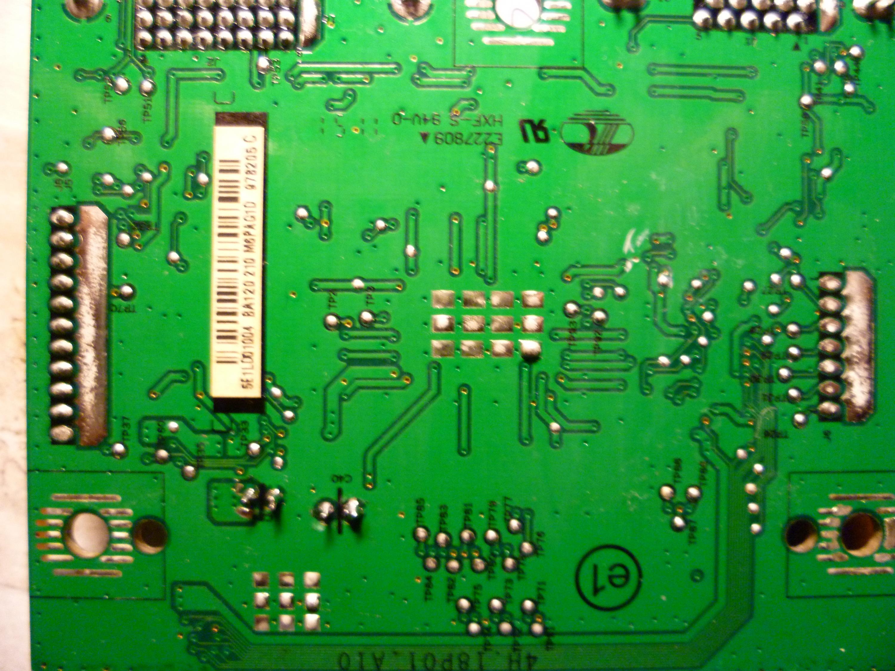

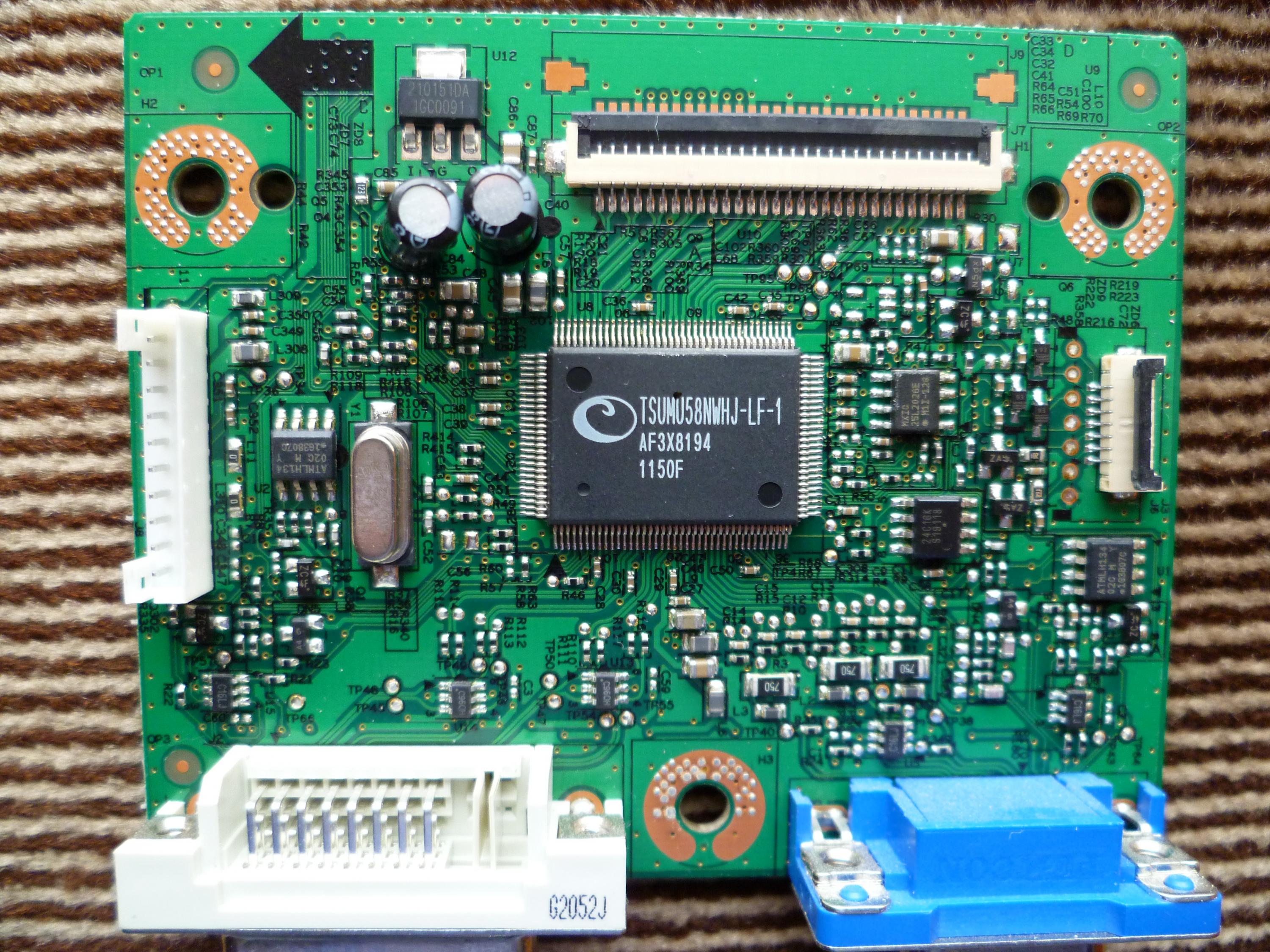

                    Started looking at my problem on the main board, and when I measure 3.3V to ground I get 80 ohms. That sounds a bit low, don' t you think. If it is too low, probably what is giving me that amber power switch light when I plug in the monitor. Any ideas what I should be looking at?
                    I inspected the main board but can't find any physical trace of anything. What do you think?
                    Photos attached to this post for convenience.

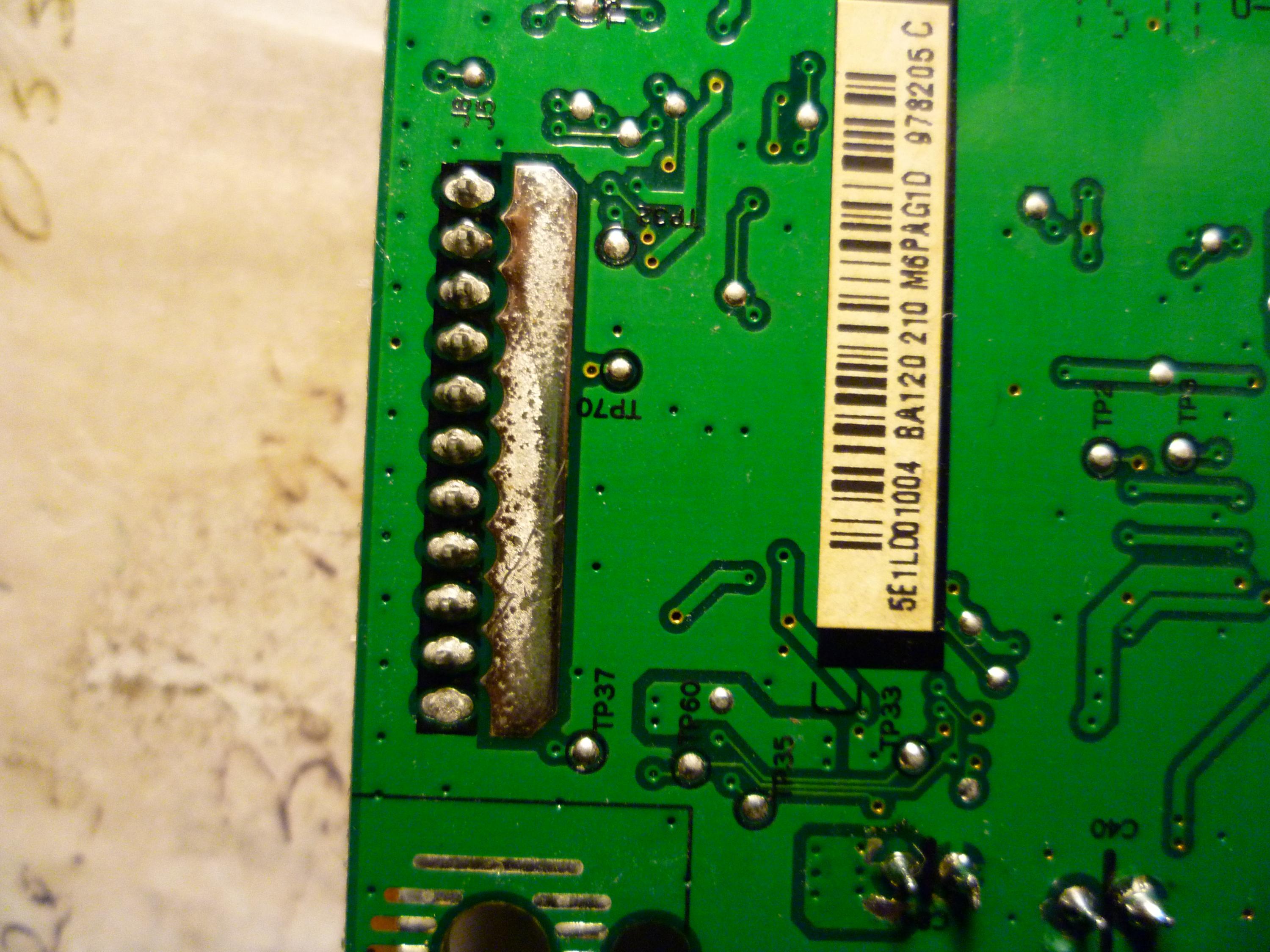

                      The 80 ohms does sound low. Above, you mentioned that the caps measured 85 ohms when removed. That sounds way too low for a good cap. You might want to remove those again and recheck resistance (3V to gnd).
                      Also, please check the area on the back of the board, circled in the pic. Looks like something scraped across the board there.

                        Hi Will62,
                        Tks for hanging in there. What I meant, was that the resistance was 85 ohms on the 3.3V to ground even with the caps removed. The caps I checked with my multi component tester and they tested fine...I also checked their resistance and it was in the kilo ohms, so they are not the culprit. So it has to be something else along the line of the 3.3v rail.
                        As for the picture, here is a closeup of the area with another photo of the underside after cleaning it up with isopropyl alcohol.
                        Will, could you review posts 9 and 10 and tell me what you think?
