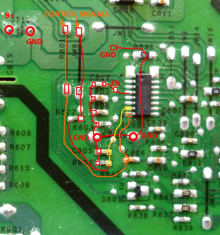

    We use the resistors to simulate the control signals of the main board, this is how you test the power supply board by itself.
    Could it be that if the supply board has a problem it would be why the whole thing doesn't start, just the amber power light that comes on?
    Any ideas what I should check next? I checked for the +17V (in the schematics), the +5V and +3.3V and they are all present.

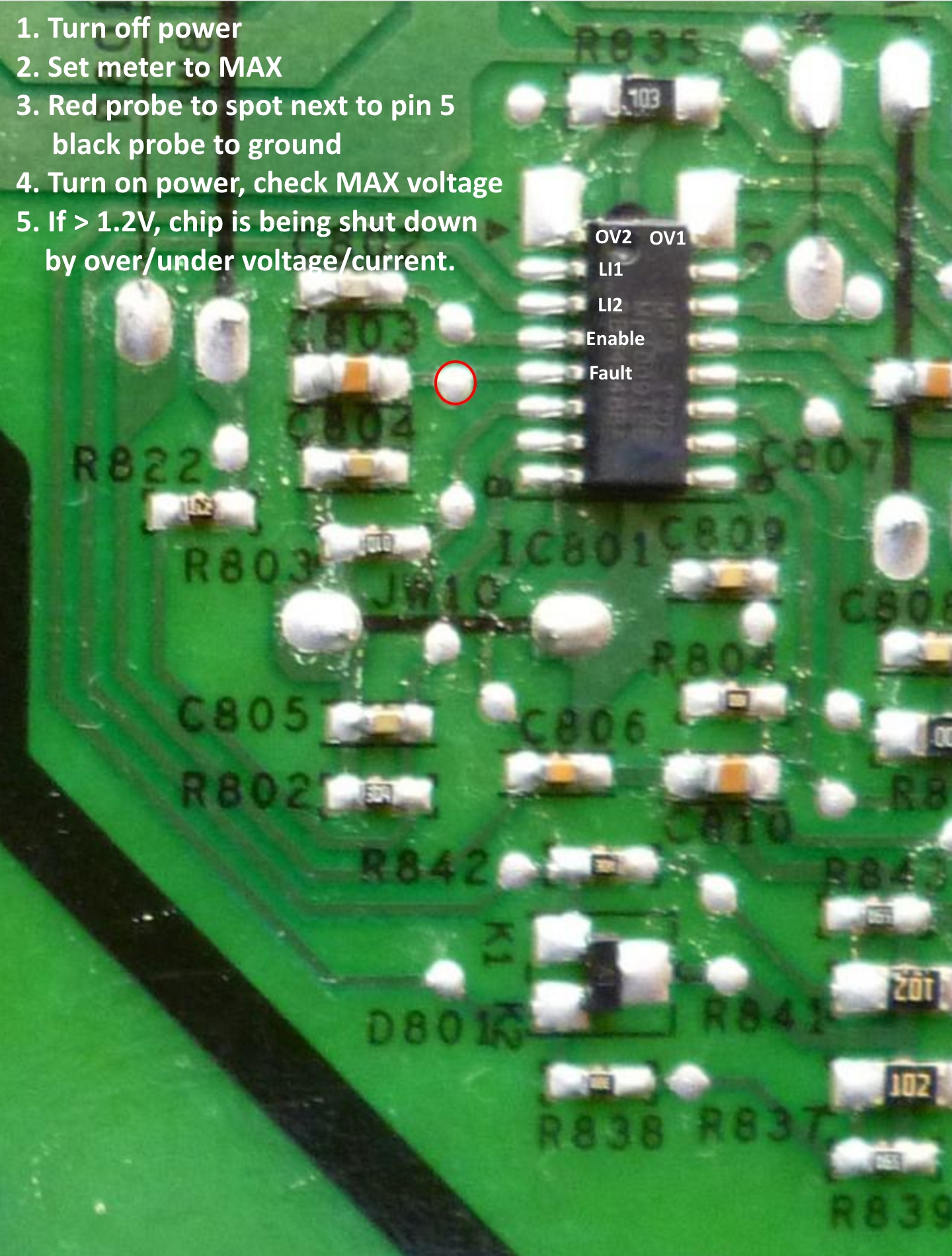

      The 8-pin SMD device on the right is the dual power MOSFET for driving the Inverter transformer.
      I wonder if you are getting the 12~18V on the Cap 801 to run the inverter circuit or not.

                  You will leave all 3 resistors in place while testing the power supply/inverter board by itself, isn't that what you have done so far?

                    No, I only had 2 resistors at a time, once the way you had mentioned to put them and the other time the way Dumah had said to try. Should I have 3 resistors i.e. the blue, white and green to 5V ?

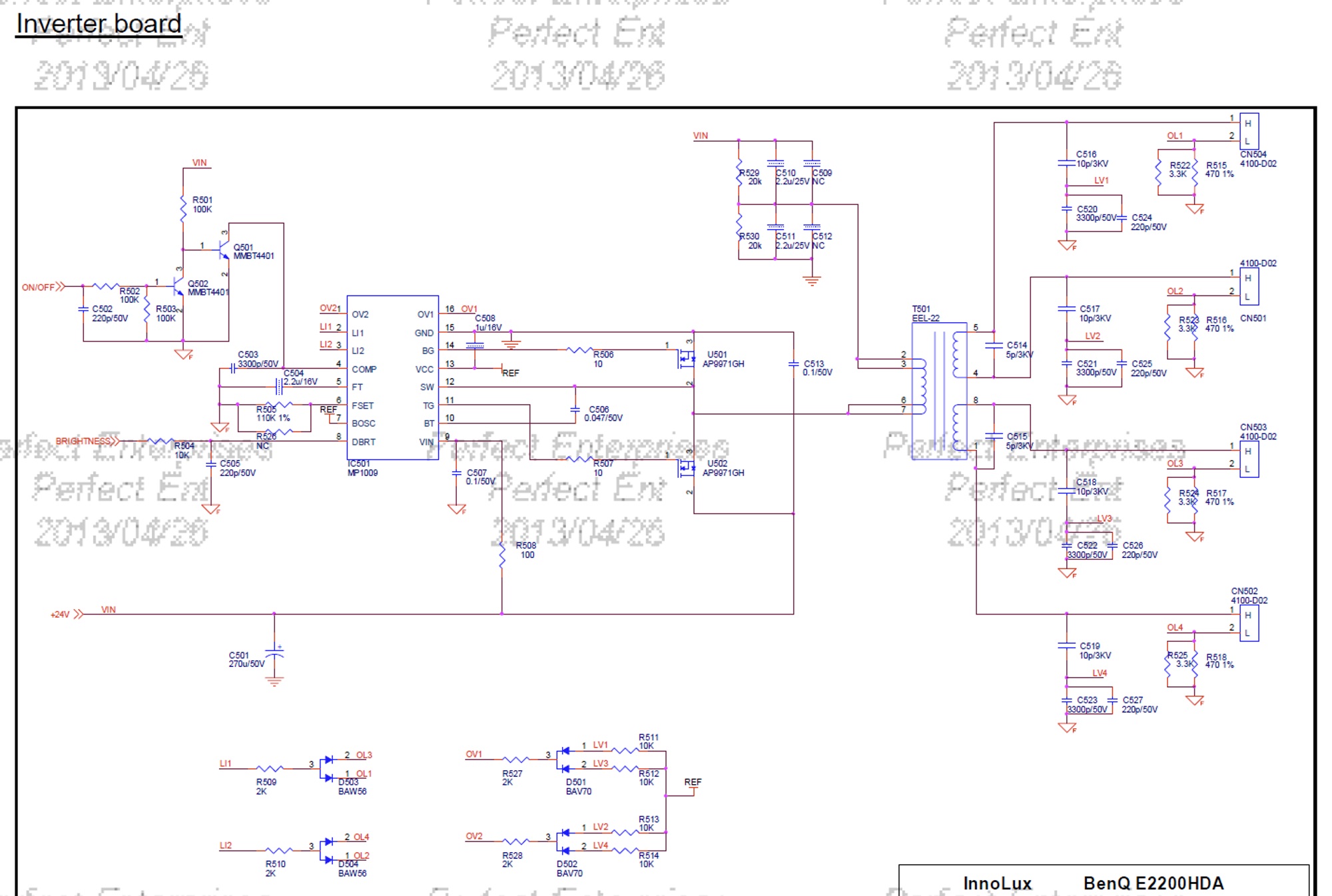

                      I've been following your progress on this BenQ. I'm adding a couple of pics that may help you until Budm gets back to you. The schematic is for a different model, but uses same/similar driver chip and dual mosfet. Hopefully it will help you follow how this chip handles fault detection.

                          I also found this schematic which seems to be very close to the one I have, attached.

                            You are not getting the Enable signal on pin 4, it should be >2VDC.
                            EN Function
                            The MP1009 has integrated EN function with
                            the feedback compensation pin COMP. A logic
                            low (typical below 0.5V) turns off the IC
                            . An
                            open collector (OC) si gnal is req uired as EN
                            signal which connected to COMP.
                            Can we see pictures of the board showing us how you have the resistors connected?

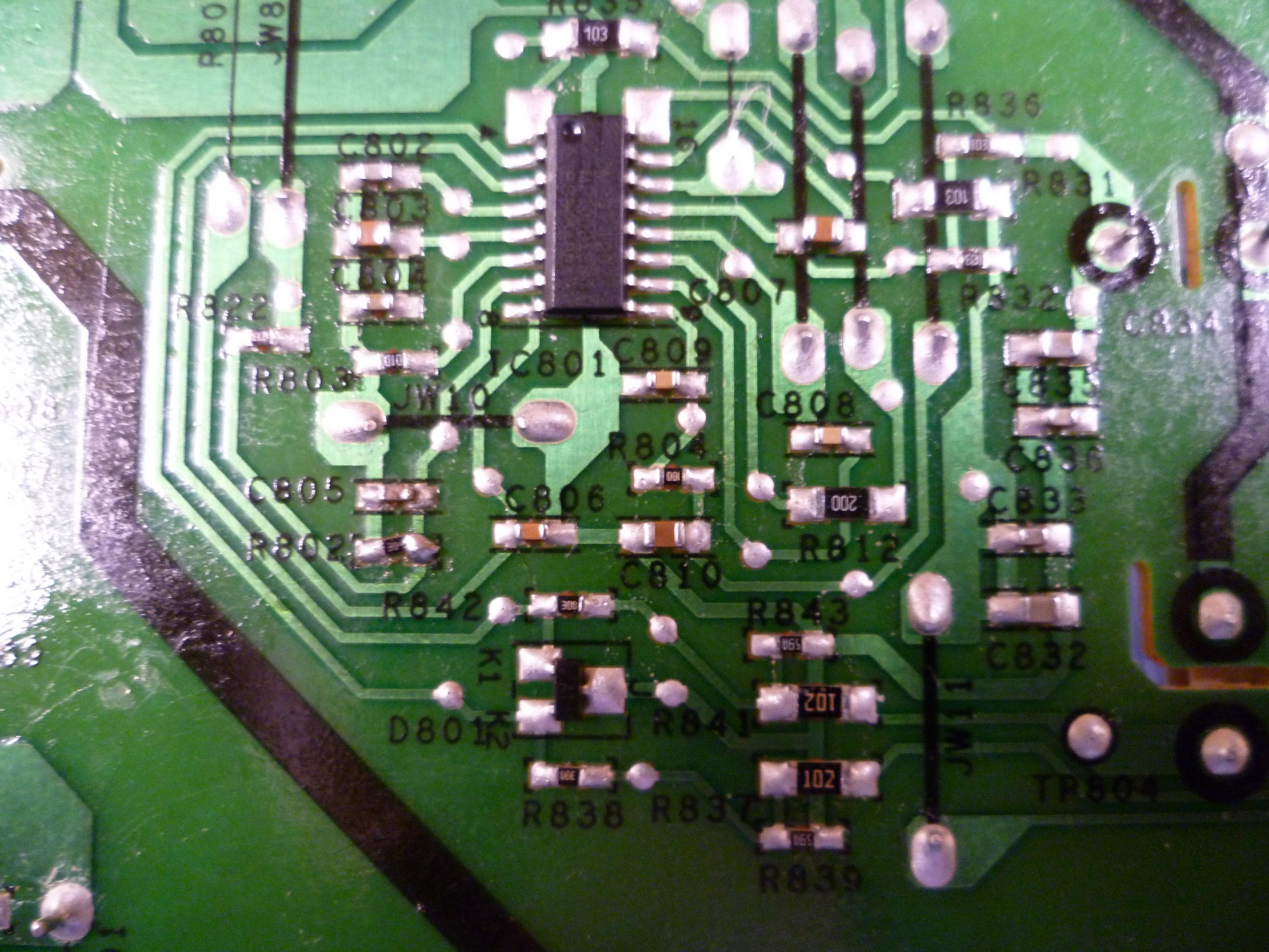

                              Here you go for the resistors. It might look as if the wires are touching each other in the photo, but don't worry they are not when I am under test.
                              I then traced the circuit that goes from the connector and feeds that pin 4, photo attached with voltage readings along the circuit. At resistor R802 is where the voltage drops. R802 is a 304 resistor, so 300K, I was getting a reading in the megahoms. So I changed that resistor thinking it was open with a good 304 smd resistor. I now get 30K reading in ohms and when I apply voltage, I still get .09V on the left side of the resistor???
                              So then I thought C805 might be the problem so I unsoldered it and tested it out of circuit 239pf, ESR 2.9, and without it soldered I still get 30K reading on the resistor, so I just resoldered back the capacitor. Tested the voltages again a second time to make sure, and I get what is in the picture???

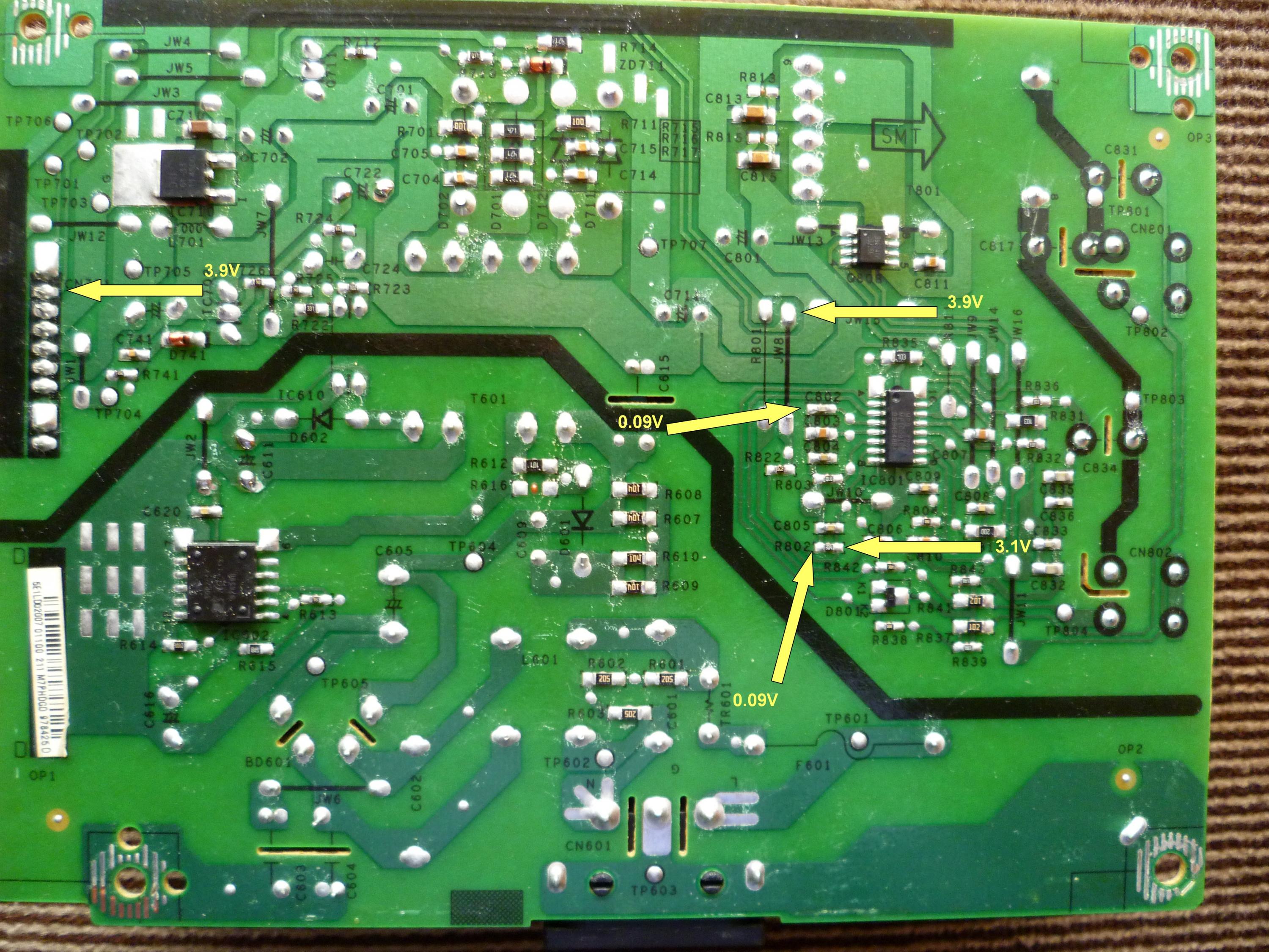

                                        " At resistor R802 is where the voltage drops. R802 is a 304 resistor, so 300K, I was getting a reading in the megahoms. So I changed that resistor thinking it was open with a good 304 smd resistor. I now get 30K reading in ohms and when I apply voltage, I still get .09V on the left side of the resistor???"
                                        BTW, that point in the picture that you show .09V on the left side of R802 and the other test point you show is CIRCUIT GND!
                                        What do you actually get at pin 4?
                                        BTW, the picture is not super clear for me to trace the circuits in real details so I am not sure if the traces for pin 7 (BOSC) and pin 8 (DBRIGHT) I marked are correct or not.
                                        Need to verify if the right side of R802 (left side of R802 is connected to GND) is connected to pin 7 of the IC or not.
                                        The circuit looks to be about the same as shown in the spec sheet of the IC.
                                        I can see EN pin 4 connected to cap C802 (another end of the cap is connected to GND) but I cannot see where else pin 4 goes to in the picture.
                                        Also you show one of the control line has 3.9V, what is the Voltage of the other control line?

                                          Good evening gentlement.....didn't have time to do the tests tonight, but I did take a closer picture of the chip and surroundings. The other side of R802 seems to be connected with the cap that goes to pin 4?
                                          The voltage I get on pin 4 is .092V, so if that is ground where does pin 4 get it's voltage from?
                                          Anyhow, I will do the tests that you asked Budm (and will do the test that Will62 suggested) and report on my findings very shortly. Thank you for your patience.
