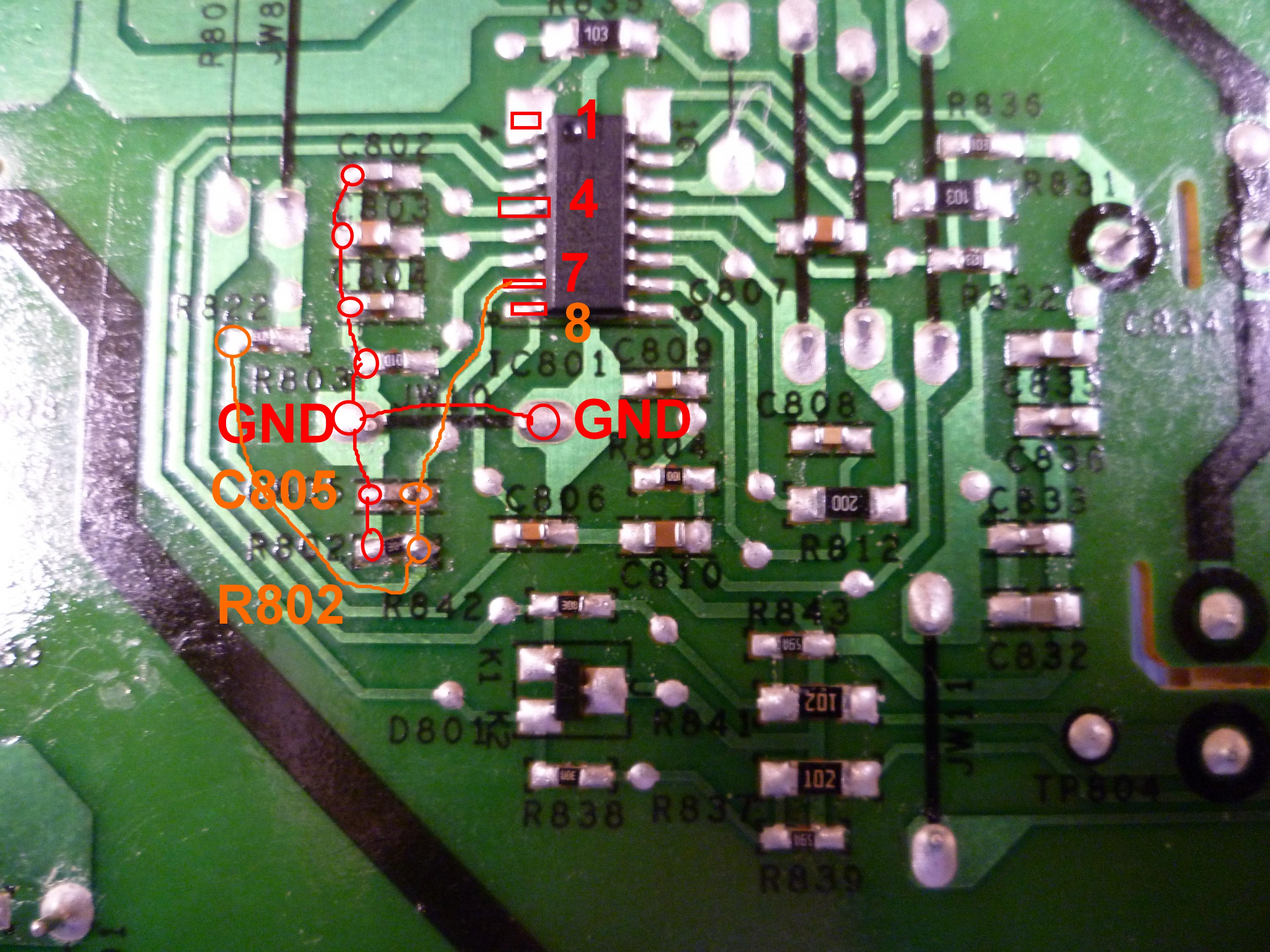

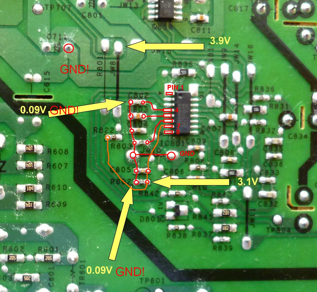

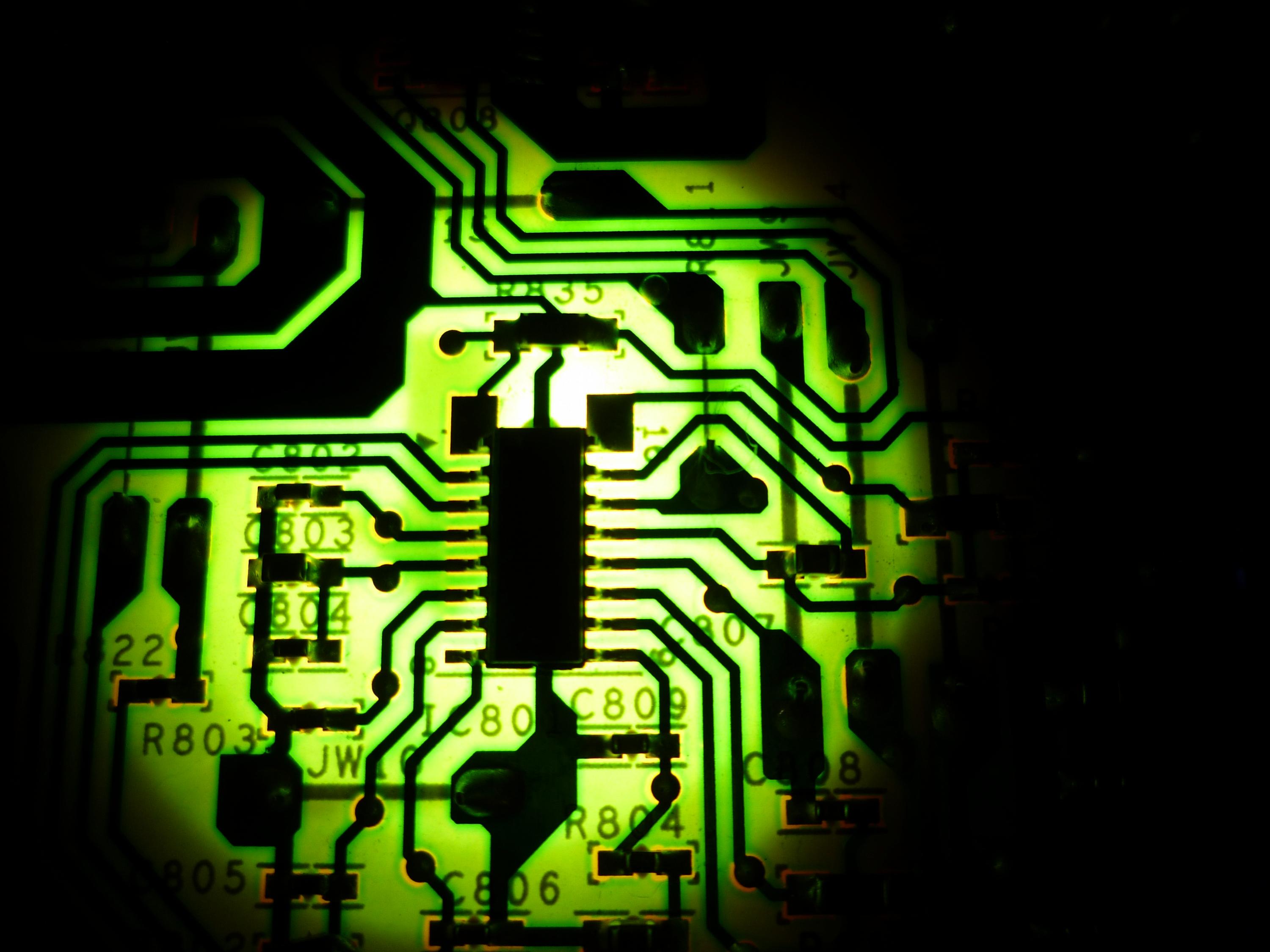

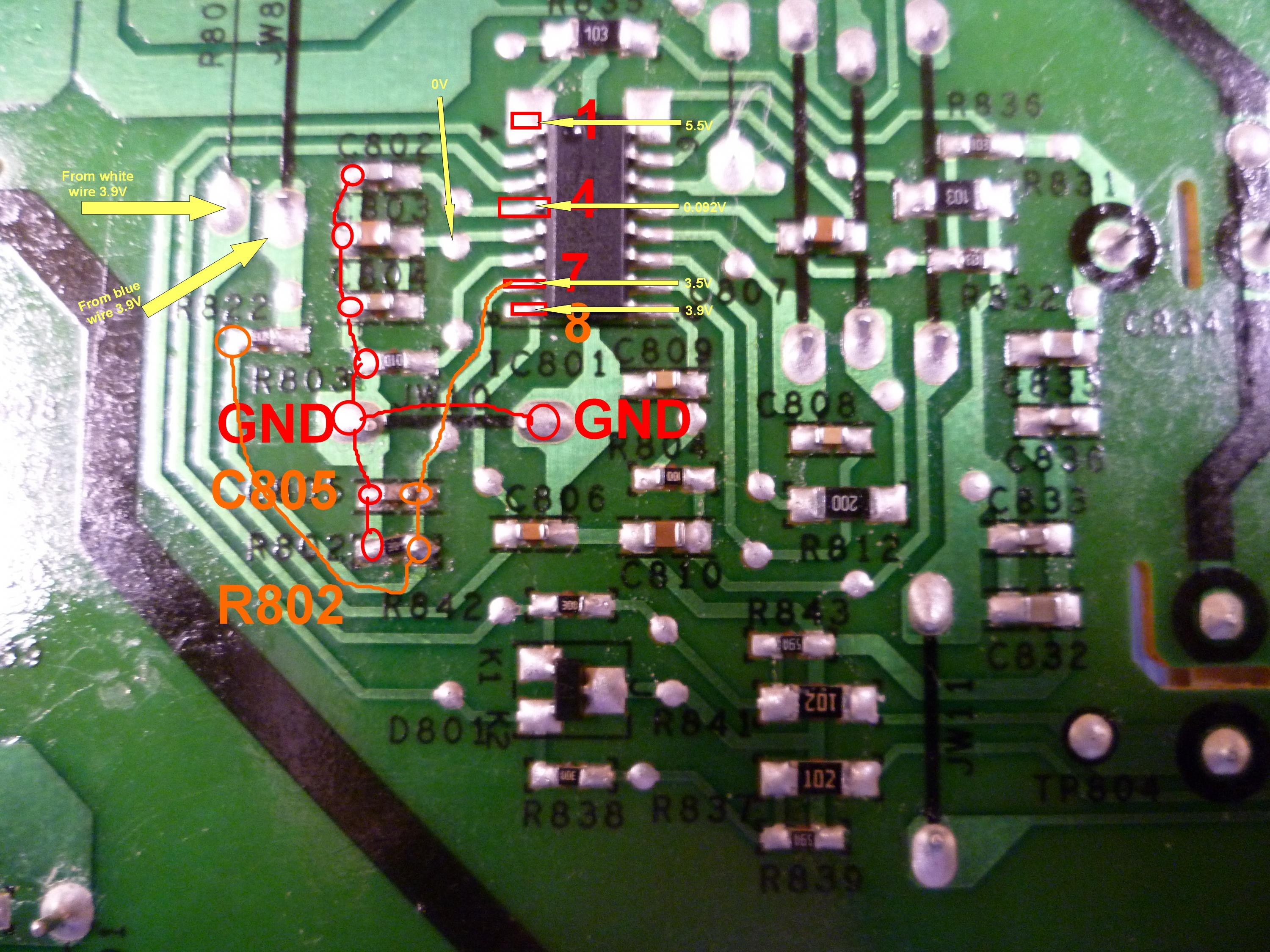

    Did you look at my pictures on post 39 that I clearly marked where GNDs are?
    Again, look at the left side of R802, it is connected to GND.
    C805 is also connected in parallel with R802, the right side of R802/C805 are connected to pin 7 of the IC, so I do not see how you can say that one end of R802 is connected to pin 4!
    Your picture here https://www.badcaps.net/forum/attach...6&d=1515675227
    Clearly show the reading of 0.09V at TWO PLACES, both if them are GNDs. I do not see any arrow pointing to pin 4 at all.
    See my new pix that I have marked again.
    It looks like I am getting wrong DATA from you.
    Are you sure you count the IC pins correctly or may be we are not looking at the same pictures same board?

      Re: Benq G2255 doesn't power on - amber power light when plugged in
      Hello Budm,
      I'm sorry, I am still learning at this stage and your drawing makes it pretty clear what is ground and what is not. I was measuring the right pins, on the pins themselves.
      I have attached annotated photos for the opposite side of the resistors to 5V and the voltages I get on the pins. I also measured the voltage on that point in Will62's photo for reference.
      Please bear with me, I promise to listen and try and understand the first time
      Many thanks for your help and guidance.
        #43
        So at this point pin 4 (EN) does not look like it is being use to turn inveter circuit on/off like as shown in the circuit.
        The two control signal lines seem to be going to pin 7 and pin 8.
        May be you have to trace out and see if pin 4 is connected to anything else beside C802.

          #44

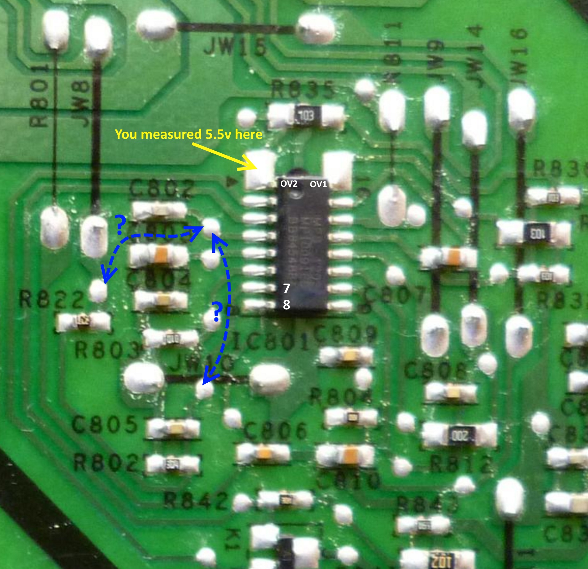

          I'm going to throw in a few notes:
          1. You measured 5.5v on pin 1 (OV2). From the datasheet: "If the voltage at OV2 is always above 4.9V, the controller will treat this as a short circuit condition after a certain delay. The Fault Timer will
          start ramping up."
          2. In order to use external PWM dimming (pin 8), pin 7 must be pulled high
          first. Is it possible that JW8 is covering 2 bases? Pulling pin 7 high, as well as activating pin 4 (enable).
          3. It is possible that the solder point next to pin 4 is over a via to a sublayer
          track that you can't follow. With power off, you could use your meter (resistance) to find where the track resurfaces.
          4. A little odd that you measured 0v on pin 5. Over 1.2v is supposed to indicate that a fault has tripped the protection circuit. Shorting pin 5 to ground, bypasses the chip's protection circuit. (I would get Budm's advice before trying that.)
            #45
            It is single layer board so that is just a pad for test point.
            I sure like to get the correct diagram, I am sure we can bypass the protection circuit but I do not really want to do that but we may have to to do the test.
              Has anyone ever purchased an S.M. from this site?
              http://www.service-manual.net/ashop/...?product=56211
              You might spend the $13, and get something generic, or similar to
              what you've found for free.
              Edit: Also, with power off, please check resistance between pin 4 and pin 7. There may be a trace under the chip. Thanks

                • Jun 2013

                    I tried to find a trace from pin 4, but it doesn't seem connected to anything, not even pin 7 which gives me 47 kohms resistance. Here is a picture with a light under the board.

                      I look real close at the pictures of the IC, the P/N as printed on the body is MP10091ES which I believe it is not the same as MP1009.

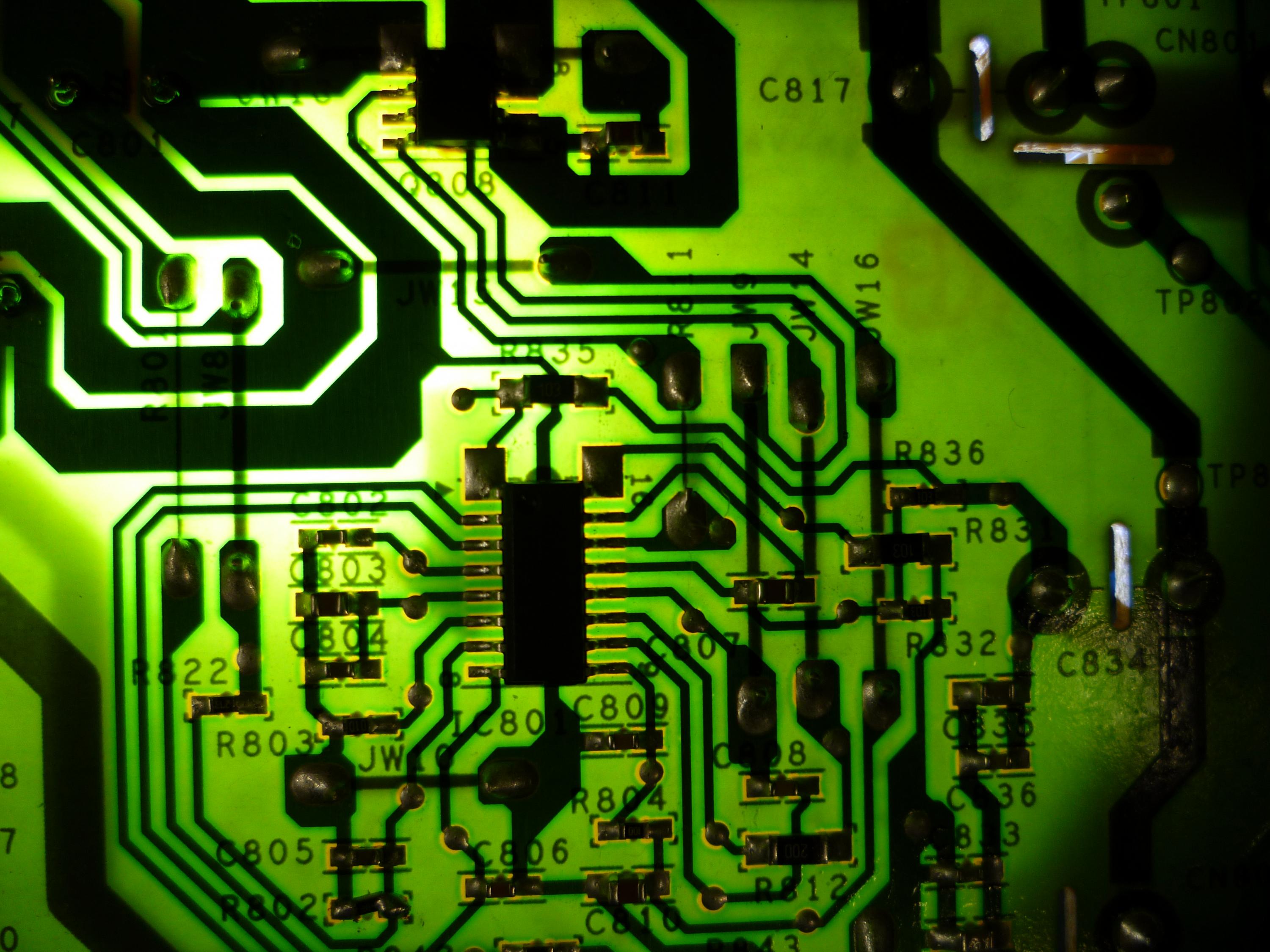

                          That last pic really cleared up the trace routes. Can you take another with
                          the light further back, so that we can see the traces all the way to the back light connectors and the ap9962?

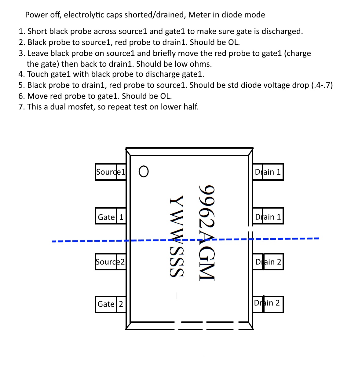

                          I'm including a pic that might help you check the ap9962. It's usually best to check them out of circuit, but you can try it and if you get weird results, just
                          unsolder the gate/source side, lift it slightly and retest.
                          Not sure what to think about pin 4 going nowhere. Most circuits that I've been
                          able to find using that chip, have the enable coming from the main board. Maybe default is enabled, until it is pulled low. It may be low now due to internal fault detection. (Have you ever checked to make sure that C802 is not shorted to ground?)

                            Thanks Will, here is another pic. Checked C802 and left side is to ground and right side to ground I get 1.4K ohm.
                            In the pic you include what does 0L mean? Do I set my meter on diode for all tests, because at one point it says I should get low ohm?

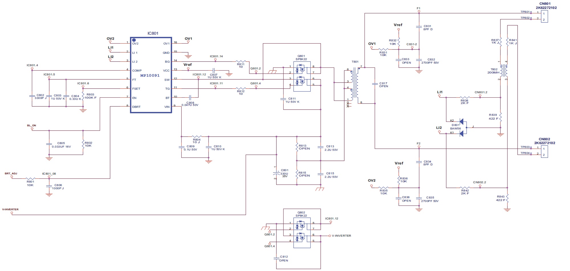

                              OK then MP10091... Pin 7 is enable.
                              Rddube: OL: open line/over limit. depends who you ask.
                              sorry, low reading, not ohms.

                                Man, I have been searching for the MP10091ES schematic, MP10091ES circuits and nothing really come up, nothing for the spec sheet either. Do you have the link where you get that from?
                                Finally clear out the confusion about the pin 4 of the IC. I am glad I took a closer look at the P/N of the IC.
                                  #56
                                  The power MOSFET, you just check the resistance between S and D pin, since it is dual MOSFET so you will test resistance between S1 and D1, S2 and D2. it should show high resistance.

                                    The schematic is from a Philips 22" that uses the chip.
                                    pdf

                                      Ok, did some tests in circuit for the power Mosfet. From S1 to D1 (there are 2 D1's) i get varying results, sometimes .5 MegaOhm, other times 47K and other times 475K ??? Same for S2 to both of the D2's.
                                      However if I measure S2 to either of the D1's I get 1 ohm, meaning a short?
                                      Should I remove the Mosfet (which will need hot air, I can do that) to test it?
                                      I'm confused but sure am glad to have you gentlemen (Budm, Will62 and Dumah) looking over my shoulder! Thanks to you so much!!
                                      PS - don't forget that this is the Power Mosfet for which I had mentionned in a previous post (#20) that there seems to be some heat marks under that chip, please see photo:

                                          When testing in circuit, you're dealing with other components in parallel. As Budm mentioned earlier, if you don't have a short between D and S, the chip is probably fine.
                                          Look at the dual mosfet in the circuit pic in post #54. See how pin 7 is tied to pin 3? That's why you are getting a low ohms reading between D1 and S2.
                                          On removing the chips, are you applying flux before heating? You should see the solder go soft when it's ready to lift. I would think the adhesive is softening by that time. You may need to pry beneath the chip to coax it. You can also lift each pin one at a time by using a dental pick (or similar) under the pin, as you heat the pin with your soldering iron. You don't need to lift much, a mm will do.
                                          Now that we have a good pinout of the MP10091, can you go around and take voltage readings for each pin? An earlier reading that you took on pin 1, indicated a short circuit fault. I would like to see what the other voltages are. Also, somewhere along the line, you are going to need to check all caps for shorts, and resistors for open. I'll defer to Budm on what to try beyond that.
