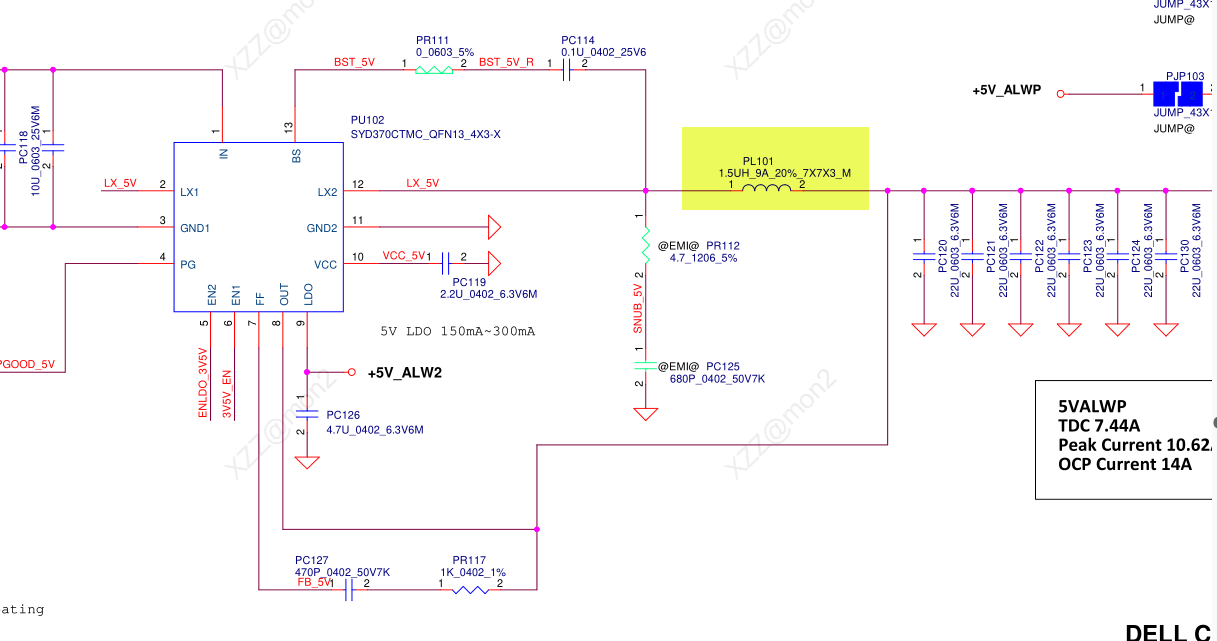

    I have this Dell Latitude 5420 with ST: CMF62F3, board GDF40 LA-K491P REV 3.0 that does not power on, i already searched for some clues about this problem that happens on mine but no BIOS i downloaded and flashed did anything.
    Only when the power brick is connected, when pressing the power button an amber light lights up at the front and slight decreases its brightness, the RAM and the CPU seem to heat up if the laptop is left connected but nothing else, other than USB devices getting powered.

    Update: Tested proper ME cleaned BIOS with the laptop's ST on it and no change in symptom.
    PU102 heats up as soon as DC is connected to the laptop too. but i do not know if that should be normal on this model.

      Remove all power. Meter in resistance mode. Measure the resistance to ground of the inductor @ PL101 (either side). Checking if there is a low resistance to ground on this power output rail = shorted part is present. Post the measurement in ohms. Suspects are the USB Vbus rails that consume the +5V.

        Measuring PL101 to GND gives 20.3Ohm

          So there is a partial short on this rail. Everyone attached is a suspect. Would you have a thermal camera?
          Review UI1 - pin 12. What is the resistance to ground here? If it is low, consider to flux and remove UI1 off the board and test again.
          Check UI3 - USB load switch in sot23-5 package. Test the resistance to ground of pin # 1. USB load switches often short out with illegal USB loads. If the resistance is low here, flux and remove this part off the board and test again.

            UI1's pin 12 gives some mega ohms that my multimeter cannot read and stays 0.L with a M at the top
            UI3's pin 1 reads the same as UI1's pin 12
            also no, i do not have a thermal camera, had checked PU102 with isopropyl alcohol method

              Removing PJP103 seems to kill the short on PL101's side. PL101's resistance to ground goes up to 204 K Ohms.
                +5V_ALW's resistance to GND now is 60Ohm after disabling PJP4 (and +5V_ALW_A_TBT reads 30Ohm), where to go from here?

                    UPDATE: +20V_TBTA_VBUS_1 29Ohm
                    +20V_TBTB_VBUS_1 is 240K Ohm (not affected?)
                    EDIT: PD_VSYS at RT248's pin 2 (although not present) and UT3's pin 3 is 0Ohm is that how it should be?

                          Your post #10 is a good clue. Review all parts on this low resistance to ground rail.
                          Start with fluxing and removing capacitor CT3. If the resistance to ground does not return to a much higher value, place this capacitor back onto the board.
                          Each part mated to ground on the 'EMI Part' red box are also suspects. It may also be true that the PD controller @ UT3 is 50% broken but doubt it for now.
                          I would flux and remove mosfet PQ1 off the board to essentially isolate parts of the board to hunt for the shorted part. Continue to review and post your updates here.
                          Most likely some USB Type C connector cross short during hot removal while the power adapter was @ 20V killed either the PD controller (partially shorting) or some other part on this network.
