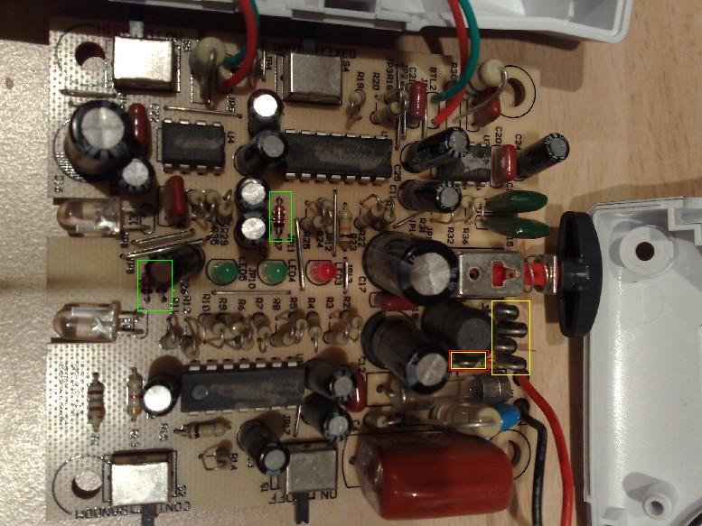

            Ok - so what if it's snake oil? I sleep easier for having it.
            I would like to point out that I don't have an infestation of spiders (or anything else) in the house at the moment. So getting the house fumigated would not really help. The device is supposed to stop the spiders coming in. That's all .
            Anyway, back on topic. I have removed the zener diode now marked in yellow and red, and tested it on my DMM, on the diode setting, both ways. I get readings of 001 in both directions. So I think I may have found the culprit. (Tested another similar looking diode on the PCB and got 001 in one direction and 717 in t'other).
            The question now is where can I get another diode? The lettering on it is "1N4740A" with "5T" underneath.
            Any help is much appreciated. Thanks.

              Re: Electronic spider repeller not working
              http://www.fairchildsemi.com/pf/1N/1N4740A.html
                Thanks - I think I've managed to order some from Farnell in the UK (free postage), so we'll see what turns up in the post.
                Fitting it is probably going to be another matter, but I'll let you know how I get on.
                  Fitted the new diode last night, then soldered the speaker wires and power leads back.... and....
                  IT WORKS!
                  (Well, the lights come on, and the test button emitts a sound, whether it will work as a repeller has already been debated on here!)
                  Thanks guys... I owe u
                      Originally posted by mrs sumner
                      IT WORKS!
                      Good job. If it fails again, use one with a higher power rating.
