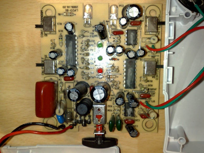

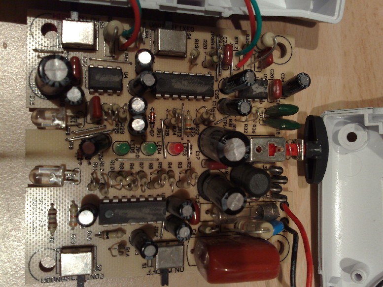

              • mrs sumner
                • Sep 2009
                • 8
                Re: Electronic spider repeller not working
                Well, here are the photos anyway (hope it works!).

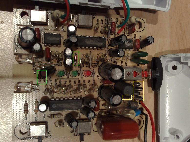

                Do you think it could be a diode problem? The four diodes (presumably AC/DC rectification) near the power leads show resistance in both directions, when I'm testing with my multimeter on the diode symbol. Is this correct? I thought they were supposed to pass current in one direction only, so would show next to nothing resistance in one direction and infinite in the other?
                  looks like it uses that big red cap as a "ballast" and the diodes to rectify.
                  are they zero in both directions?
                  also look for a shorted zener that would be used as a regulator.

                    Is it likely to be the big red cap, and how would I test it?
                    No, the diodes were giving a reading of something like 600, or maybe 0.6 in BOTH directions on the diode setting on the digital multimeter. But this was measured with them in place on the PCB. I'm going to remove one leg each off the board and try again...

                      no the big cap is probably ok.
                      is the fuse blown?
                      i would look for a shorted zener.

                        The fuse looks ok, and there's no resistance testing it end to end on the board.
                        Are zeners always a browny orange colour (like the ones I've boxed in green)? I would say there's three or four of them on the PCB. Then there are the black diodes I've boxed in yellow. They are not zeners are they?
                          Through hole zeners are almost always in glass bodies and orange.
                          Unlikely the bridge rectifier blew then it would have blown the fuse.
                          To test diodes set the meter to diode check don't use the resistance function. Reading in only one direction around 0.700 for GP diodes is fine.

                                        Back on topic I see they scratched the part numbers off the ICs I guess they don't want the competition stealing their snake oil .
                                        That aside if you have any more circuit questions post back.
