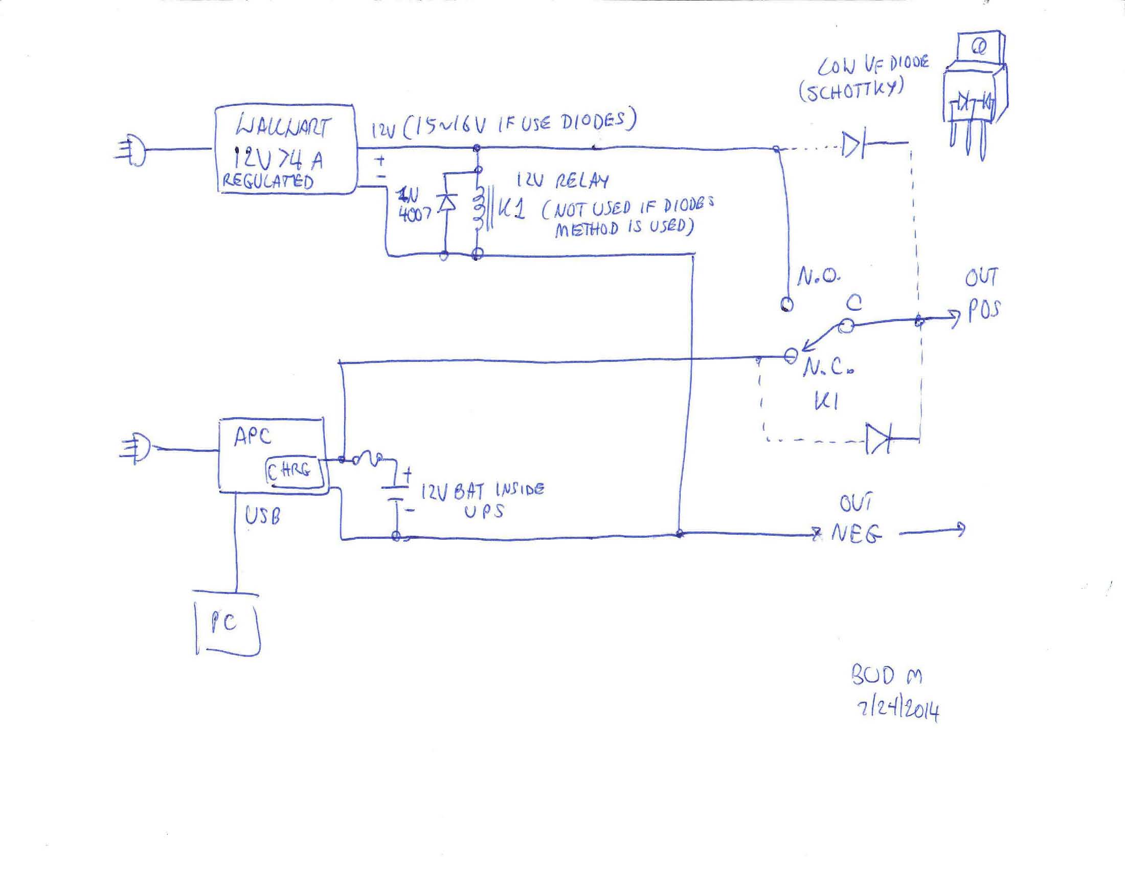

                      Are you going to use the relay or Diodes for switching?
                      Please measure the DC Voltage right at the batteries terminal with the UPS plugged in, you do not even need to turn on the power switch because the charger is an always on.
                      From user manual:
                      The Back-UPS ES should charge for at least
                      16 hours to ensure sufficient runtime. The unit
                      is being charged whenever it is connected to
                      utility power, whether the unit is turned ON or
                      OFF
                      Then check your computer to see if you communicate with the unit.
                      The relay method is probably the best way with minimum power lost.
                      If you are going to use diode switching, the Wallwart will have to be around 15~16V range.

                        Re: help with a APC ups mod
                        I figured I would use the relay method.

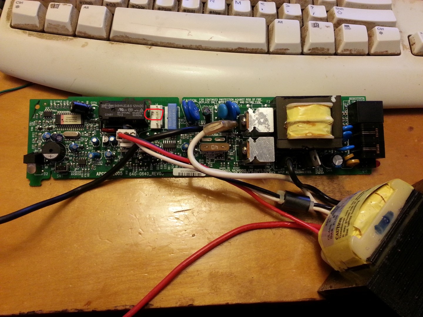

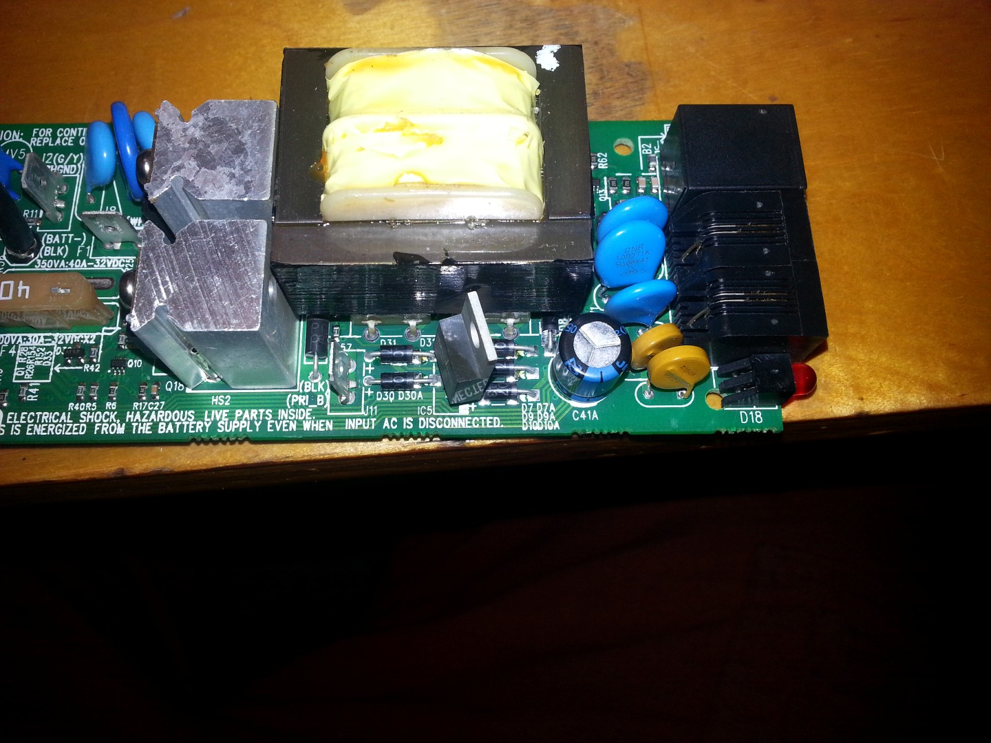

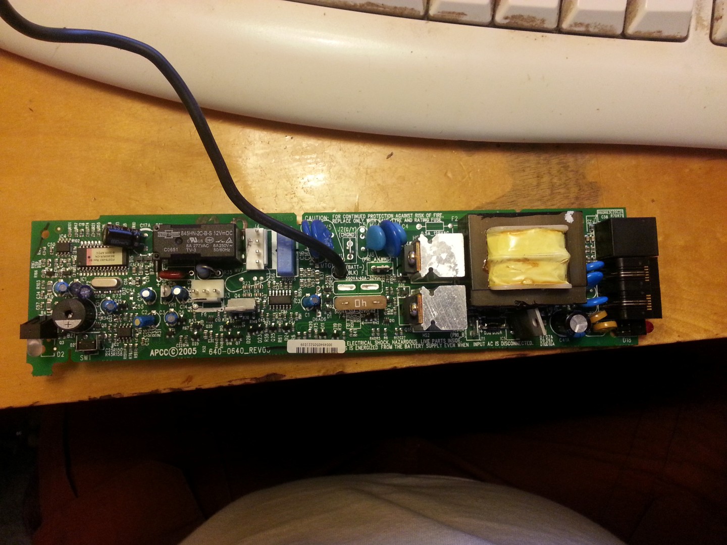

                                ok I am picking up another be350r tomorrow from a client that found out it was cheaper to buy a new ups then a battery locally. so if any one is game to help me out I want to make an attempt with it to pull the charging transformer and install a larger one. However I know very little about transformers so I am hoping someone may be willing to help me id the parts I should change out and the part I am really lost on is how do I know what pins/wires on a new transformer go where.

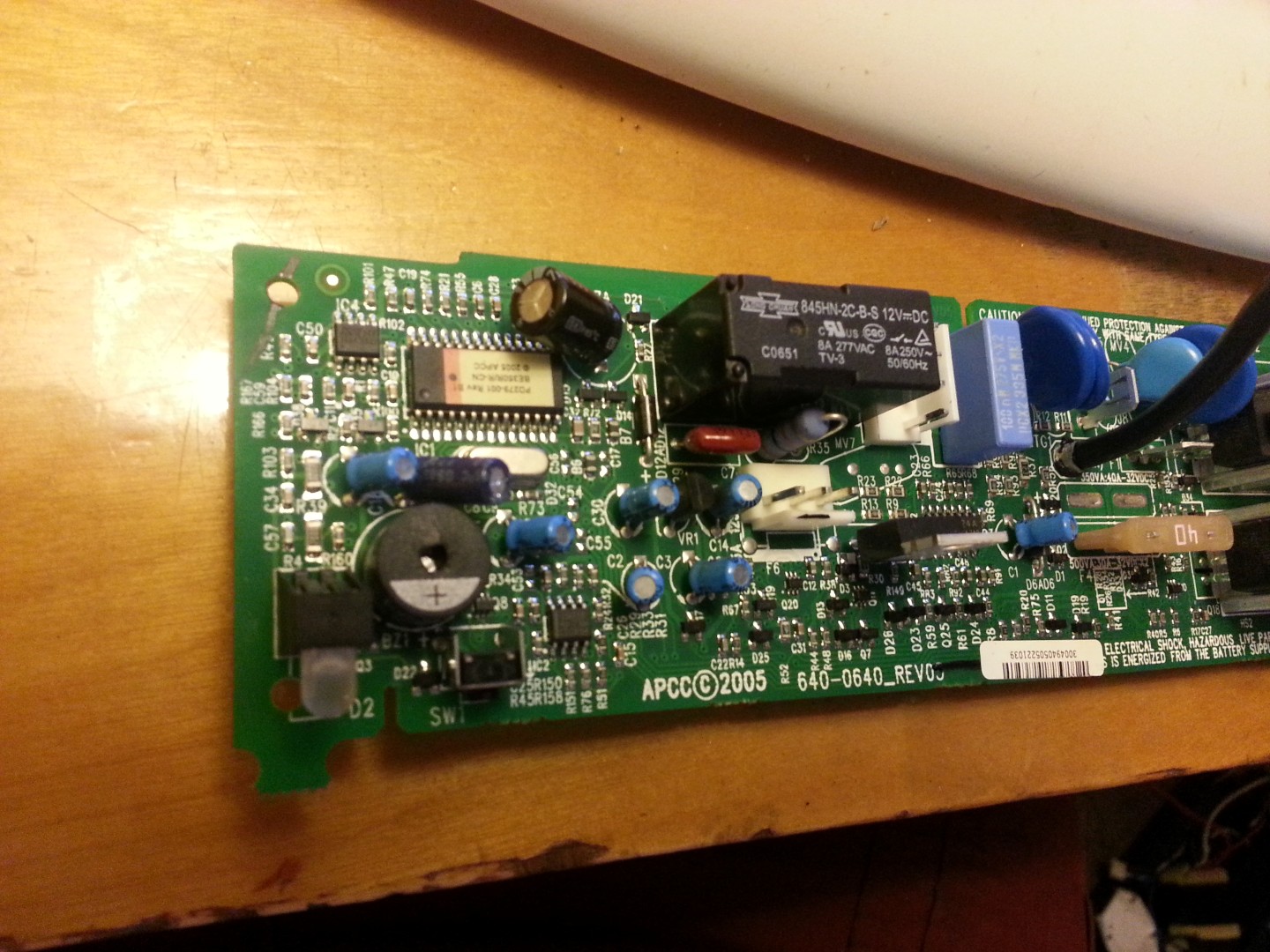

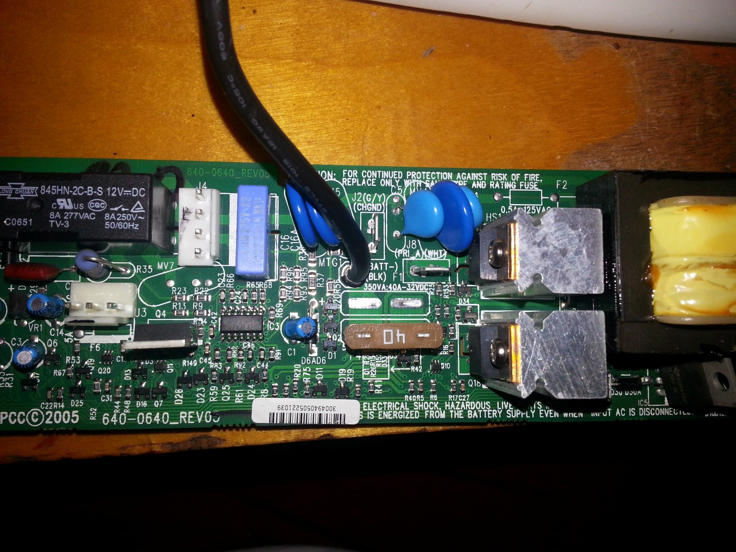

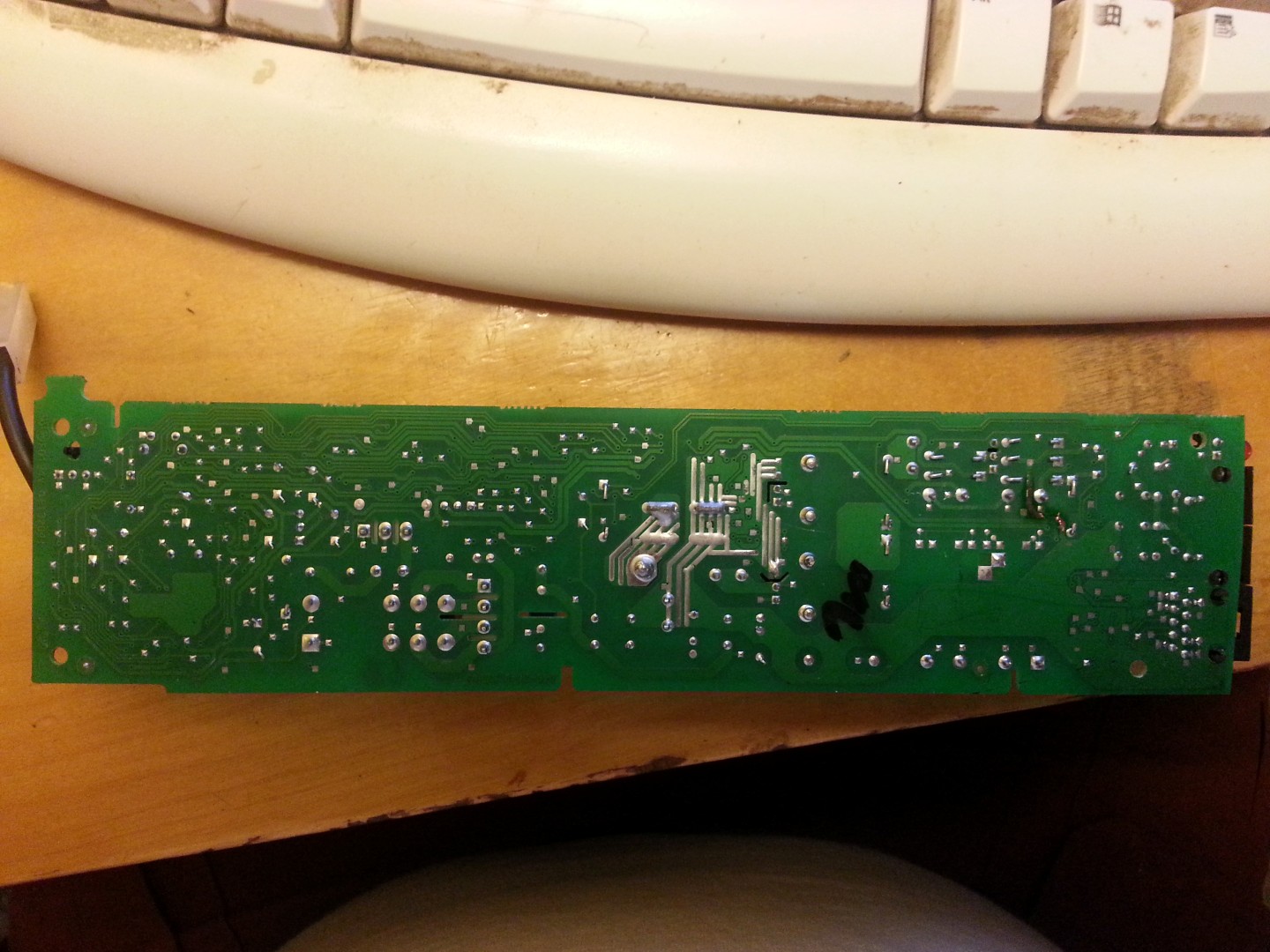

                                  Take good clear pictures of the whole both sides of the board again, and then in 1/4 sections using good lights so we can clearly see the traces and the components.
                                    #37
                                    ok I will get them taken tomorrow
                                      Ok here are the pics

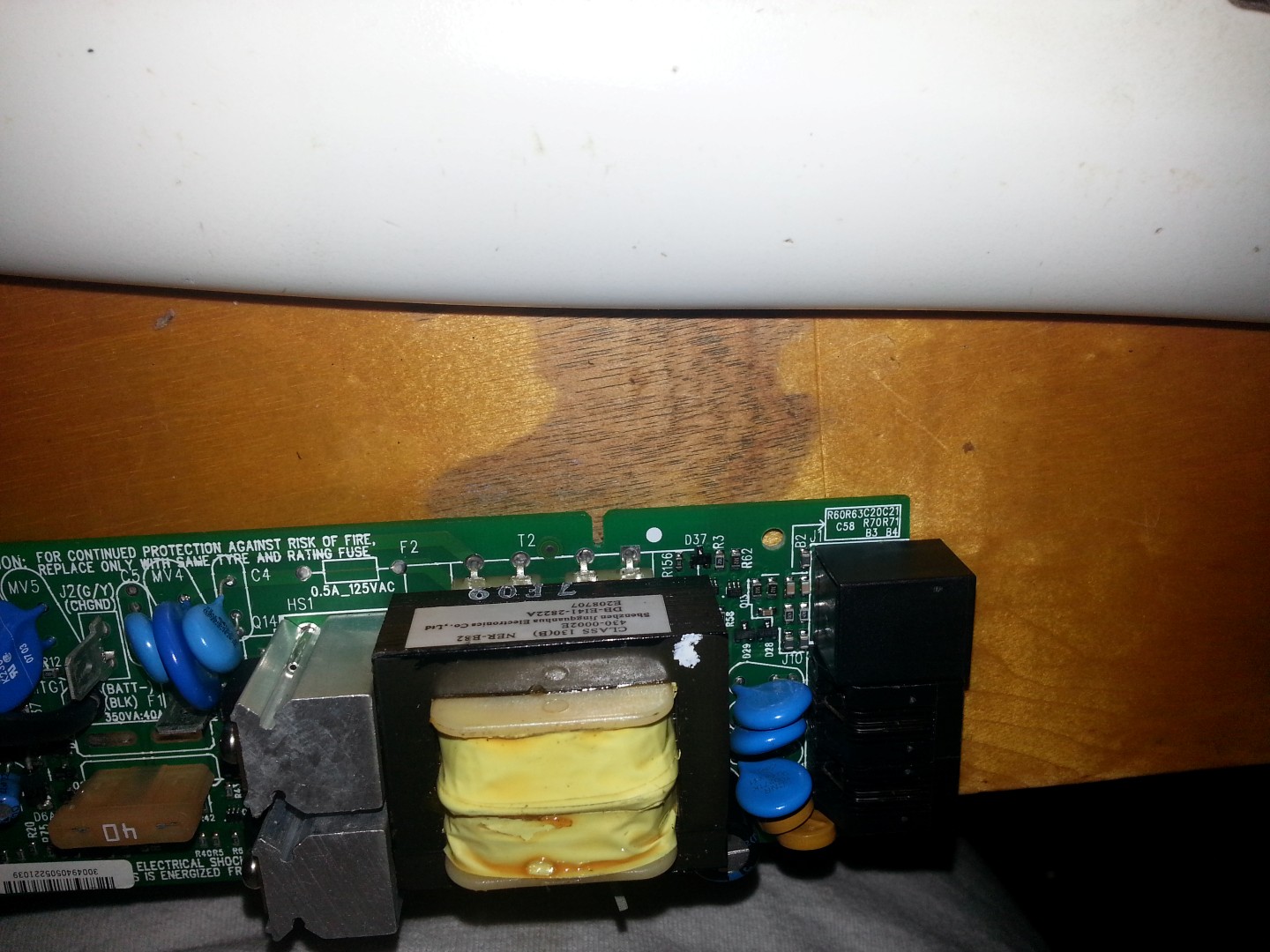

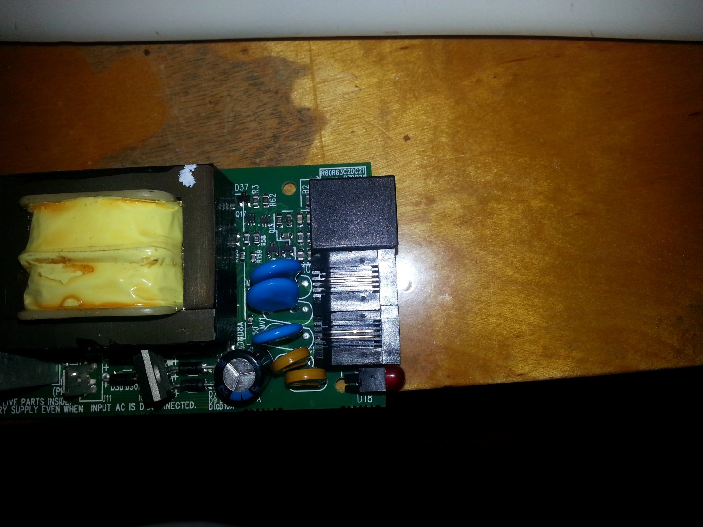

                                        That T2 transformer has a P/N sticker on the side, can you post that picture?
                                        I also see burnt trace on the bottom side around that transformer also.
                                          #40
                                          ok on the sticker will upload that one in a sec and yikes didn't even notice the burnt trace but then I wasn't looking for it
