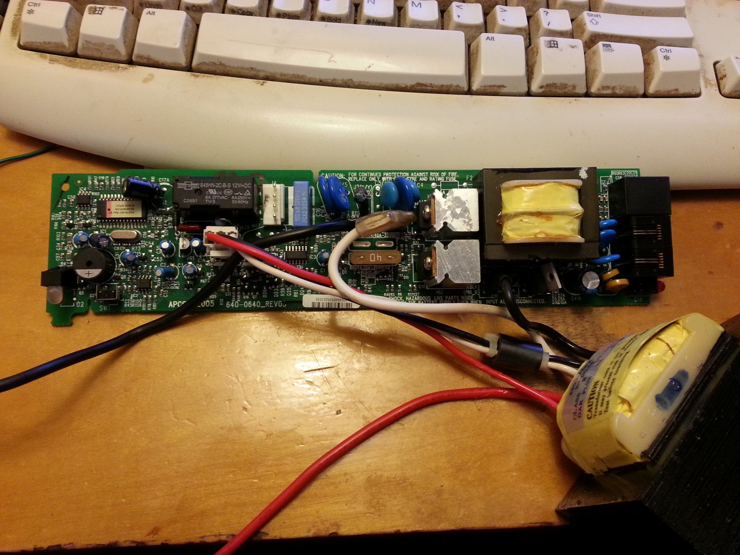

    OK all u have a APC back-ups 350 es with a blown inverter. What I would like to do is repurposed the circuit by removing the 110v inverter and using it as a 12v monitor/ trikle charger for another project. I wanted to see what anyone more knowledgeable with PSUs and UPSs thought of this idea.

              Ok please be nice as this is more than likely going to seem very stupid. I have a Idea of how/what I want to do this just not familiar enough with the internals of a ups to sort out what I need to remove or disconnect.
              ok I have tested every part of the back-ups 350 es I have setting here and the only thing I can tell is dead is the inverter. now I have no reason for repair/replace the inverter as I don't need it.
              What I would like to do is make a new casing and put the unit inline with my 12v battery backup system I have on my low voltage equipment the total load is 3A at 12VDC as I am tired of having to check the batteries. Now I could simply splice in the battery connectors so that it can read the battery voltage and send it to the computer via USB. However my goal is to have it setup so that the load is setup so that the UPS can stay plugged in to 110v for lack of any other way to put it but to act as a giant wall wart unless the power is out then switch to the batteries basically like it works for 110v currently.
              Oh and since I know this will be asked part of reason for this is so that I can pass the battery levels over to my Home automation system.
              Like I said I more than likely sound like a nut job,
              yonu
                Re: help with a APC ups mod
                OK, I see, you want 12VDC UPS (instead of 120VAC UPS) with batteries charger, and monitoring capability through USB interface. I do not believe the charger circuit can put out 3A + Plus charging the batteries at the same time, more likely to have 1A at most.
                The model is 350, not something like XX-350?
                How is the "12v battery backup system" working right now, just run of the batteries with or without charger?

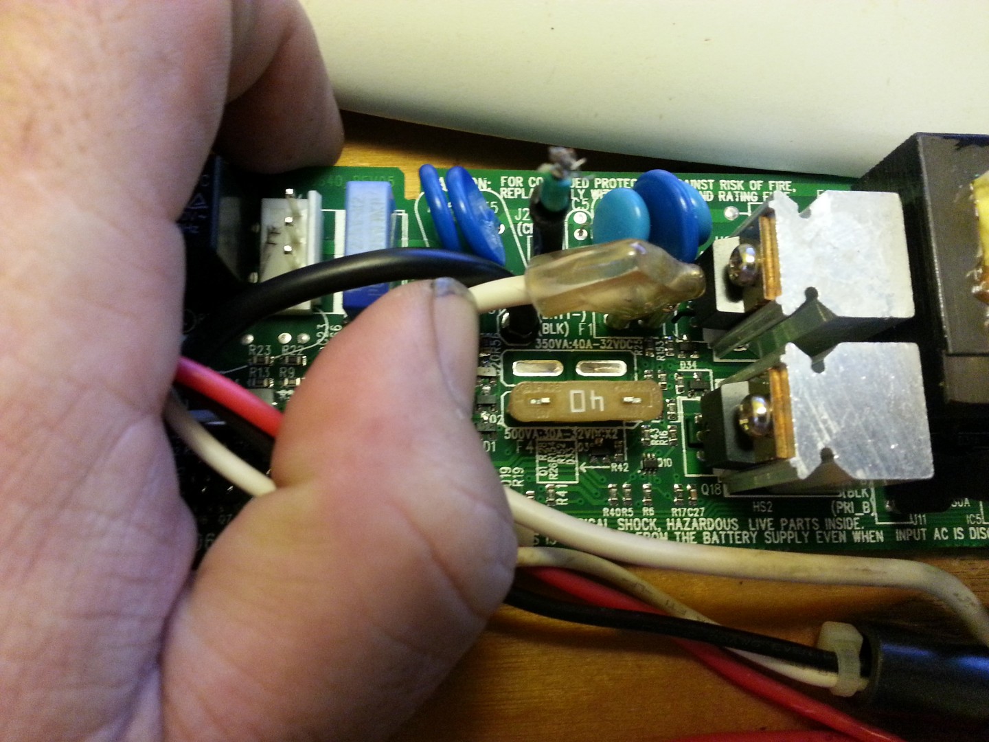

                            Out of curiosity is the 40amp fuse in the charging circuit or the inverter circuit just cant figure out why they used such a large fuse.
                            Thanks,
                            yonu

                              Are you talking about some colored ones ( car Fuse type) ?
                              • yonu
                                • Nov 2007
                                • 138
                                Heap a 40A ATC automotive fuse
                                  Can upload the pictures of the inside of the unit? That fuse is in series with the batteries, to produce 230W (350VA) output from 12V, you need more than 20A (~30A) of current from batteries.

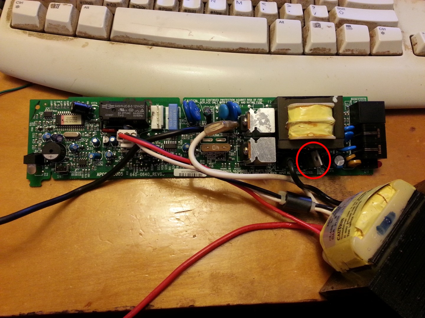

                                    sure pics will be right up and wasn't sure was just curious about the fuse
                                    • yonu
                                      • Nov 2007
                                      • 138

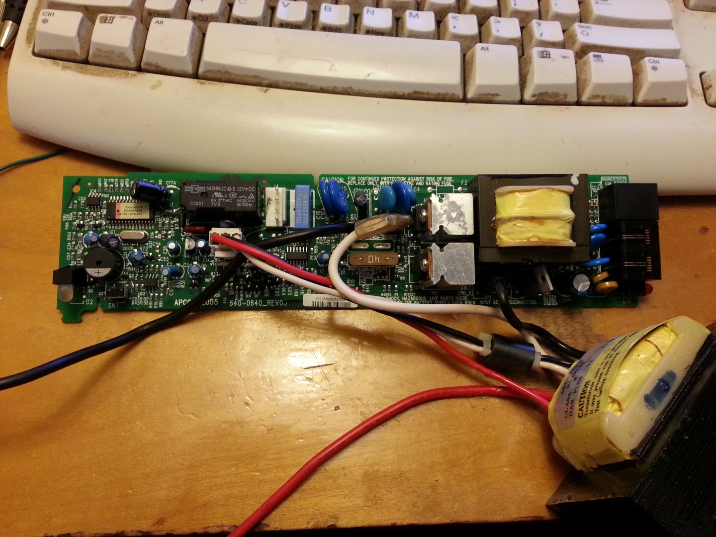

                                      Ok here are the pics of the PCB
                                        Please look at that TO-220 device to get the P/N, I expect it to be xx317 printed on it.
