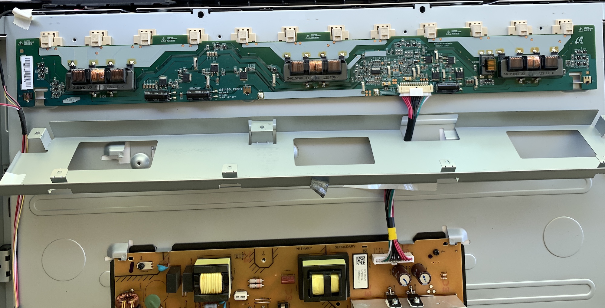

    I have well maintained Sony KDL-46BX450. It went black one day. After turn-on, I get solid green light and Sony logo in screen center for about 1-2 seconds, then black. No blinking LEDs, no hissing. Flashlight test shows screen characters dimly viewable, so tv is probably ok, just no backlight. After taking apart, I measured voltages on the Samsung SS1460_12F01 inverter board connector CN6401, with power on, which matched what others had reported for this board. They were:

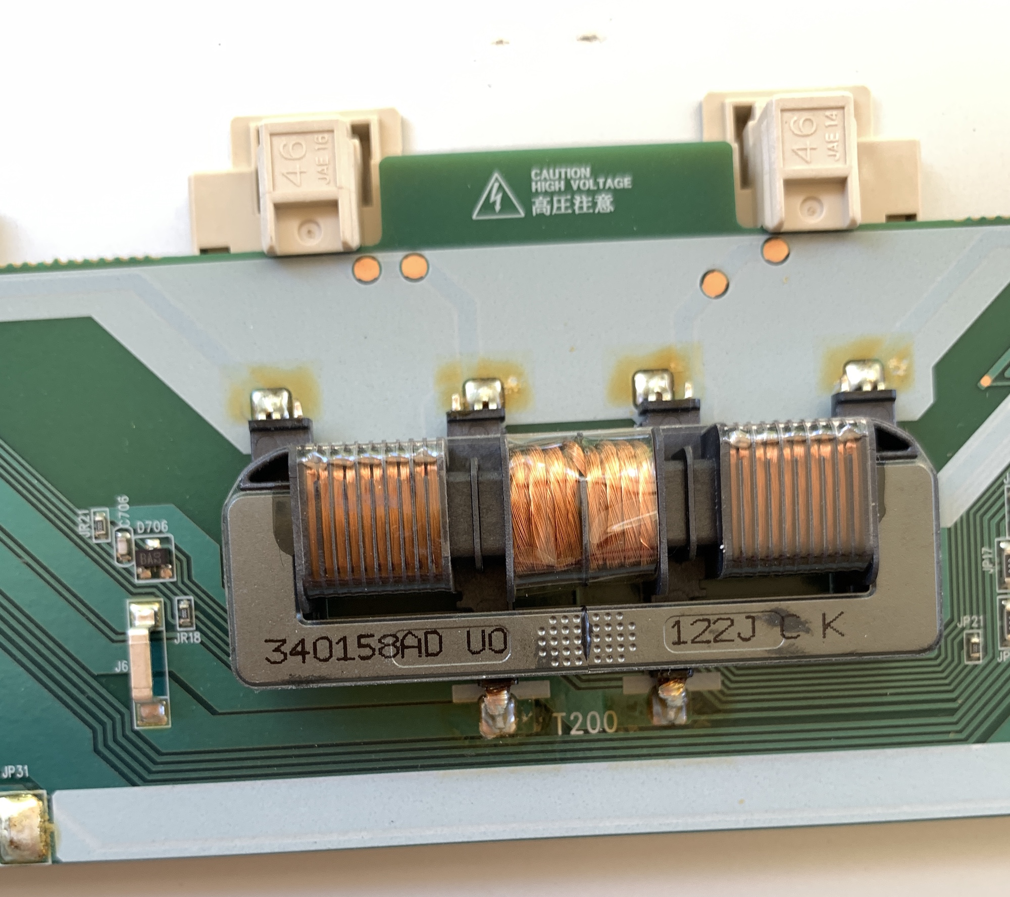

    I pulled the inverter board up and gave it a close inspection, no hot spots revealed, solder looked in good condition. Careful inspection of caps revealed all in good condition, Rubycon type caps. Board looks like it has six transformers to drive the ccfl tubes (three dual transformers top, center and bottom pn# 340158AD). Measurement of each of six transformer secondaries in ohms is from top to bottom:
    1. 1297
    2. 1367
    3. 1389
    4. 1393
    5. 1388
    6. 1391
    Although topmost transformer 1 is 6.89% lower than the highest #4, it is not burn-up. Maybe has shorted across several windings enough to lower the resistance a little.

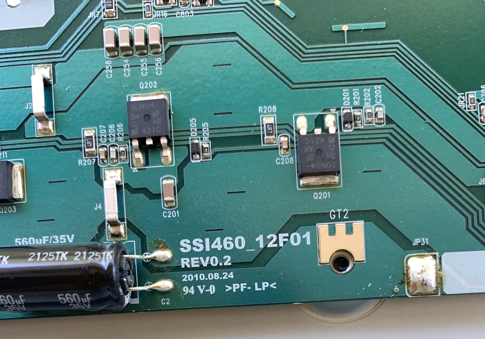

            As regards your comment on the difficulty of finding transformers, I am searching through ebay for a replacement transformer board which might have a least one good transformer on it. Are you aware of any other boards except the Samsung SS1460_12F01, that contain the 340158AD transformer?

              You probably didn't understand me, I wrote that if you rearrange your the transformers on your board, nothing will change.
              A decrease in the winding resistance indicates an inter-turn short circuit and of course the protection will work and turn off the TV.
              You write the name of the inverter with an error, you need SSI460.....

                  Hello All, I got my replacement inverter board (Samsung SS1460_12F01) from Ebay's seller christmas2carol. I checked the secondary resistances and all measured 1320 ohms +/- 10 ohms. So I swapped it out with the bad one and the screen lit up and said Welcome to me. I am so happy that I was able to resurrect this Sony which had one foot in the dumpster back to life again. None of it would have been possible without all of your help. Special shout-out to kassfamily for taking special interest it this. The replacement board was about $40 US plus shipping.
