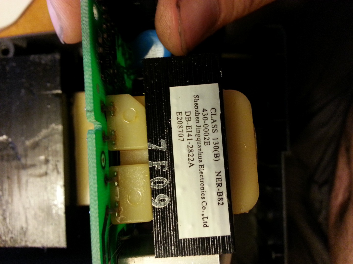

    Ok here is the label on the transformer
      #42
      Re: help with a APC ups mod
      It is still charging the batteries and still talking to the computer?
        #43
        it is still talking to computer but not charging so I will patch that trace tomorrow and see what it does not even sure when it burnt as it was charging

          I think that is part of the charging circuits.
            #45
            the older ones yes.
            these newer,cheaper ones get hot even without load.
            some are wired up as autoformers so be careful.no isolation!

              Ok I patched the trace but still no charging still talks to the computer though lol

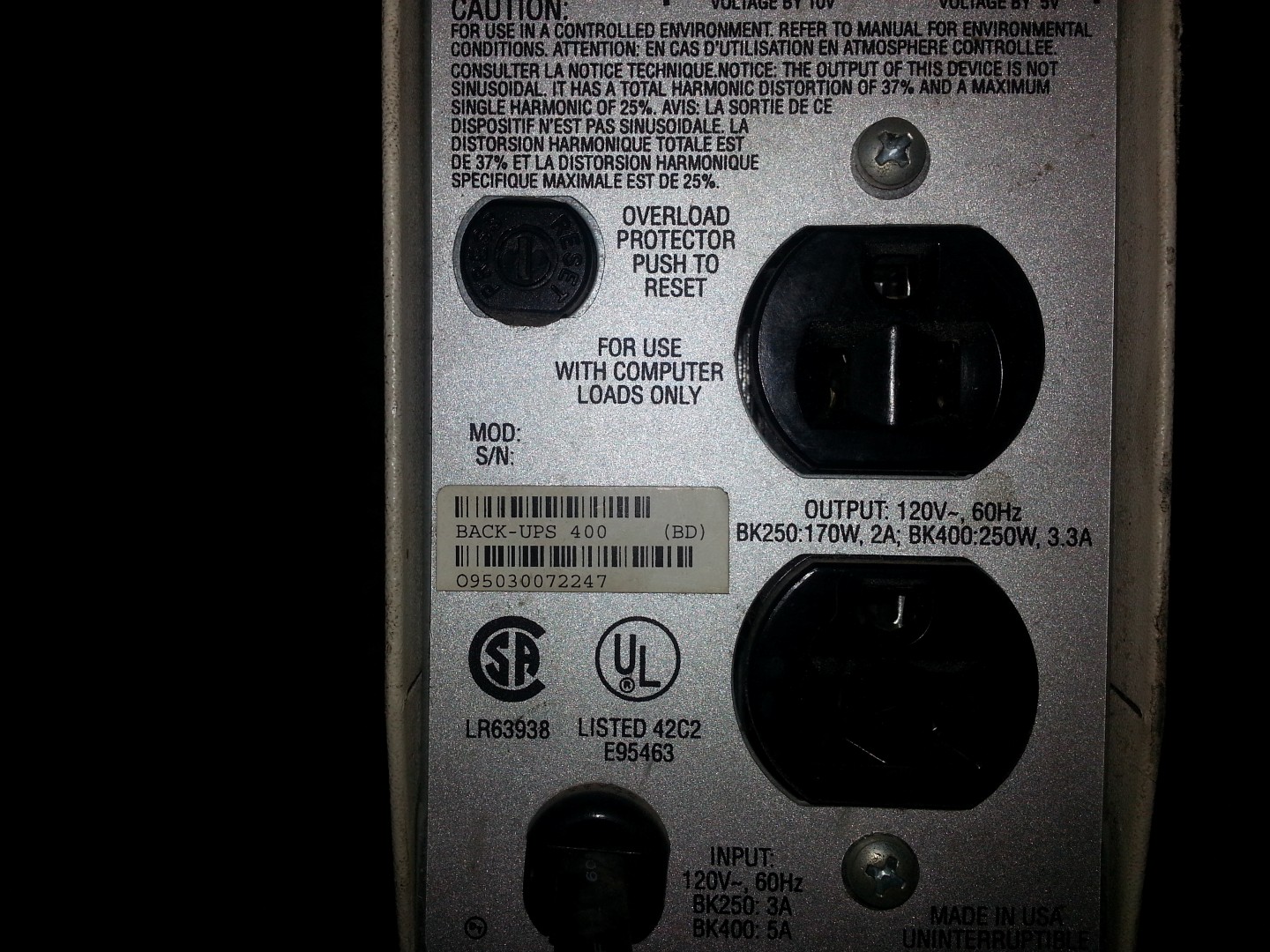

                ok question I have a couple of old metal back-ups 400 that are fully working would I be better off attempting to mod one of them forgot I had them.
                Thanks,
                Yonu
                  #48
                  Is that the exact model 400?, I can see if we can get the diagram for it.
                    #49
                    according tot he label on it yeah here is a pic of the label
                    Thanks,
                    Yonu

                      But it does not look like it has any interface for it to talk to the computer.
                        #51
                        it has a db9 I haven't hooked it up to see what data it will pass
                        Thanks,
                        yonu
                          #52
                          cable has non standard pinout(thanks apc!)
                          iirc there is still a site ups club that has pinout and schematics of these older units.
                          supported under windows and linux natively.
                          these i add a fan to that only runs in inverter mode.
                          so now you have a charger,monitor,and a working ups limited only by the battery you connect.
