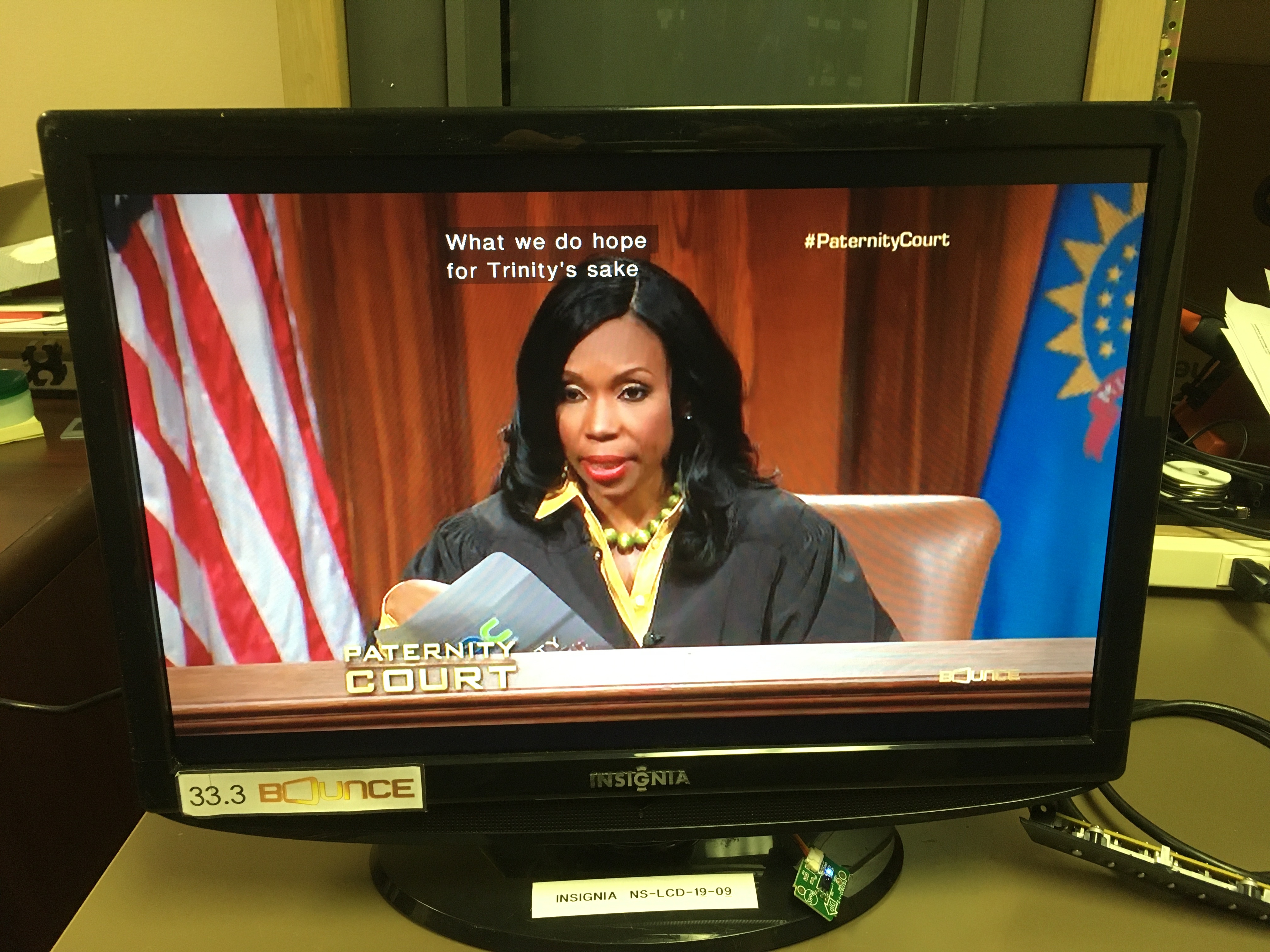

        Replaced the shorted MOSFET's with eBay specials from across the ocean. Marked FDS8958A, they could of course be counterfeit but as you can see, the TV now works. Would love to now thank everybody for their help but of course the saga continues. The set will turn on and come up with a picture, but then turn off after 5-10 seconds. Subsequent turn on's will produce a flash of a screen, then turn off again. It takes 4-5 tries to actually get it to turn on and stay on. When it does it will stay on all day. This was before I put my auto turn-on circuit into the equation. Now, instead of having to turn it on manually it will auto restart but exhibit the same behavior- on-off-on-off, etc., various lengths of on time before it turns back off again. Once the TV is up and running you can turn it off and on manually and it works as it should.
        I do get a series of red blinks when it powers up (this was the case before, too) and now get red blinks as it shuts off which may be normal but I don't remember this. Am I looking at something weak in the power supply (like a cap) or knockoff MOSFET's that can't handle the job of finishing the power-up? Tomorrow morning I will pull the wires from one of the backlights and see if that affects the startup.
        I could always try to obtain the specified MOSFET's with their higher current handling capabilites.
        Any ideas welcome. I can make a video of what it's doing if it will help.

          Might just be the problem, you don't want to use ones with a lower current rating.
            The FET's are marked the same as the ones that came out of there although of course they could be counterfeit. Digikey shows this part number as a "last time buy" starting in 6/2024 so fakes could already be popping up. Schematic shows the higher current ones but the lower current ones were on the board before I started shorting things out.
            The set would power up and stay powered up (the first time on startup) when I had one or the other backlight connectors pulled. Dim screen during startup but then it went black. Could still hear audio; I assume that the screen going back with one backlight out is normal.
            Monday morning I will warm up the power supply with a heat gun to see if that allows it to start. I still think it might be a power supply issue. The set restarted 20-30 times this morning, gradually staying on longer but never actually staying on. That's making me think it's a PS warm up issue.

              If the set is giving a picture that suggests the MOSFETs are fine.
              If heating the boaerd has an effect then I suspect it's the caps, but i don't think it will and it's tired CCFLs

                Be careful not to overheat with a heatgun, I just use a hairdryer it's plenty hot enough to find a marginal/faulty cap.
