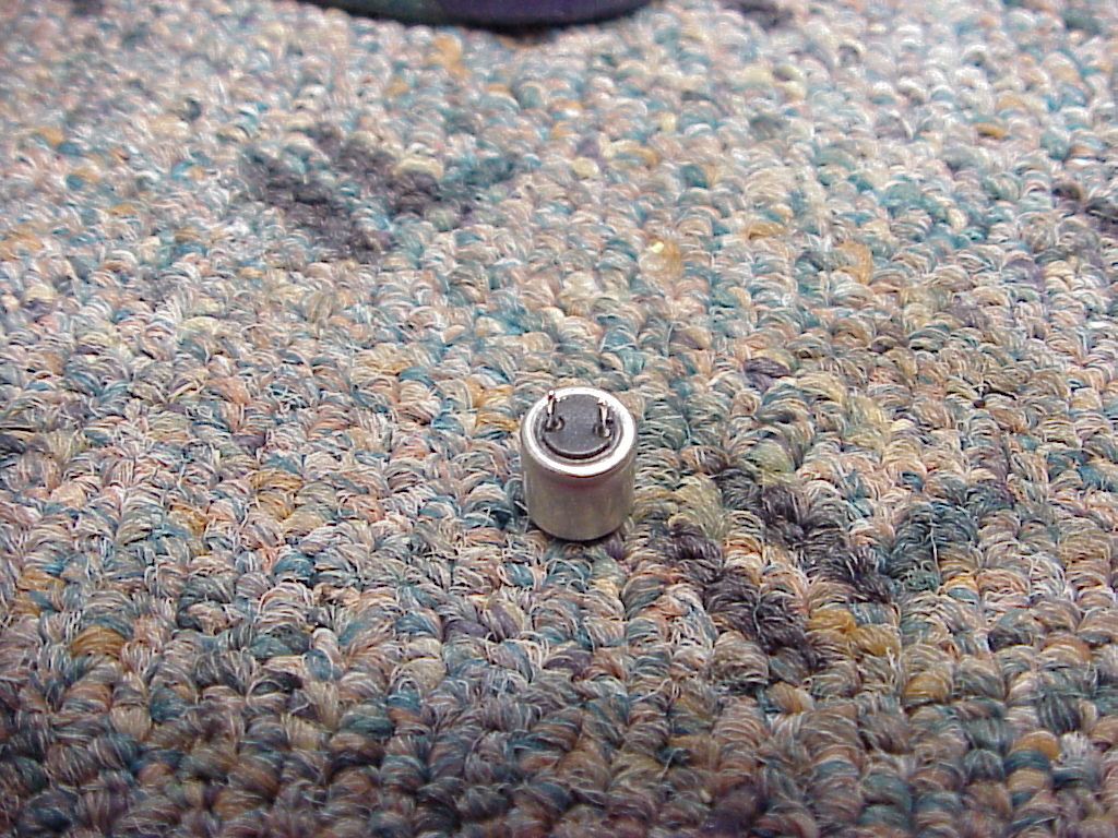

                Re: The Hall of Shame - Badcaps Photo Montage
                elite cs cap up 560@4 shorted.
                from ecs 945gct-m3.
                dead shorted and was killing the vcore.

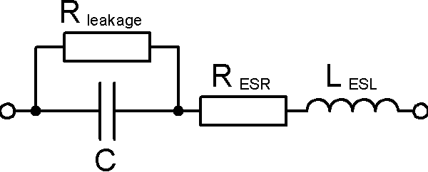

                  kc8adu; Just a curious question
                  I've got a few caps from VCore on a mobo, also solid polymers
                  They read 0.00 and some 0.01 ESR...
                  This I presume means they are shorted out
                  But if I use my digital multimeter they don't register as a true short?
                  • 370forlife
                    Large Marge
                    • Aug 2008
                    • 3113
                    #189
                    Well, they show up as low ESR where they should be, and they are not shorted
                    Sounds like they are good.
                    • shadow
                      • Feb 2007
                      • 732
                      #190
                      Low ESR means that the internal resistance of the capacitor is extremely low. As low as 0.00 according to your meter.
                      This is the model of an electrolytic capacitor.
                      (Source of picture: http://en.wikipedia.org/wiki/Electrolytic_capacitor )
                      As you can probably see. Even if R(ESR) is zero. It does not mean that the capacitor is shorted.
                      As you have pointed out, a DMM reported the capacitor as an open circuit and not a short circuit. This proves that the capacitor is indeed not short circuited.

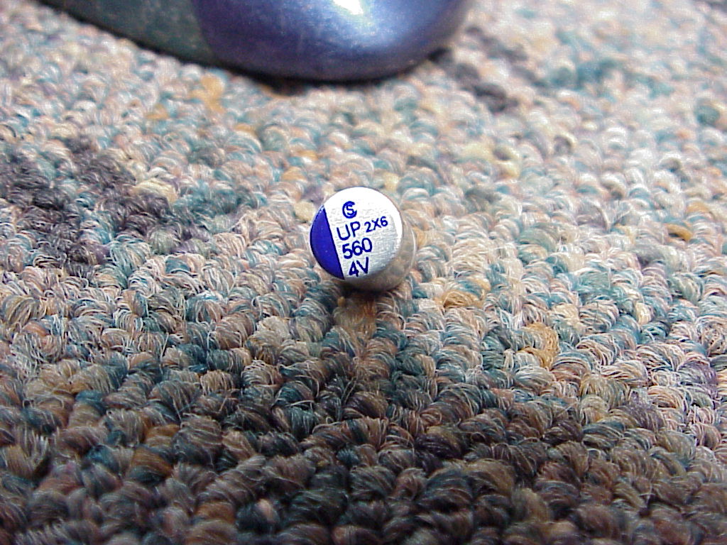

                        What brand is this cap? Its logo is the letter "S" in a circle.

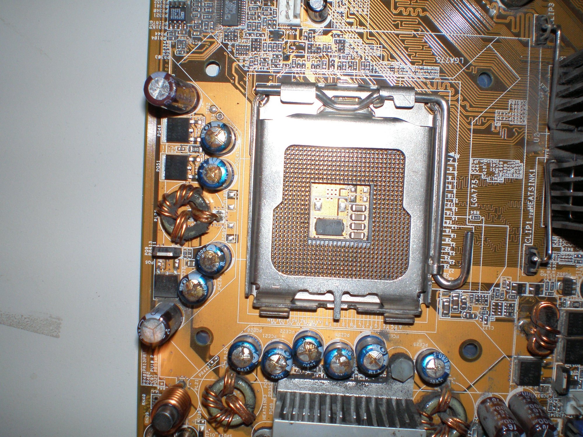

                                  heres one for you OST 4v 680
                                  Asus P5GDC
                                  • c_hegge
                                    • Sep 2009
                                    • 5219
                                    #197
                                    Those are RLA series. I recently replaced a few identical caps on an MSI Motherboard with 6.3v 560uF Chemi-con polymer caps which I salvaged from other motherboards.

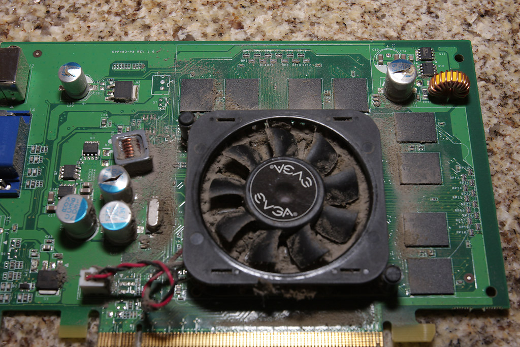

                                          #200
                                          I have an EVGA video card with some bad caps on it that I have not seen here. They are all silver-colored with a blue "edge" that looks sort of like one of those so-called "solid" caps, but isn't. There is no name on them whatever. Says "FZ72" and "FZ73"on top of each cap along with the values.
                                          I'll post a photo as soon as I can get them taken.
                                          Anyone have any idea who made these PsOS? (Pieces of Sh**)
                                          When they went out, they literally "popped", spewing weird crap all over the place, and destorying the motherboard, a Gigabyte 7N400.
                                          I am NOT pleased! :-(
