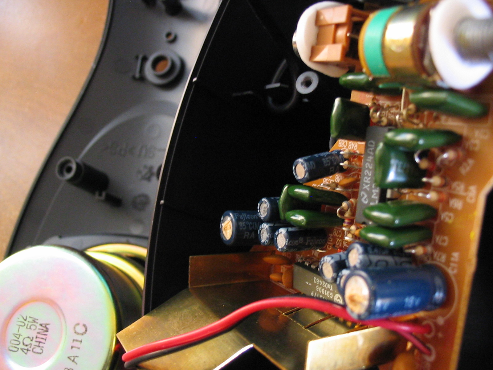

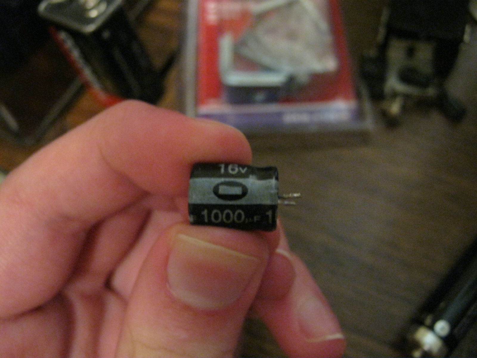

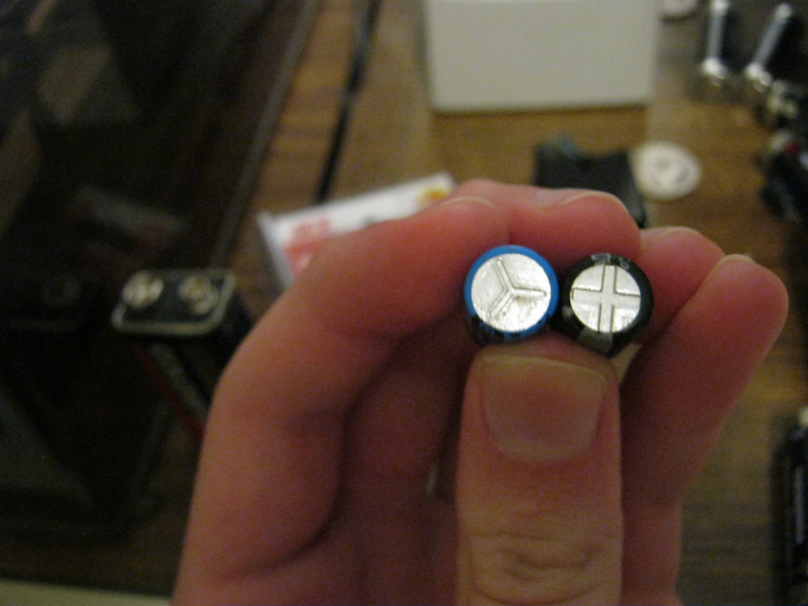

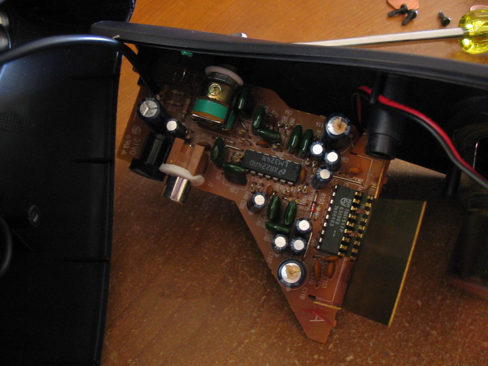

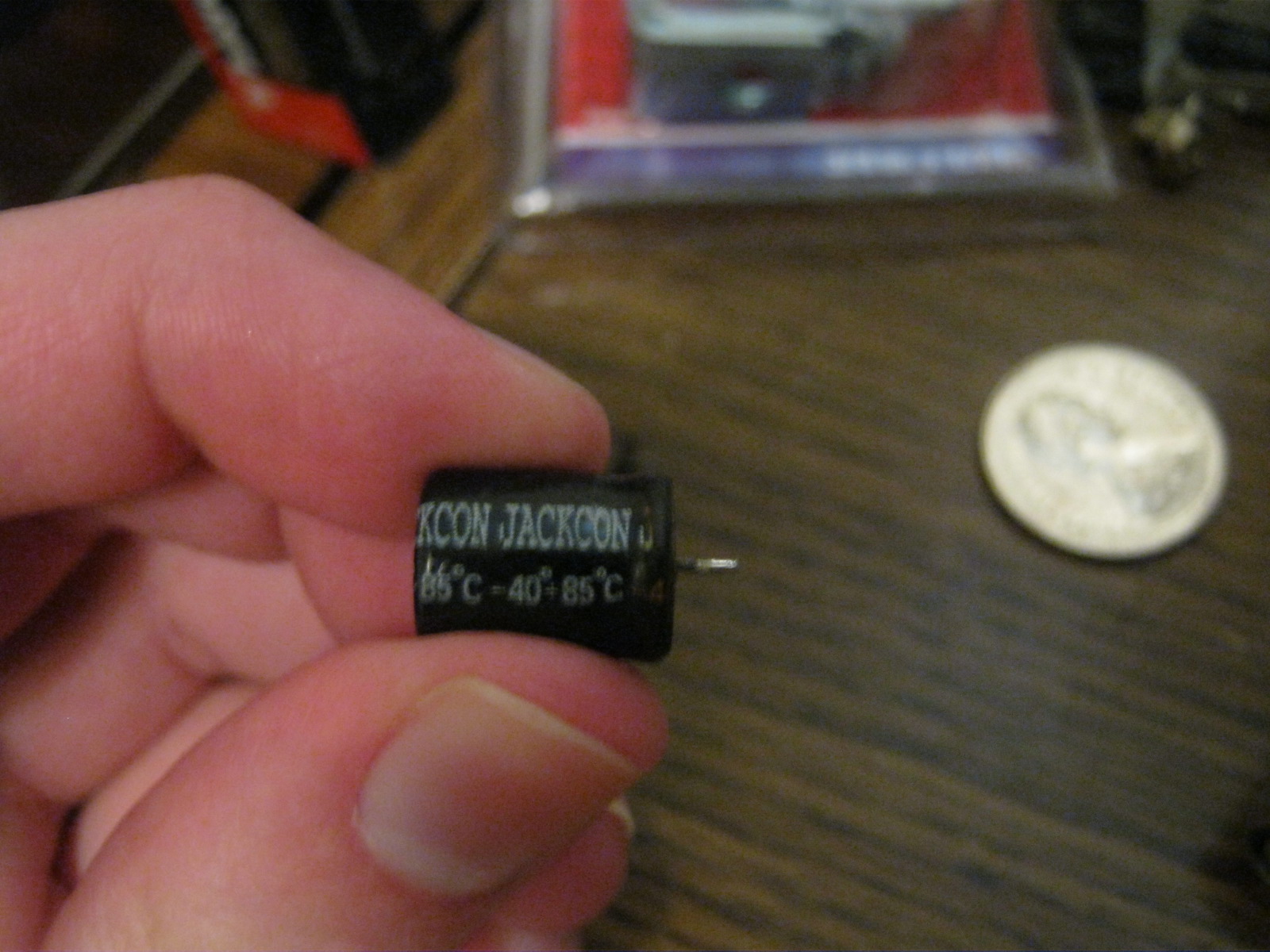

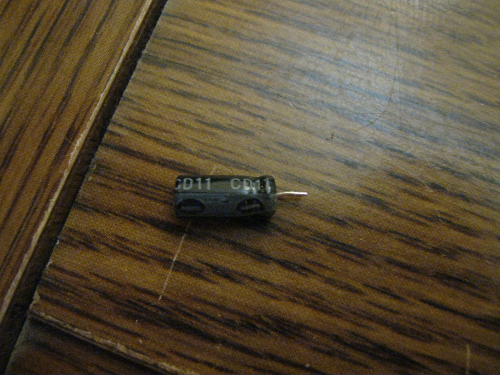

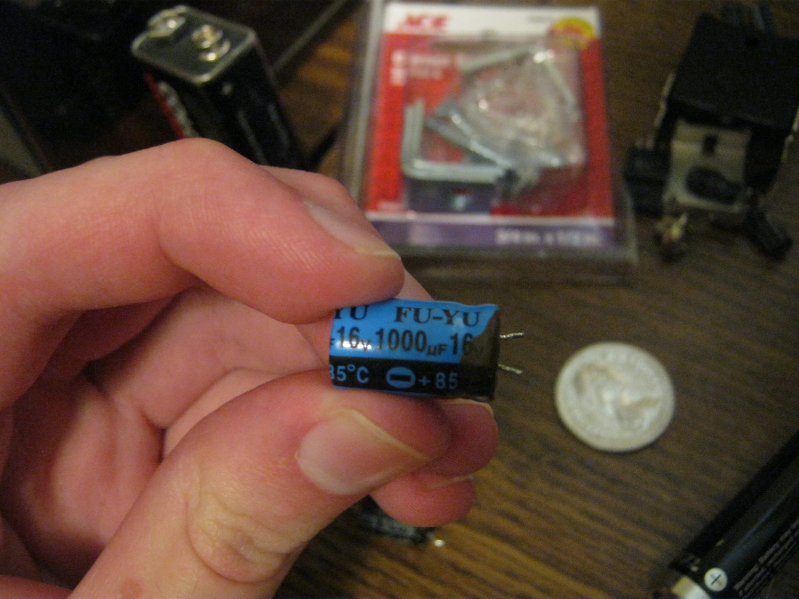

        Re: The Hall of Shame - Badcaps Photo Montage
        Here are some good ones...
        The first two are a FU-YU and a Jackcon pulled from an Emerson ghetto blaster that was made in 1999. I think the first brand nane would be more appropriate if they left out the first U.

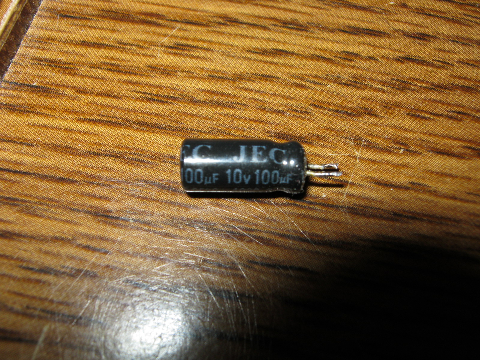

        Next, there is a JEC that was pulled from a set of computer speakers. I measured 11.38V across it, and it is only rated for 10V.

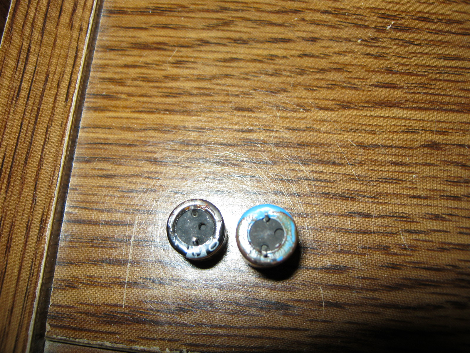

        Finally, there is another set of computer speakers that is full of Fujicon caps. The two that are bad are the output coupling caps.

          #244
          I just remembered that every Fujicon cap except for the four 0.47uF 50V caps were bad. I don't have an ESR tester, but they all had very low capacitance. The 0.47uF caps gave me the correct capacitance value.

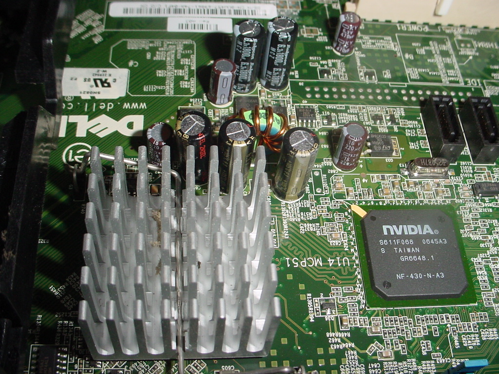

              Successful recap-Dell Dimension E521. Rubycon 6.3/1800 MCZ's with some Pannys
              edit: Yes I know its an nvidia 6 chipset with some KGZ's. but if the thing has lasted this long with a COMPLETELY blocked airflow, those KGZ's are probably going to be OK. Most of them are under 470uf, everything else is rubycons (except for the pannys I put in)

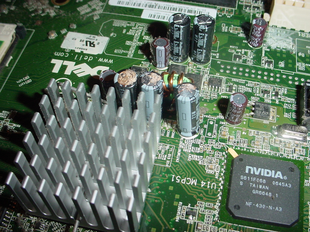

                    #249

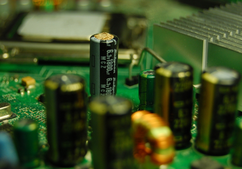

                    Smithfield (90nm) Pentium D's in an SFF case can apparently kill a Rubycon:
                    Also some swelled up KZJ's.
                    It's an SFF Dell Optiplex 745.
                      I'd say it's time for a poly-mod.
                            Another explanation: The KZJs bulged (they have heat issues) and the Rubycon took all the ripple... Combine that with the heat of the Pentium D in as SFF case and here is what made it fail.

                              #254
                              As far as I know legitimate MCZ come in black with gold lettering, not black with white lettering.
                              May have been previously recapped by someone that got counterfeit caps on ebay.

                                #255
                                No, MCZs do also come in black and white like B757's board. I have seen it and so has topcat. My guess would be that the black and white ones are
                                from a Malaysian or other non-japan rubycon factory.

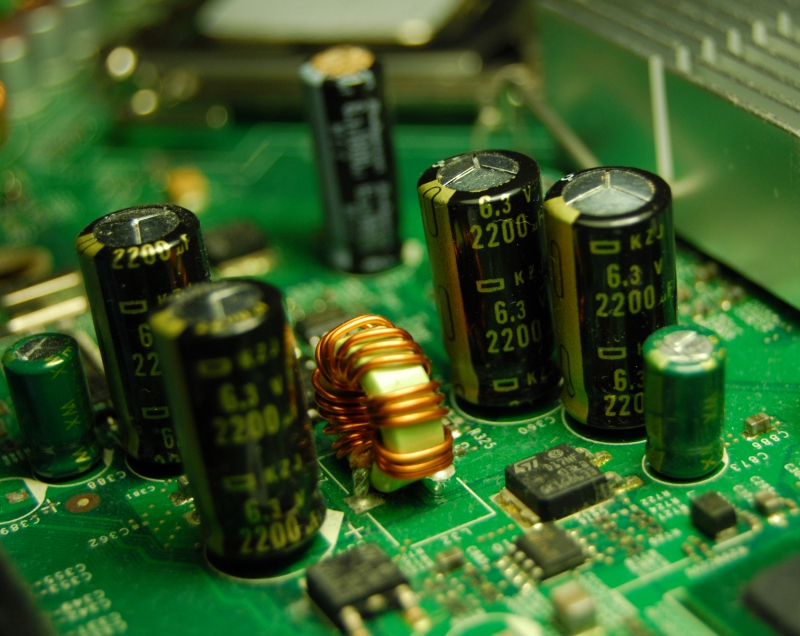

                                          • 3741
                                          #260
                                          KZG caps from a Biostar S939 mobo
