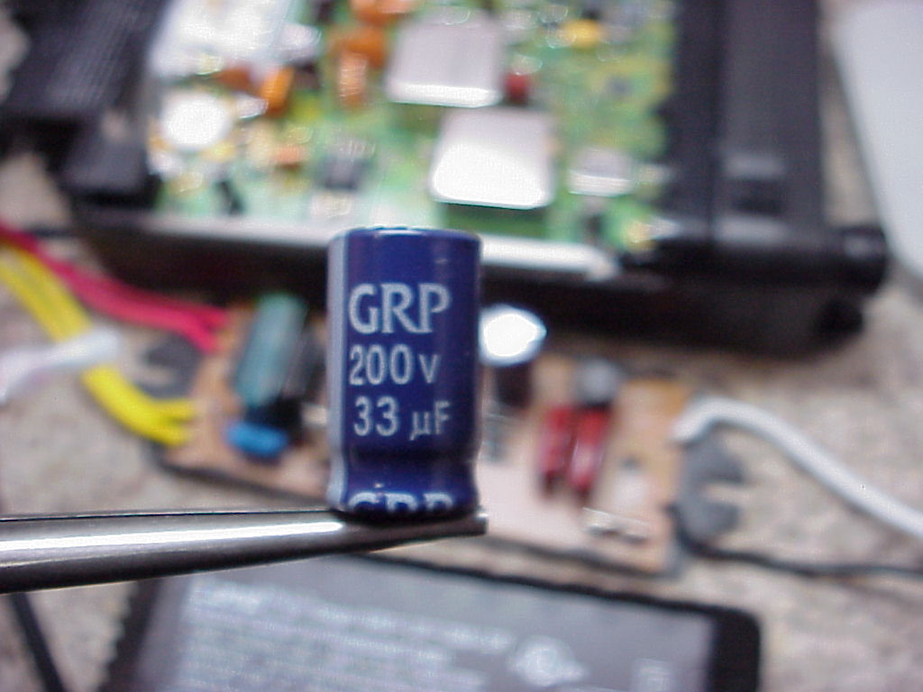

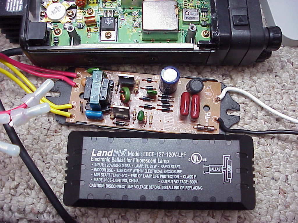

      grp with a faked?
      matsushita logo.
      from a cheap junk fluorescent ballast.

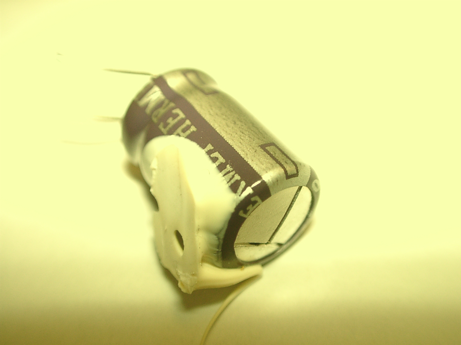

        HERMEI
        1000uF/16V 105° LZ Series
        Found in the power supply of a Viewsonic LCD monitor

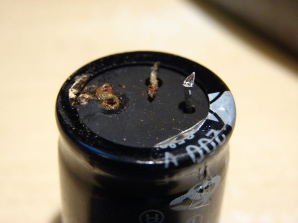

                        Re: The Hall of Shame - Badcaps Photo Montage

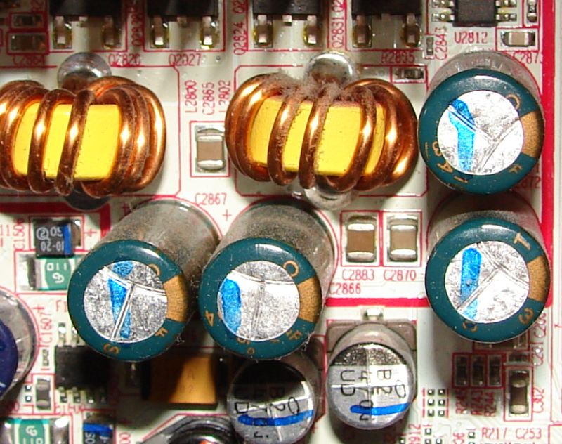

                        Teapo with panasonic vent copy, It's currently on my Sapphire grouper Mainboard.
                        The 2nd picture is also a "Saturn/SC?" brand capacitor 330uF 200V.
                          Teapo with Panasonic "T" vent?
                          This is the first time i see this, so surprising.....
                          May be Teapo have changed their vent, when your mothwebaord is produce?

                                        Don't know the production date, The bios is from: 04-17-06 DD-MM-YY ( depends on country)

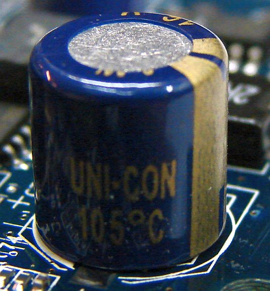

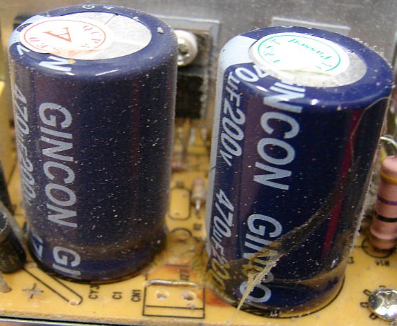

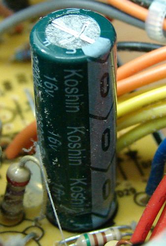

                                          1. Koshin 2200uF 16V cap do they allways use the ELNA Vent?
                                          2. GINCON 470uF 200V
                                          3. Skywell SEL, UNI-CON 330uF 16V, Looks like polymer caps, it's on a VGA card bundled with Sanyo OS-CONS.
