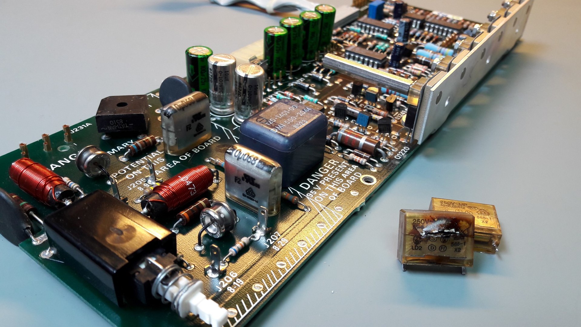

    This RIFA caps are well known for failure over time.
    This one has blown with not much noise, but some amount of smoke and a terrible smell.
    It came from the PSU board of a Tektronix 2445 oscilloscope.

      We used to blow them up for fun at college, and they smelt like stinky fish
      Back in the good old days where nobody gets offended or sued you
