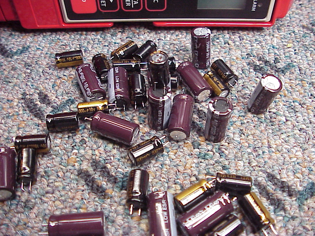

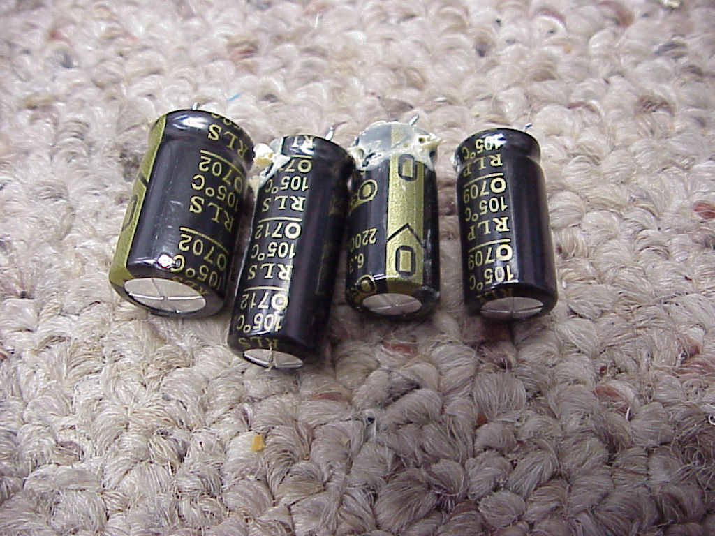

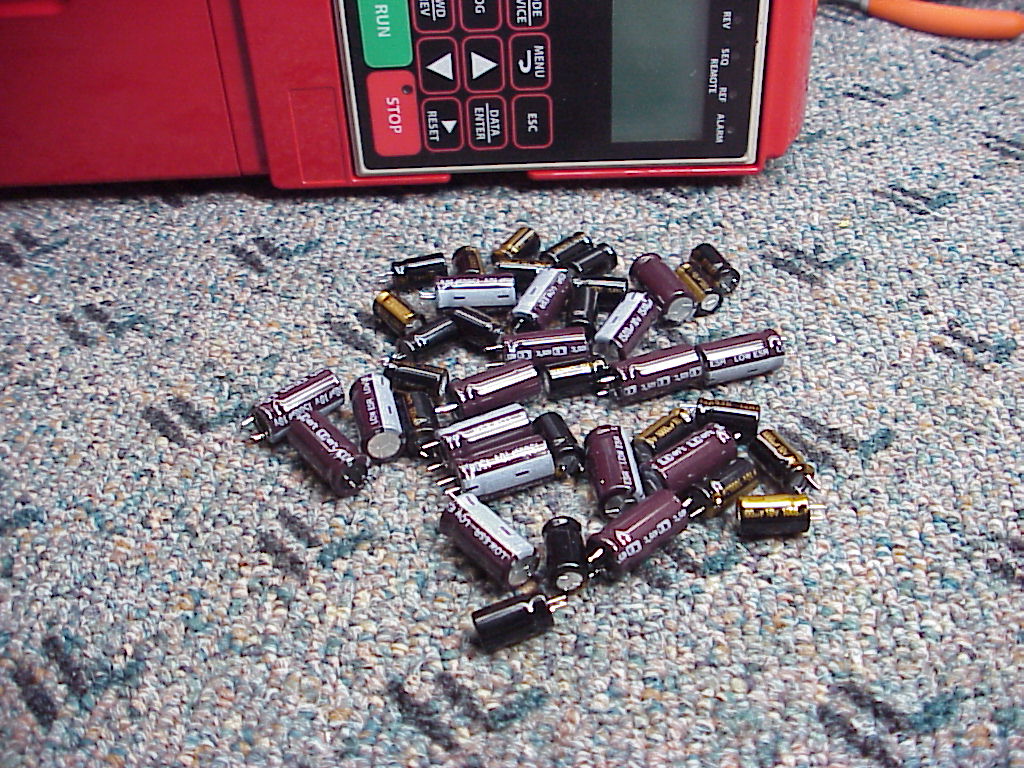

                        #151
                        Re: The Hall of Shame - Badcaps Photo Montage
                        I figure this is the best place as any to make my first post. Plus, include a couple of pictures of why I am here. The attached are shots from my Asus A7N8X v1.04. Yep, I have one of those. It started giving me trouble just a few days ago.
                        Joe
                        "I'm gonna need a hacksaw" - Jack Bauer

                          #152
                          hehe... nichicon HM again

                            #153
                            Go ahead ... laugh it up at my expense. It couldn't come at a worse time. I'm getting ready to replace another system and was planning to put all my money into that build. Now it's just a matter of comparing the cost of replacement with a re-cap. I should hear from TopCat soon.
                            Time could be an issue. I use the bad board for a sideline business too.
                            Damn computers ... can't beat them with a baseball bat, can't live without'em!
                            Joe

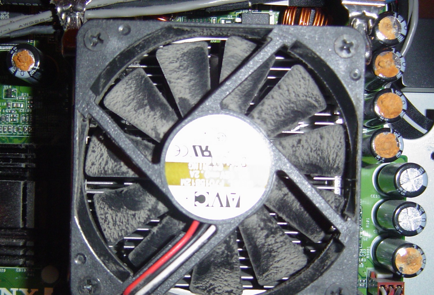

                              #154
                              sry... -.-'
                              BTW.. my A7N8X came with Rubycon MBZs everywhere.. and with only 1 fan connector above the AGP slot!?

                                #155
                                sry... -.-'
                                those ost will be your next problem.
                                i often see them open without bulging.

                                  #156
                                  just weld em back shut with that eyeball laser.they will be just fine!
                                  i would just recap it.beats playing the crapcaps lottery on a replacement.

                                    #157
                                    i dont really care.. its just my socket A test board
                                    i just wondered.. did asus replace the Nichicon HMs with Rubycon MBZ in Rev. 2.0 ?
                                    just found out that my board is a Rev. 2.0 one..
                                    BTW: the print on the board itself (between the PCI slots)
                                    says "A7N8X Rev. 2.0" but the BIOS says "A7N8X-X" !? WTF?

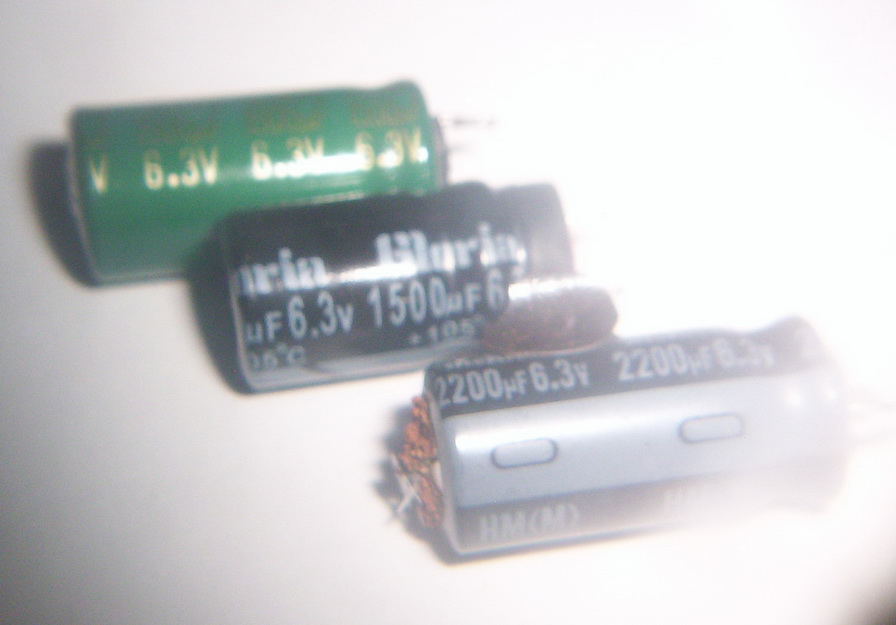

                                        #159
                                        GLoria GAE 1500uf 6.3v and one of two Nichicon HM(M) 2200uf 6.3v (H0143) from SMC EZ-Switch 1016DT. The Nichicons were on the power board. Replaced with Rubycon ZL (for the Gloria) and MBZ (for the Nichi) since they were the matching values on hand.
                                        One of three Sanyo 1500uf 6.3v WX (S.E.13) from a Socket A motherboard. I can't remember which one. Did not repair it, just pulled the Rubycons and pitched it.

                                          #160
                                          noname?
                                          look like hermei
