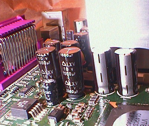

        Re: The Hall of Shame - Badcaps Photo Montage

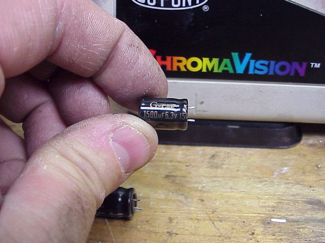

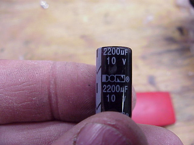

        Here are some pics of SAM YOUNG capacitors. (Different angles)
        You can see 2 of the 1500uf 10v are buldged at the top and the bottom seals are blown out.

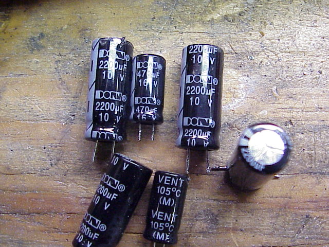

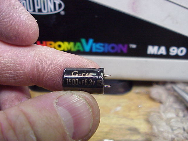

          g-cap

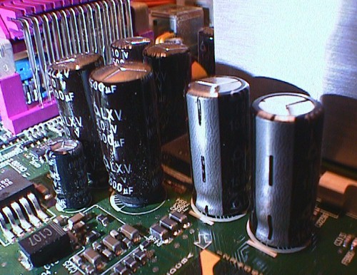

            JetWay N2PAP Ultra board and it's Vcore Evercon caps:
            They should be considered as bad caps and added to the list...
            The machine has problem starting up (sometimes more that six tries to sucesfull boot-up was need) and also the max. clock was about 2100Mhz for 1.650Vcore and about 2300Mhz semi-stable (but so was the board in general) for 1.575Vcore in Mobile AXP...
            Definitively a "neat board" to own. My stepbro want to trash it, but I think I could save it with recapping and let it fold for me

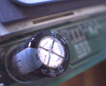

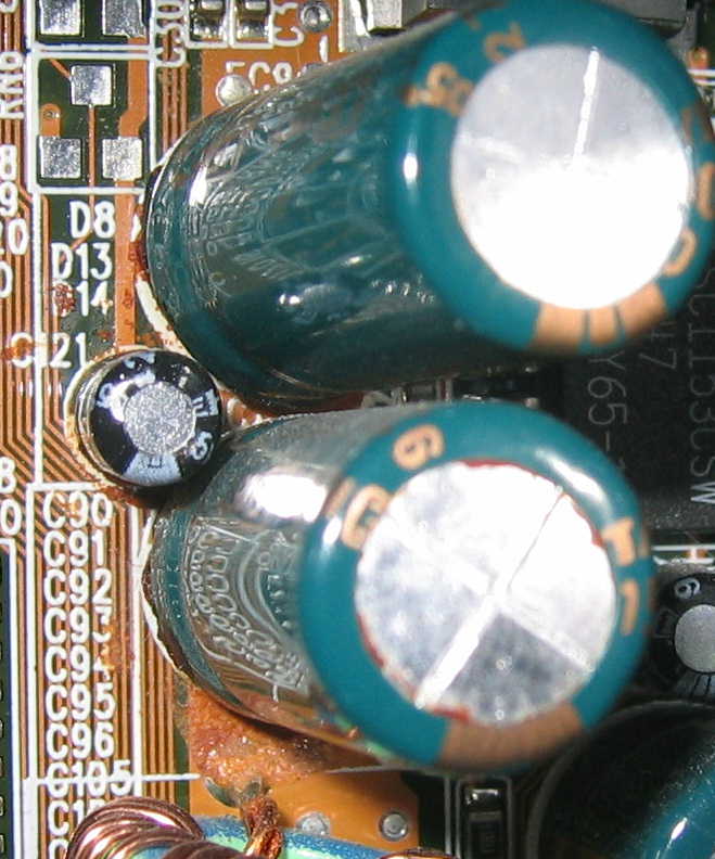

              Just thought I'd post a couple of pics of bad caps I've seen - feel free to use them in the first post (photo montage).
              Note that the GSC pic was taken after I'd scraped most of the electrolyte off the top of the caps - but you can still see the bulge and residue where it was! The Tayeh pic is a bit blurred on the caps themselves, but it's meant to show the electrolyte oozing out of the bottom.
              You know there's something wrong when you open your PC and it has vented Rubycons...

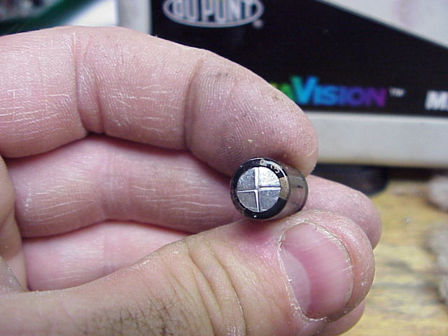

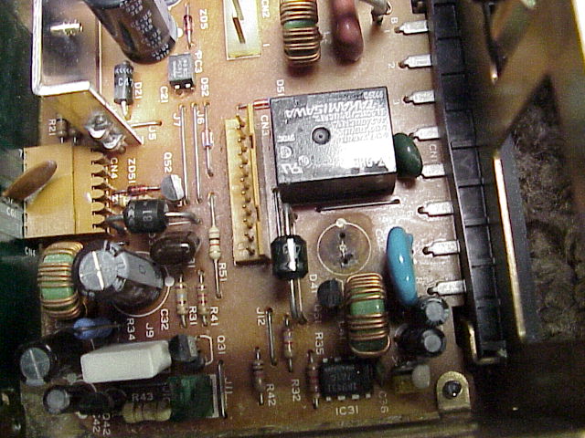

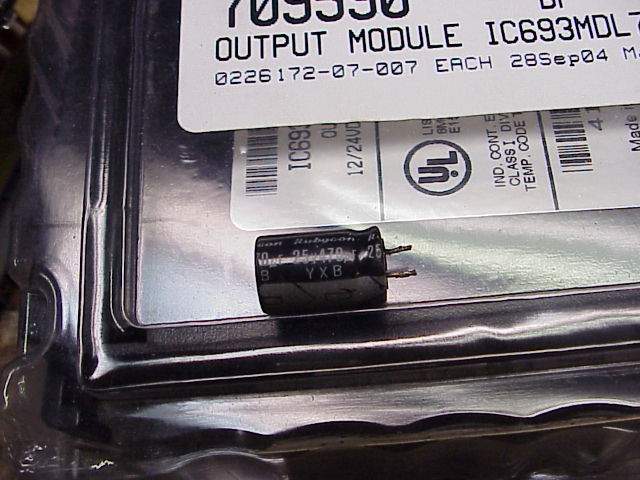

                just for topcat...
                a blown ruby!

                  YXB series? How old is that? Looks like a 1997 date code on that Takamisawa relay.

                    I've seen a blown ruby on very rare occasions.... 21-gun salute for the dead ruby!!

                        A blown Ruby is not unusual for me. We have Optiplex GX270 systems & I've seen probably 7 or 8 Rubycon caps that have either been bulging or leaking. It's always in the same place, right between the RAM sockets and the AGP slot.

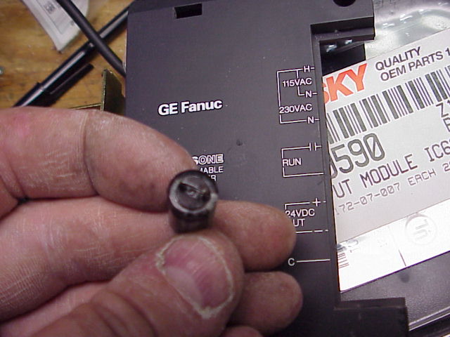

                          that is in a ge-fanuc plc psu.
                          think easy bake oven.the nichicons were toast too.i service a similar unit in a mitek cyber saw that was only 2 years old when its caps spilled their guts.the saw operators have been known to keep a pizza warm in the plc rack till lunchtime!

                            Are you sure the caps are in the right way round? Rubycon should almost NEVER fail; when they do it usually means they are connected up wrong or the board is providing severe ripple current.
                            The stencil (and therefore the caps) could be backwards on the motherboard - it's not unknown!

                                If they are, then Dell's vendor would have installed them that way. My theory was that there's two small chips next to this cap (I'm assuming are voltage regulators) that are extremely hot to the touch, enough that they discolor the board over time; I think they are baking those Rubycons.

                                  if they were connected wrong they would have blown shortly after installation.
                                    like my 5 minute fm!
                                    btw i emailed matsushita industrial and they confirmed my suspicion.one in 50k might get sleeved wrong and sneak past qc

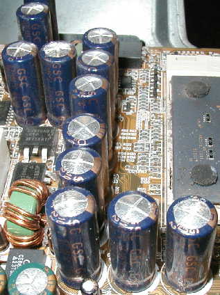

                                        I am chore boy in one smal bazar and internet shop. One customer take a computer for repair.
                                        GSC on CPU power
                                        Dust
                                        Computer:
                                        VIA MB - P4MA Pro 533 - with GSC caps LE series
                                        VGA- ManLi 4MX
