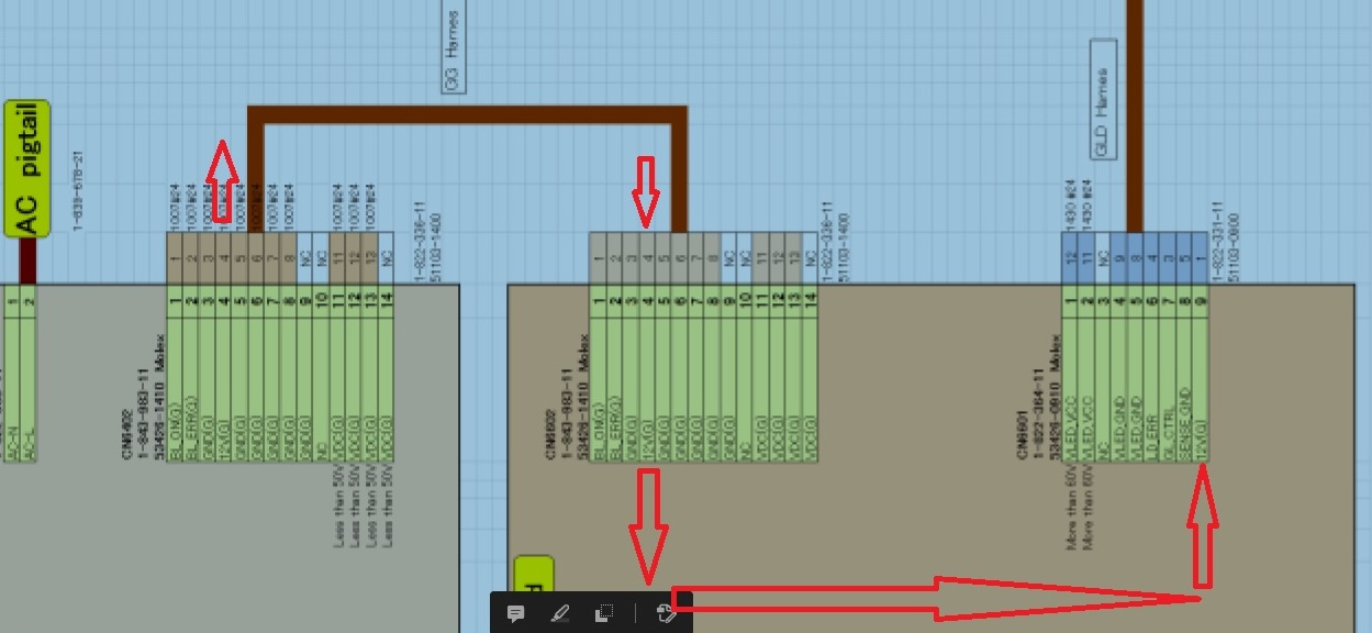

                #207
                Re: Sony xbr65x900c sound yes, no backlight or image.

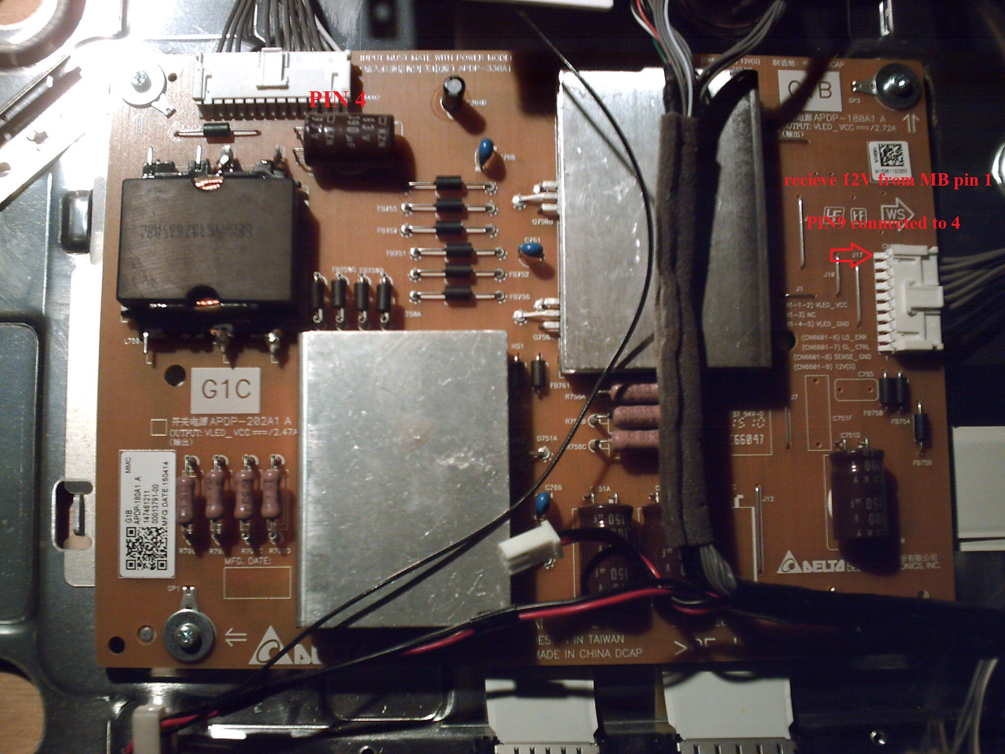

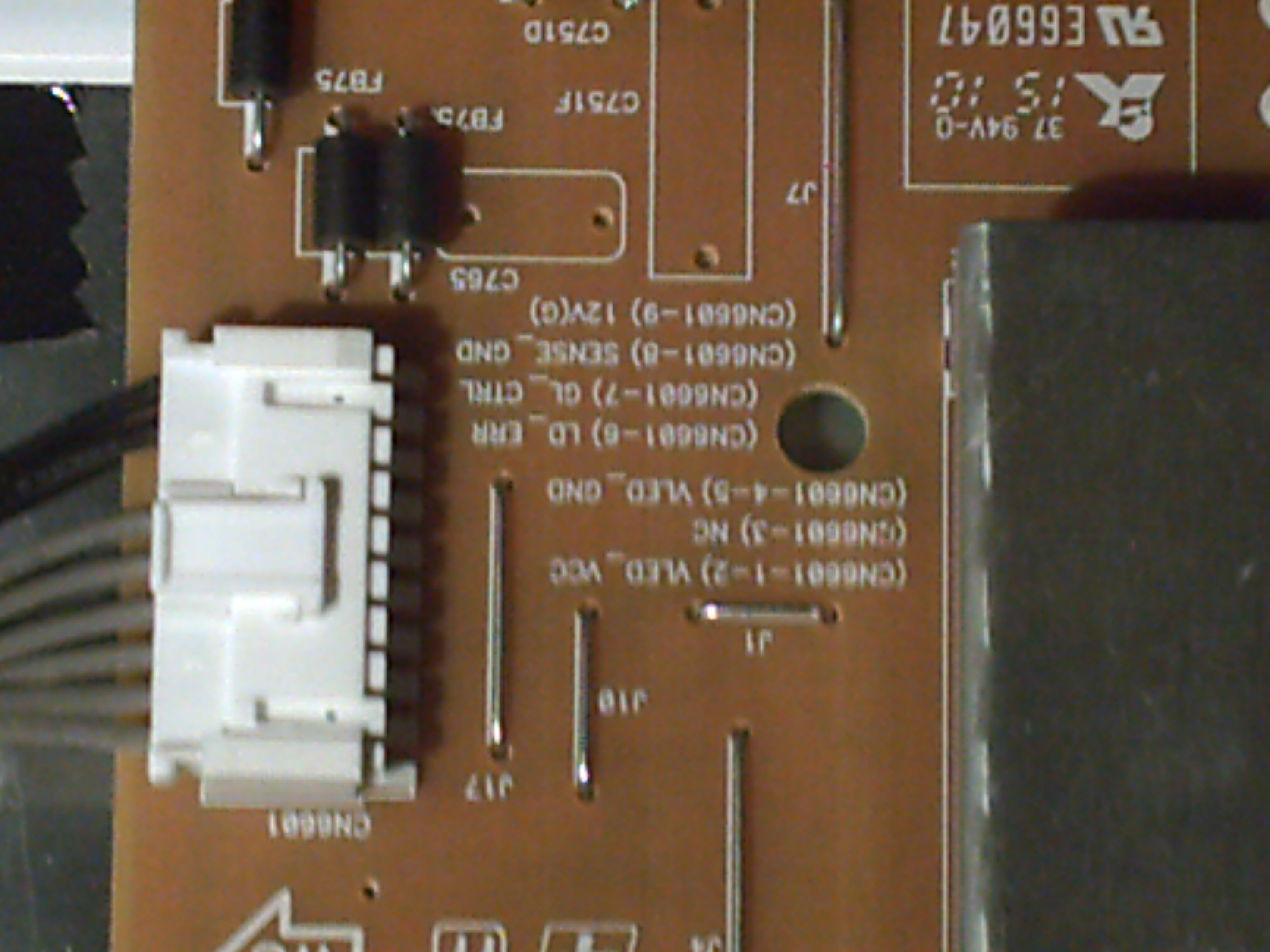

                man. this is confused... SJ photo may different.. cn6602 pin 4 & cn6601 pin 9 they connected together and should have 12.V... you need to follow both to know who are the IN 12V. and from where.
                • nomoresonys

                    #209
                    probably not what you meant, I tested cn6102 pin 4 to cn6402 thats between both powerboards, i got 27v.
                    • Diah
                      • Feb 2013
                      • 6573
                      #210
                      post photo on yours LD boards
                      no need you have..
                      also pin 9 recieve 12V from MB pin 1. you need to check if you have fuse on this rail on MB open

                        ok, my bad, there does seem to be a difference between the G1B and the G1C i linked, heres a pretty good picture of the G1B board. I noobed that one https://www.ebay.com/itm/12512214097...YAAOSw6dVh84uZ
                        • Diah
                          • Feb 2013
                          • 6573
                          #212
                          look above i add yours photo

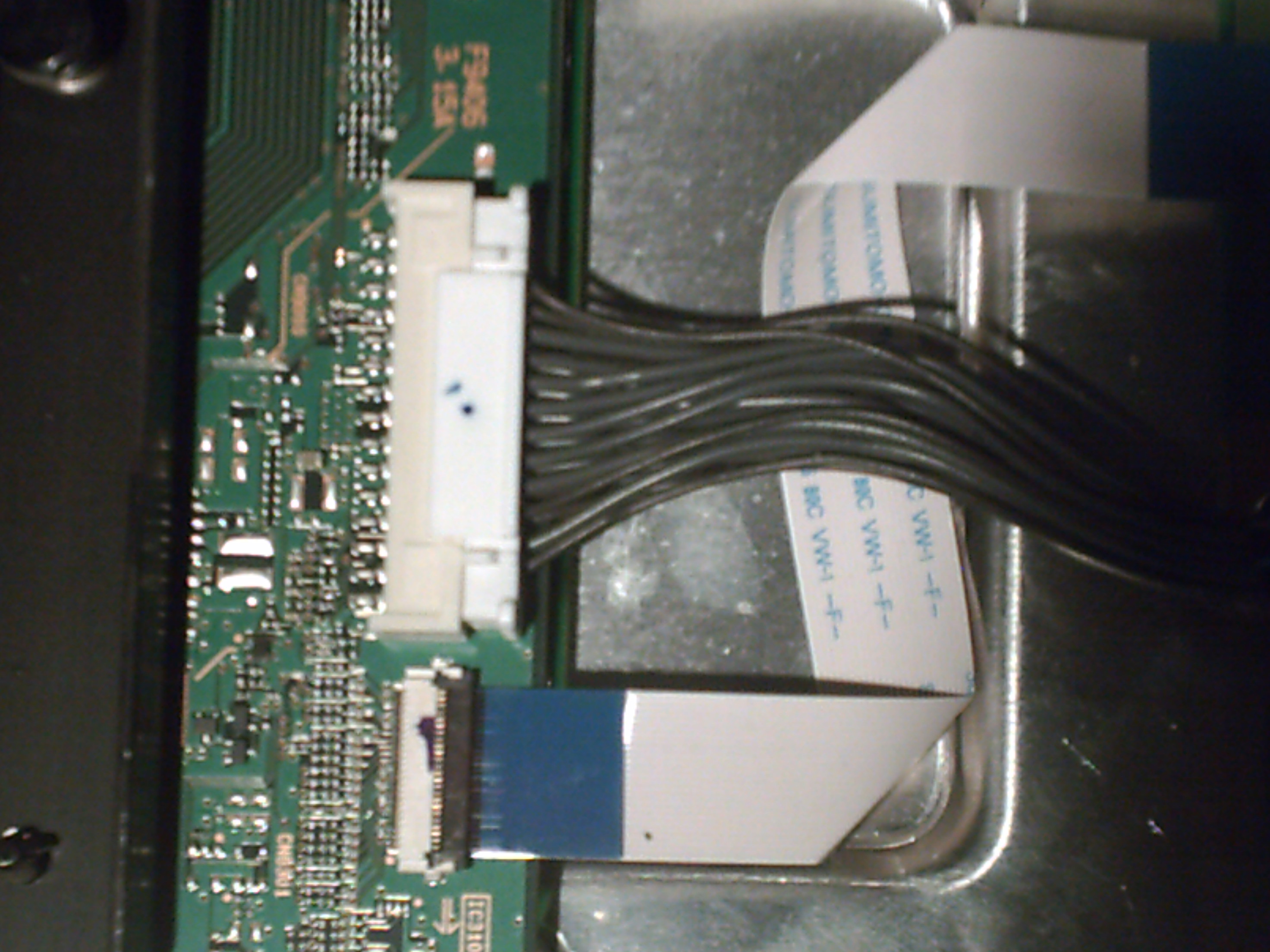

                            #213

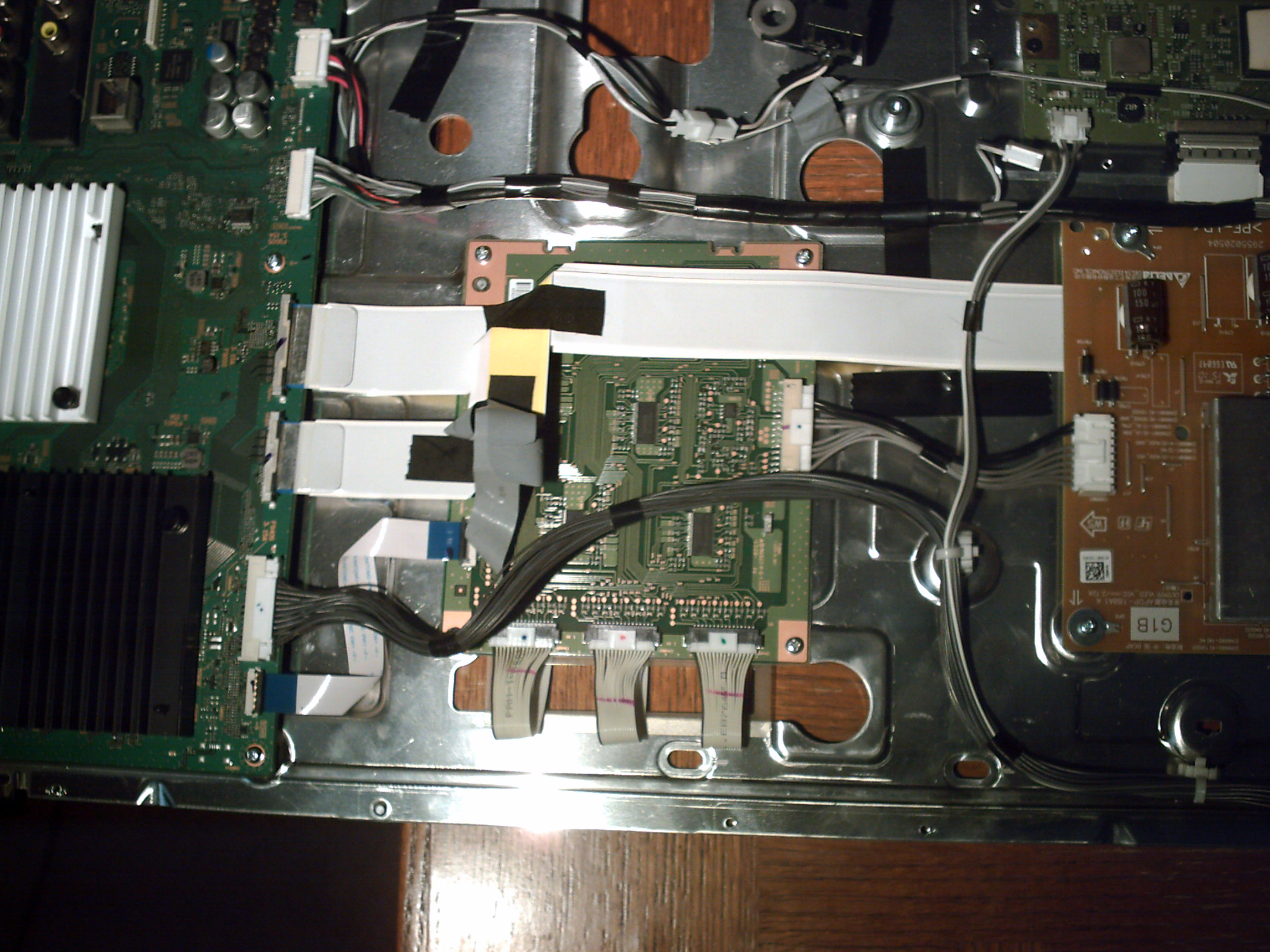

                            Thanks Diah, i just took a bunch, ill add them.

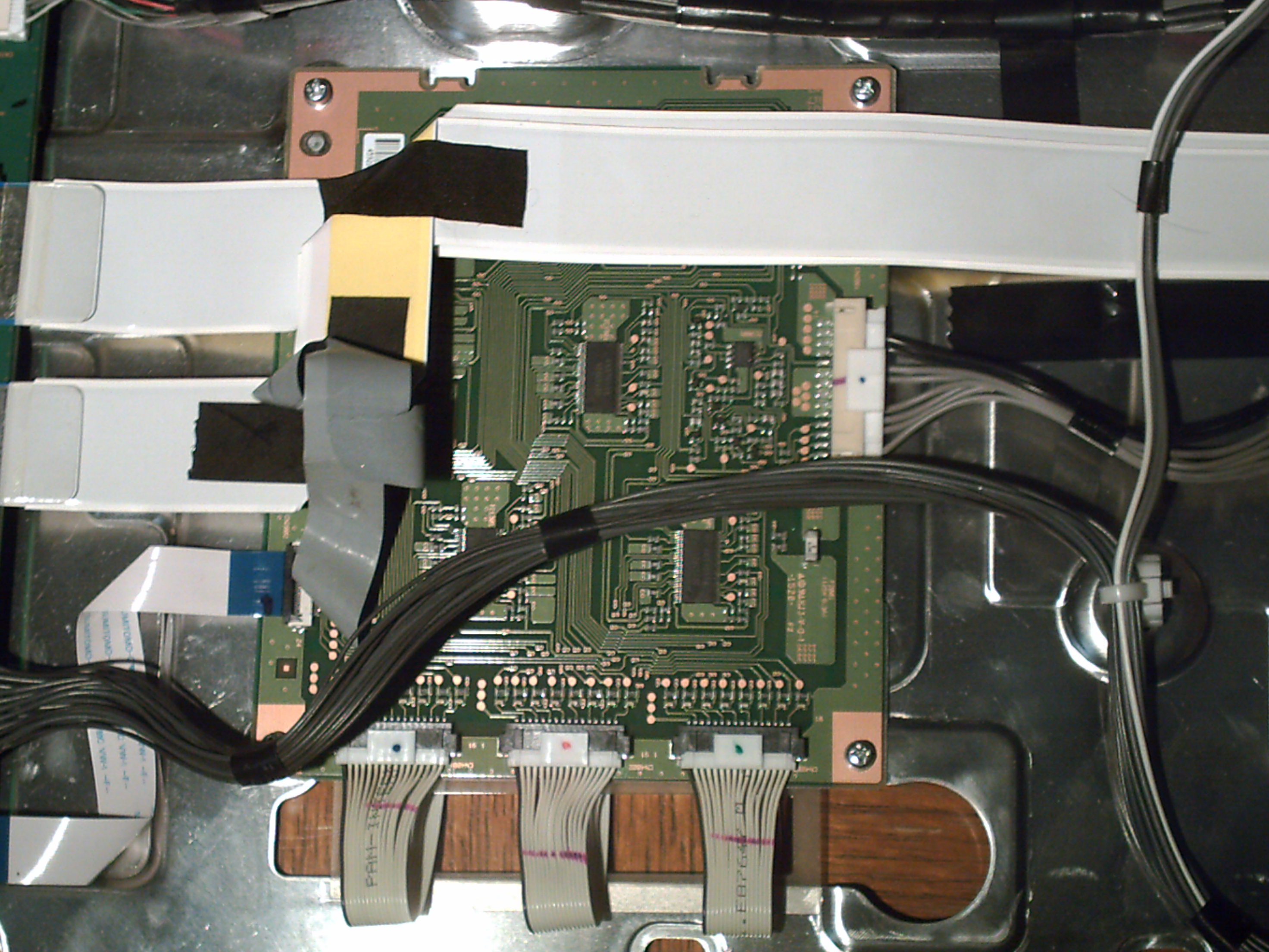

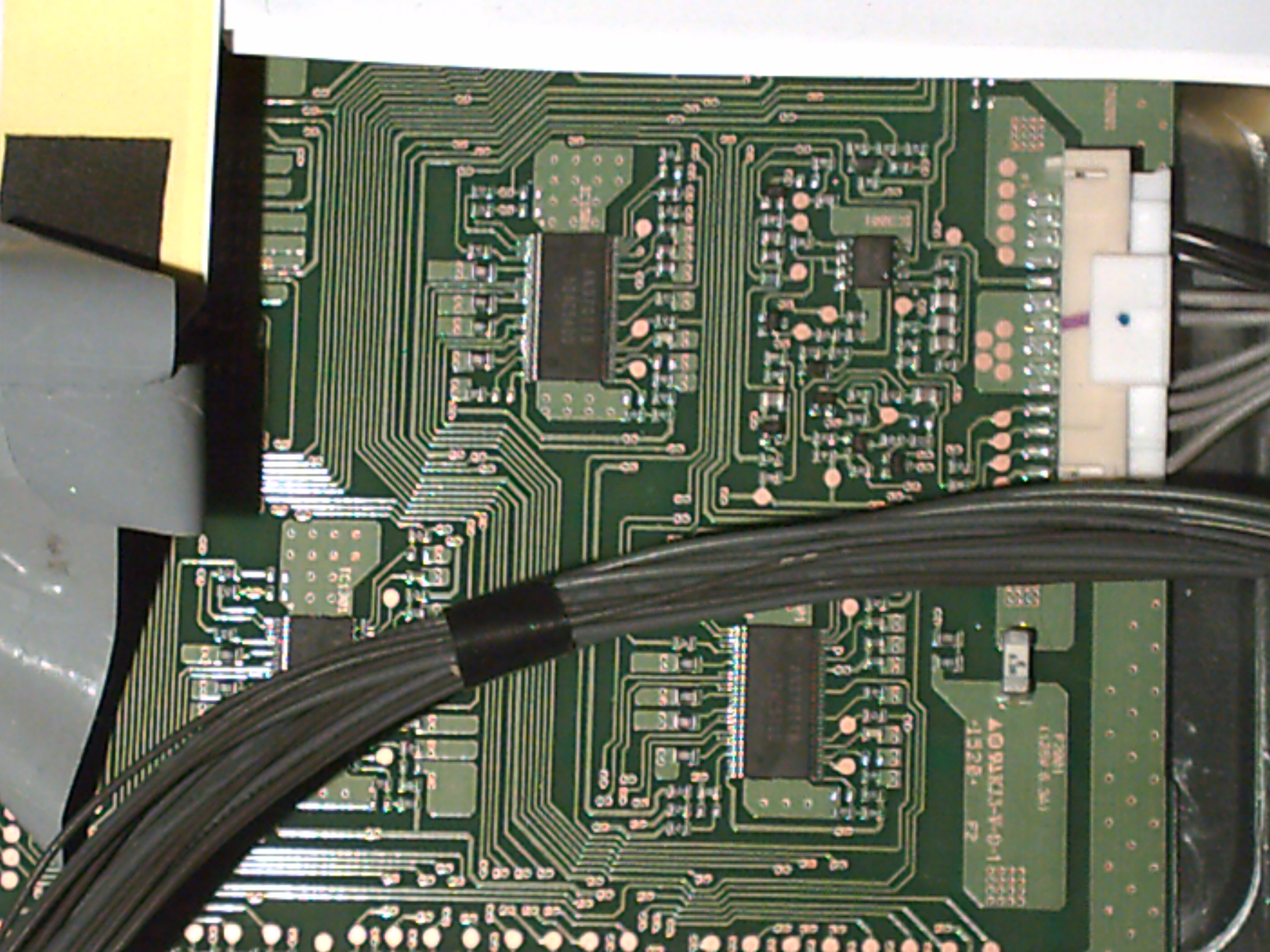

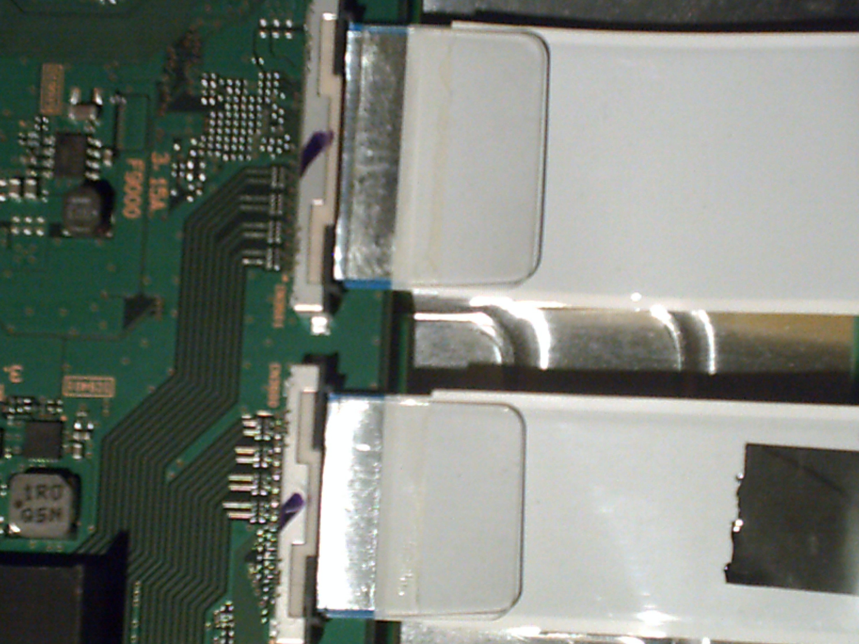

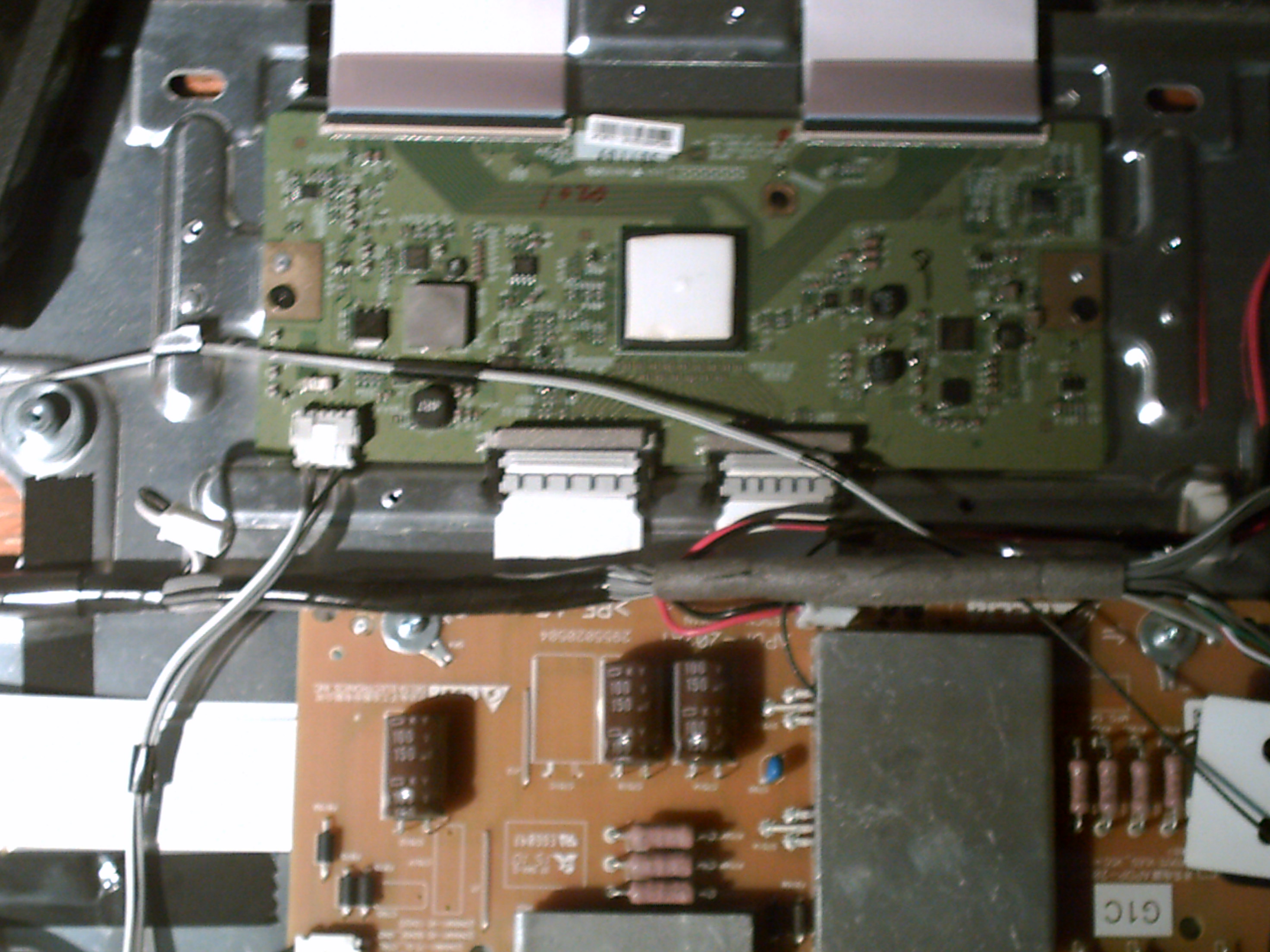

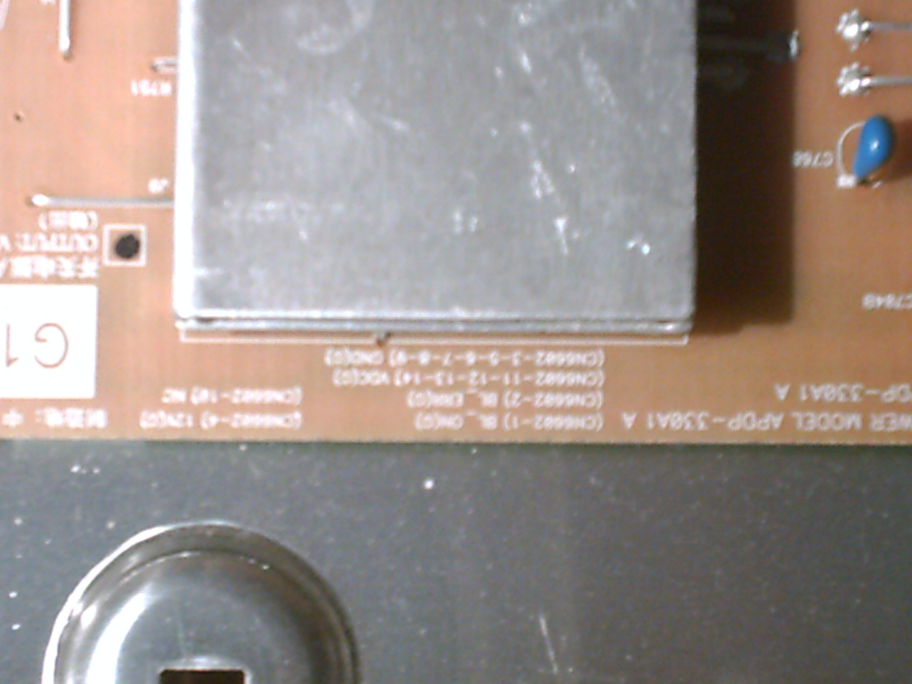

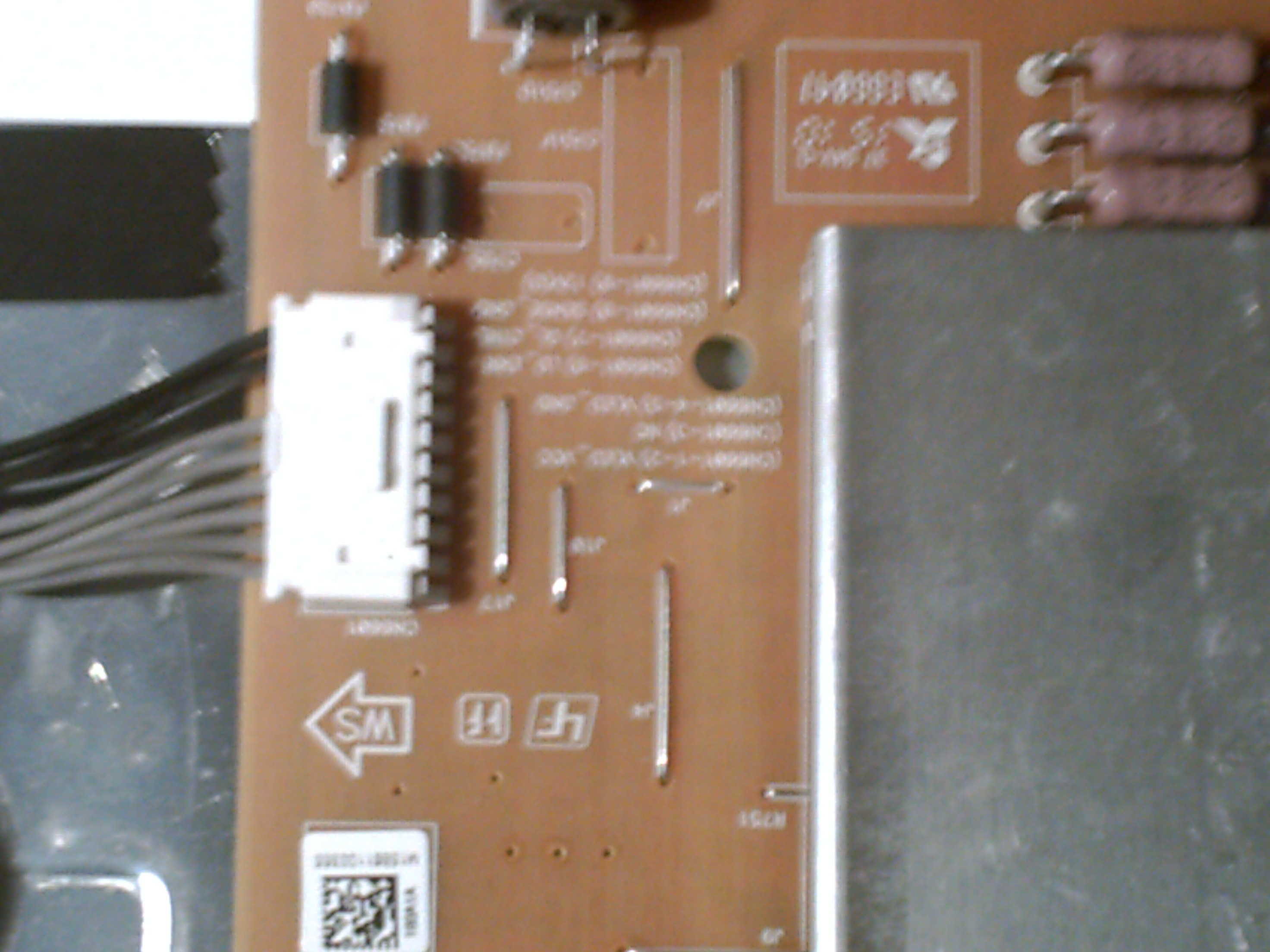

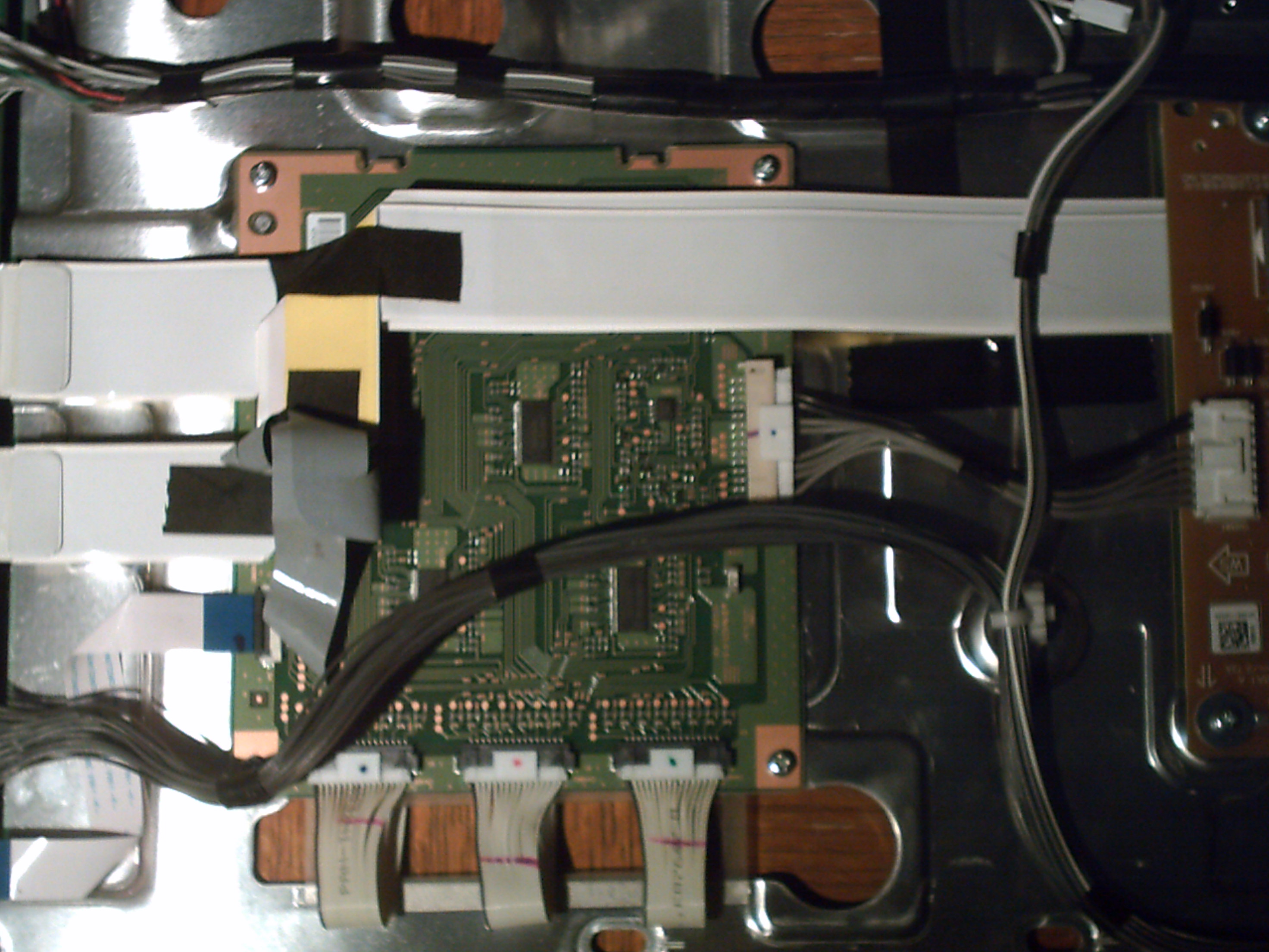

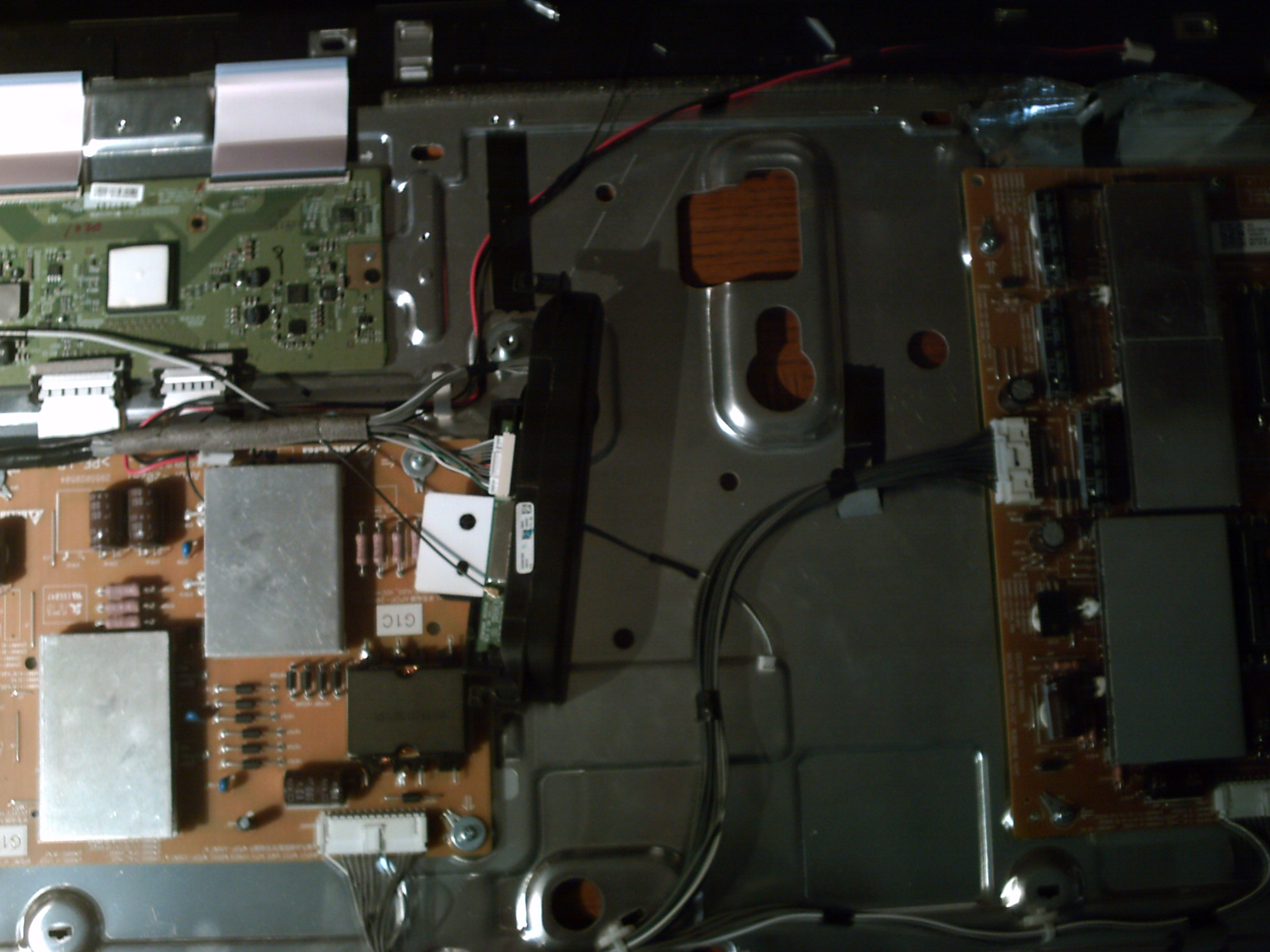

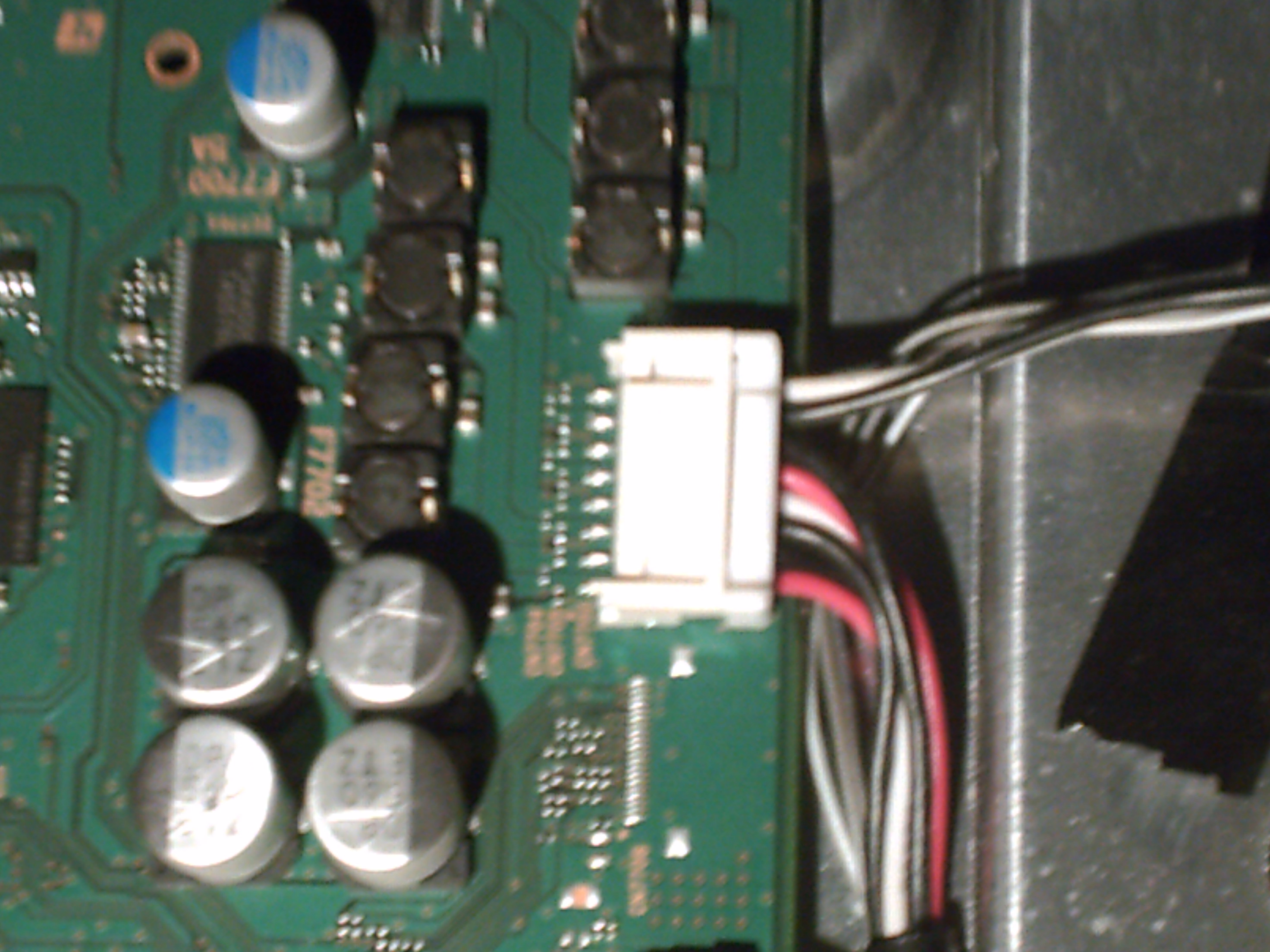

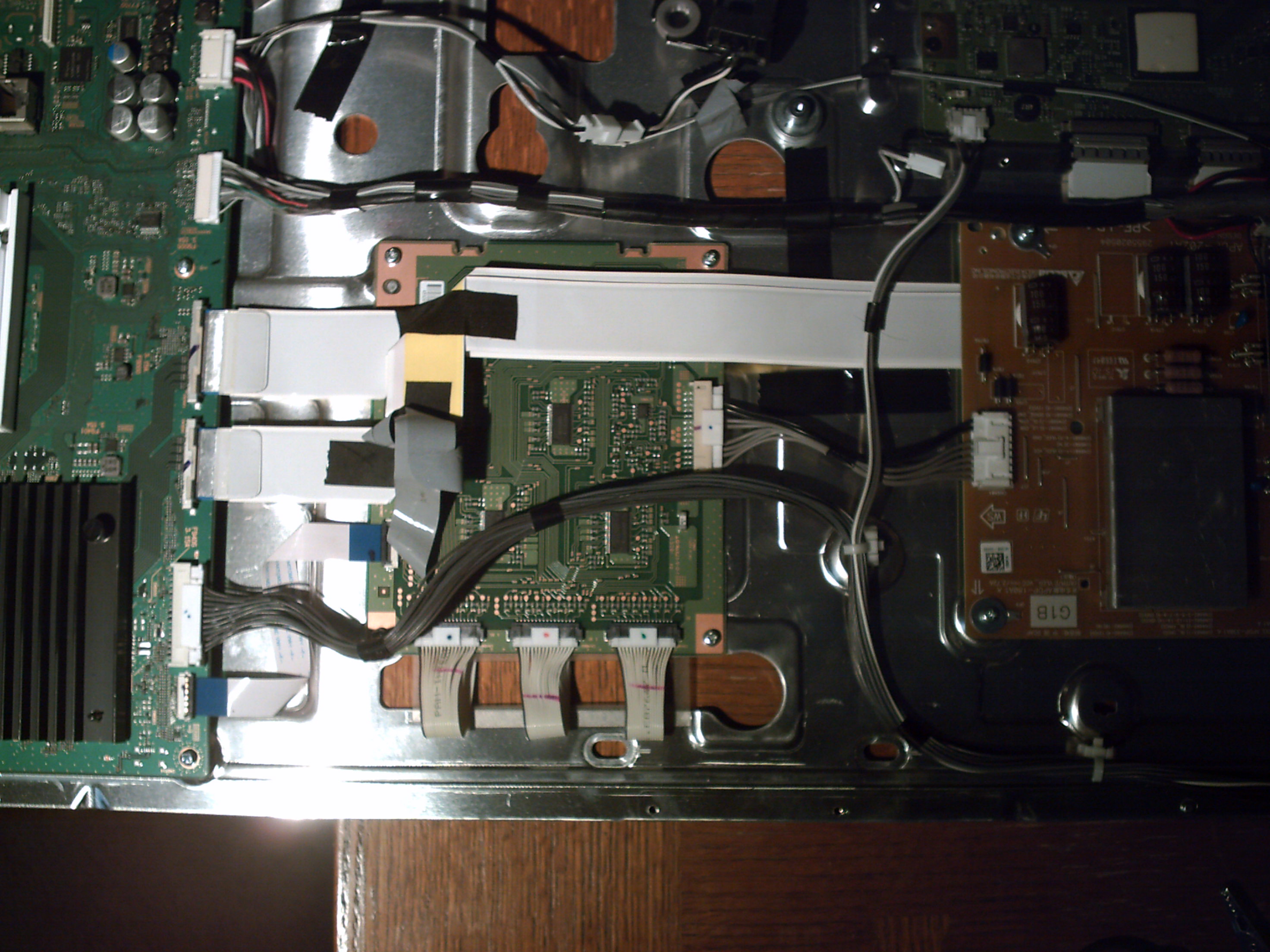

                              #214
                              Pictures:
                              • nomoresonys
                                • Jan 2013
                                • 12330
                                • U.S.

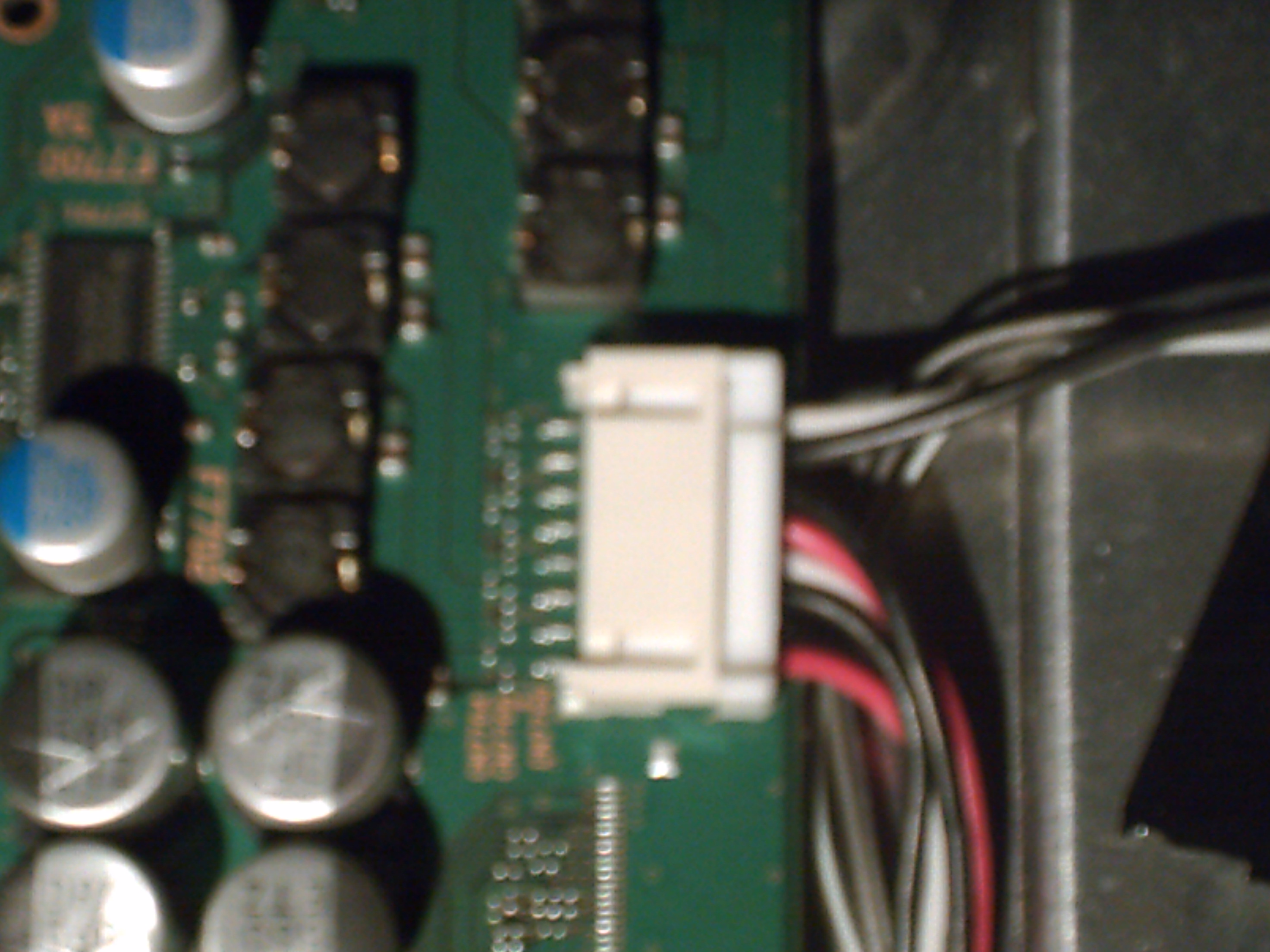

                                #215
                                pictures:

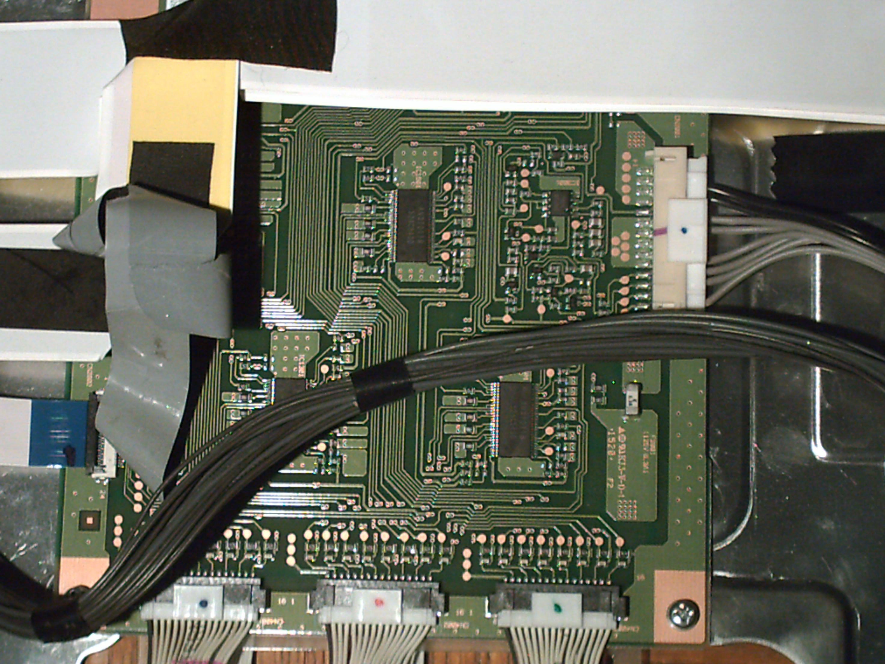

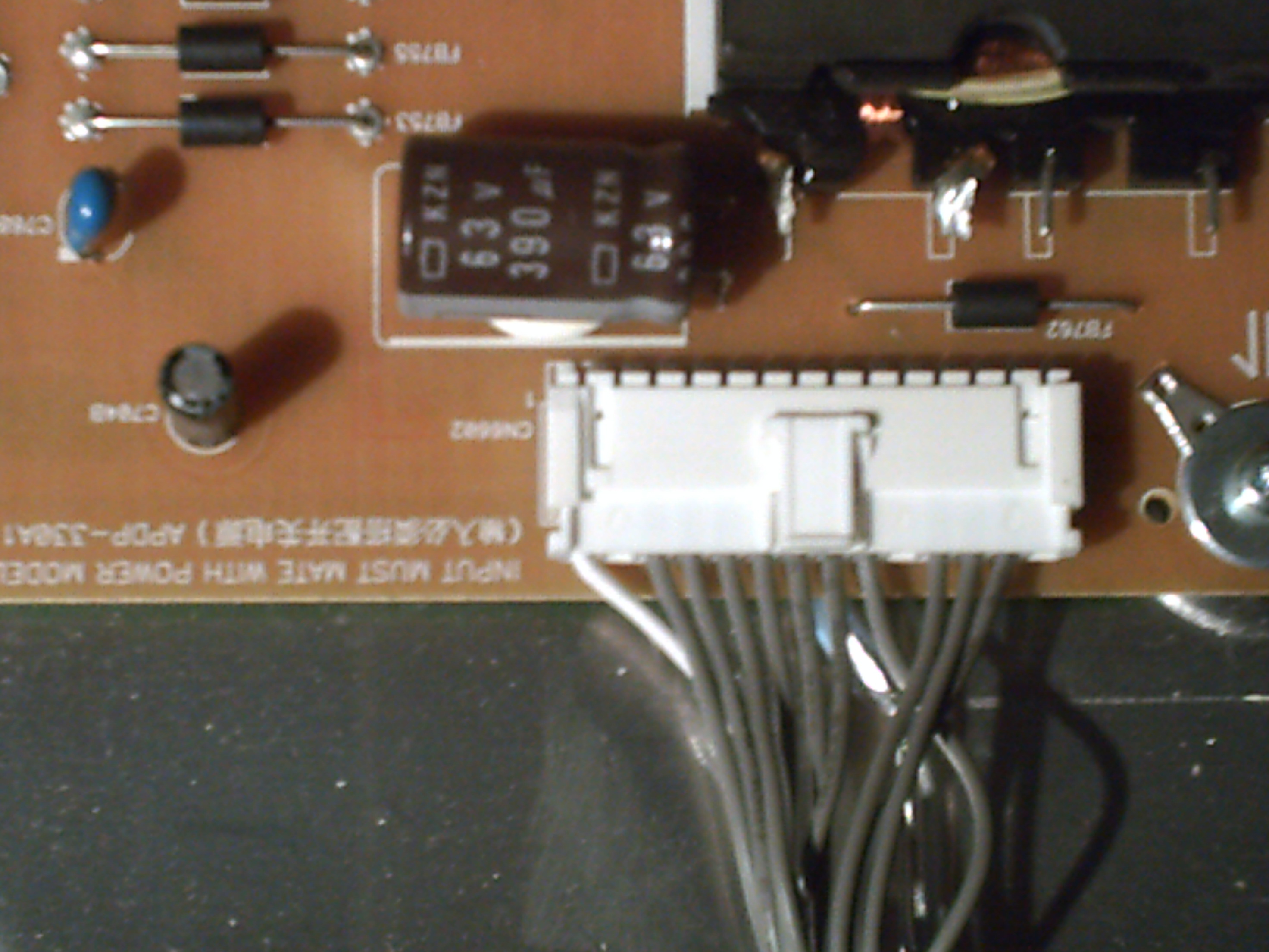

                                • Diah
                                  • Feb 2013
                                  • 6573
                                  #216
                                  my attached photo at post #210 i wrote it in wrong way
                                  12V come from PCB to the boards cn6602 pin 4 then go to MB via PIN 9 CN6601.
                                  just check there are 12V or not.
                                  • nomoresonys
                                    • Jan 2013
                                    • 12330
                                    • U.S.
                                    #217
                                    with this camera if you try to get too close it blurs everything.
                                    • nomoresonys
                                      • Jan 2013
                                      • 12330
                                      • U.S.
                                      #218
                                      ok, i have 12 at 4 and 9, i measured between 9 and where it goes to ld board, there is 0v on the ld side, thats from cn6601, should i yank that harness and check it for continuity?
                                      • nomoresonys
                                        • Jan 2013
                                        • 12330
                                        • U.S.
                                        #219
                                        I do currently have the bl-error pin from pin 2 grounded to pin 9 on cn6602, has been for a while.
                                        • Diah
                                          • Feb 2013
                                          • 6573
                                          #220
                                          ok. now you need on the socket cn6602 pin 1 BL_ON to pull it out from the socket ( discconect it ) and power on... messure the cable if it go high... in case yes or no ... go to the shit IC pin 18 check if it get >3.V
