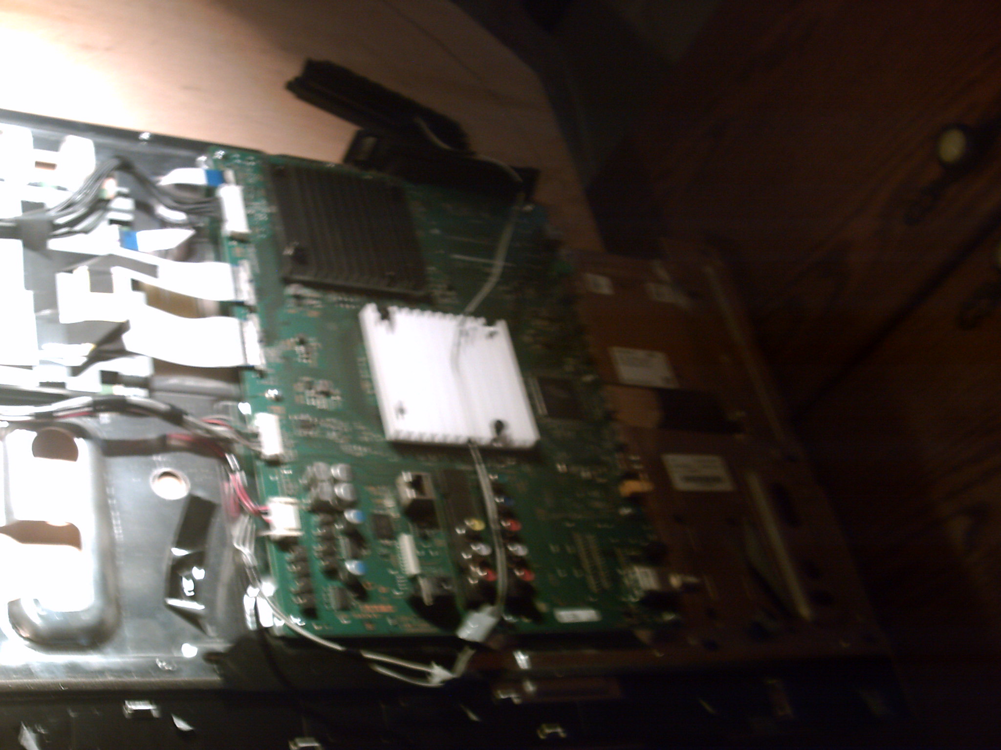

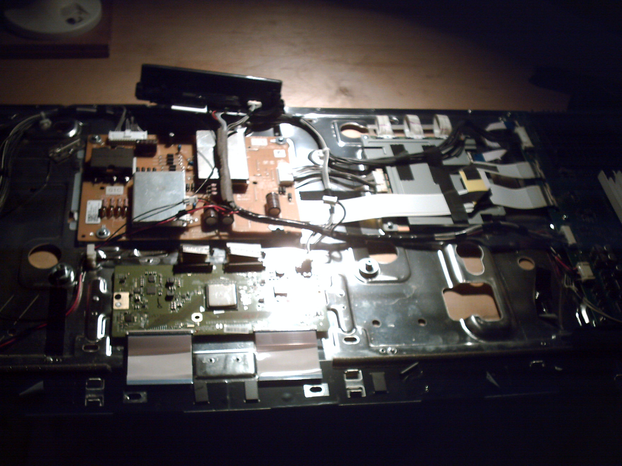

    Another troublesome sony: Just the facts. Tv was on, went off with 4 red blinks, messed around unplugging boards, testing cleaning, 4 red blinks went away, next turn on would get blinking green amber, then tried updating, nothing seemed to change so stopped that. Next I would turn it on get the steady amber/green blinking, I hit power on remote and it changes to steady dim white light, would get the android music but nothing but a black screen, no backlight, no image with a torch that I could see. Then made a mistake not letting it dry long enough after cleaning with iso alch and blew up the 2 main filter caps, put it back together plugged in without tcon connected, got flashing green/amber and solid red at optical on mainboard but it went off after 15 seconds, now not getting anything at plug in and remote or panel button does not turn it on. The pics didn't turn out well, even tho I used a flood light.

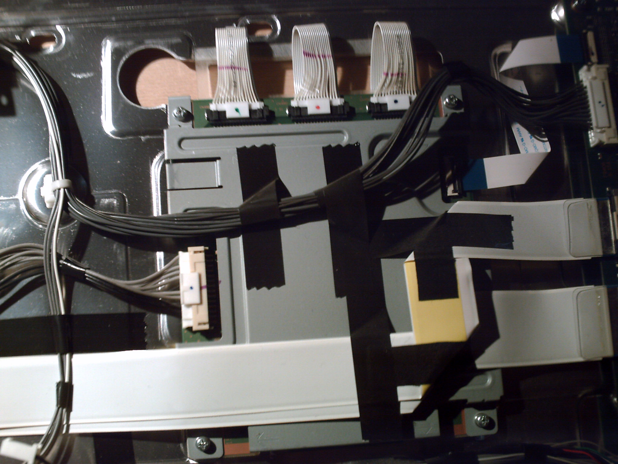

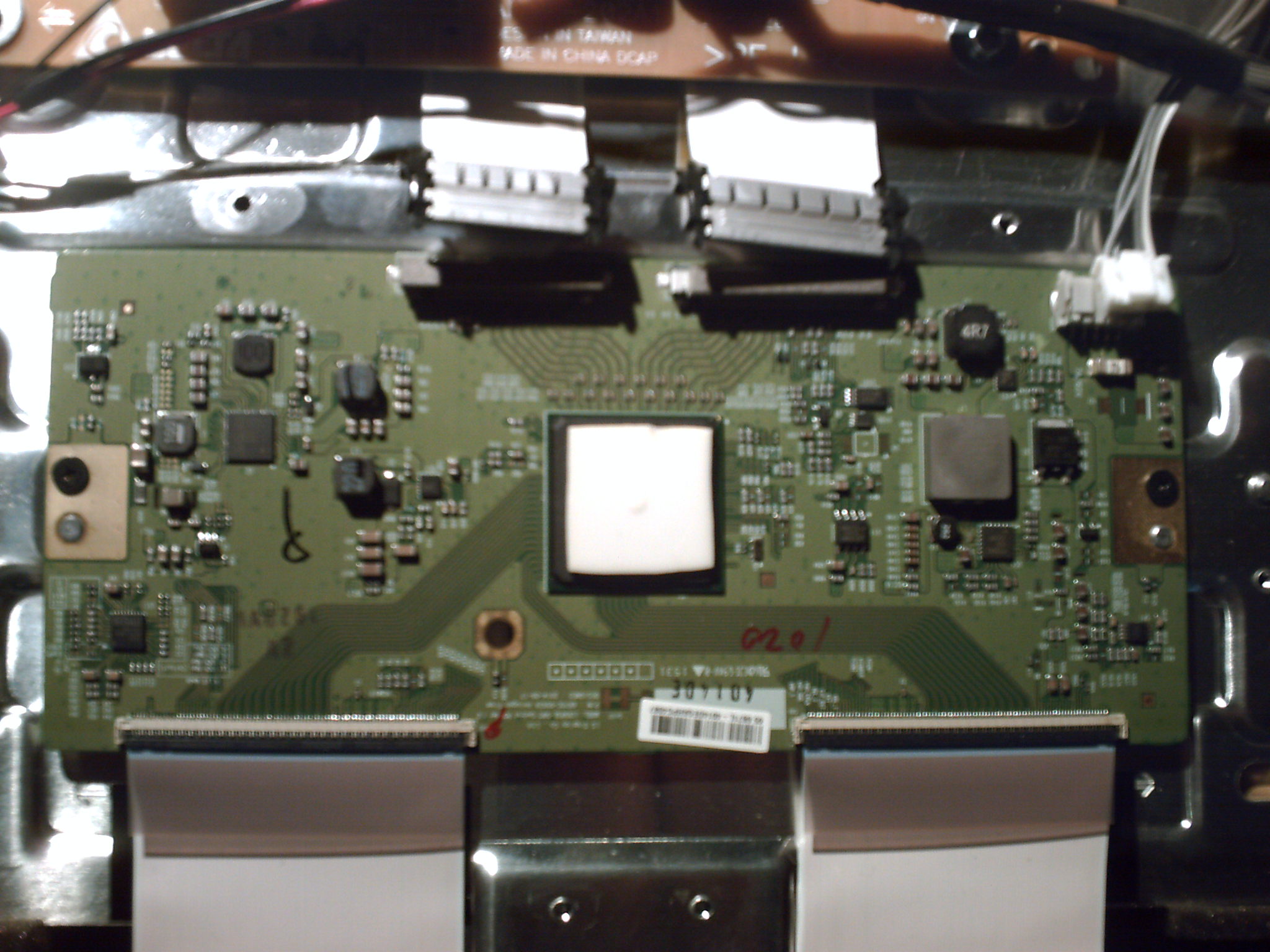

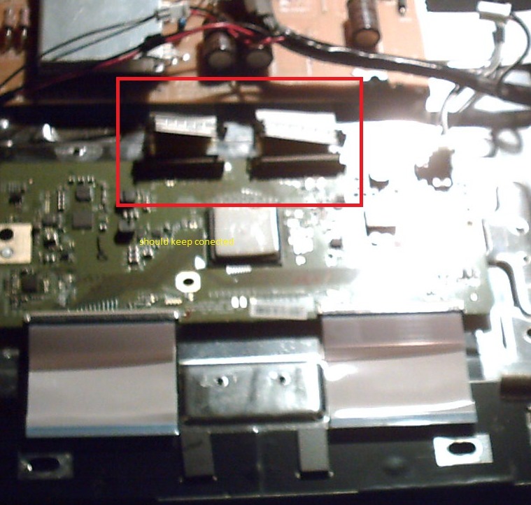

    yours photo it is wrong.. you need to disconect the ribbon cable between the t-con and panel.. not the one you show on the photo which they should in place..

      So, what are your power board voltages without main board connected and powered up? What are they with mainboard connected?

        Thanks for replies, Don't know why I can't get any light in here, it's like a dark cloud, I'm in the states. powered up with the tcon connectors on that side back in place place and off on the panel side, the light blinked amber/green for about 30-45 seconds then went off by itself, then tried remote and tv power button but no response, then took readings I get the proper voltage on 5-stby and 7-acdet, I have 2.3 volts on bl-err, the rest are 0, those are with mainboard hooked up, unhooked 5-stby and 7-acdet are the same and bl-err is .17 volt rest are 0.

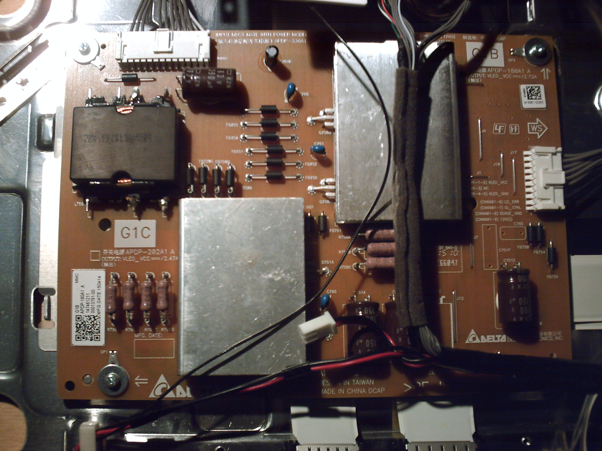

                    Did the powerboard alone test you suggested Diah, in that state the 12 volts are not there, do I need to jumper anything besides power-on and stby? thanks.

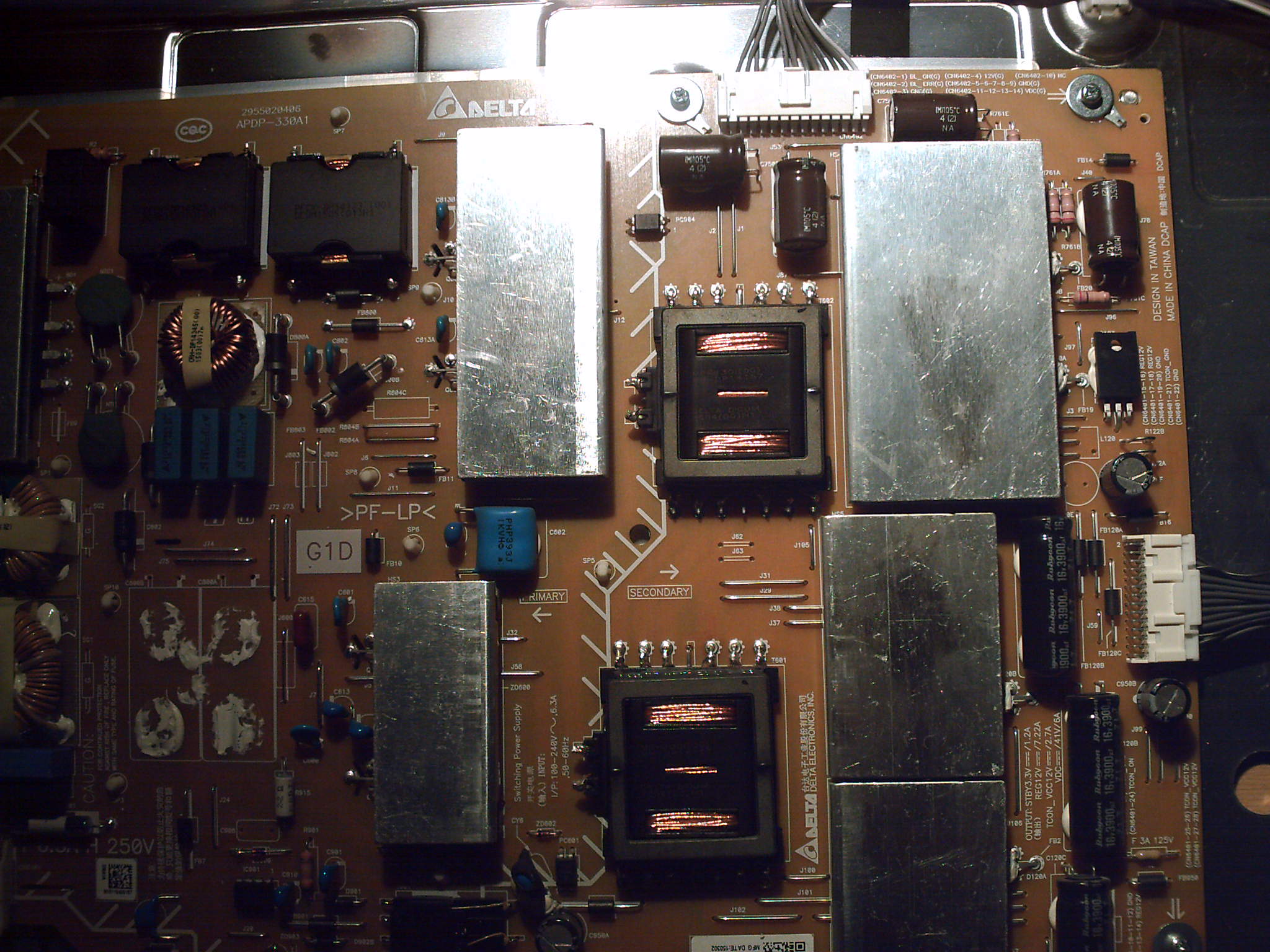

                      show here the print pin chart of the PCB which it goes to MB.. to tell you how to test PCB as stand alone

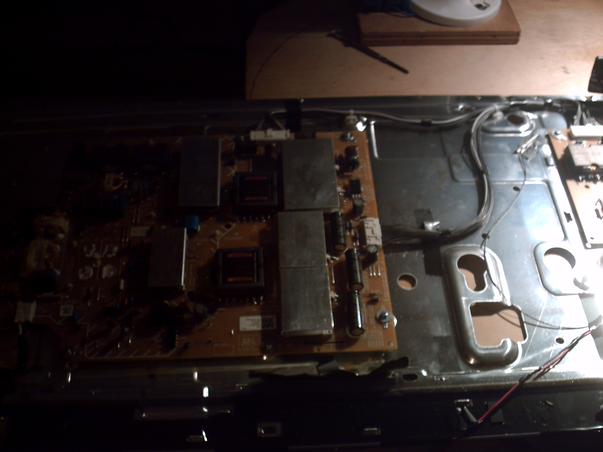

                        If you click the first pic 3 times it will magnify, This is my powerboard, thanks: https://www.shopjimmy.com/sony-1-474...-supply-board/

                          Re: Sony xbr65x900c sound yes, no backlight or image.
                          if it was clear to my eyes i would never ask..lol
                          but you look self.. find the power_on i think pin 9 as the SJ photo.
                          yours main board should disconnected from PCB. first jumber STB with this Power_on pin.. and messure if you have reg 12v on the socket.
                            Thanks Diah, yes I did that, my 12 v's are not working at least there's no voltage on the 12 v pins, just 3.4 volts on power on, ac-det and stby that's in the stand alone test. When I had it hooked up to mainboard as normally the power on was not there, that is after the green/amber stopped flashing. But I know the 12 v's were there because I did read them at one point and that's after the fireworks.
                              stay with stand alone test.. and keep the first jumber you did. do another jumber between STB and TCON_ON pin... see if you have 12 volt on pin TCON_12V
                              BTW be sure the first Jumber goes to power_on--- check again
                                Did it, when connected tcon on-poweron-standby voltages read 0, with poweron-stby connected voltage is 0, so in the standalone test, the only time I have any voltage at all is when I just plug the power cord into power supply, then I have 3.4 at stby and 3.4 at ac-det the rest are 0. I guess something is wrong with powerboard.
                                  so since the main fuse didn't blow up.. you have now OPEN CIRCUIT at the Primary section.. start with testing all parts with FS label include any R or diode or zener
                                    Yes, I sent it yesterday, you might have missed it. Clipped the ZD909 zener, its ok, have several tiny resistors reading short in that area, do you think that IC901 could be bad, not sure how to test it, can I test it in circuit? guess I could remove it and see if the shorts go away, thanks. have a picture here from sj: https://www.shopjimmy.com/sony-1-474...-supply-board/
                                      Plus when ZD909 is installed it reads short but is ok out of circuit, well .972 one way and 1 the other.

                                        Will test all with fs label, thanks.
