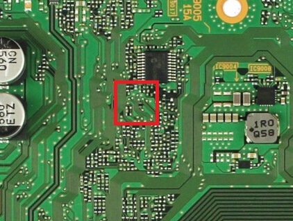

    if you by mistake touched next pin to 18... then need to do this
    pin 17 = PANEL_PWER_ON it should read >3.0V okay.. if no change IC
    pin 19 = power on >3.0V okay
    then while the tv out from wall check pin 18 of this IC if it read short with chassis... if yes then need to replace the IC
    If BL_MUTE (R9174) is 0V and pin 18 read >3.0V and its not shorted with chassis... need to replace IC91017

      ok, 17 and 19 have 3 volts, 18 has 0v, while testing when the music was on i would touch 18 and music would stop and go back to orange green blinking, tiny work, taped needle to probe.
                      if pin 17 =>3.V mean the panel if its in place you should see image via tourch or if you turn on one line BL with yours tester.

                        those are better than i can take with this lighting situation, winter here, just about every day is cloudy dark and dreary, lol.

                            "If BL_MUTE (R9174) is 0V and pin 18 read >3.0V and its not shorted with chassis... need to replace IC91017" is this resistor R9174 near IC91017?
                                yes down side IC little to the left... check the r if its Lor H as its mute BL

                                      ok, i cant find R9174, theres lots of tiny things around IC91017, but my weaker eyes cant see it even with a magnifying glass.

                                          Thanks, think i got the right one, it read 562 in diode mode, it jumps around in ohm mode just like some other same looking ones I tried to measure on the board.
