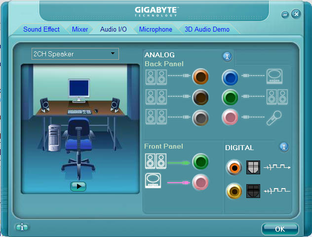

    so i took out one of my spare gigabyte ep35-ds3r mobos from storage for use to do some cpu, ram and video card testing of stuff i bought from ebay and got for free from momaka. he bought 50 e8400 cpus for cheap from ebay some years ago and i decided to help him relieve him of some of his supply since he had waaaay too many!! what did we say about hoarding too much stuff and depriving others of them?! *cough* socialism *cough* lol!
    i had to blow some dust off the board and heatsinks with the datavac as i didnt clean it up before putting it in storage. after finishing assembly of all the components, i powered on the system and noticed there wasnt any sound from the rear onboard audio jacks. oh no! not again... i once bought the same board locally with dead onboard audio that i had to return to the shop. this time i had the same problem. on the realtek hd sound effect manager program, on the audio i/o analog back panel jack detection tab, it couldnt sense any of the jacks being plugged in. none of the 6 rear jacks worked (no audio totally) and it couldnt sense anything being plugged in.
    surfing around the internet, it seems im not the only one with this problem. it seems dead onboard sound and lan is a common fault on these gigabyte boards. grrr!

    so the realtek hd audio sounded so much better than the cmi8738 audio indeed! so now this leads me to believe the audio chip isnt focked. just the rear panel jack detection switches are farked. i believe the jack detection is needed to turn off the audio signal to unused audio connectors to prevent signal reflection and echoing to preserve the high signal integrity and snr of hd audio, so then this adds on a new layer of problems. if the rear panel jack detection switches are farked, this then makes the onboard sound useless from just a minor fault.
    so now i wanna ask if there is a way to trick the sound chip into thinking something is plugged into the jack bypassing the jack detect switches by hotwiring it or something? is it also possible to desolder the rear panel audio io jacks and replace it with a new one? i have another scrap ep35-ds3r that has either bad bga on the northbridge or lga775 socket. using momaka's hammerblow punch fix on the northbridge, i was able to get the board to post but as soon as i take my hand off, the board hangs instantly, so that board is an ideal candidate to pilfer the 6 jack hd audio rear io panel from. any suggestions on a more permanent repair for the hd audio rear panel jack set would be welcome.

      Sounds like the high humidity in Singapore has tarnished the contacts in those jacks when they sat idle for too long.
      Try using electronics contact cleaner first.
      Spray a generous amount in each 3.5 mm jack on the rear and then connect and disconnect your headphones a good number of times (10-20??)
      Yes.
      Just find out which pins on the audio jack(s) are used for the signaling using a multimeter set on diode test and a pair of headphones. With the headphones plugged into the jack and multimeter black (-) probe connected to ground on the motherboard, start probing the pins on the underside of the board with the red (+) probe until you hear clicking/static from the headphones. Then note which pin corresponded to the Left channel and which to the Right channel. Do the same for the other jacks so you get a complete pinout of all of the L/R channels on all of the 3.5 mm jacks. The pins that are not connected to ground and you did not find to make any static/clicking noise through your headphones are likely the ones used for the signaling. I can't remember what needs to be done (can check if you're still interested), but I did trick a silly HP Maverick socket 775 board into thinking there is a front audio header and front USB connected to stop it from holding me up with a warning on POST every time I powered on the board. I believe I used tiny 100-470 Ohm resistors for the purpose and soldered them directly between the pins on these front headers. But like I said, I'll have to look it up if you want more details, as I did this like maybe 8 years ago.
