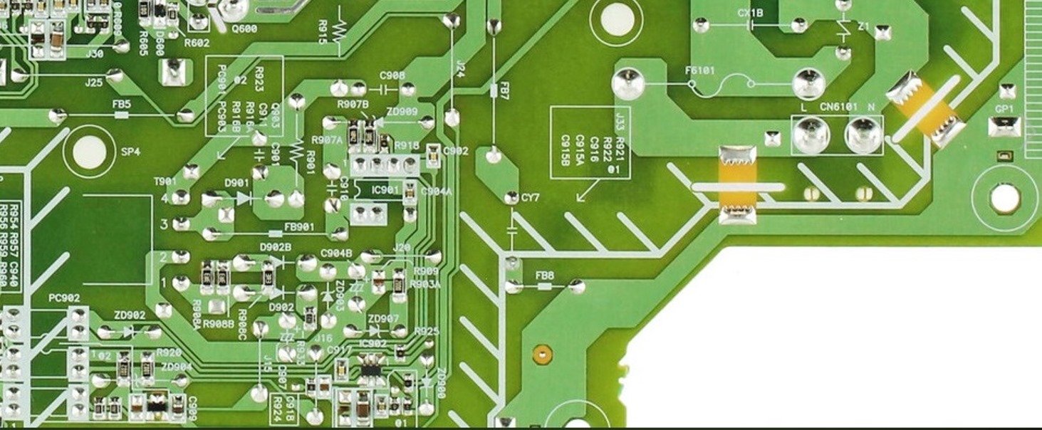

    Well I'm going backwards, I put 3 iffy zeners with the over 8xx testing in diode mode in, have 170 on the big 450 v 220 uf testing cap but now have no stby or acdet voltage at the connector pins.

      Hooked up 2 500v 120uf caps, have 168v on main caps, bridge is ok 160 dc and 120 ac, still not getting the stby or acdet on connector pins like before which just seems odd, can not seem to turn this board on with jumpers, guess I'll throw it back on the tv and see what I get.

        Ok, Diah, I think I figured it out, IC 901 is reading short, diode mode on 4 pins in relation to neg of main cap, that seems bad. Yet when I tested for vcc and the other voltages they all tested good, hate to dig that off and scrounge up another if that isn't the problem, did I do that diode test correctly?
          good but to late lol
          your reading could be had error... look of its pins.

            I still can't figure out these powerboards, I have 168 v at the drain of Q600, but there's 3.5 on Q601 drain, not sure if that's normal, that's just with powerboard plugged in, removed from tv, still no stby or acdet on pins of connector. Was watching a youtube video, his IC only beeped ie showed continuity on one of the IC pins, mine beeped on the whole side, 4 pins, but it seems like the whole side is connected to the big cap, seems like they maybe should all beep???

                          Ok, what do you think about this, powerboard on bench, main caps have steady 166v, checking drain of q600, q601, q800, q801, neg probe on - of bridge rectifier and + probe on drains I might get 166v, if i take it off and put it right back on it might say 0v or 5 volts or 3.5v, ever have that problem? could it be a voltage regulator?

                            Took readings, what do you think of the difference?
                            old board shows continuity from - of bridge rec. to pin 1 of IC901 which is G/OCP, new board does not, guess that means IC901 is bad??

                              IC901 datasheet: https://datasheetspdf.com/datasheet/STR-A6069H.html
                                yes. for me it had leak

                                  Thanks Diah, guess I blew it by not investigating that IC close enough, do you think it could be a bad ld board that is keeping the backlights off?
                                    i know the screen out, did you got sound? and stable white indicator ? or at least the optical audio lit red on

                                      plugged it in it flashed green/orange for about a minute then went out then turned green for a few seconds then went out, turned it on with remote, have stable white dim indicator and android music.
